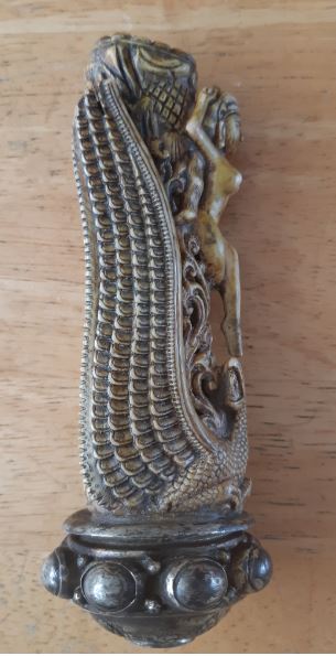

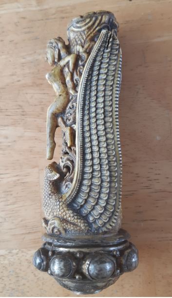

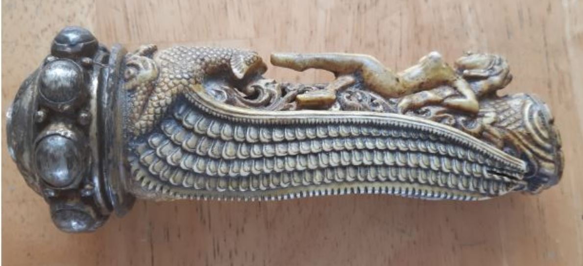

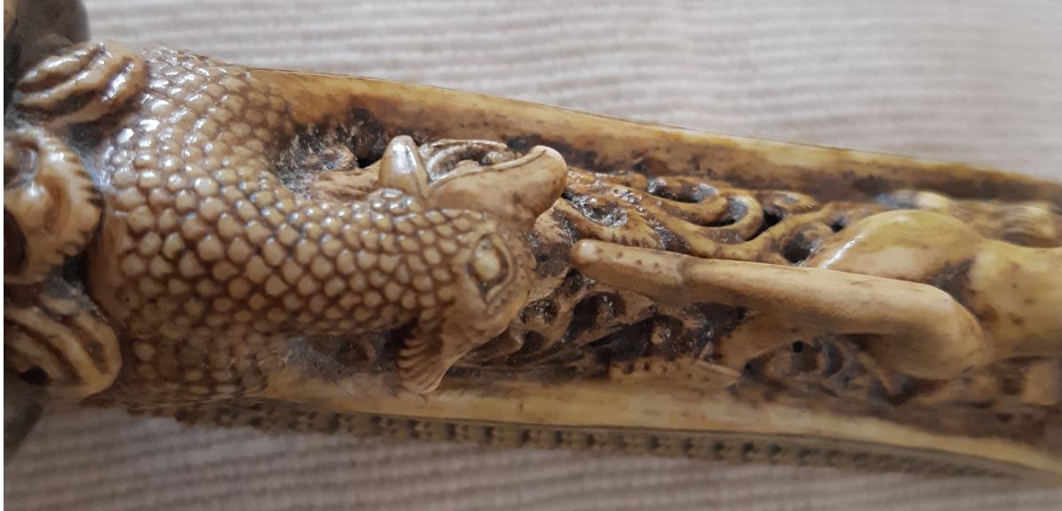

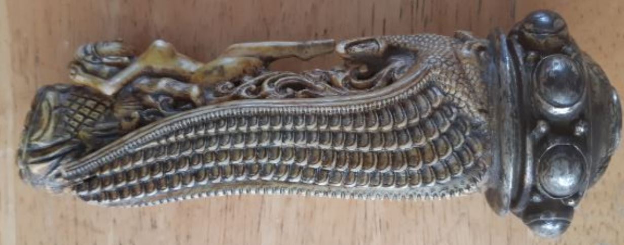

Does anyone recognize the material from this ukiran, based on this photo's?
regards Pat
Last edited by Patje1970; 19th August 2019 at 11:05 AM. Reason: added more photo's

The hilt look very recent to my eyes. Recent hilts from Bali are often carved from moose horn. Difficult to be certain by the look to pictures on a screen.

Not easy, it seems to have some age, the materials is strong/ solid, not from bone, does not seem from ivory (black spots), so my best guess is deer antler.
PS: Moose antler is a strong possibility as advised by Detlef.

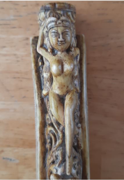

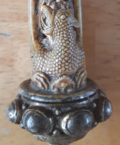

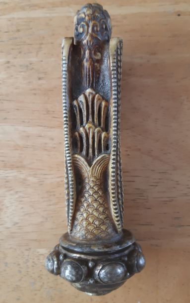

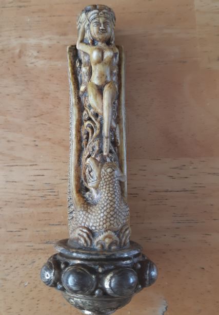

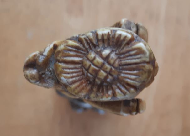

Default More detailed pictures
See more photo's below
Mayby Spermwhale ?

The patina & colour do not look like spermwhale tooth from the pics.

Well, first off, while i believe this hilt is a contemporary, non-traditional form, i personally find it very appealing.
I don't think it is ivory (certainly not elephant or whale) and it doesn't look anything like the moose antler that many modern Bali carvings are done with. It could be some other type of antler or dense bone.
What does it feel like? is it heavy or light? Does it feel cool to the touch?

It feels cool when touching it, In hand it feels a little heavy, even the weight is only approx 128-130 gram. Don't know if it helps, there is a very vague what "saulty" like smell on it.

Personally I don't think that this hilt is very recent (say less than 10-15 years) or the ageing process was very professionally made! (blackened cavities, etc.). Can you remove the selut? Is there a sign that there is added materials under the selut or inside the pesi hole (look for a transition line with a flashlight), or it is one piece with the hilt? Very nice carving anyway!

Hi Jean, I cannot remove the selut. Only some pictures from the inside. So far I see it. Seems dense bone ore some kind of antler.
I agree with you that is not very recent, I loved the carving, that's why I bought this one.
regards Pat

Could this have been artificially aged?
Old 20th August 2019, 02:48 AM   #15
Posts: 6,436
I think it's entirely possible Jose.
Doesn't look like natural aging to me at all.
If there were evidence of tiny pits I'd think it was a casting that was hand finished.

I don't think it's a casting. material seems more like antler or bone. The selut attachted is from metal. I don't see evidence of tiny pits. If it is aged it was very professionally made (blackened cavities, etc.)

Patje, I think I'd be inclined to do a hot needle test with this hilt.

Another clue you gave was the impression of heavyness and being cool to the touch. Then there is the matter of all the 'gunk' in the crevices.
When I was first collecting kerisses I received a very intricate Madura hilt; it too felt heavy and cool to the touch also with lots of gunk in the crevices. I figured I would clean it up and in doing so discovered it was a casting made from some kind of heavy non natural material and aged quite professionally.
I'll be interested in what you discover when you do a bit of testing.
