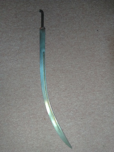

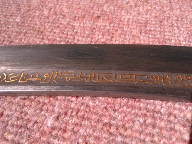

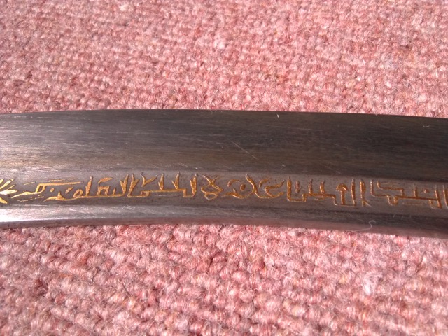

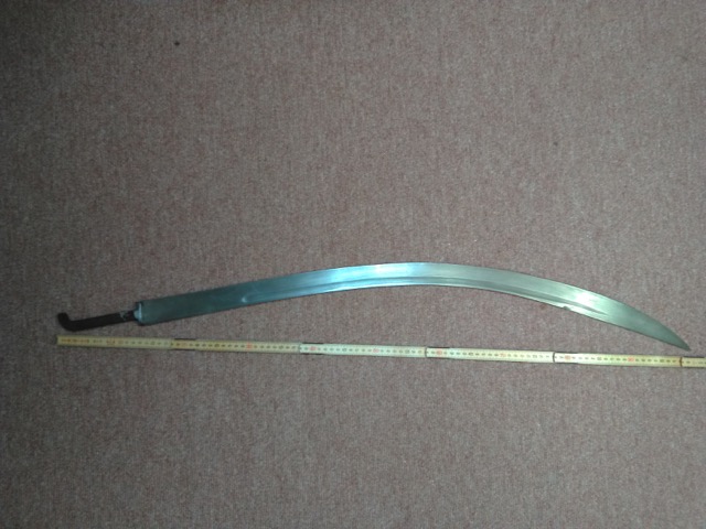

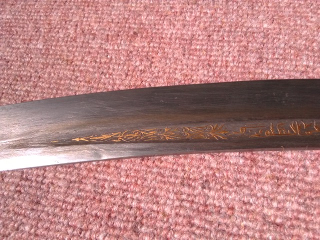

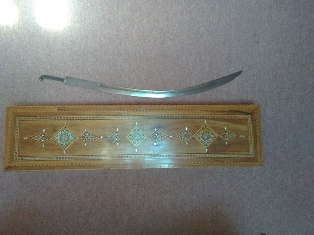

Hello everybody,
A good friend bought this blade some time ago,
a kilij ( turkish ?) shape ( I think ) but it is a really long piece !
1 meter - 39,4 inches long !
Maybe I will buy it !
Do you think its an old blade ?
Maybe with more recent engravings ?
The engravings on the blade are nice and well made,
I think the style is Kufic calligraphy
but many signs are strange/ unusual ...
so I wonder if it was really made by arabophone craftsman or maybe is it indian work ( per example ) ?

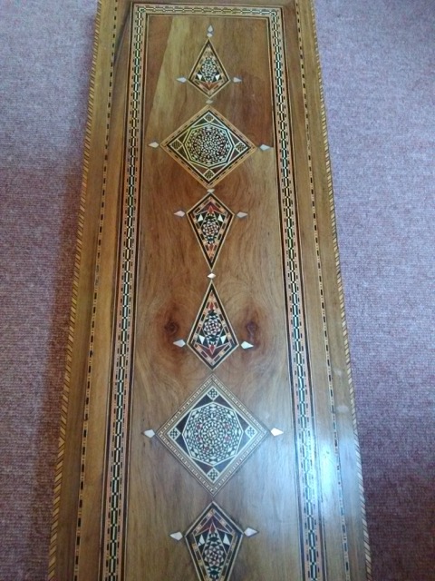

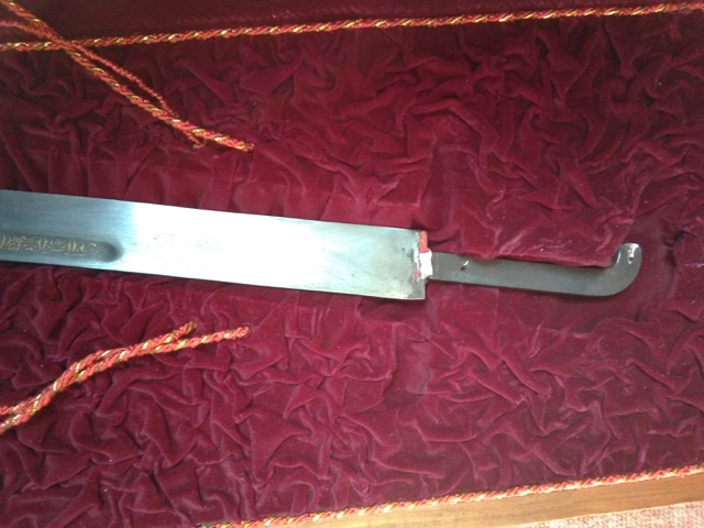

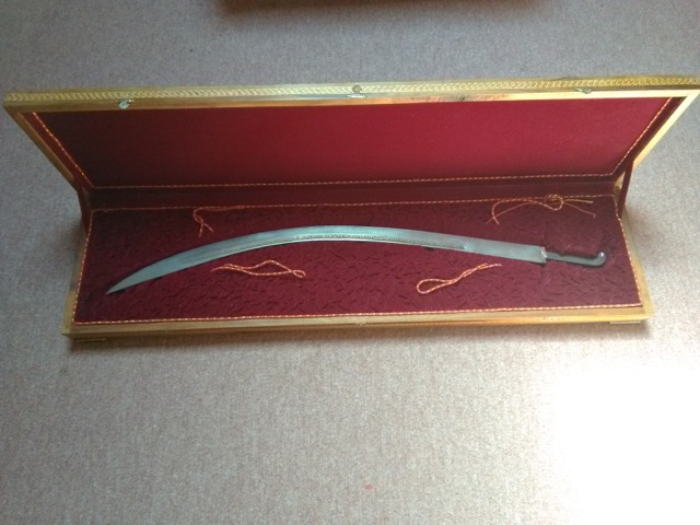

It comes with a nice wooden box,
Syrian-north african style ?
Well made too, I like it ! ( and 1m12 - 44 inches long !... )
It don't seems too old, maybe from the middle 20th century ?...
In the box, there is still the shape for put the complete sword with mounts and scabbard, more the shape of a shamshir hilt.
Where are they now ?!
The blade fits good inside, I think it's the right blade made for this box case.
What do you think ?!
Thank you

The box...

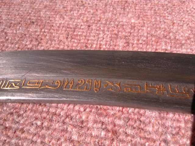

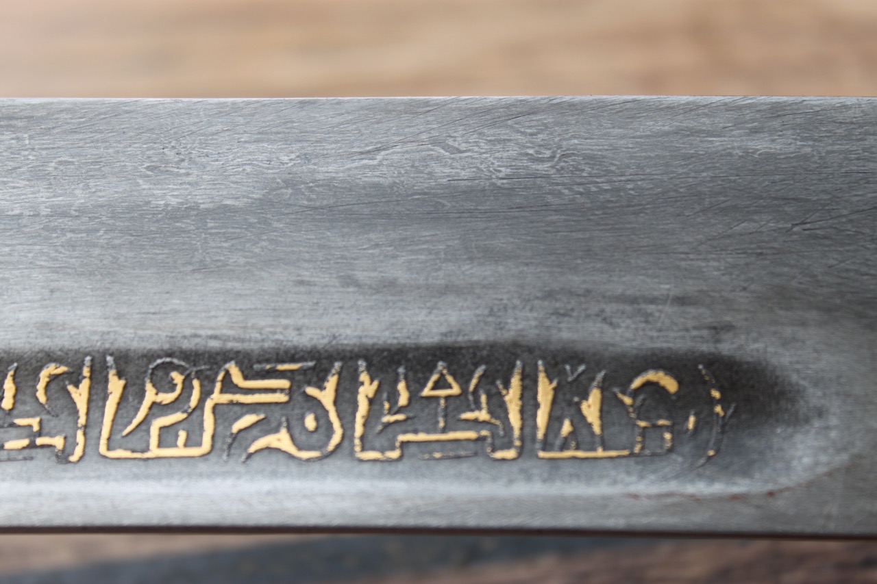

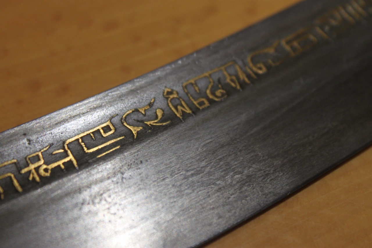

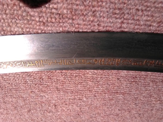

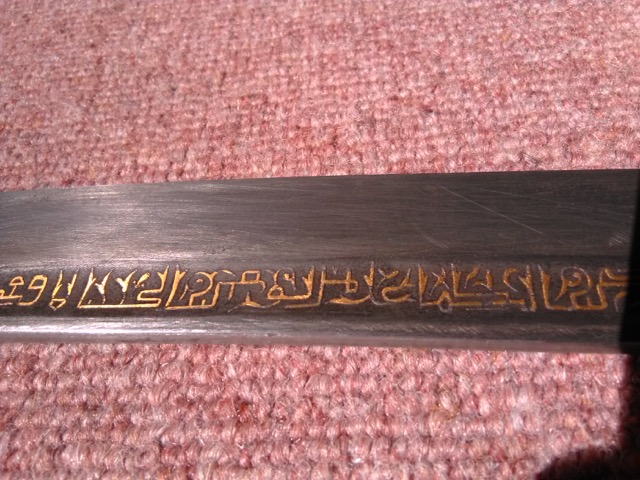

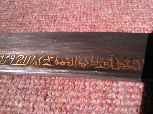

Here the golden calligraphy,
can anybody translate ?
( If possible )

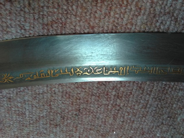

Old 8th June 2019, 04:14 PM   #5
francantolin
Posts: 973

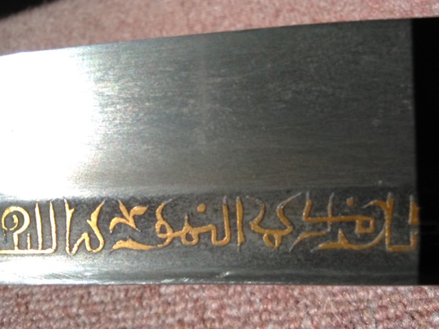

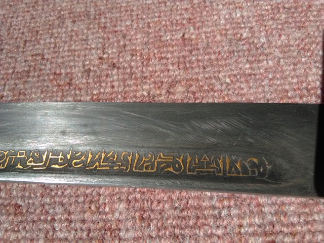

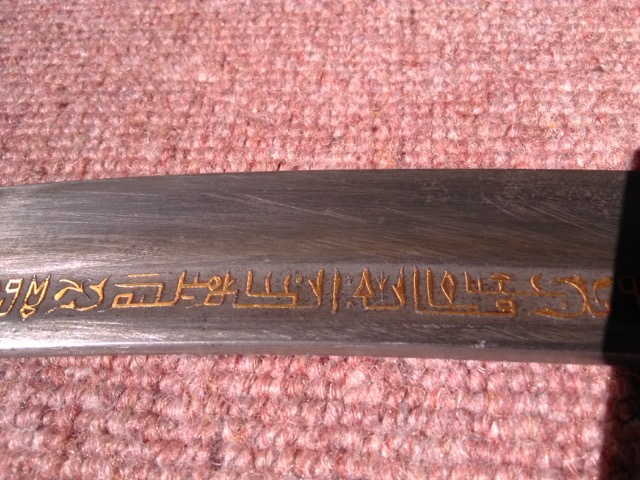

I just recognise '' Allah ''
in the center of this picture.

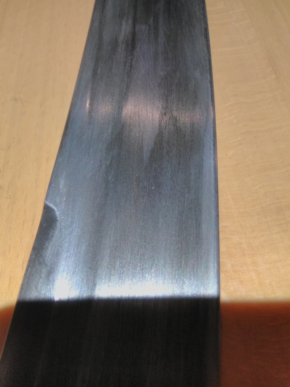

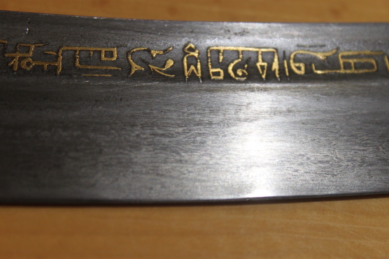

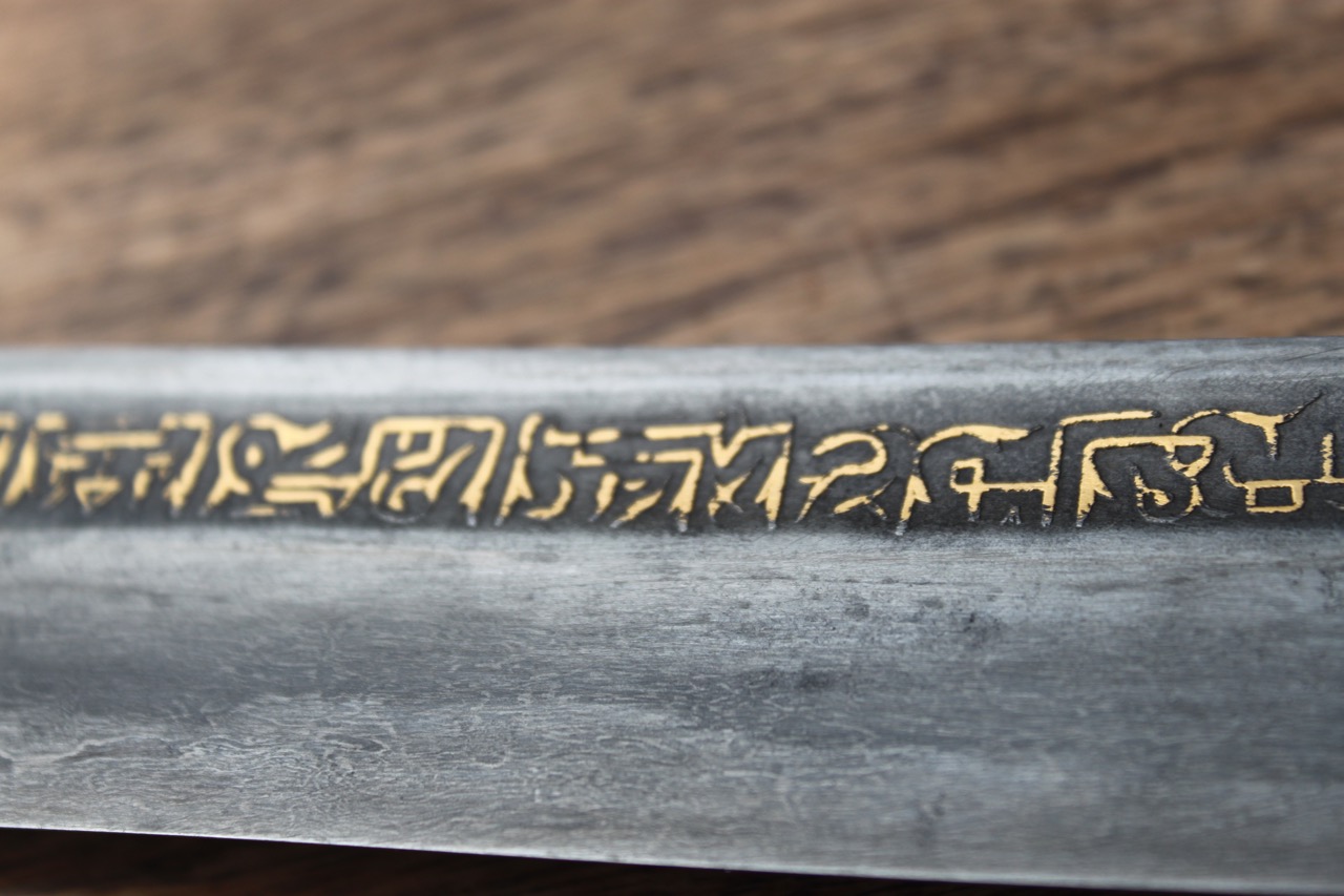

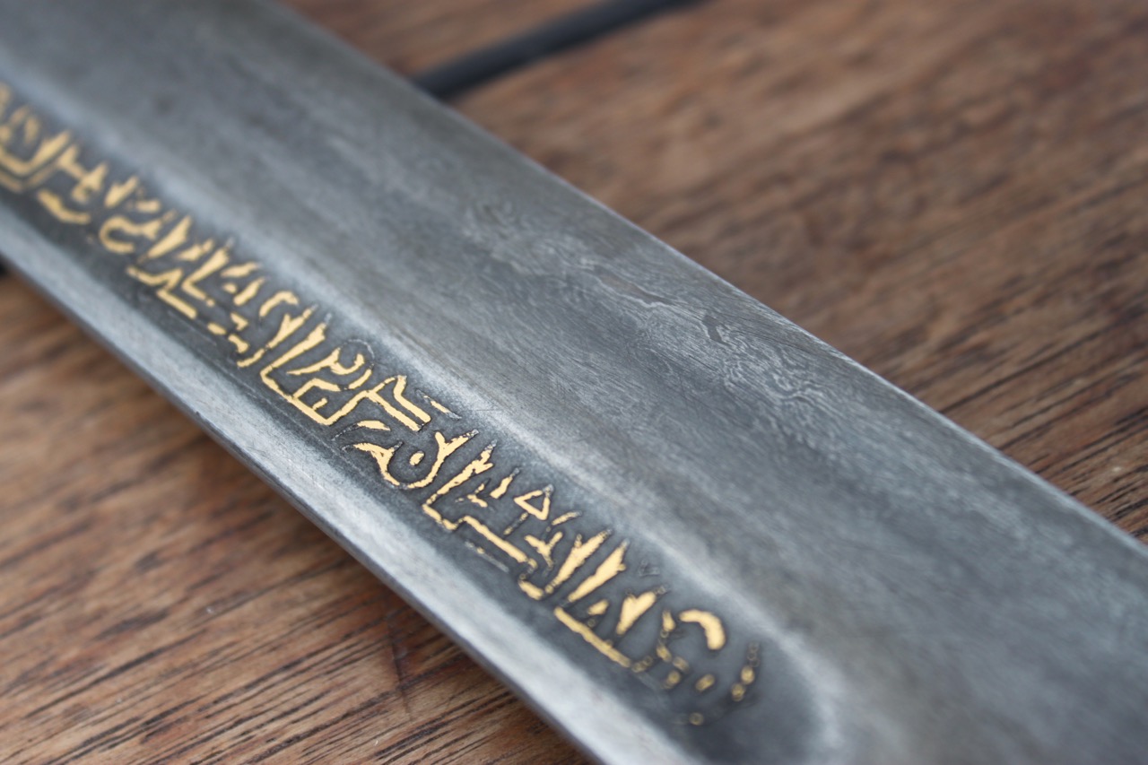

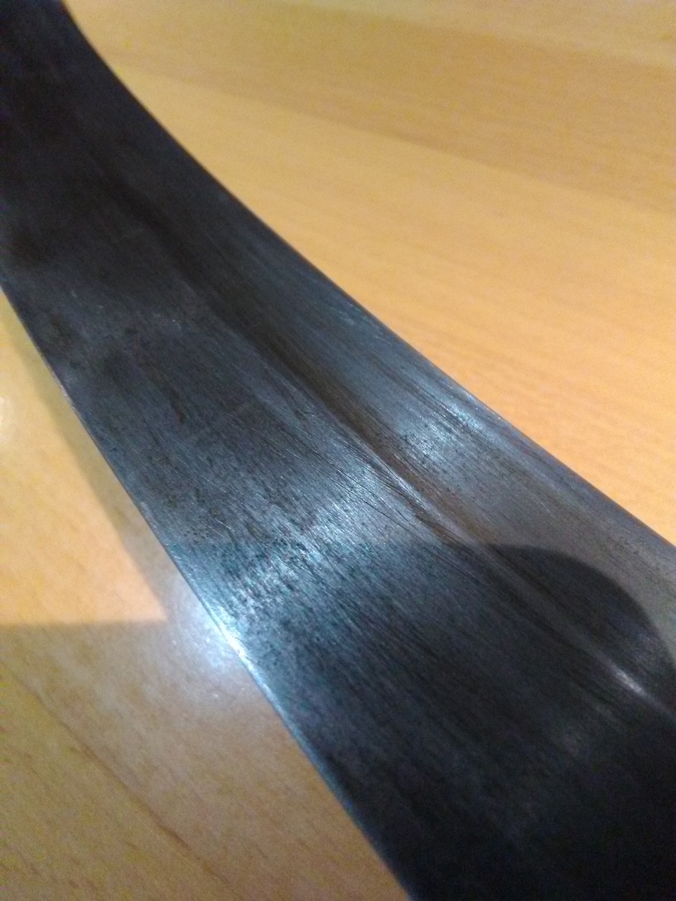

Here some closest pics,
Not to easy to do...
First I found just this kind of stripes on the blade
( + lot of scratches ... )
Old 9th June 2019, 11:06 PM   #9
francantolin
Posts: 973

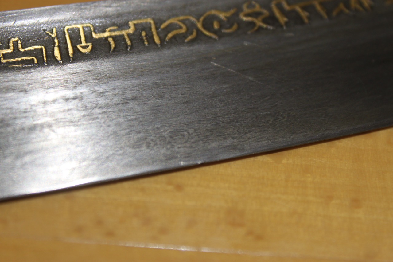

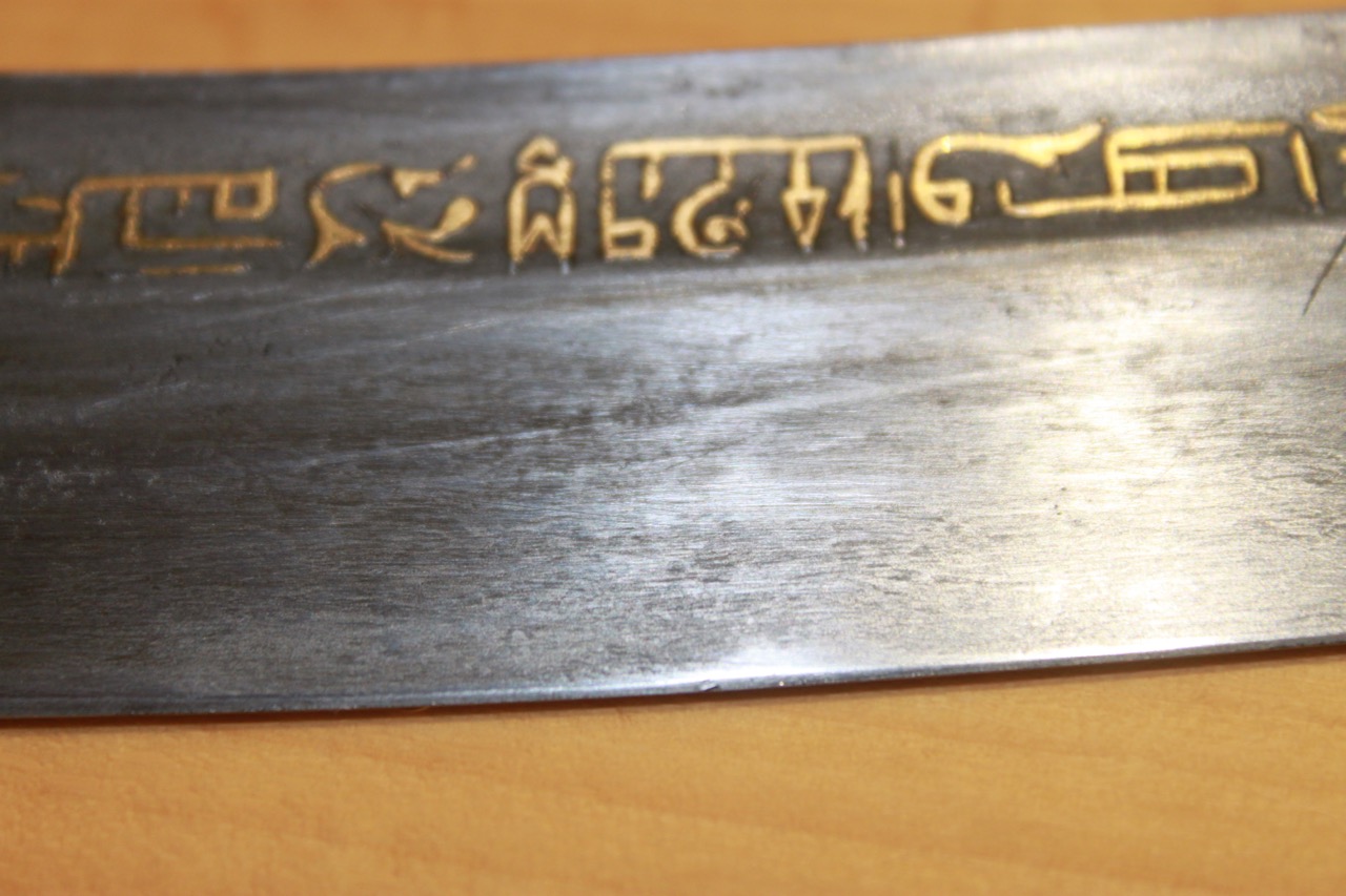

In a few places,
I found I guess a pattern...
What do you think ?

Gold looks a lot better than the modern stuff so I am not sure. Polish a small area and etch?

Last image looks like wootz, not scratches. But worth working on it!

Well, last images do show a tight wootz pattern. I know the swords you are talking about, this one is not one of them.

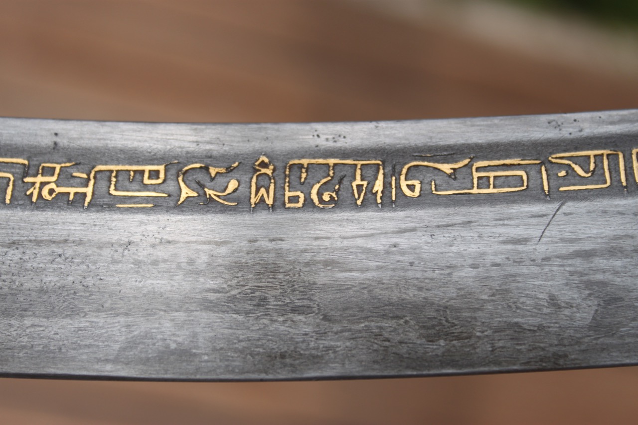

So, the blade,
polished and etched a little.
Not that bad for a scrap tourist blade isn't it !?!!!
Can someone help for exact origin and age,
would be fair !
Kind regards

Well done! could etch even better. Pattern looks Persian? I am no expert in identifying patterns but definitely well made. Inscriptions are odd. If you can send better photos I will try to read. Email them to me (check private messages)
