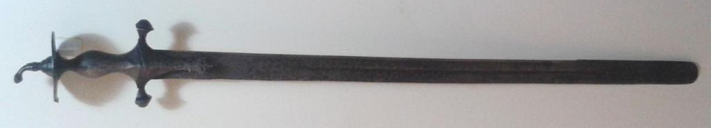

Picked this one up cheaply at auction this afternoon. Was descrbed as a 'sword', I of course realised it was more than that.
Farengi? Kirach? Kanda? Poor picture, will hopefully get it soon and get rid of the active rust and get some better clues.
Straight blade, appears to have a rounded tip, tulwar grip with curved pommel spike with a ball end.
What shall I call it?
Old 1st December 2018, 08:41 PM   #2
It is unlikely to be Kirach: those are single edged and usually ( here I am cautious) have a sharp point.
Firangi by definition use European blades , but there is too much rust to see any markings.
Thus, I am torn between Khanda and Tulwar.
However, here we get bogged in the linguistics. There are far too many languages in India and different ethnicities called the same things differently.
In a way, it is like asking what is a correct name for “ a sword from Europe” , a place roughly comparable in size to India, but infinitely poorer in the number of languages used. Sword? Schwert?Spada? Kard? Espada? Epee?
In the new Elgood’s book he shows blades he calls Khanda, but whose appearance is totally different from the “classic” khanda blades as per Rawson or Egerton. And, by the way, locally produced “ Firangi”-type swords were called Dhup and Asa Shamshir depending on their locality.
I would clean yours, hugged it and kissed it, and I would call it Khanda. If I am wrong, it would take it no more than couple centuries to accustom itself to a new moniker:-)
The curved pommel projection is ( also per Elgood) compatible with 17th century.
Hope it cleans well. I love those old and unpretentious things that saw a lot of battlefields but nary a single palace wall.

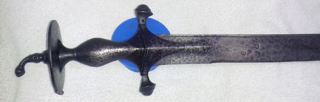

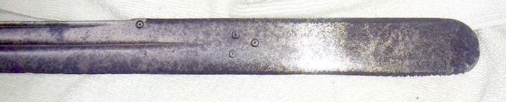

Gets more interesting. Scotchbrighted the blade to get off the red stuff, found another set of 3 dotted circles in a triangle near the blade tip either side. Also found a row of approx. 10 smaller dotted circles almost on the blade edges, almost touching each other, disappearing under the resin holding the blade.
the cross-guard and grip section appear to be in two pieces. they have a line of sheet metal between them, the cross-guard on the side where I thought a finger bow guard may have attached doesn't look like anything was. that one has a flat spot from the remains of the sheet metal to a square corner, also on the upper squillion. Looks almost like a bowl guard was once there behind the cross-guard. Like this fancier one I found on the internet:

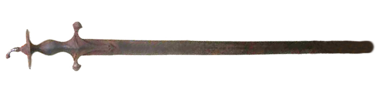

Aa few better ones, red stuff removed and oiled:

Is there a hole in one of the quillons?
All the dotted circles are a riddle to me, but the hilt looks a bit like the hilts used by the Talpurs of Sind, although I doubt it is from there.
How broad is the attachment of the hand guard at the disc?
Old 6th January 2019, 04:47 PM   #16
Hole:Yes. A tiny one. looks drilled. Goes all the way thru.
Attachment to pommel disk/guard looks like 1 in.

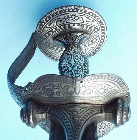

The hole could be for a pin attached to a short chain attached to the scabbard to make sure the sword stays in the scabbard.
I have seen this on jade daggers - see below, but I have never seen this on swords. Sword scabbards often have a loop to keep the sword in place - see below. Mostly the loop is broken off, and only the 'fish tail' remains.
