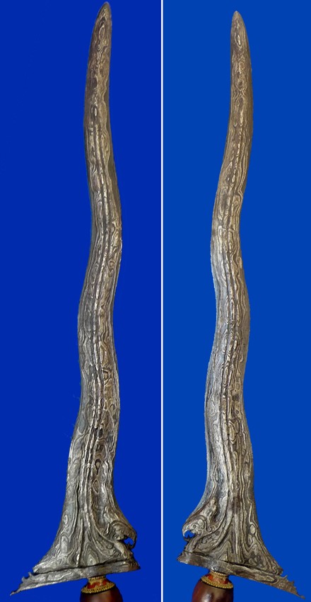

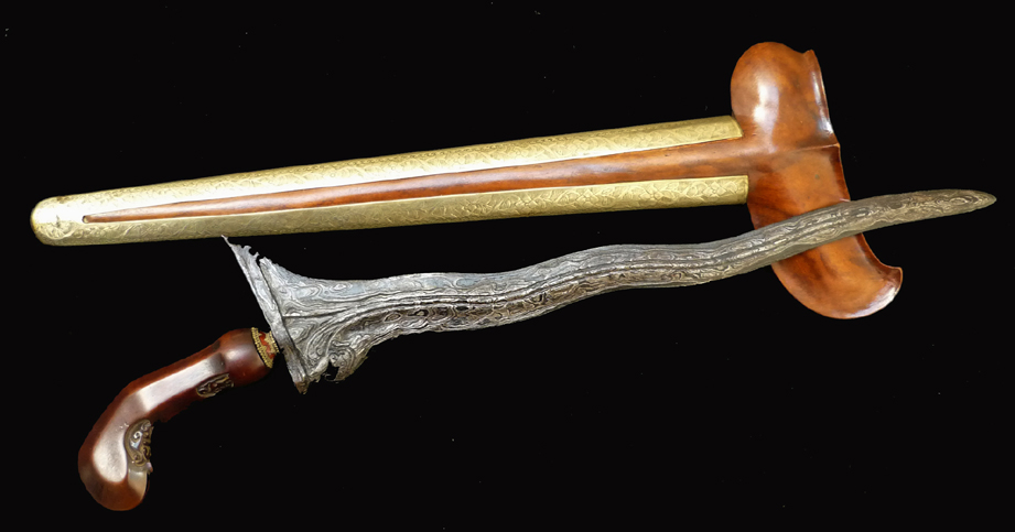

Shown is a blade with Ngulit semangka (Nggajih) pamor and suppose this blade is from Madura. The dress looks more like a Solo sarong with good fitting.
Is this dapur Anoman? The carved winged Singa could be an additional carving of more recent age? Are there 2 sogokan or is this kind of a Naga body ?

Hi Paul. I can't tell for sure from your photos, but that does look like elongated sogokan to me. Like the "winged" carving i am not sure if they are original to the blade though.
As for the "winged" carving, this is also a bit difficult to make out in your photos. In hand this is probably much clearer, but i do see what you are perceiving as "wings". However, this would not be a Singo. If indeed i am interpreting this correctly it would seem more likely to represent a winged elephant. I have seen such representation on keris before and in fact have a blade with a much more obvious carving of a winged elephant in this position on the blade.

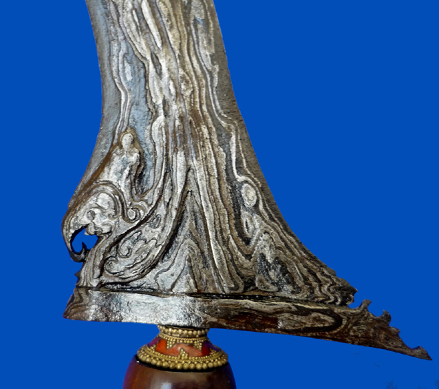

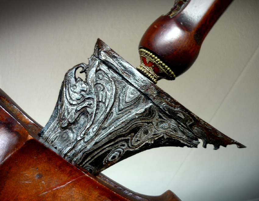

Yes my bad...I meant a winged and crowned elephant.
This pic shows the details more clear.

When taken together, couldn't the elongated sokogan and winged elephant be taken as a representation of paksi naga liman?
Liman = elephant, paksi = bird, and the long sokogan would symbolize the naga's body.
As to whether the carving is recent or not, I wouldn't care to venture.
Can I ask, why do you assume the wilah is from Madura?
Personally, I still find it difficult to tell which blade is from where. What I know about Madura blades is that their gandhik tends to slope inward, and that they often have a wispy telale gajah. I have difficulty recognizing those traits in this particular blade. (But as I said, I am quite bad at that.)

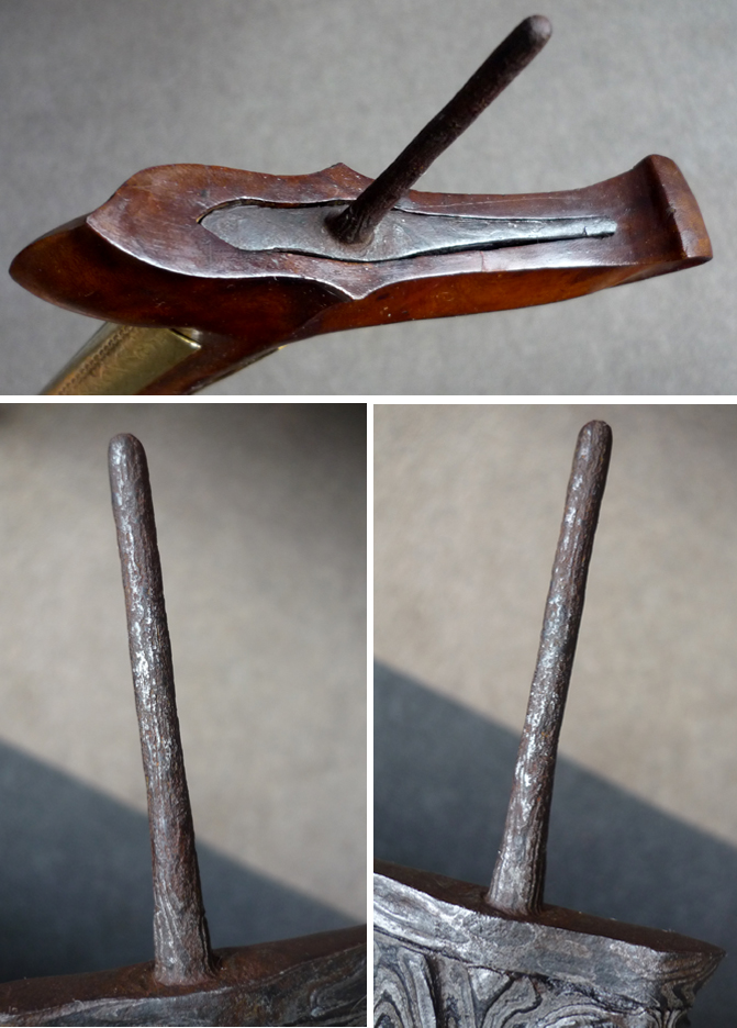

You may learn from the peksi? It is not as massive as you might think ( wide base of the ganja).

Paul, with my apologies, "peksi" is Krama for bird, "pesi" is an alternative spelling and pronunciation for "bird", brought about because the "k" in "peksi" is a glottal stop and is not usually heard by a non-native speaker.
But the word for a blade tang is "pesi", it is never "peksi".
I know that we find "peksi" as the word for "tang" in many places.
They are all wrong.
Looking closely at your photos of the gonjo area, it appears that the gonjo might be held in place with adhesive rather than by a metal to metal fit.
Is this so?

As far as I can see it is metal to metal fit.

Paul, you have it in your hand, I only have photos, but it looks to me as if there is an adhesive between the blade base and the gonjo base, and that there is also adhesive between the gonjo and the tang. The adhesive that is commonly used to fill these areas is normally a two part resin such as Araldite, mixed with iron filings or black artists colour.
We normally test if adhesive exists, with a needle, sometimes it is necessary to heat the needle.
This adhesive fill is common, even usual, for a very old or worn blade, it has been used in Jawa since two part resin became available ---1950's? --- its purpose in an old blade is to prevent further deterioration, and in an old, worn blade it is regarded as quite acceptable.
However, since about 1980-'82, it has also been used by some new makers as a shortcut to fix the gonjo. This blade of yours is not old, I cannot see a key used in the gonjo fit, the other acceptable way of fitting a gonjo if no key is used , is to work around the pesi and tighten the gonjo metal with a hammer and punch, this is easier and faster than using the key method, but it normally leaves punch marks on top of the gonjo and around the pesi. In the photo I cannot see these punch marks.
Because I cannot see the expected evidence of a metal to metal fit, my suspicion is that adhesive was used to fit the gonjo. If you have tested as I outlined, and there is no adhesive, then I still have no idea of exactly where this blade might come from. However, if there is adhesive, and especially if that adhesive is between the pesi and the tang, then this blade is most probably a recent Madura production, say, within the last 40 years.

Thanks, I tested it with a red heat needle and just some old dirt came out. With a magnifying glass I saw the metal to metal contact.
