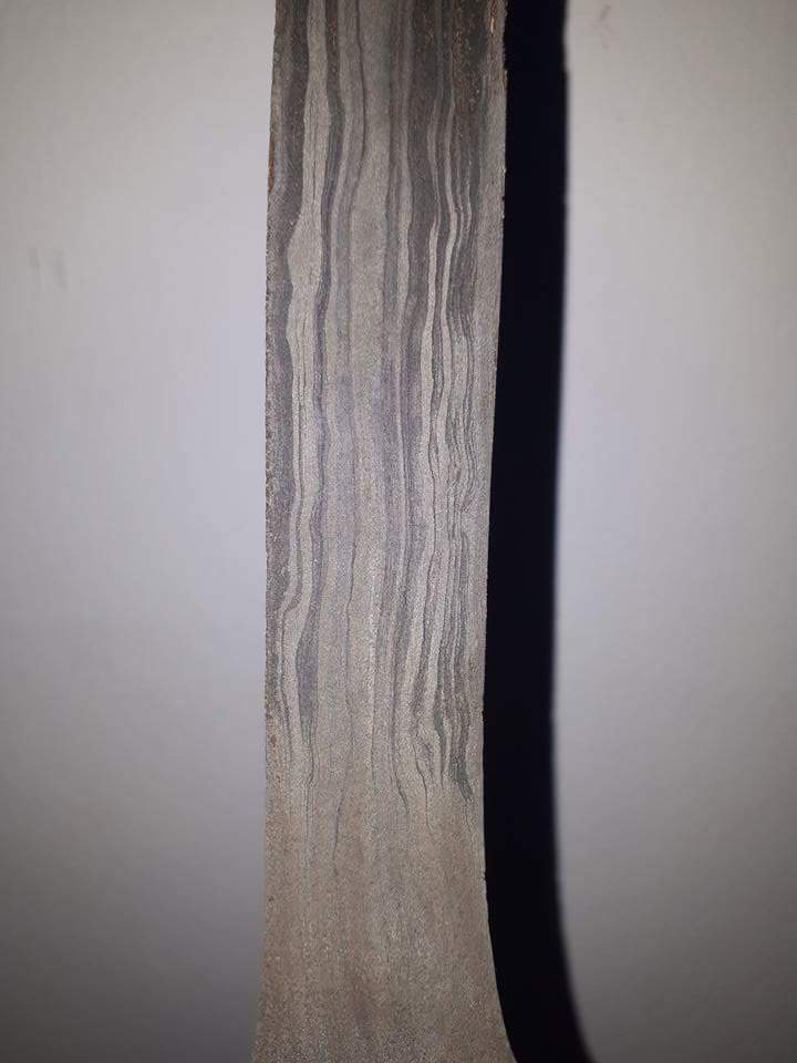

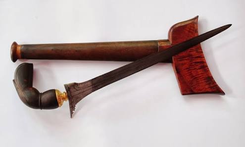

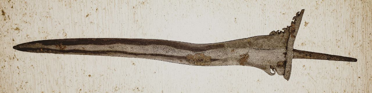

Sepuhan or ipuh in a keris
There are some variations in regards to applying sepuhan/ipuh in a keris blade. The most common sepuhan usually done from above the sor-soran to the tip of the keris which resulted in blackish coloration along the sepuhan part of the blade (as shown in the keris Bugis picture here). But there are also keris which are given sepuhan only on the tip (as shown in the keris Minang picture here). However, the common sepuhan which is done from above the sor-soran to the top can sometimes also bear different characteristic of coloration on the blade (as shown in the keris Pagaralam picture here: ribbon like pattern from above the sor-soran to the middle of the blade and blackish from the middle to the tip).
I also attached a page taken from a book in regards with "sepuhan" process in the keris making. It says that sepuhan may also be done using poison taken from various plants (called "sepuh racun") or using venom/poison originated from various animals (called "sepuh upas"). However, this is maybe a subject to dispute since "upas" itself leterally means a species of poisonous tree (Antiaris toxicaria) which is known to be used in Java (and maybe also in the other part of the archipelago?).
Also, the existence of a poisonous keris is always a subject to debate. Moreover, if the process of infusing the poison to the blade is done through "sepuhan" which involves very high temperature, enough to denaturate proteins found in the poison or venom originated from plants or animals.
It left us some questions:
1. Why there are different types of sepuhan in the keris?
2. What is the actual purpose of this "sepuhan" process in the keris making? Is it having the same purpose as "quenching" in the blade making or is there more purpose to it?
3. Is there literally exist a "poisonous keris"?
What is your view on this matter? Please let me know in the comment below.

Hi Oracle. I was waiting for someone like Alan to come along to address your questions since he has far more experience in processes of forging than i do. I am sure if i get some of this wrong either he or someone else will correct me.
As i understand it sepuhan, when the word is applied to the keris forging process, it is the method of harding the blade to make it usable as a real weapon. Quenching would be the first part of that. Then the blade would be tempered, reheated at a somewhat lower themperature, to soften the hardening a little so that the steel is not so brittle and doesn't just crack in use.
These are different blades done by different smiths from somewhat different cultures at different times so it is not surprising that each smith applied this process to different degrees. Some may have felt that just hardening the tip was enough while others went further down the blade. Most keris smiths these days don't bother with this hardening process at all since there is always the risk of cracking and failing welds when to is applied. Since most modern keris are made to be seen for their artistry, not used as weapons, the hardening process becomes a risky and unnecessary step.
I see that you are still wondering about the concept of the poison keris. I believe the first thread you opened specifically on that subject answered those questions for you. Alan stated that he was aware of such a process down with snake venom i believe, though i do not believe it was commonly done with most keris.
Again, any poison that is added and then heated to a high degree in the hardening process would only be made ineffective by that process of heat. If people are saying that such a thing was done it is probably more legend than fact, or if it was done it was a useless procedure because the science of it would be faulty and invalidate the effects of any poison.

I'm not at home David, moving around a bit, and pressed for time.
Different makers, different times, different objectives.
As David has said, to make the blade usable as a weapon, however, a keris is not drawn after the initial quench, the fact that it is a laminated blade and that the iron/nickel pamor does not harden during the quench protects against fracture in use. Ferric material needs to contain carbon in order to harden. Steel contains carbon, iron does not, neither does nickel.
Any non-sterile keris plunged into your guts will poison you.
I have never heard of a sterile keris.

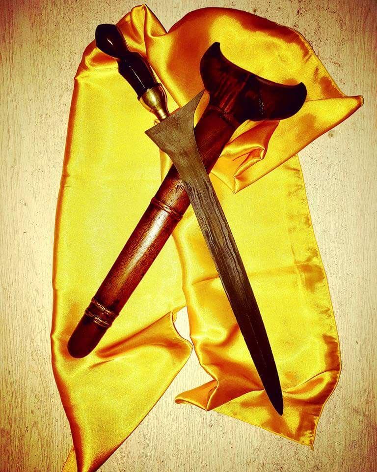

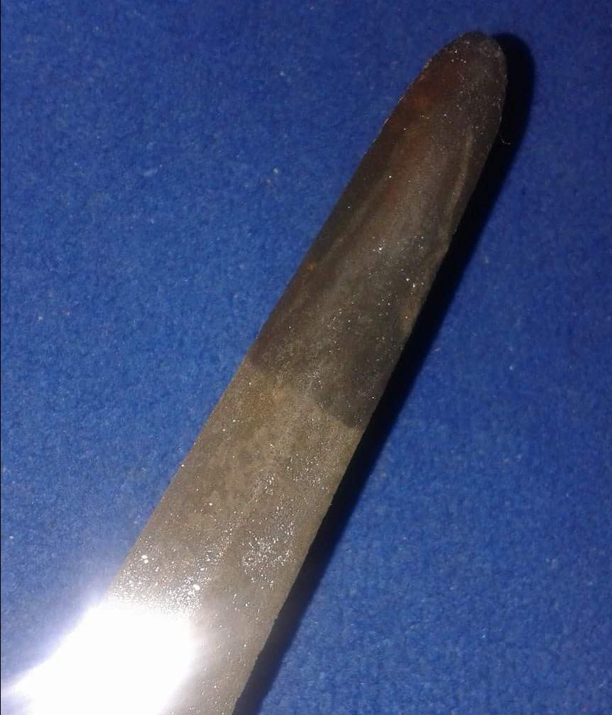

Default Small (dress?) Keris Minang with sepuhan on the tip
Hi David & Alan, thank you for your explanation.
By the way, the keris Minang pictured here is actually small one (the blade is less than 25 cm in length) and it got sepuhan on the tip part of the blade.
I have seen the previous thread which discuss the small keris or called keris selit in the Malay culture which is functioned as dressing companion. But judging from the sepuhan exist on the keris that I've shown you, is it possible that these small keris may have practical function (eg: as a weapon)?

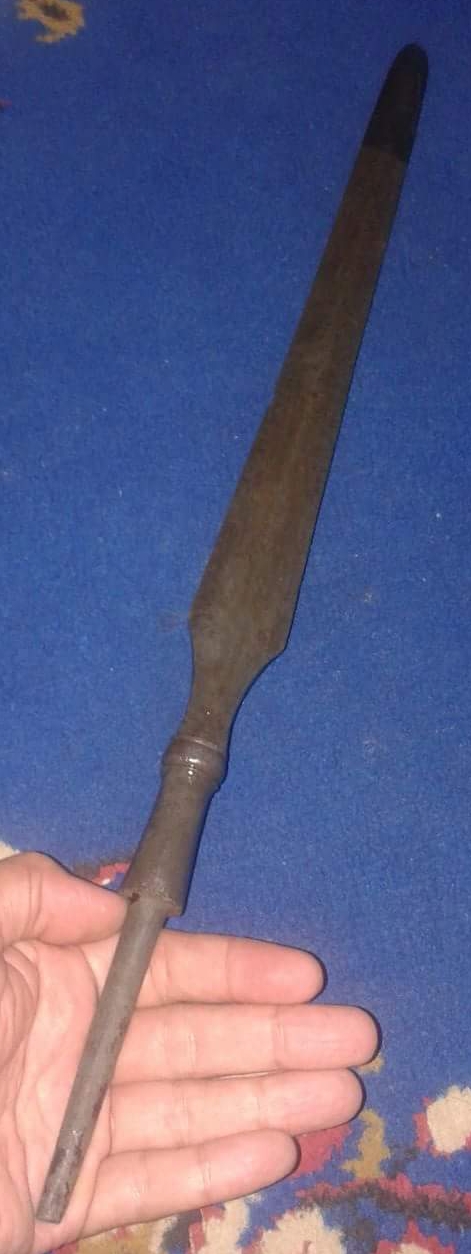

I also attached picture of a tombak from Palembang with sepuhan only on the tip part.

Hi Oracle. AFAIK Keris selit is specific certain areas of Malay culture. Minangkabau culture is distinctly different from the Malay cultures of the Peninsula as well as other cultures on Sumatra. I do not believe they have a tradition of keris selit as a dress function. From my understanding Minang keris tend towards the shorter side.
Keris are stabbing weapons so the most important area of the blade for harding would be the tip.

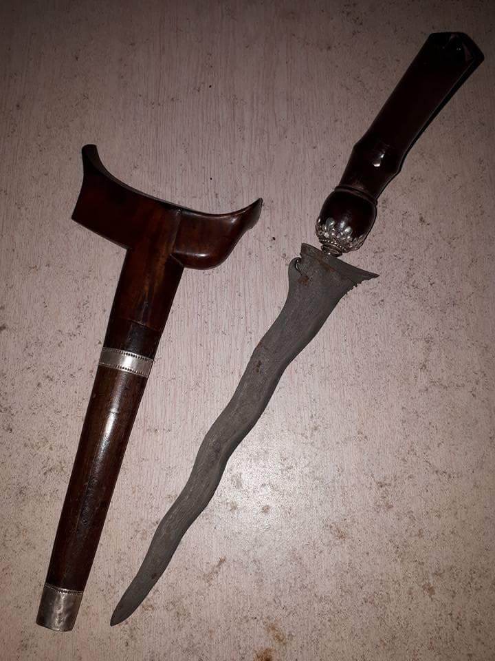

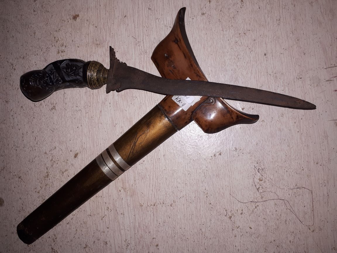

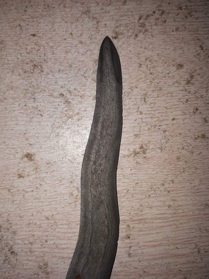

Hi Gustav, I want to show with you another example of keris Minang which has intrigued me in regards with our discussion about the practical function of sepuhan and therefore, its existence in small keris particularly in Minang culture (and whether or not it is separable from the Malay culture in general).
Attached, I sent you pictures of a keris Minang with small size with blade length just about 20 cm (actually it fits exactly the length of my palm). After I clean the rust with coconut water, it appear that this keris is constructed from different kinds of steel: pasir malela steel (or "bunga garam") along the center part of the blade and the ganja; then malela steel or "besi miang" along the edge part of the blade. It is also given sepuhan from the part above sor-soran to the tip.
Given the complexity of making such a small keris, maybe it really serve a practical purpose? So not just as a dress keris.
