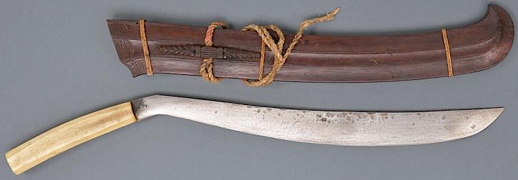

I'm adding a pic of another odd Waray blade that I acquired recently. Again with original Waray scabbard (with a somewhat similarly curved tip); the weird bone hilt might well be a later replacement though.
