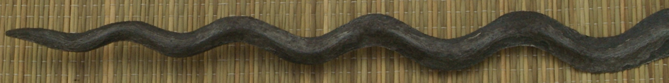

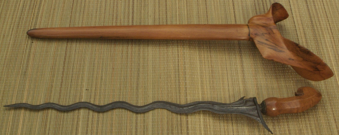

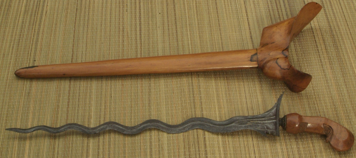

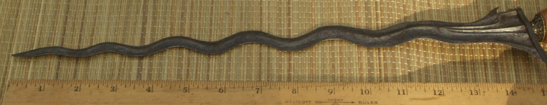

Without further input from me, yet, what do y'all think:

nice keris and sarong.... ganjawulung maybe from another blade
Old 1st March 2018, 04:37 AM   #3
Posts: 7,267

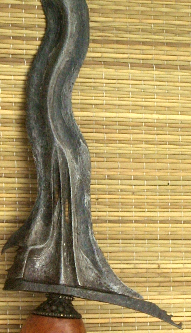

Marco, these are not the best images to make any assessments by so i've tried to make this image more visible. I am wondering why you think the gonjo might have originated from a different blade. Is it that it appears to have a slightly darker in color?

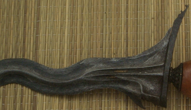

No David, first of all I suppose the gonjo is ganjawulung but not shure (maybe with cleaning and warangan process the pamor rises up). I suppose that gonjo comes from another blade because near greneng there is (IMO) a little not harmonious piece with the beginning of the right part of the blade

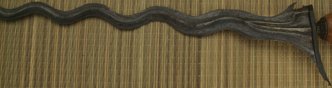

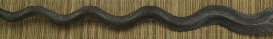

I'm working on cleaning, etc., and getting some macros snapped. The ganja appears to me to be wulung, but I'm not sure if the gap is due to a mismatched replacement ganja or to the blade shrinking more with repeated treatments. Note the two combongs.
I've been trying to find a literature citation for the supposed edict of Sultan Agung calling for replacement of pamor ganja with wulung, that I remember being told about once. Anyone have a reference one way or the other for that?
I'm fairly satisfied that the dapur is Sengkelat. Any disagreements with that?
Anyone have an opinion on the pamor?

That's a nice old soldier for sure Treeslicer that has seen a lot of years and a lot of washings. As you point out, the combong attest to this age and wear, but it still shows itself as a well formed blade despite this erosion. I don't think anyone will argue about dhapur sengkalet at this point unless better photos reveal something we are not seeing. I wouldn't even begin to assess pamor until this keris receives a good washing and hopefully warangan. Hard to tell much otherwise.
