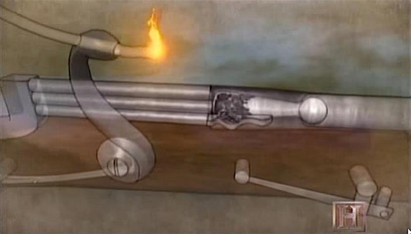

The breech on yours seems to be the same pear shape as mine - but in the opposite direction ???? I honestly don't know what to make of that. You just have to wonder what some of their thinking was??
The breech on my barrel seems to be designed just like the photo here from the YouTube vidio.

By the way, do you think the picture posted here, showing the inside of the bore originated from a European matchlock design ?
If you've seen the YouTube video "Mughal Matchlock", they cut the breech of a Torador breech lengthwise. But the only show it for about 3 seconds. But it does show the design similar to the above photo. Which seems to duplicate my barrel.

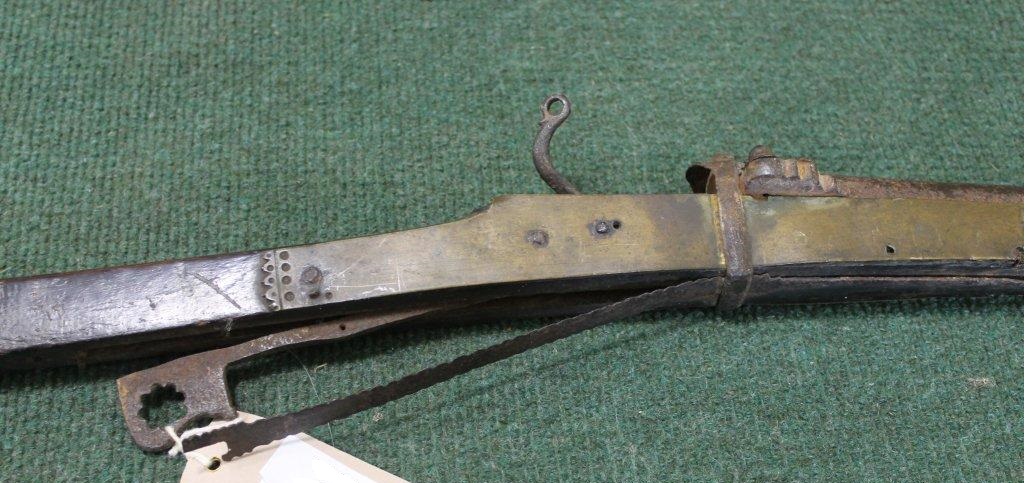

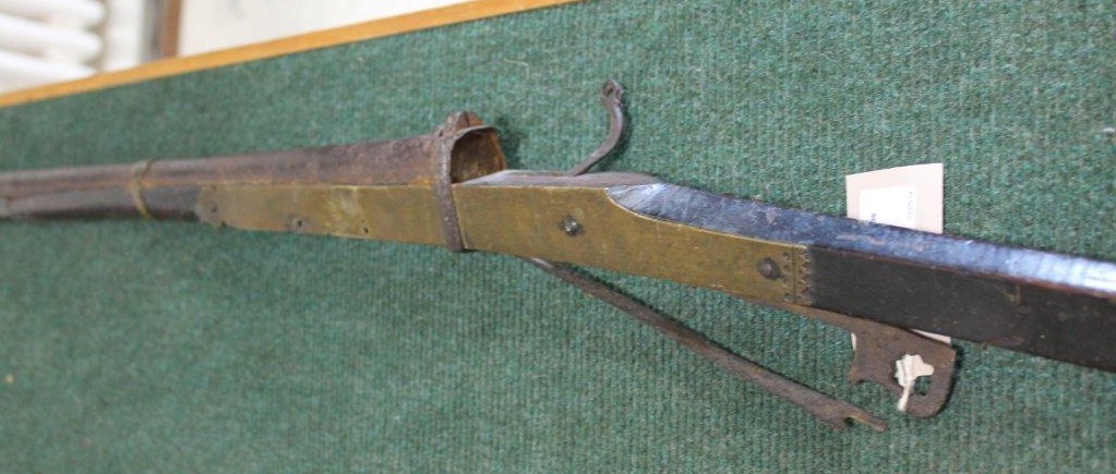

These are the seller's pictures below;
My camera still hiding.
The stock is So slim that it's just about not there at all!!
Richard.

Thanks for posting pics of your Matchlock. Yes, that would be a tough job with the bore not having a removeable breech plug. But the gun definately looks restorable. There appears to be a missing piece of wood behind the breech area of the stock. From the photos, it doesn't look broke. Just missing. Originally, maybe a different colored piece of wood, maybe with a horn cap ? Or maybe one piece of elaphant ivory somebody removed But I don't notice any holes in the bottom section where nails or pins might have been (?). Anyway, be careful with that forearm. Sounds like it might be delicate.

Yes, the fore-end is like paper it's so thin!
I too wondered about the missing block behind the breech, as there are no holes where pins or nails held it in place, and no signs of glue either!
Looking at the sideplate, I can't see where a match -holder was located, so think it may have had a hole in the rear end of the missing block.
Any ideas of age on this?
Also usage?
I Think possibly made for sporting use, as it is a bit thin and delicate for warfare. (Think!)
I do wish these were easier to date, but looking at it overall, and the shape of the (very thin) sideplates, I Think late 18th C.
Again just think and would appreciate your thoughts.
It seems a book could be written about these. A book with actual facts that is, And dates for specific changes over the centuries.
Yes, I know it may never happen, and one has to look at lots of photos to try and figure out the finer details which often vary over the sub-continent.
