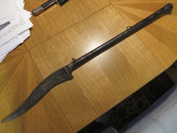

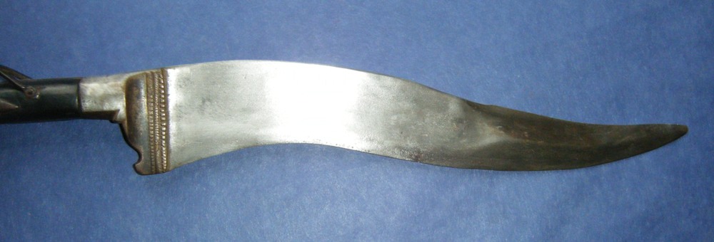

Hello dear members,
just have bought this polearm, I think it's a Bhuj from either Sind or Kutch but I am unsure. The examples I found in the net or at other places have had a pole grip from metal. It's 90 cm overall, more I can't say until I have it in my hands. The pictures are from the seller. All informations and comments are very welcome!

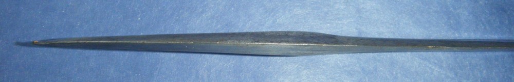

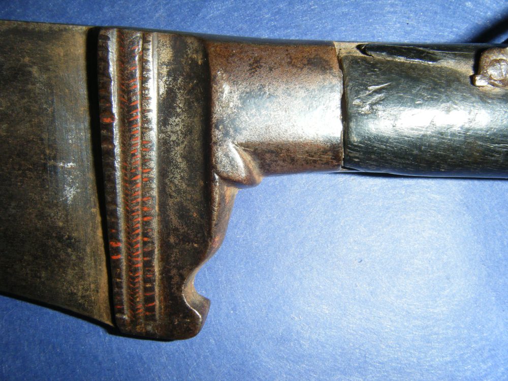

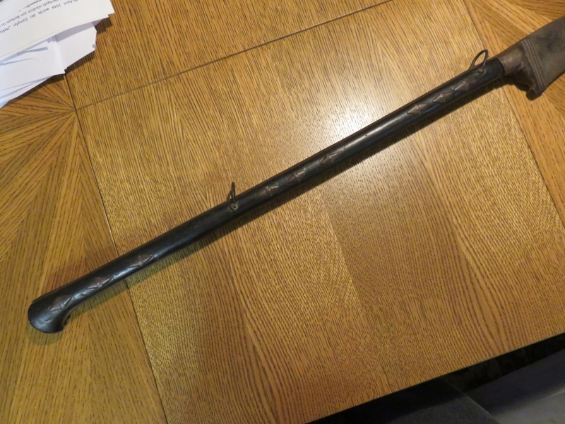

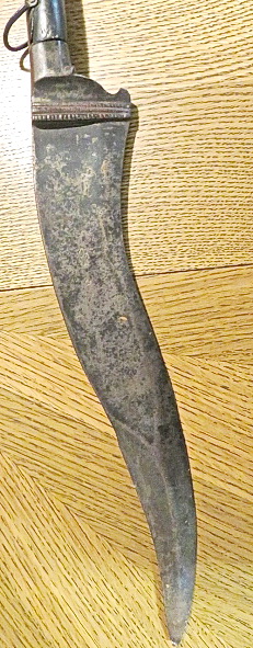

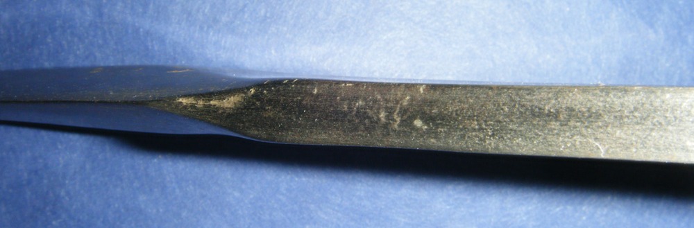

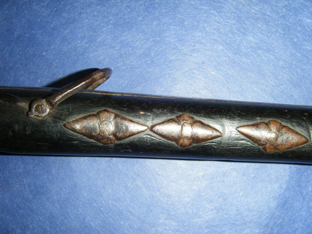

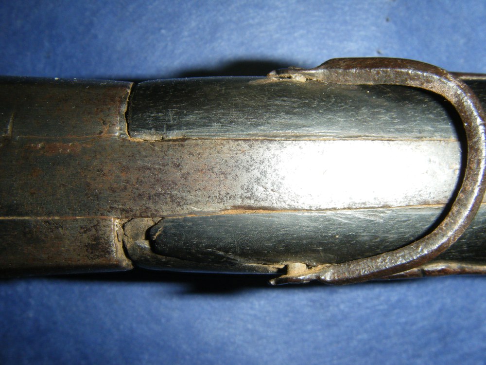

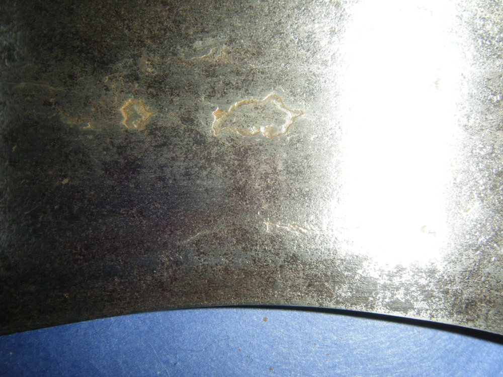

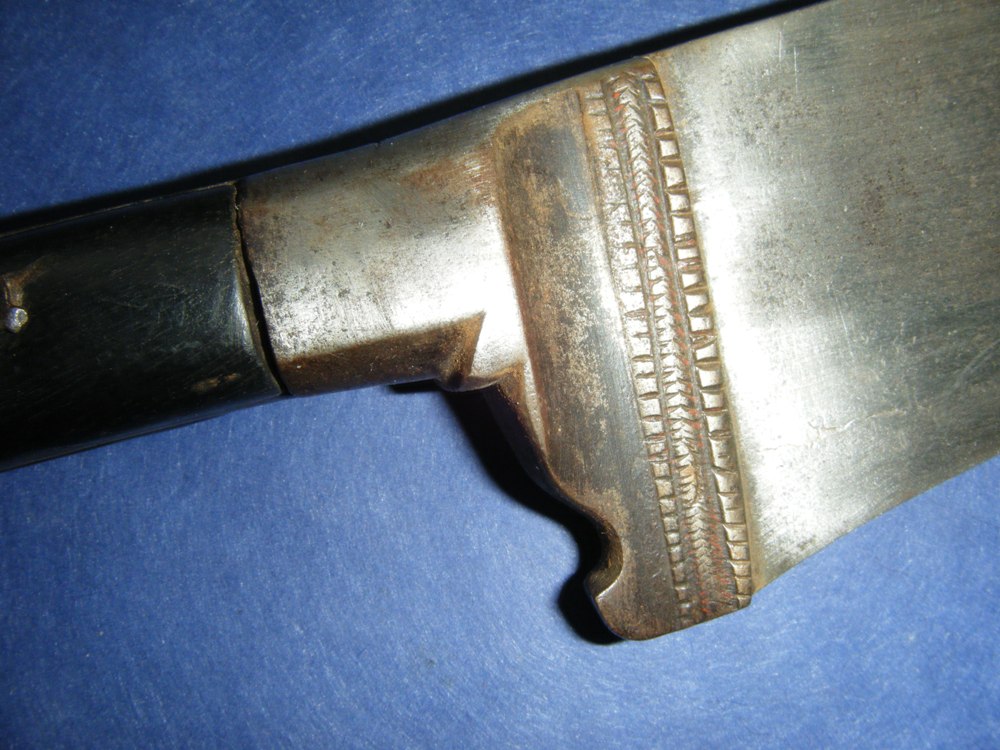

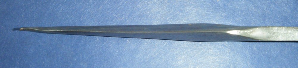

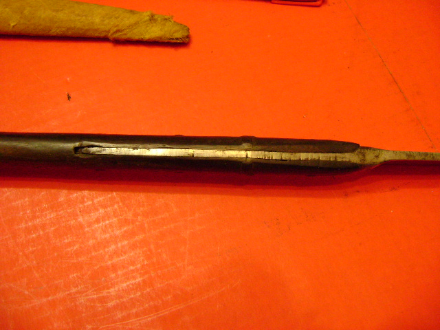

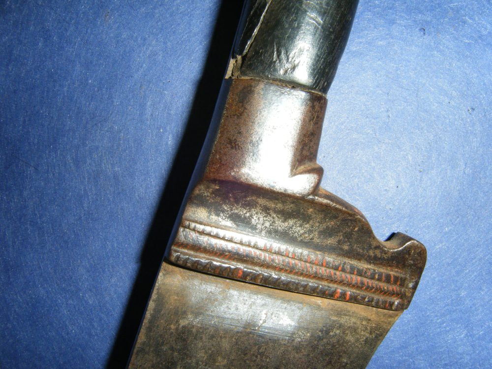

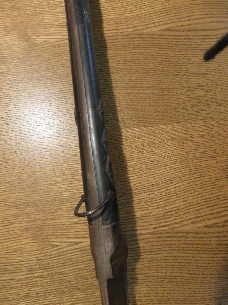

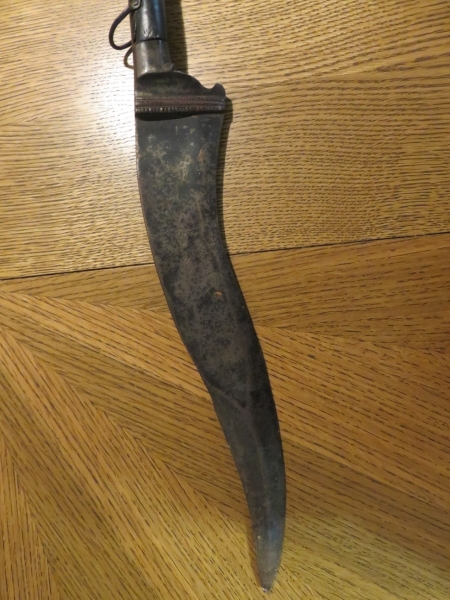

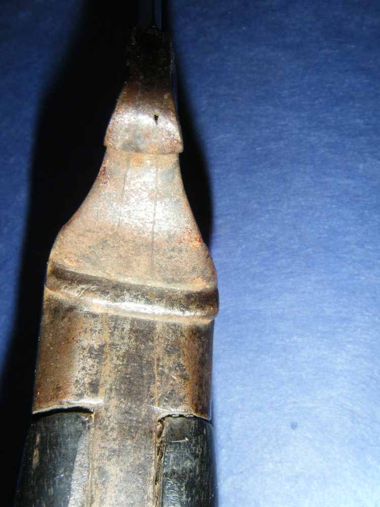

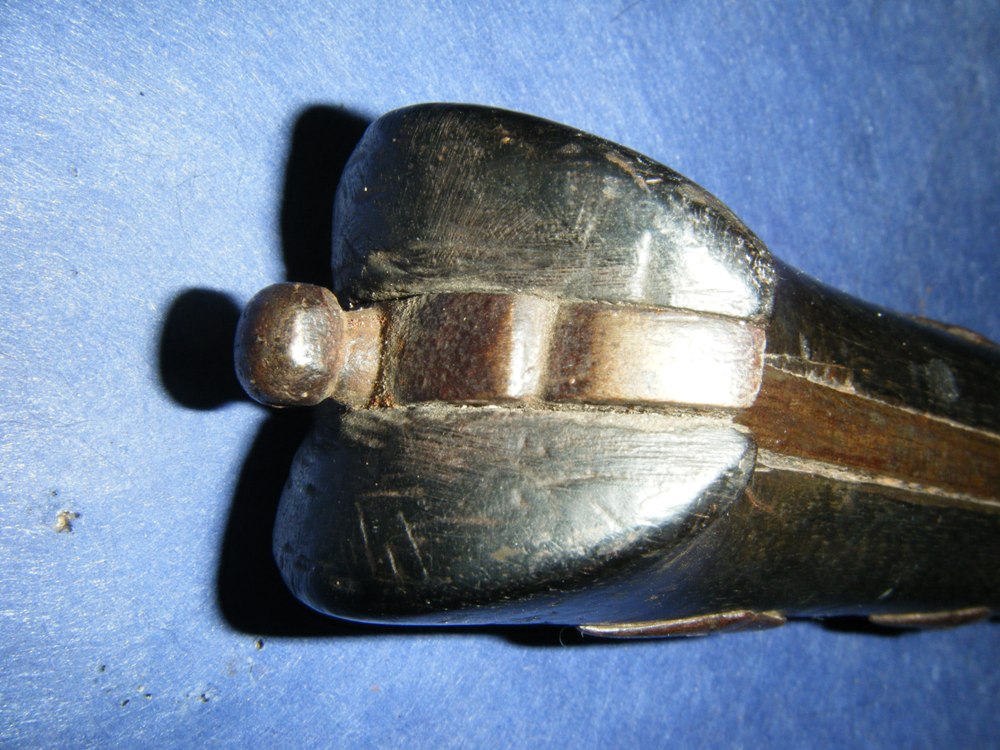

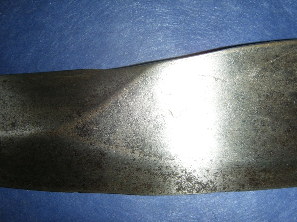

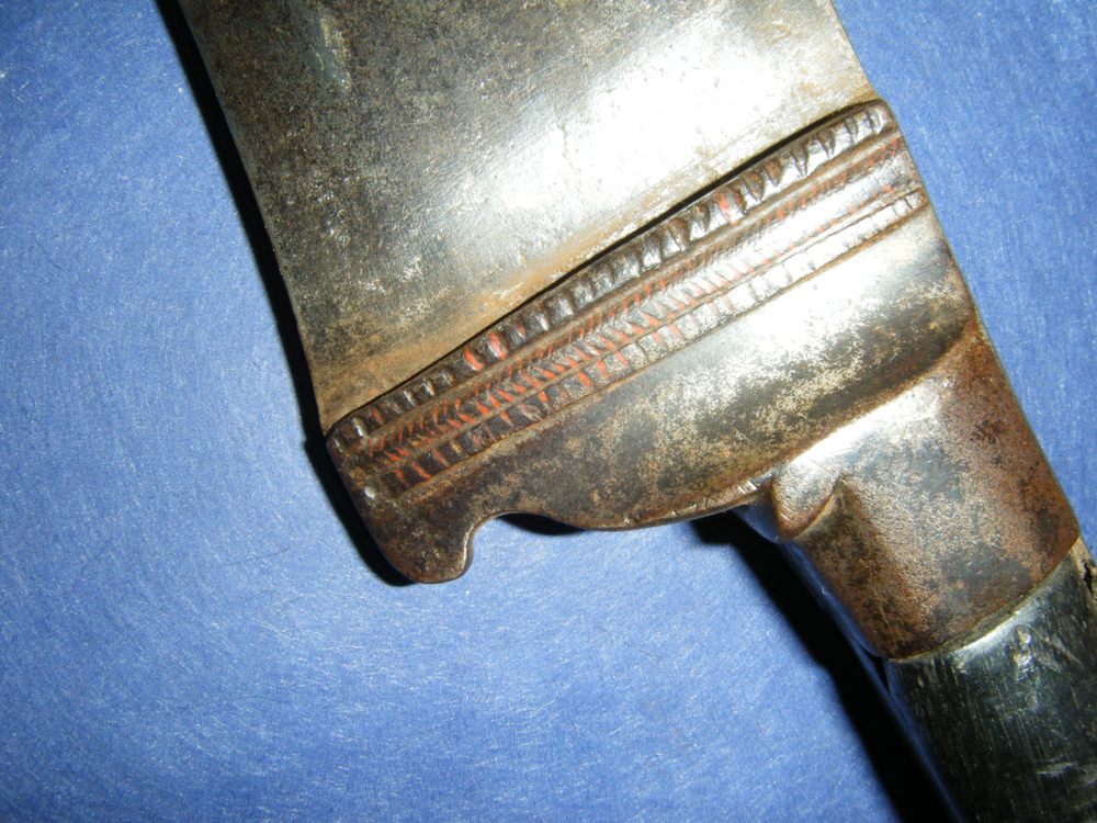

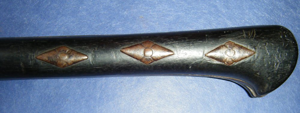

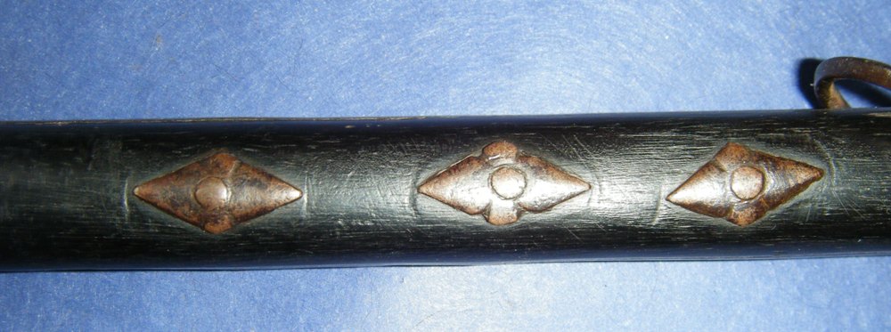

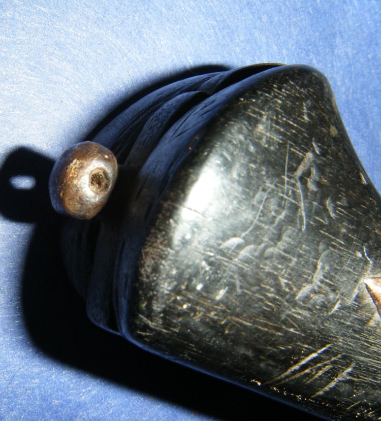

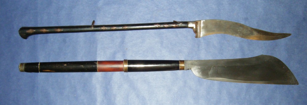

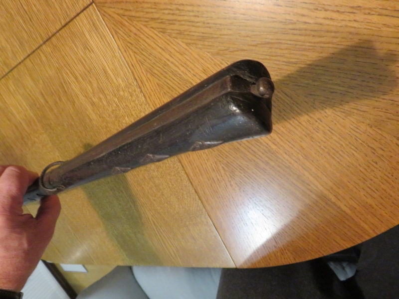

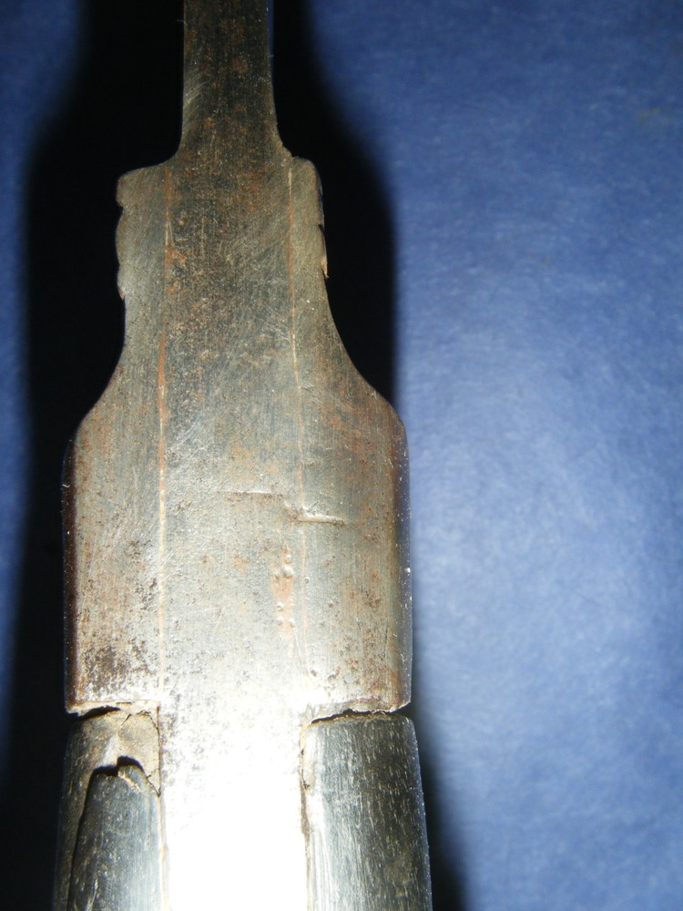

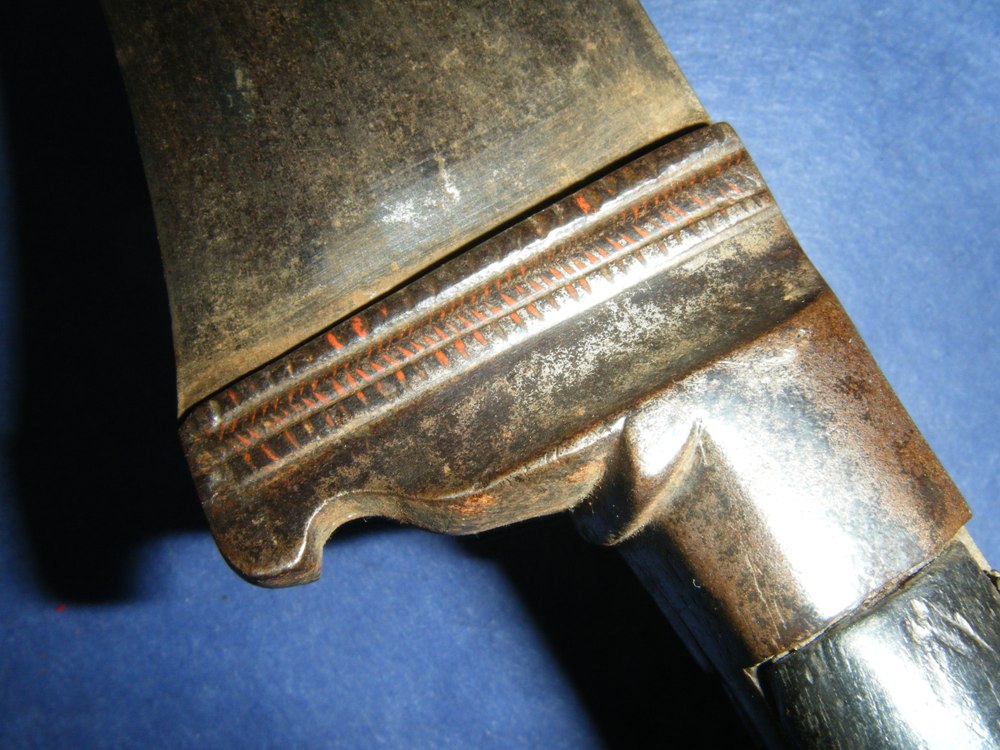

Have received the beast, the blade is laminated, the tip is compressed and a little bit bent, the bolster isn't integral with the blade but "hard-soldered" and the two plates are different thick and it seems that they were red painted at one time, there are still some red paint visible. It's a heavy weapon and thought as thrusting weapon IMVHO instead of slashing. When I attach a string at the two rings the weapon is exactly in balance so I suspect that there was once attached a belt which can laid over the shoulder due the heavy weight of it (approx. 1 kg).
I've taken many pictures, please excuse the quality, it's the best I can manage by the light we have in the moment in Germany.
Old 21st January 2018, 02:15 PM   #17

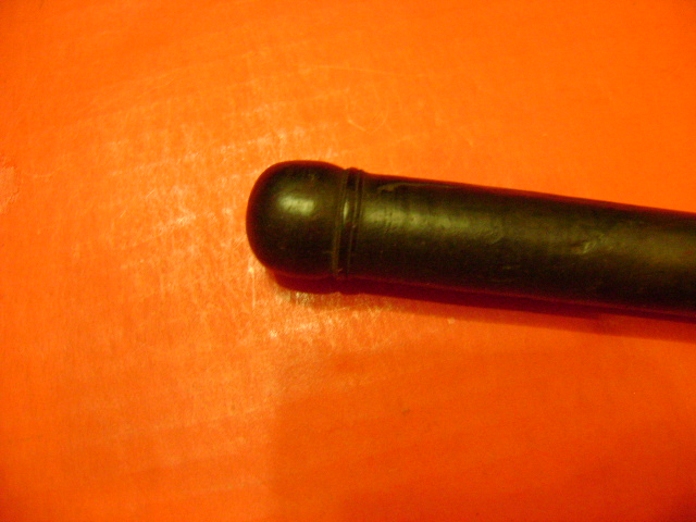

More

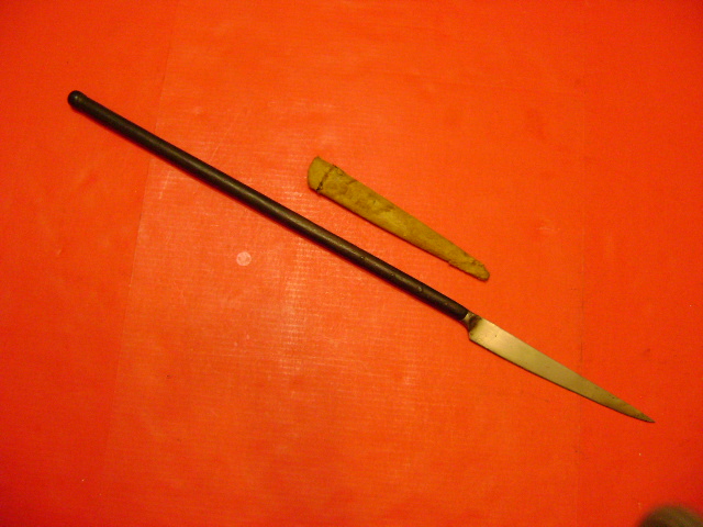

Old 21st January 2018, 02:18 PM   #18
And here a size comparison with my toa.

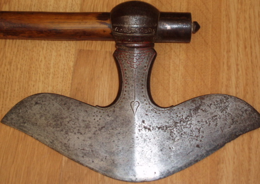

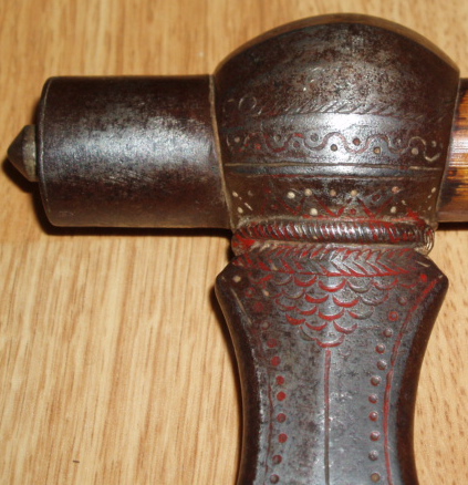

Norman McCormick
Norman McCormick's Avatar
Posts: 1,657
Hi Detlef,
This is an Indian axe of mine that also has red pigment used to accentuate the designs. I never quite managed to I.D. with absolute certainty the when and the where although Oriental Arms had an axe with red pigmentation and described as probably 18thC and South Indian.
Norman.
Old 21st January 2018, 08:28 PM   #20
Posts: 4,747
Hi Detlef,
I have a folding Lohar axe with red pigment on various parts of the piece and have also wondered about its significance. Perhaps this is a form of sacred blessing (puja). Maybe some of our Southern Asian members could explain more.
Ian.

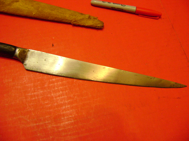

Egerton has a similar example in his book, listed as Buckie.
I have 2, but their blades are of normal uniform thickness and are straight.
Here is one of them.

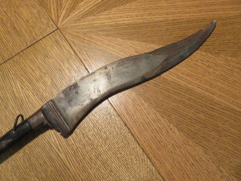

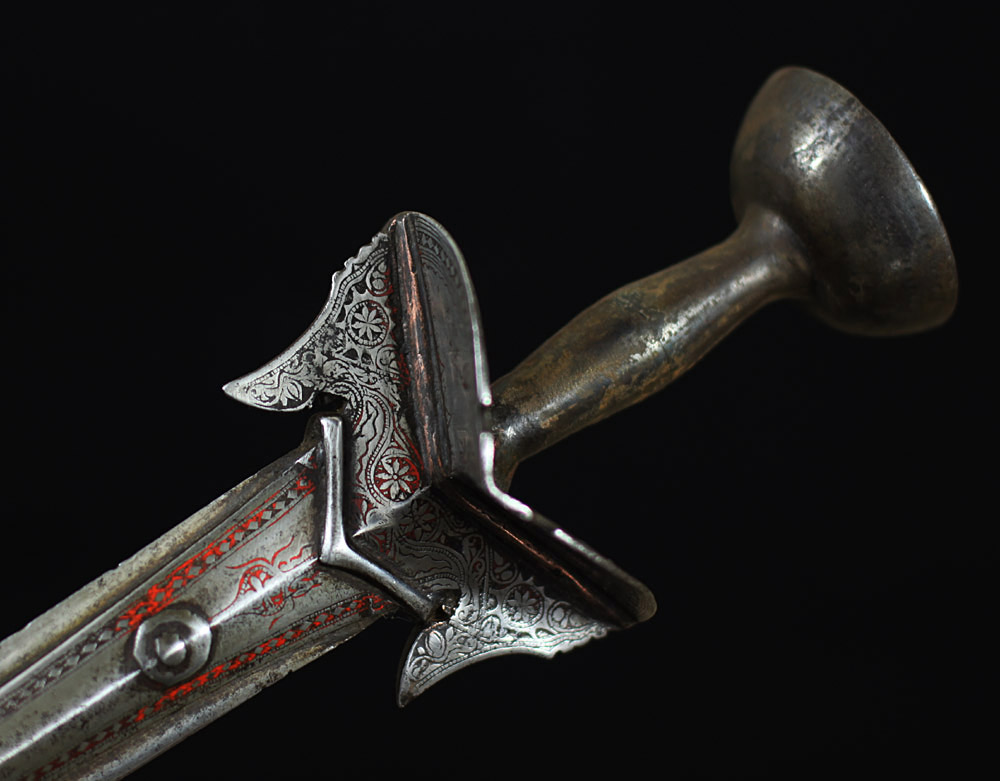

Jens Nordlunde
Jens Nordlunde's Avatar
Location: Europe
Posts: 2,718
For the same kind of red lac see A Passion for Indian Arms pp. 350-53, or the picture below.
