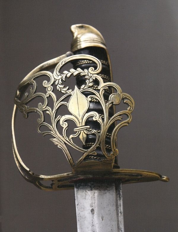

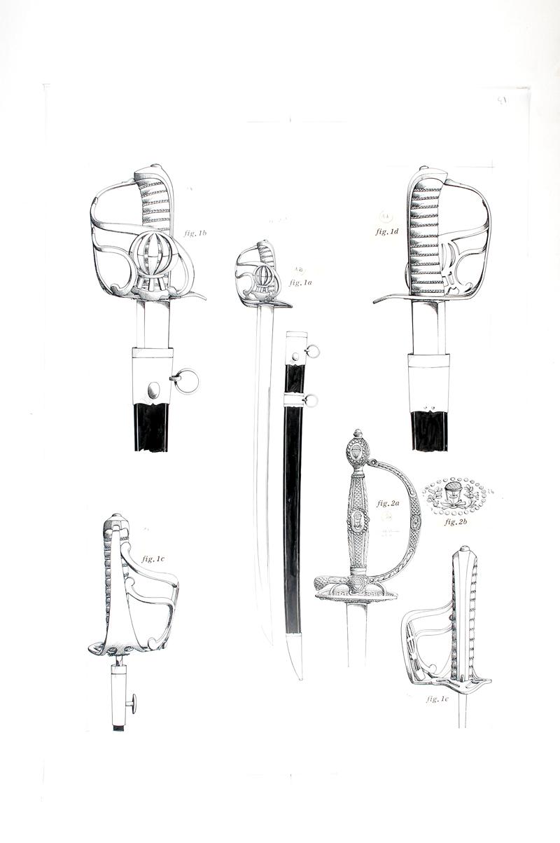

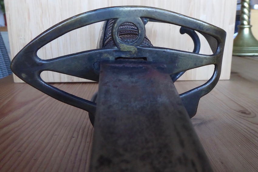

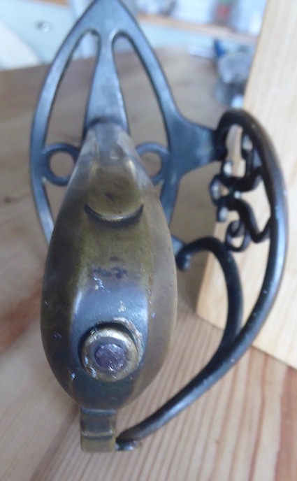

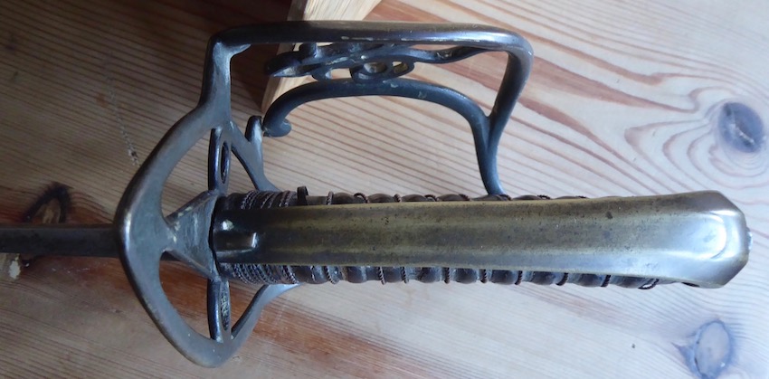

Hi,
A French hanger type sword known as a Petits Montmorency. The blade is 74cms long and 3.2cms wide with the overall sword being 88cms with a blade of the Montmorency type hence the name. The tip is slightly bent but gentle heat and a vice may solve that. These types were in use pre-revolution by the Army, National Guard and the Navy although the Navy versions generally sported an anchor on the guard. The Fleur de Lys guard was in use from 1788 to 1792. This sword was probably used by an Infantry officer or perhaps a well heeled N.C.O. in the National Guard. As usual your thoughts and comments anticipated.
My thanks to the Musee d l'Armee for the above information.
Norman.

Thank you so much for posting this Norman!!! I have never seen one of these hilts, whose openwork design reflects the styles of the period on British spadroons in the general design. This is timed nicely with the studies being discussed on the fluer de lis concurrently.
The Montmorency type blade was also most popular with some English sword types in these times.

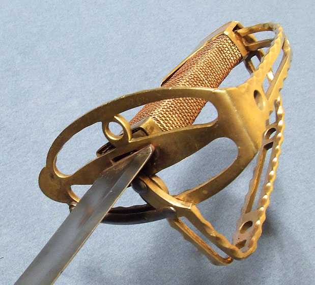

Excellent acquisition, Norman! Like Jim, I had never seen nor been aware of this pattern sword! Of note are the two oval cut-out designs to the guard base, seen on the French officer's pattern naval sword with the swivel guard, like this one I used to own-
http://www.vikingsword.com/vb/showthread.php?t=19372

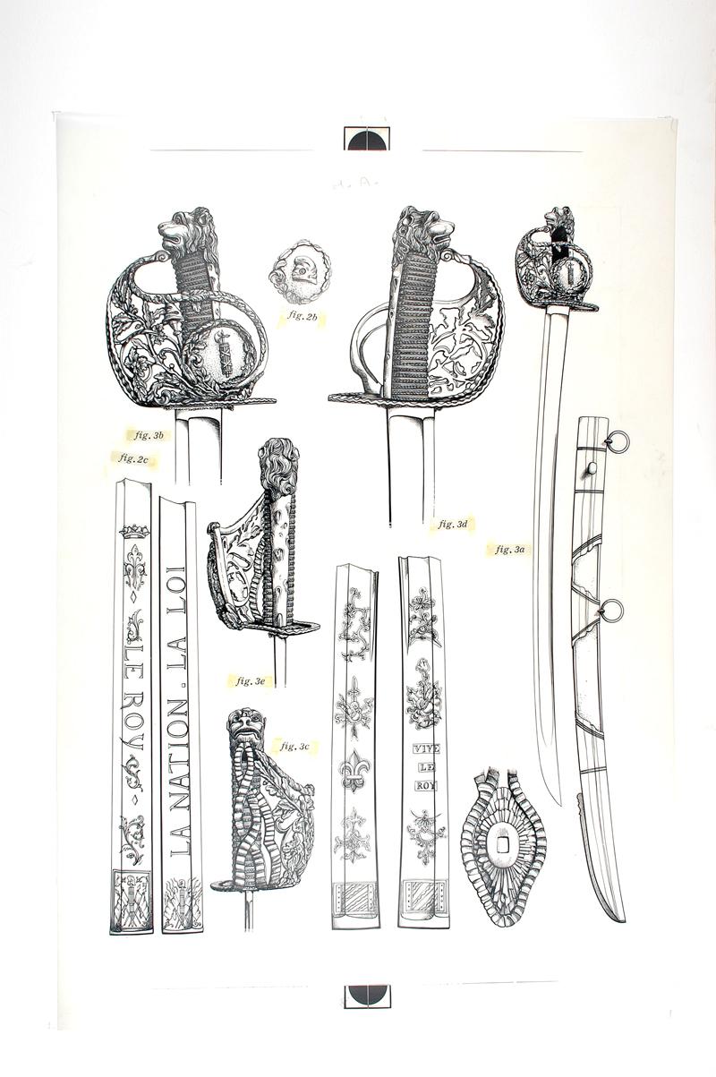

Jim, Mark,
Thanks as always for your views and input. I too was unaware of these Petits Montmorencys until I acquired this example. An internet search of Petits Montmorency sabre will bring up many examples, some plain and businesslike but also expensive blue and gilt types. The guards are many and varied with some pointing towards the particular arm of service in which the owner served e.g. anchor, grenade etc. The 'slotted type' cross guard and blade profile appears to be a common factor with the 'basket' and occasionally the grip as varying factors.
My Regards,
Norman.

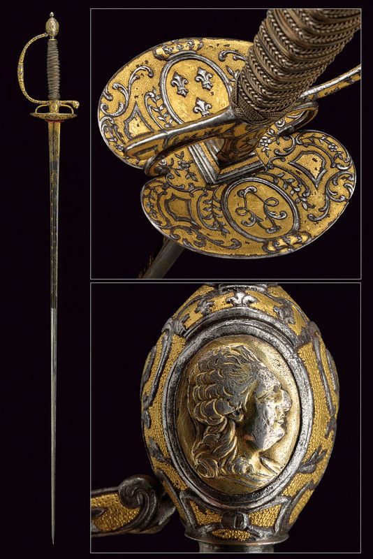

If I may parry with this~ Si le sabre-briquet de 1767~

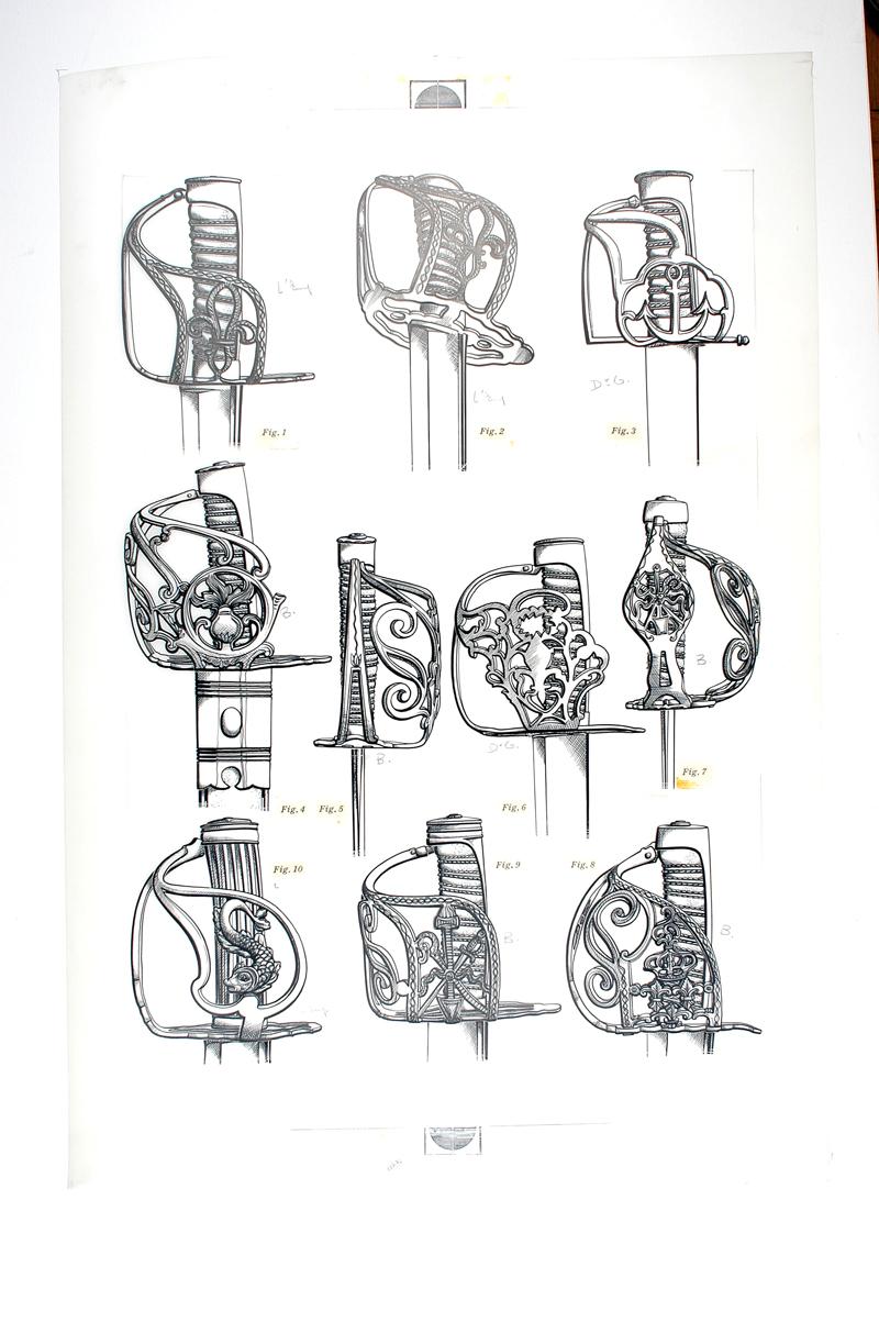

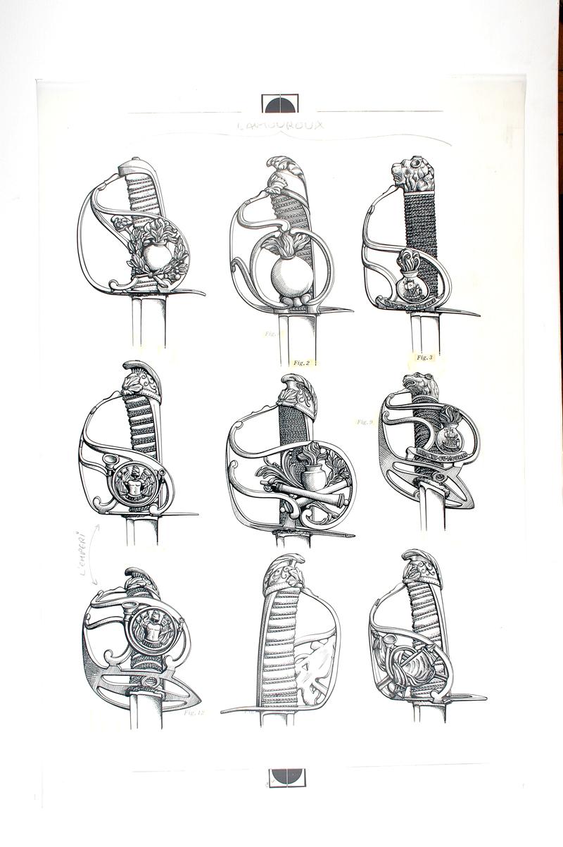

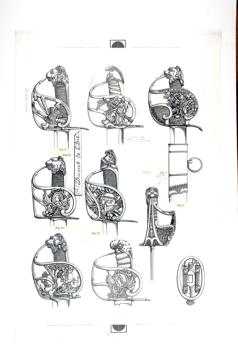

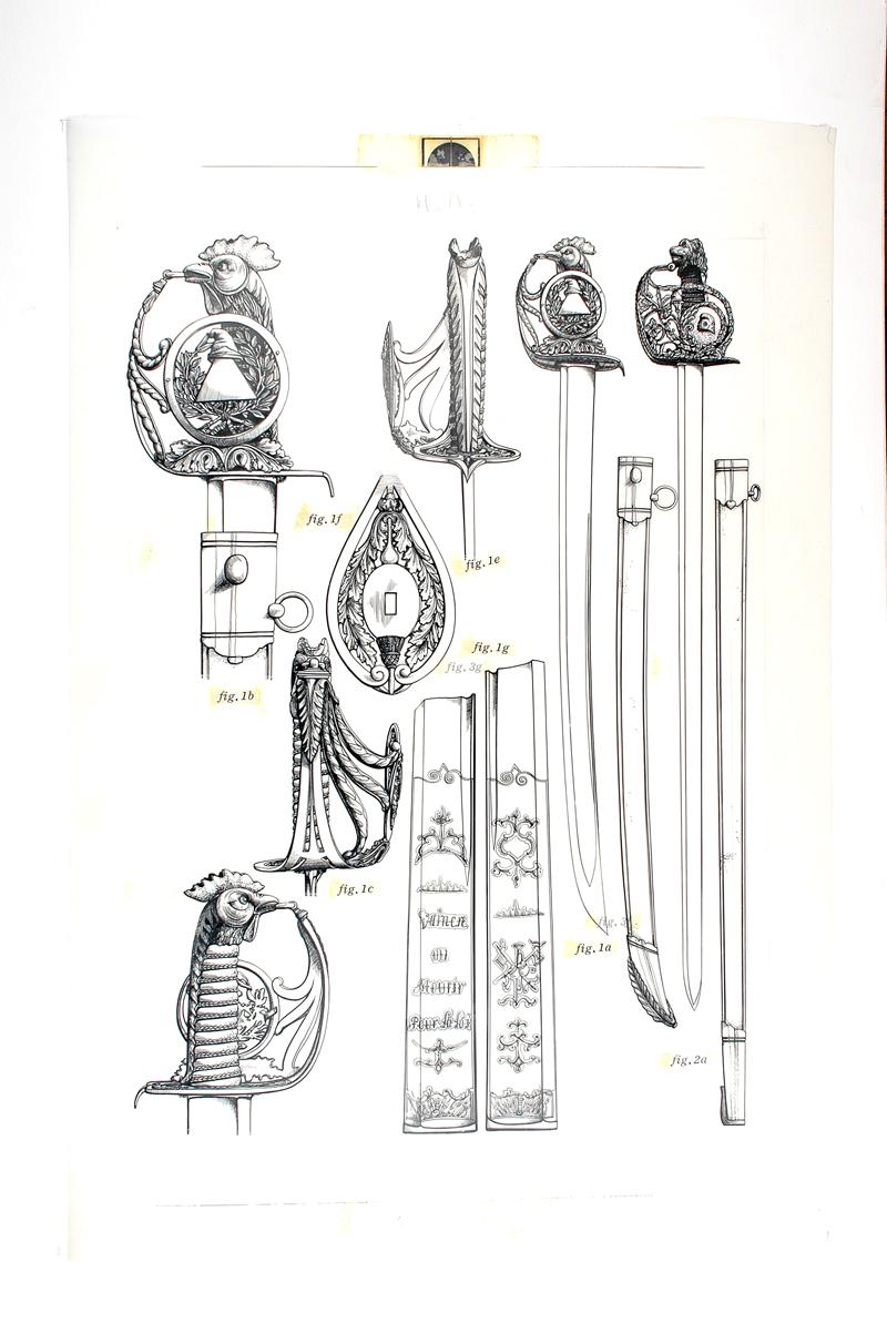

Thank you Ibrahiim, here are some more hilt designs.
My Regards,
Norman.

Excellent, excellent, excellent! Great pics of the multiple pierced French hilt types!

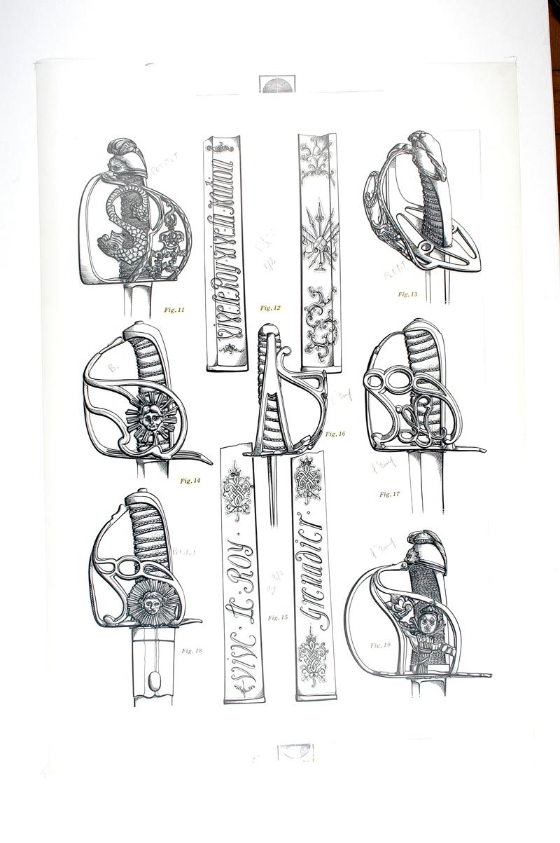

Another group of hilts.

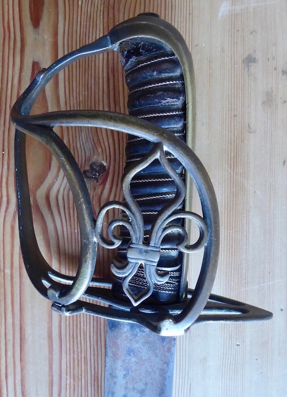

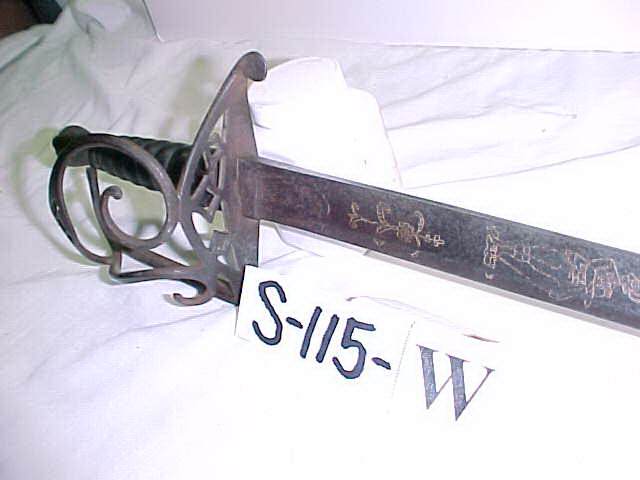

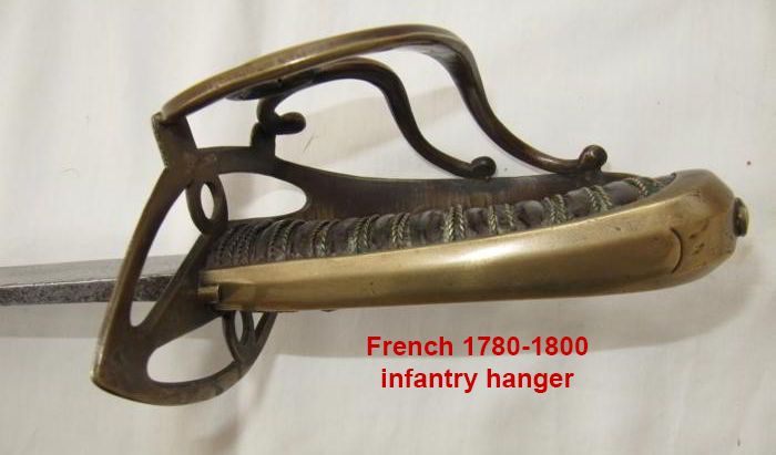

the royal french infantry/dragoon hangers were imported into the USA as aid for the continentals during the revolution, and modified by removing the outer part of the guard where your fleur is, like mine below. they also came without the fleur (napoleonic imperial period?), example from google also below. british dragoon swords of the period had round grips with an urn-like pommel, like the pooley swords made for the loyalists & crown forces in NY. the brits later used a hilt style more like these.

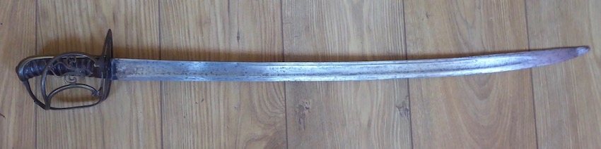

https://upload.wikimedia.org/wikiped...a-Reynolds.jpg
The Tarleton portrait seems to show one. ^^^^

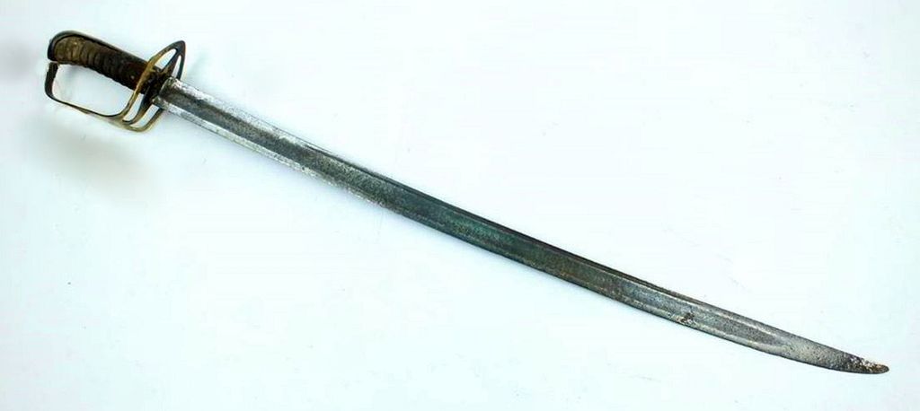

I have always adored this British dragoons sword.
Sorry, no fdl but I like slotted hilts.

I just wanted to thank you for posting these pages from the incredibly hard to access Christian Aries sets of material on French swords and the amazing drawings by Michael Petard!
The sword hilts of this early 19th century/Napoleonic period are pretty fascinating, and your example is a most notably designed hilt among the array that apparently existed.
As noted, the slotted guard, (also often 'four slot') which were popular in British swords clearly gained popularity in France. While the French seem to always be leaders in sword hilt designs, it does seem that in these times from c. 1780s into early 1800s, English designs had notable influence on the French.
This same slotted guard was notably part of the most attractive British M1803 infantry/flank company officers sword.
Also, the British 'spadroon' , of which the 'five ball' hilt was one, became popular in France with these orb groupings on the guard, and were termed
l' Anglaise.
The term Montmorency is also notable as this particular cross section blade became quite popular with British sword makers, and it seems that James Wooley used it on his blades from the M1788 patterns, and later with Deakin as his partner, on M1796 type blades.
Interesting cross influences between England and France in these times in their sword designs.
