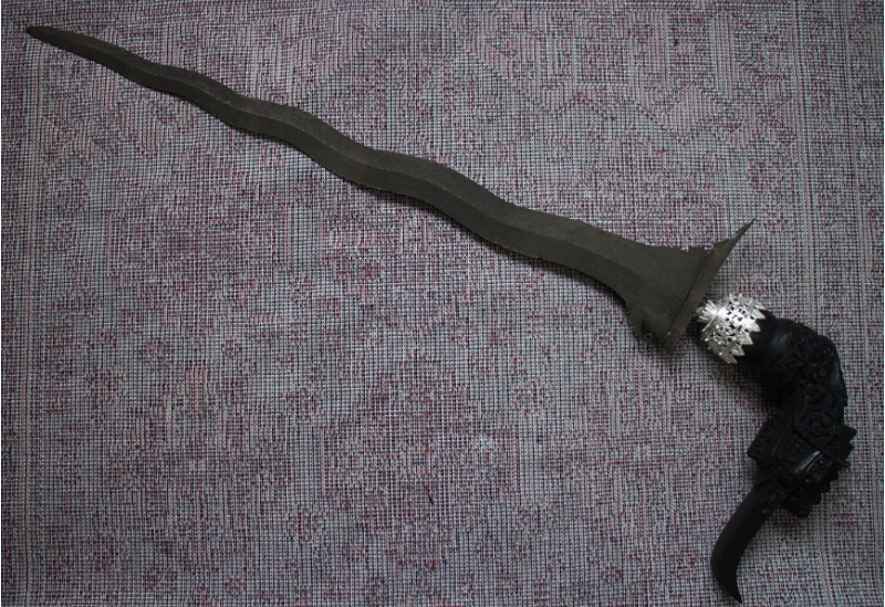

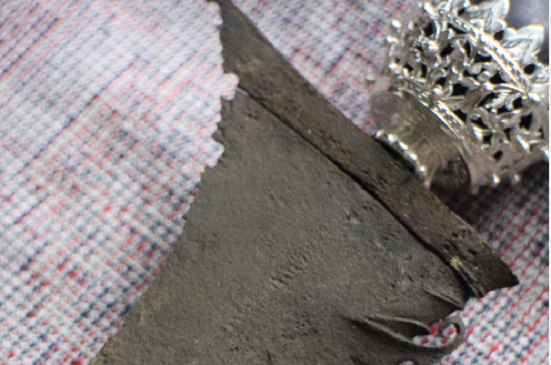

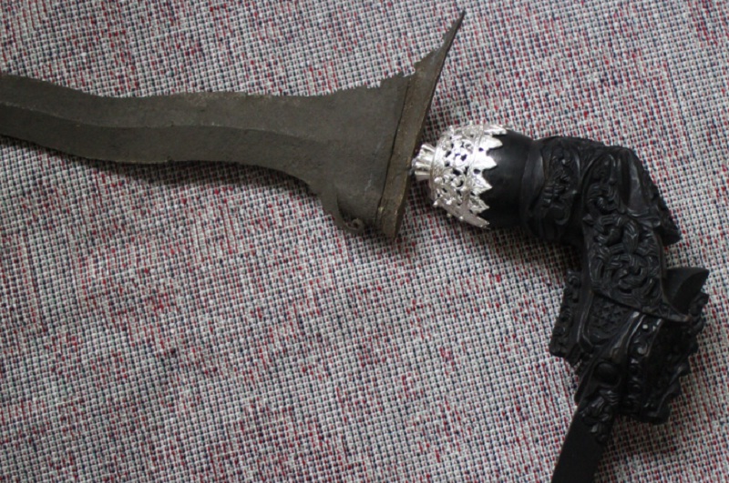

I'm quite fascinated by markings that one can sometime find on some keris blades- Particularly on antique blades. These days keris makers make all sorts of marks on blades by copying old marks simply for decorative purposes without any proper ceremonies or mantras attended to the making of these talismanic markings (ketandaan) as done in the old days.
Would love if dear members can show us some examples of your blade talismanic markings and if possible tell us their probable meaning or purpose.

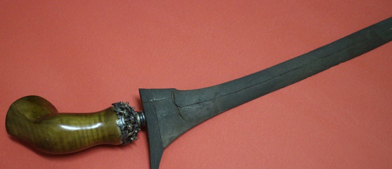

Here is an example from me. A simple but old keris anak alang most probably from Kelantan Malaysia or Patani(?).
There are 2 markings on one side of the blade. A gat ? (Guard) which runs across the blade at the base , and a furrow termed as 'anak sungai' (stream/rivulet) running along the middle of the blade with a break in the centre of the blade which then continues towards the top part.
I don't know the meaning of this markings but has been told that the purpose is to prevent the enemy from finding you . But on the other hand this blade is not good for business purposes (because the customers won't find you!).
don't know what the rivulet is suppose to mean.
Old 29th December 2016, 09:20 AM   #2
Jean
Join Date: Jun 2009
Posts: 1,740
Hello Green,
From the pics I am wondering whether these markings are purposely made or just welding flaws?

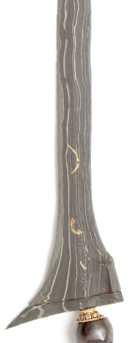

Old 29th December 2016, 09:26 AM   #3
Jean
Join Date: Jun 2009
Posts: 1,740
Hello Green,

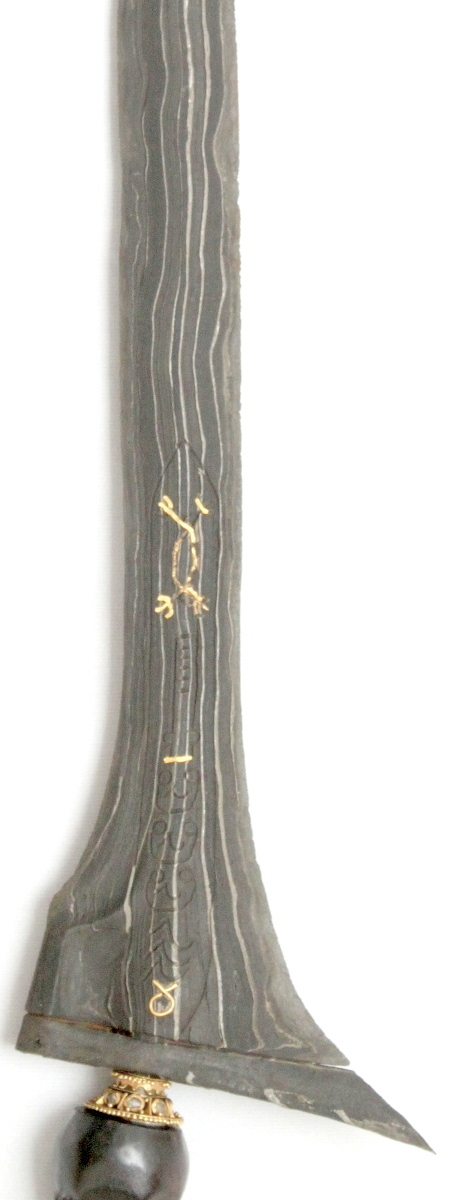

I attach pics of a Javanese blade with engravings partly inlaid with gold, the top motif is called pilulut.
Old 29th December 2016, 03:08 PM   #4
Posts: 7,289
That was my impression as well. The groove down that center (what you call "anak sungai") may well be intentional, but that other gash in the blade surface looks more like a forging flaw to me.
Old 29th December 2016, 04:05 PM   #5
Green
Green's Avatar
Join Date: Apr 2015
Location: Malaysia
Posts: 328
from what i understood and been told the mark was intentional... looks a bit awkward it is true...
Jean;
Do you know what is the meaning and purpose of those golden marks on your keris?
Old 29th December 2016, 05:55 PM   #6
Posts: 7,289
Well, people do tend to tell us a lot of things in regards to keris that are not necessary true...though in the end belief seems to trump truth a lot of the time in these situations.

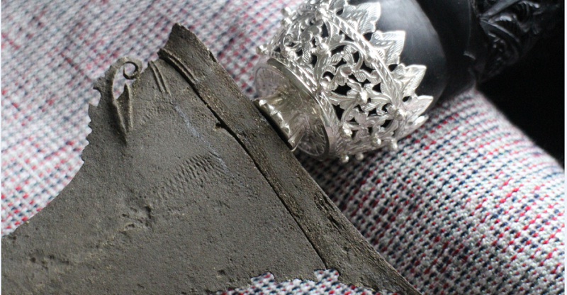

Old 30th December 2016, 03:10 AM   #7
Green
Green's Avatar
Join Date: Apr 2015
Location: Malaysia
Posts: 328
David;
Belief attending to meaning of marks and other belief regarding the history and background of the keris is one thing and can be exteremely subjective.
but the marks on keris is a hard objective fact. If we can see it on the keris , it is certainly purposely made - for whatever reason. Marks are usually obvious (not always) and can not be mistaken from incidental defects to the blade.
Old 30th December 2016, 04:07 AM   #8
Green
Green's Avatar
Join Date: Apr 2015
Location: Malaysia
Posts: 328

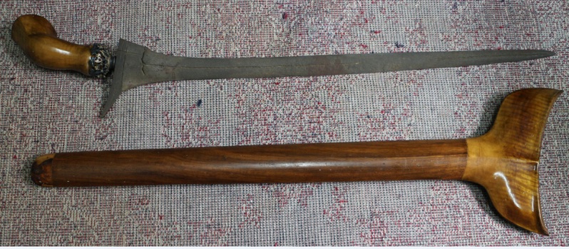

Here is another example of talismanic marking on my old pandai saras blade, which is not obvious at a cursory glance.
But if you put the blade at a certain angle in good light, you can see cross hatches on one side and parallel small hatches on the other side.
These are obviously made for whatever purposes that I am not sure of.
Old 30th December 2016, 05:57 AM   #9
Posts: 7,289
I'm sorry Green, but that just looks like tool markings to me. I'm not convinced at all that these markings have a talismanic intention.
Old 30th December 2016, 08:27 AM   #10
Green
Green's Avatar
Join Date: Apr 2015
Location: Malaysia
Posts: 328
i did think the same when i first saw it, but a couple of people who know about patani keris that I showed this to, told me it's a mark done purposely.
they could be wrong...or right...
Old 30th December 2016, 08:39 AM   #11
Posts: 7,209
They're made because somebody forgot to use alloy jaw covers on his vice. Even folded newspaper would have done.
Talismanic value is to remind one to take care playing with things they do not understand very well.
Old 30th December 2016, 08:58 AM   #12
Posts: 9,729
Hello Green,
agree complete with Alan, this marks a more as typical for a vice.
Sajen is online now   Reply With Quote
Old 30th December 2016, 09:04 AM   #13
Green
Green's Avatar
Join Date: Apr 2015
Location: Malaysia
Posts: 328
Ah... yes, Alan's explanation makes perfect sense for this blade! Many thanks. I'm learning new things everyday!
what about the first blade I showed...would that considered some form of artifact and not a purposely made marking?
Old 30th December 2016, 09:48 AM   #14
Jean
Join Date: Jun 2009
Posts: 1,740
Jean;
Hello Green,
The golden marks were recently made or refurbished I think but the engravings look original.
Old 30th December 2016, 11:04 AM   #15
Posts: 7,209
I would need to examine the first blade under magnification to know what I was looking at.

Old 30th December 2016, 07:55 PM   #17
Jean
Join Date: Jun 2009
Posts: 1,740
Originally Posted by Sajen
Hello Green,
If these diamond-shaped marks were imprinted by vice jaws they should be of equal size (unless the vice is very rustic) which does not seem to be the case from the pics: the marks look of larger size up the blade but this may be a perspective effect?
Old 30th December 2016, 08:05 PM   #18
Posts: 7,209
Green, pics will not be of any use to me, I need the thing in my hand, and a 3X loupe in my eye.
Jean, to you these marks may be something to be investigated, analysed, given careful thought, and then a decision made. To me they are as clear as reading a sentence that I have already read many, many times. I've even been guilty of writing that sentence once, when I was about 13 or 14 years old. These marks were made by the blade being clamped into a holding device. That device is usually a bench vice, but some hand tools do leave a similar imprint.
Old 30th December 2016, 09:02 PM   #19
Gustav
Join Date: Jun 2009
Posts: 1,328
Yes, we see them quite often on Malayan Keris.
http://www.vikingsword.com/vb/showth...ght=vice+marks
The magic of modernisation.

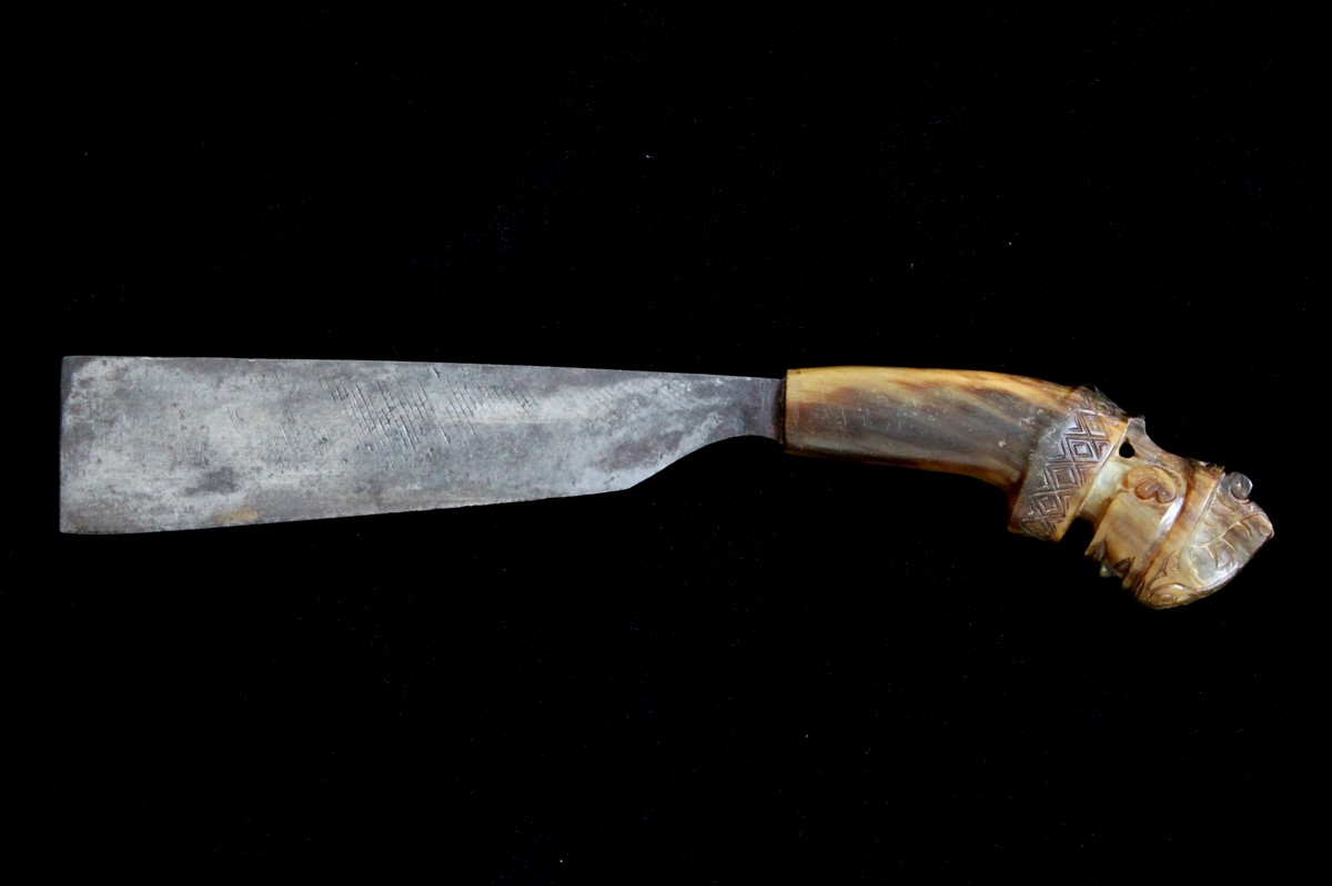

Default Crisscross lines on a Batak knife

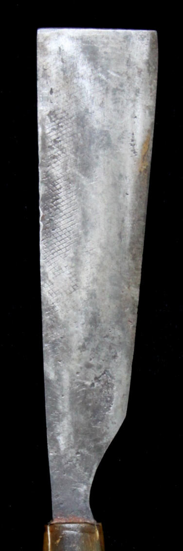

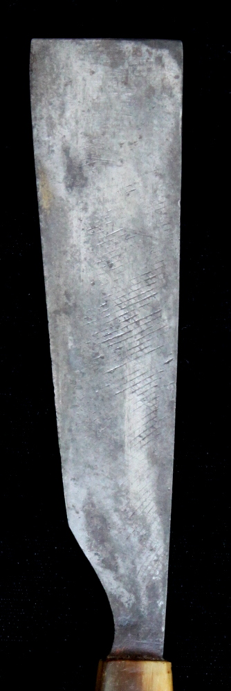

I own this old Batak chopping knife, the strong blade has one cutting edge and a convex section, and it shows irregular crisscross lines on a significant part of the surface. By close examination it seems that the entire surface was initially crisscrossed but it was polished towards the edge probably for maintaining the sharp cutting edge.
These lines were clearly incised for any reason and not imprinted by a vice or other clamping tool.
Old 3rd March 2017, 08:17 PM   #23
drdavid
Join Date: Aug 2005
Location: Australia
Posts: 374
Jean, what are the dimensions on this piece. I have previously owned a couple of knives that had been made from old files. They still had a little cross hatching visible over a fair amount of the blade
Drd
Old 3rd March 2017, 08:56 PM   #24
Posts: 6,418
It looks like it's made from an old wood rasp to me.
One flat side; one convex side.
Seems like the cross section of a rasp flattened out.
Old 4th March 2017, 12:48 AM   #25
Posts: 7,289
I'm afraid i am in agreement with both Rick and DrDavid. It appears that you blade was made from a file. I've seen many in my day and the result looks very much like this. Even if this were not the case though, i wouldn't image that a pattern of lines like this would have any talismanic purpose. We often find markings on blades both decorative or practical that do not have any talismanic intent.

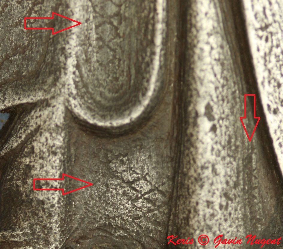

Old 4th March 2017, 12:54 AM   #26
Gavin Nugent
Gavin Nugent's Avatar
Default I can see the confusion
I can see the confusion from who ever noted that the Tajong blade pattern is a talisman in nature. The markings on the tajong blade are to my eye are also that of a vice. The small knife shown later is certainly made from a file as indicated.
Such patterning on the Tajong is known in the Patani/North Malay regions but it does not start and end there. Below is an example from my personal collections that gives a partial indication of how it should look...I say partial as there is much more to these marks than what meets the eye in the image.
Gavin
Old 4th March 2017, 09:38 AM   #27
Jean
Join Date: Jun 2009
Posts: 1,740
Drd
Hi Drdavid,
The blade is 17.2 cm long by 4.3 cm wide and 4.5 mm maximum thickness (6.8 x 1.7 x 0.18 inch). This appears too wide for a rasp or file (the piece would have been originally wider) and furthermore the crisscross lines near the tang are not parallel to those near the tip (more slanted) which would not be the case if the piece had been made from a rasp or file. There are also traces of crisscross lines on the flat (non-cutting) edge of the blade.
Old 4th March 2017, 09:48 AM   #28
Jean
Join Date: Jun 2009
Posts: 1,740
Hi David,
Although I do not believe that this blade is a recycled file or rasp for the reasons explained above, I agree that these rustic markings are more probably decorative or practical than talismanic.
Old 4th March 2017, 09:54 AM   #29
Jean
Join Date: Jun 2009
Posts: 1,740
Gavin
Hello Gavin,
Some of the marks on you blade are clearly located in a cavity, so how could they have been imprinted by a vice?
You are correct that it is difficult to assess and interpret these marks from a picture.
Old 4th March 2017, 10:02 AM   #30
Posts: 9,729
Hi David,
Hello Jean,
disagree with you, sorry. I also own some old blades made from files or rasps, it's a typical sign for this. Files/rasps has been high regarded as material for good blades. Good iron material was not found at every corner in old times!
