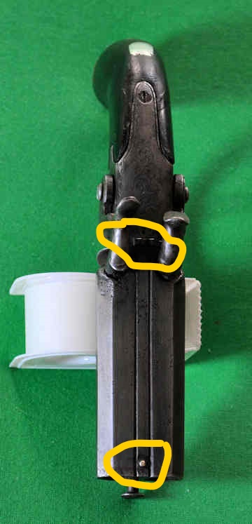

A recent impulse purchase at auction.
Catalogue description:
Mid 19th Century Double Barrel Percussion Pocket Pistol. 50 bore 3 1/4 inch sise by side octagonal barrels. Lower rib fitted with asteel swivel ramrod. Action frame sides and topwith floral engraving. Pecusion dolphin head hammers with matching engraving. Polished wooden bag shape grip with brasspommel and white metal escutcheon.
My Stats:
Weight: 1lb 4oz
Bore: .45 inch (11.6mm), 50 bore?
Length overall: 7 3/4 inch (19.8cm)
Barrels : 3 1/4 inch (8.3cm)
Floral engraving on hammers, top frame, lock sides and trigger guard. Small amount of engraving on muzzel ends. Two proof marks on underside of each barrel. No makers marks or signature. Silver escutcheon not marked or marks/engraving worn away.
Small repairs to sides of wooden grip by the lock platres. One of the hammers has been rep[laced and is slightly mismatched. It has a slightly simpler form of engraving and differently shaped hammer spur.This gives the pistol a rather cock-eared look
I assume this is an English pistol from about 1850 but there is no makers mark so I cannot tell for sure. Can anyone decypher the proof marks? They are not very clear. Any insights anyone can offer would be welcome.

These are as far as I can see the Birmingham/GB view- and proofmarks

Thank you both. Does 1850 seem about the right date for this?

Proof are Birmingham as mentioned above, from 1813 to 1904.
Likely the date is close to what you suggest. Maybe a shade earlier with the flat hammers.
Smooth or rifled does not suggest earlier or later, as both were used for many years prior to this.

Not sure if it qualifies as a ''sighting system'' but thr pistol does have a simple fixed fore and rear sight.

This sight is outsite of the barrel's length axle and so totally
useless
