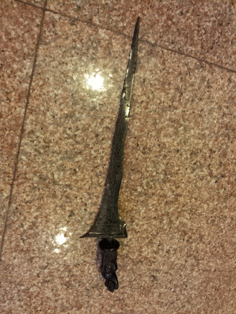

I have a Balinese keris for discussion. It is a small keris. The blade not more than 30 cm long, still in good polish except for some rust spots which I would need advice on how to remove without destroying the polish on the blade. The seller said it was an ex-museum piece as seen by the catalogue number written on the keris. I remember in an earlier post, Mr Maisey made mention about small Balinese Keris but I can’t find that thread.
I attach pictures of the keris. I juxtapose the keris with a typical Balinese keris I have so that you can get an impression of its size. Any additional information welcome on views on the keris welcome.

Well I can surly say that I like the pamor and the condition of that pamor on the blade!
Definitely not a tourist piece!

Well José, i don't think there was ever a question that this could be a tourist piece. Certain size alone would not be an indication of that.
I believe we can find numerous smaller Bali keris about that are genuinely antique and legitimate. The smallest one i own in just under 13 inches (33cm). This one is a bit smaller at just under 12 inches. Certainly by Javanese standards that would be too large for the usual patrem. Frankly i am uncertain that patrems were even a thing in Balinese keris culture. I can't really recall actually ever seeing any. But one thing i notice that is different in the presentation of this small Bali keris from my own is the sheath size. While my 13 in. Bali blade is clothed in normal sized Bali dress Paul's example wears dress that is more proportionate to the smaller size of the blade. As an accessory of Balinese dress the sheath and hilt need to be of a certain minimum size to be appropriately wore in public. The smaller dress of Paul's keris does not allow for that style of wear so perhaps it is meant as a patrem or perhaps it was made for a small boy.
Alan, if you are tuned into this thread perhaps you have some insights to add.
Exactly! What if the Keris was meant for a boy?!
Or what if the Keris was meant for a rather small man?! I am rather small myself, but I certainly saw many Indonesians smaller than me.

Hello Paul,
I think that Alan speak about the blade alone!
Also when the sarung show age and handling is the blade much older IMVHO.
And I think in a maybe similar direction like Alan.

Firstly, the keris.
The wilah is an old Javanese one that has been given a Bali style polish. It can be classified as Tangguh Segaluh, which is one of the very few tangguh classifications that I am prepared to endorse from a photograph. Its about the easiest of any.
The hilt and scabbard are 20th century. Based upon similar examples of known age that I have seen and owned, I am of the opinion that the hilt and scabbard date from either the period 1950 to 1980, or from the 1930's. My best bet would be 1960-1975.
As I remarked earlier, an old Javanese blade presented in Balinese dress is not at all unusual, in fact a great number of Balinese pusaka keris are keris (wilah) that have been made in Jawa.
This is exactly what I thought byself but frankly said first after Alan hit my nose on this with his remark: "Look at this keris. Forget that you think you know where it comes from.
What do you see?" !!
Paul you have a very old Javanese blade with a Balinese polish and newer dress. I personally would look for a nice uwer.
