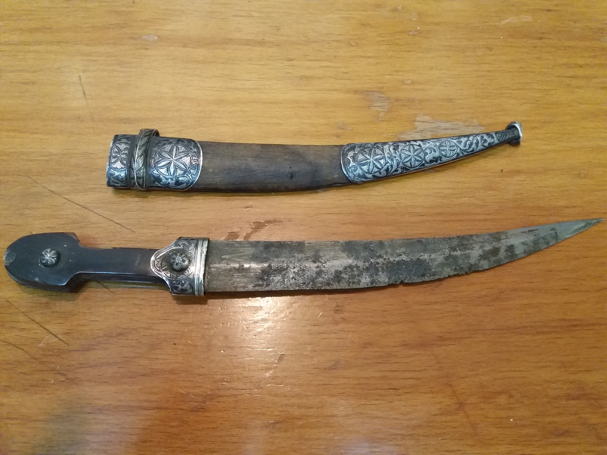

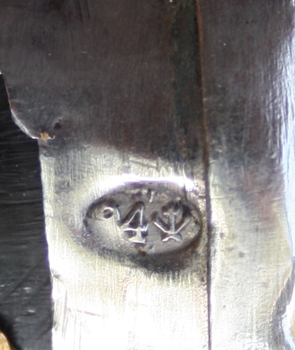

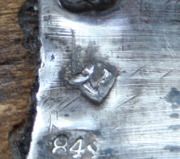

I bought this very small kinjal recently, somhow thinking it was Ottoman. It turned out to be Russian, but I don't know anything about age and origin. It is in rough shape, so not a very good peice, but I gave it for restoration anyway. It has a maker's mark, and three silve hallmarks. I know that the symbol next to the "84" should stand for a place (town) where it was made. Does anyone know this mark? Any thoughts about age? Thanks

The city is Tbilisi, Georgia, and that's a 19th century mark. Do you have more pics of all the marks?

G. McCormack is correct, it is the Tbilisi mark.
I believe this design came into use in 1886.
The embellishment is in Circassian style. Relatively
small daggers like this one were made for boys and
women.

I knew I could trust this forum members for some good answers. Thank you. Here are some additional pictures. Unfortunately, the blade is severely damaged by rust and I can only stabilize it. It is a thin and sharp, with a diamond cross-section and looks fairly well made. Remains of leather or similar material once covering the sheath are visible in picture.

The 84 itself was of course the fineness of the silver
84 zolotniki or 875/1000 pure silver
Russian marks would have marks including town mark as indicated.
If court supplier the double head eagle.
French used the 84 as well, but only accompanied by a G.
