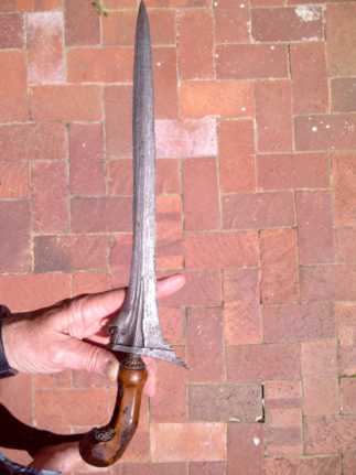

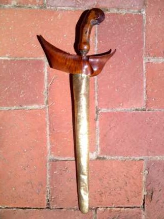

As a new member I heartily greet you all. The keris is a brand new interest of mine, and my head is swimming with the new information I have gleaned so far from all kinds of sources. I realize that therein also lies the danger of my being misinformed. That's why I have the greatest of expectations from this forum and I will do my best to make my contributions worthwhile.
I got this keris from an antique dealer who is a family member, and all indications point to it being a Java keris: ukiran, warangka,gandar and pendok all say the same thing. I going to try my hand at posting a few pics, which I hope will be sharp and clear. My first concern is whether I am on a sound footing when I suspect this keris is a genuine antique dating from before 1945. Secondly, I am very much interested to identify the blade pamor. I think it is mlumah. My biggest disadvantage is that this keris is the first and only one I have seen and handled in my 70 years! I am looking forwards to intimately studying this remarkable edged weapon.

Welcome to the forum Johan. I can certainly understand why your head would be spinning for your various sources of information and you are wise to suspect that there is a lot of misleading or outright false information to be found out there on these marvelous blades. And then many things are simply a matter of differences of opinion or belief systems that can't ever truly be settled. My best advice to you would be to take some time searching our archives where you will find all these various opinions, along with a few cold, hard facts, living in residence.
As for your first keris, we could certainly use some larger photos, but they do seem relatively sharp and clear. From what i can see it is indeed an antique keris from Jawa. If you posted photos of the sheath and the hilt we good even place it, dress wise, in a more specific area of that island. I can't really see the pamor pattern very well in these pictures, but the blade looks a bit out of stain anyway so even better photos might not give us a clear answer.

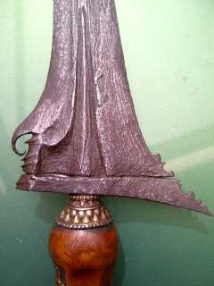

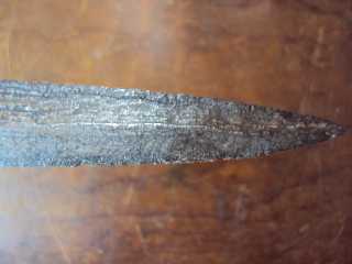

Thank you so much David. I will certainly do what you suggest, and start to build a kind of "book of facts" concerning this keris. I am very thankful that I managed to get hold of this one in the undamaged condition it is. The warangka however had separated from the gandar-pendok unit and I have re-attached same by merely using glue. It's nice and firm now.

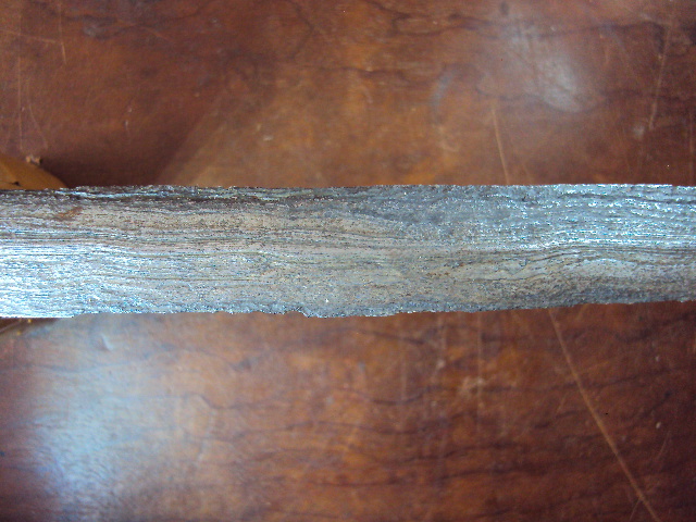

The first of my various suspicions that I will try to confirm, is that there is no nickel-containing layers in this blade, which means that the blade will not show contrast, and that various iron layers (besides the steel core) are the only types of metal used in the crafting of this blade. Secondly, I am hoping that the layering in this blade and the combination of the layering will eventually lead to a decision on the era (tangguh) out of which this keris originated. Thirdly, I have provisionally established the pamor pattern as mlumah, because the lamination is parallel to the flat surface of the blade.
I am hoping that my improved pics will help all you experienced guys out there to kindly comment further on this wonderful item that has come into my possession. I'm starting with one or two that I have, but others will have to be re-taken.

It would be really helpful when you would show the complete keris inside the scabbard and a picture similiar the last one in this post from the blade but show the blade complete and maybe a little bit bigger. Welcome to the forum!
Old 2nd October 2016, 06:00 PM   #6
Posts: 7,303
Thanks for the additional photos Johan. I would second Detlef's photo requests though.
This actually looks like a fairly decent old keris. Again, it is difficult to tell the pamor pattern without seeing this blade in full warangan stain, but i suspect the pattern might possibly be Sada Saler or perhaps one of the adeg (standing) pamor patterns.

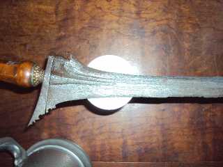

Based upon what I can presently see I am inclined to place this keris as North Coast, and towards the west. We do need to see full length images in order to place the origin of the complete keris.
The blade alone I also think is North Coast, towards the west. The blumbangan is boto rubuh, and that pretty much eliminates Central Jawa and (probably) most of East Jawa, additionally the ron dha is a bit outside acceptable parameters for Central Jawa and most of East Jawa. The pamor is an adeg pamor, maybe adeg sapu, but probably safer just to give it as adeg, which makes it pamor miring.
Not a bad old keris, and in nice condition.

A nice older keris; and I do think you have contrasting shades of metal there.

Oh yes, I didn't mention the nickel question.
Many old Javanese keris do not contain nickel, but that does not mean that the pamor has no contrast. The contrast is provided by "white iron" = high phosphorus content iron. This white iron was a local product and was not suitable for tool or weapon production, so it was combined with the more expensive irons, mostly imported, to provide a usable product, the end result being pamor. This type of pamor does not jump up and bite you, like 19th century Bali pamor, but there is nearly always a sufficient degree of contrast to allow it to be clearly seen.

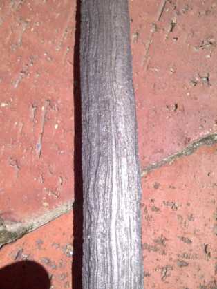

Oh to be technologically gifted! (Sigh!) Here goes some pics, for better or worse.

Like Alan I think that your keris coming from the North Coast, also the cross piece of the scabbard let me think like this, nice keris! Nice and not often seen wrongko.

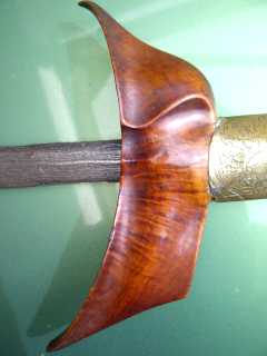

I have a further question on the wrangka of my keris. In comparing many pics of the basic shape called ladrang, of which mine is an example, I came under the impression of the outlines of the keel, bow and stern of a boat. I suppose the boat design is simply reminiscent of the Indonesian countries having seafaring people living in them.
I was wondering why the upturned ends of my wrangka does not rise so tall as those I have seen the pics of. There is no indication whatsoever that my wrangka had lost its high point due to breakage. Everything looks fine. Perhaps the very high swirling bow and stern are more modern? Another question: both the ladrang and gayaman shapes seem to be Javanese, but what position would these two different shapes enjoy in their everyday use? Are they both held in the same esteem? And a last question today, if you will be so kind: the wood my wrangka was made of does not seem to be timoho. Some comment on what you reckon it might be? Perhaps kemuning or trembalo?

Johan, in response to some of your questions regarding your sheath, ladrang sheaths are for formal occasions (weddings, court, etc.) while gayaman sheaths are for everyday use. I am not sure if one is necessarily held in higher esteem, it is simply a matter of application.
As Detlef has already remarked, your sheath (wrongko) is of a lesser seen variety, so no, it has not been re-worked from a normal ladrang sheath.

According to the book "Keris dan senjata pusaka bahari", your warangka is in perahu labuh ( a type of boat it would seem) style from Cirebon. The S shaped rib on the right side of your picture is an additional indicator besides the slightly curved ends. By the way the pendok (metal oversheath) seems inverted, the carved side should be on the front of the scabbard.
Your warangka seems to be made from kemuning from the pics but other options are possible, a better picture would help.

Keris scabbards from before about 1400 seem to have been squarish in shape, somewhat similar to the scabbards that we now think of as Bugis.
By the first half of the 15th century a ladrangan style seems to have evolved.
There has been a theory floating around for a long time that the "boat" shape of some scabbards is in recognition of the ancestors having travelled by sea to settle in Jawa. I personally doubt this theory because the early ladrangan styles did not look nearly as boat-like as the much later Central Javanese styles, nor for that matter as boat-like as the North Coast styles, such as the one under discussion. My own feeling is that we simply have an instance of artistic advance.
I agree that kemuning might be a good bet for the scabbard wood.

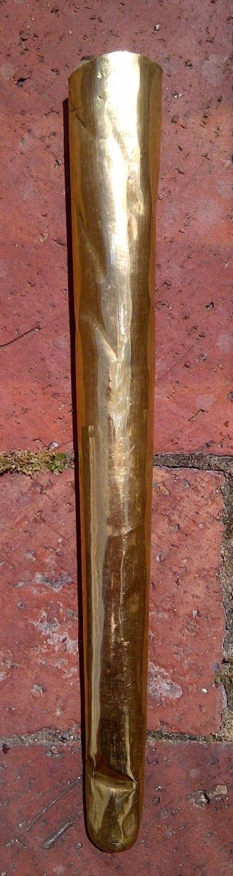

Noting what was said above about the inverted metal oversheath: When I received this keris and sheath, the wrangka was separated from the bunton-type gandar/pendok unit. I could not get confirmation from the owner that the warangka and pendok/gandar actually belonged to one another. He simply did not know, but he said he got it in that condition. I gently tried to fit the warangka to the rest of the sheath first the one way around, then the other. The way it is now, glued together by me, is the way it fitted best. I admit I let myself be led by this fit. The other way around was very ill-fitting. Now this might spell out that the two components do not belong to one another - the inverted fit being better merely by coincidence.
In addition, the brass oversheath has floral/leafy designs on the one side, and looking at the indentations carefully, I think they were stamped in with punches and hammer, not incised/carved. If the quality of the oversheath is inferior to the quality of the wrangka, it might suggest the two do not match. Depending on your comments, I might have to detach and re-attach the wrangka other way round?
Lastly, I am wondering about the pendok variation I have. It cannot be cukitan, because the design is not pierced, nor is it carved (krawangan). Is it a known variation when the decoration is by punch?

Dear Johan,
I have attached a picture from a keris in front side view, it's the show side.
Normally is a pendok only put-on over the wooden gandar. So you need only to reverse the pendok when possible. Pendoks can be engraved or punched (from front or the back). I haven't noticed until now that the pendok is decorated!
You should provide better and bigger pictures.

Thank you for the pic of the top part of the engraved pendok. It is of common quality, probably not from the North Coast, and if you reverse it as it should be, there will be some exposed wood at the top of the gandar on one side as the top of the pendok is not symmetrical, so you will have to file it. Considering the quality and condition of the pendok (bumps), I would try to replace it if I were you....
Edit: Sorry, I missed your post#21 so I understand the situation but it does not significantly change my reaction.

Johan, we really do need full length photos, front and back, before we can make any worthwhile comment on this pendok.
As has already been said, it is probably incorrect for this wrongko, in fact from what little I can see, it looks like it might be a Jogja pendok.
However, if it is incorrect it might be somewhere between difficult and impossible to get hold of a correct pendok.
Could you please let us see full length, front and back pics of the pendok?

1 Taking everything you have said into account, I now believe this keris blade was made between 1800 and 1900. Would that be a fair guess?
2 What would the significance/meaning be of the sogokan on the sorsoran of my keris blade? (I have actually read somewhere that some call them blood grooves!)

5 You have considereed the pamor of my keris to be adeg. Is that pattern only produced by twisting, or might there be another method of creating adeg?
The sogokan where it exists can be understood as a representation of the lingga, the primary icon of Siwa and of the male principle; the sogokan seems to have developed from the lines that are found in some early monumental representations of the keris and that follow the triangular blade shape, this triangular representation of a symbol of Siwa can be seen in the bronze Keris Buda shown in Image 25, and is occasionally found in much later blades.

3 What kind of hardened tool could the empus have used to chisel these magnificent features of the ricikan into the metal of the sorsoran? Surely, a job like this requires high quality tool steel! Was it available in those olden days?
Very old keris --- say, pre-16th century --- were probably carved by using stones to create the topographic features, even in the 19th century some village smiths in Jawa used stones as both anvil and hammer. In the 20th century, although we did not use stones to create the topographic features, some keris makers did use stones and abrasives made from crushed stones to refine and polish keris blades. Files, cold chisels, and scrapers are the traditional tools used by keris makers through historic times, and before the second half of the 20th century they made their own tools from scratch. I was taught during the 1980's, and it was necessary for me to make some of the tools that I used, by the modification of old factory made tools.
Generally speaking, even today many, if not most, Javanese artist-craftsmen make their own tools.
4 I understand the ron dha to be only one single, specific indentation on the greneng. Would I be correct?
Yes. The ron dha is the feature that is frequently found as part of the greneng that resembles the Javanese letter "dha".
Adeg pamors are not a twist pamor. Adeg pamors are produced by first welding a mlumah pamor, then changing the orientation of the layers so that when the core of the blade is welded between the two pieces of pamor material, that material is at 90 degrees to the blade core.
6 Lastly, I have read that the two different "sides" of the sorsoran are called "front" and "rear", but are there not Javanese names that we call those "sides", the kembang kacang side and the pointed greneng side?
Front sogokan = sogokan ngajeng, back sogokan = sogokan wingking
The kembang kacang is the front of the blade.
