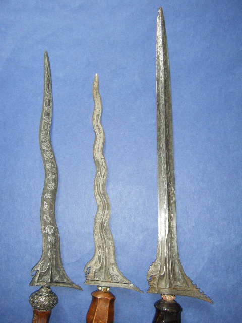

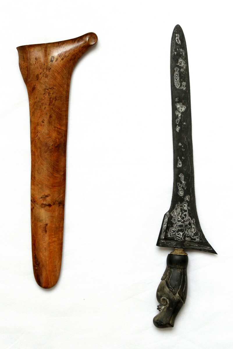

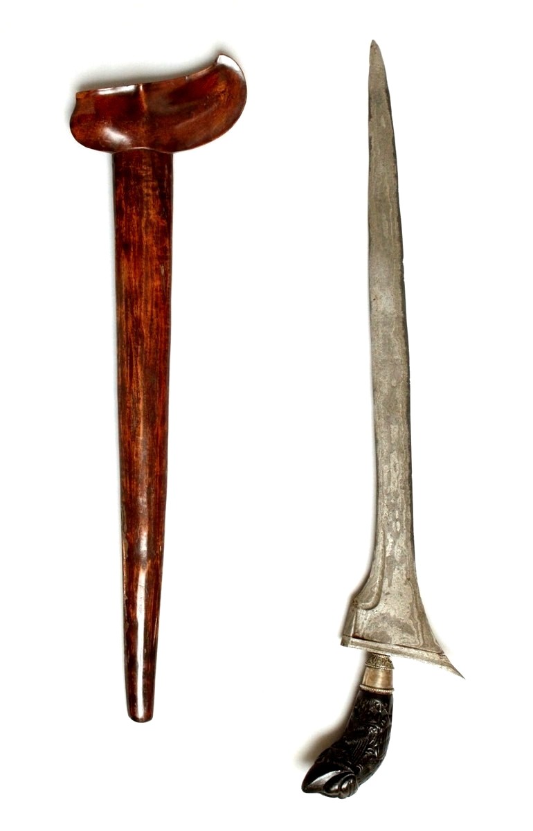

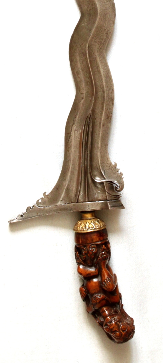

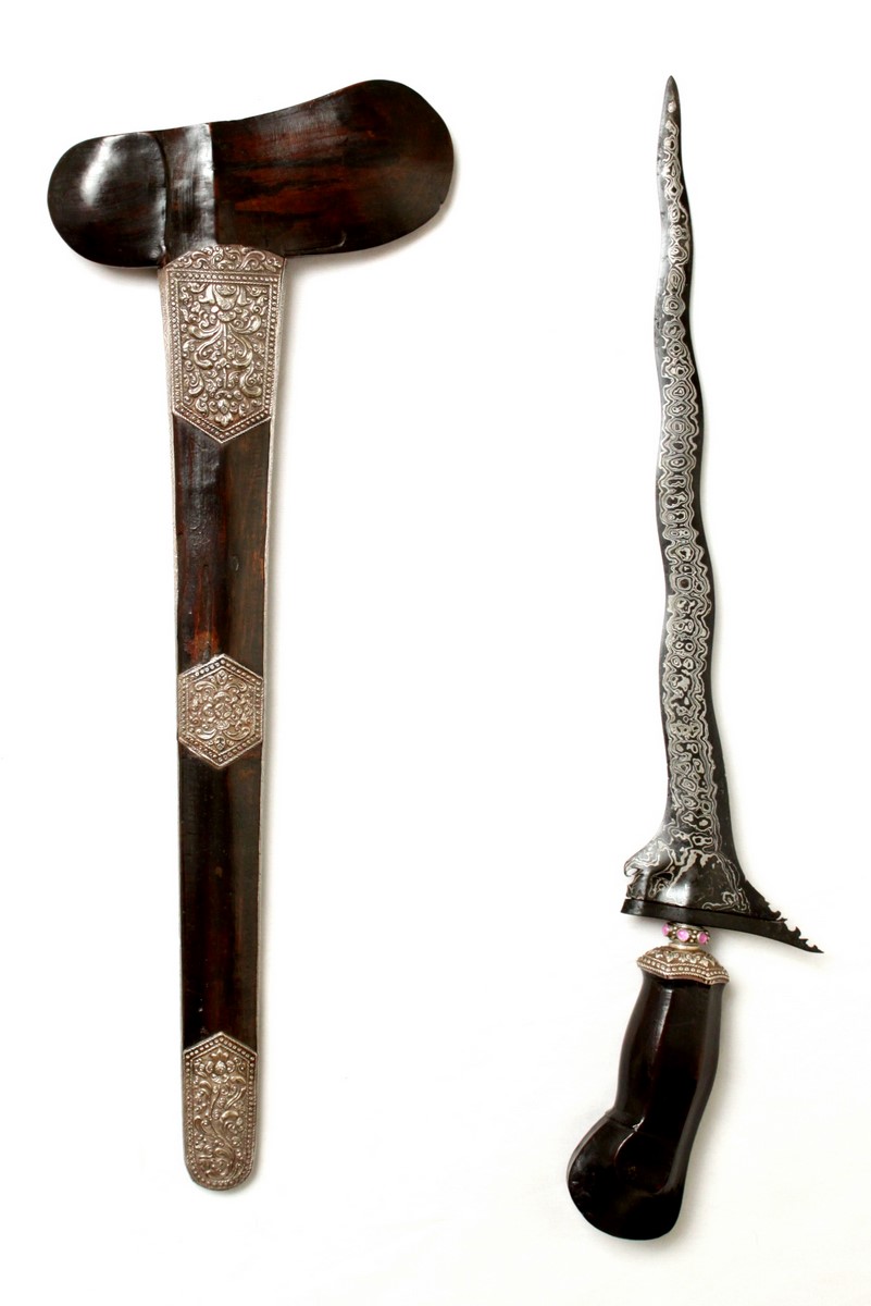

Hello Alan,
I attach my contribution with 3 unusually sized krisses:
. A typical large kris from Cirebon or the pesisir (blade lenght 47.5 cm).
. A relatively small balinese kris (blade lenght 36.5 cm, it has typical balinese features, however it may have been forged in Java or Madura).
. A small Minangkabau kris (blade lenght 22 cm). These krisses are often attributed to women but I saw several pics of such krisses worn by Minangkabau grooms.

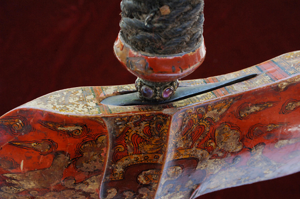

My shortest Bali keris is about 12.5 inches (31.75 cm). I am fairly certain this blade is of Bali origin. It also seems to be a fairly old blade. While this is certainly not short enough to qualify as a patrem by Javanese standards it is quite short for what we have come to know in Balinese keris. I doubt, however, that this keris was created for either a woman or a child. It is dressed in a full size painted Bali sheath that could accommodate a blade of much larger size, i image so that it can be worn in the traditional manner of Bali up the back with the hilt rising above the shoulder.

Old 6th April 2016, 11:08 PM   #5
Posts: 7,258
Thanks for your comments Jean and David.
Yes, North Coast Jawa/Tuban keris were often pretty "super-size", and Balinese keris, especially old ones, were frequently the size of Javanese keris, or even smaller.

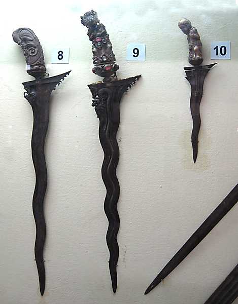

The photo I've posted is of a display in the Den Pasar Museum. You can see a couple of Bali keris of the size that we think of when we think of Bali keris, and another very much smaller keris.
The smallest Bali keris I have is 17.5" (445mm.) overall, and with an 8.4" (212mm.) blade. 5 luk., it is definitely Balinese and definitely old, I estimate probably pre-1800.
I do have a number of other Balinese keris that are about the size of Javanese keris, and I have a few big Tuban keris.
I used to have two Balinese keris that were only about 8" to 10" overall.

My deepest regrets Jean, but i am afraid you're just going to have to trust me on this one. The vast majority of my keris blades i choose not to post in public forums on as a matter of principle. While that sometimes causes me a twinge of guilt when others are so free with their postings, it is still my personal stance on the matter and not one i wish to change at this point. Whenever i have broken this rule i have always had regrets on that decision afterwards. So my humble apologies.
I can show you one image that shows the top of the blade in the sheath, but i am not sure it will satisfy your curiosity. However you might be able to at least see that it is not the meaty Bali keris we are most used to.
If this blade was not made in Bali it is probably from Lombok. It does not look like anything i have ever seen from Jawa or Madura and has clear Balinese indicators.
Hi David,
Thank you for your picture and it tells quite a lot actually.

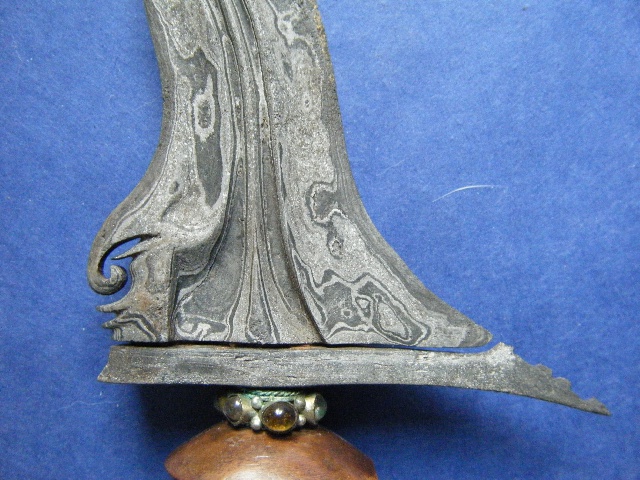

Hello Gustav,
Is this big, beefy blade (attributed to Blambangan or Banten?) as old as the 1500ties (16th century) in your opinion?

Good to see such blade posted on forum. Thank you Jean.
Could you perhaps also post the dimensions of it? If the blade has been shortened, the length of Gonjo ? From pictures I would say more probably 1600ties and it has something, which let me think of Sumatra (I am speaking about blade only). yet this isn't even speculation, just fully unsupported feeling.
There are more substantial specimens, and the most prominent one is the Keris from MVK in Vienna. The blade is 44 cm long, Gonjo 9 cm long. It is mentioned 1607 for the first time. The blade almost don't taper till the last Luk, if you see or handle it, you have a feel of a Moro blade.
I own a very similar blade, also 44 cm long, Gonjo 10,5 cm long, width just before last Luk 3,4 cm, last luk 3 cm. Comparing to it the blade you posted looks slender.

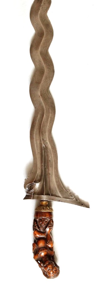

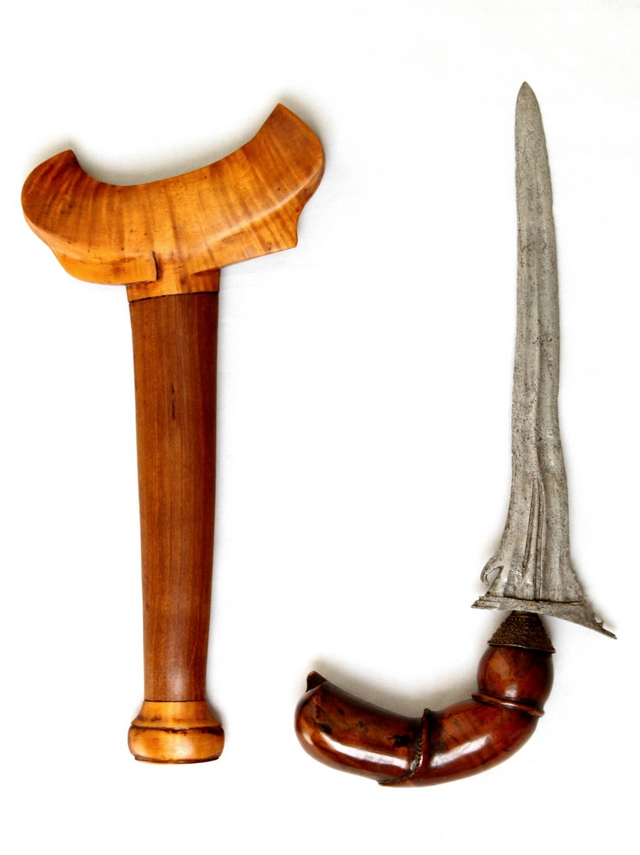

Here my shortest Bali blade, 331 mm long (without pesi), in comparison with a Central Java blade (370 mm) and a normal sized Bali blade (460 mm).
Have some thoughts about blade size but need to think about.
Hello Sajen,
Besides the twin lambe gajah (also found in Java), which indicators make you believe that this blade is Balinese?
Old 9th April 2016, 10:15 PM   #18
Originally Posted by Jean
Hello Sajen,
Hello Jean,
everthing by this blade let me think that it is a Balinese blade, starting by all features, the pamor, the feel and also the pamorless gonjo. At last I found it once on Bali, offered with many other Bali/Lombok keris. The wrangka is original and as well Balines, the gandar is a replacement but again Balinese. But can be wrong like always.

In respect of the middle blade that Detlef has shown us, from the photo I cannot tell if it is probably Balinese or not, the pamor material does not look Balinese in the photo, but it could be so.
If it is Balinese I would expect to see evidence of a polished surface, either still in full polish, or clear indications that it had been accustomed to be kept polished.
Of the ricikan that can give some guidance in blade origin, probably the most reliable is the ron dha, Balinese ron dha usually have a form that is not quite the same as most Javanese blades, but in this keris of Detlef's, the ron dha seems to be too heavily eroded to be of much use as an indicator.
As to pamorless gonjos, they can be found in Javanese keris of any classification, but most especially in Mataram Sultan Agung and earlier classifications. A pamorless gonjo is not a reliable indicator of a Balinese keris, and in later Balinese keris, say after the early 20th. century, gonjos with pamor are often found.
Then again we have the fact that many very early Balinese keris were in fact either made in a Javanese style or were made in Jawa.
Yes, we're all accustomed to seeing nice, big, shiny Balinese keris that are true works of art, but for the most part these keris are from the second half of the 19th century forward, and were seldom made for ordinary farmers and fishermen.
Similarly we are accustomed to the image of princes in court dress, or marriage dress, with their keris poking up behind the shoulder, but the vast bulk of Balinese people were not royalty, and they wore, and wear, a common sarung that finishes at the waist, often with a sash or belt to keep it up, and the keris is worn, by these people, at the waist.
So, Balinese keris are not invariably great big whackers, nor are they always so easy to differentiate from Javanese keris.
