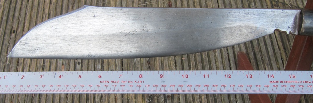

By my last trip to Indonesia I get a completely rustet stick sword from Solor (see Albert G. v. Zonnefeld, Traditional Weapons Of The Indonesian Archipelago, page 129). I have had removed most of the dark rust. After I have shown this sword to our member Roland M he offered a polish and etch of the blade. So a big "Thank" to him for the great job he have done. The blade show surprisingly a hamon at the edge. This blade is a high quality forged blade. Enjoy the pictures of this very rare weapon.
I just ask: why is it surprising?
Old 13th March 2016, 11:41 PM   #7
Hello Timo,
a hamon I know from dha but I have seldom seen it by Indonesian blades, most of the time this blades are laminated. To create a hamon is not easy and I am nearly sure that this blade wasn't forged by a local blacksmith from Solor.
Old 14th March 2016, 12:20 AM   #8
Posts: 6,441
I had the same feeling about my example.
I wonder where they were sourced from if not of local manufacture?
Old 14th March 2016, 12:31 AM   #9
A.G. Zonneveld write at the in up mentioned page about the stick swords from Flores which have a different blade shape : "Almost always these blades are imported from south-east Sulawesi, mostly from the Rumbia region, where swords of this type are called toa." But this blades are laminated so far I know.
Maybe Chinese blacksmithes?
Old 14th March 2016, 02:23 AM   #10
Timo Nieminen
Timo Nieminen's Avatar
Join Date: Mar 2012
Posts: 422
Hello Timo,
For low-tech metalwork (i.e., unknown carbon content, no thermometers or temperature controlled ovens), differential hardening can be easier than trying to achieve a uniformly non-brittle hard blade. If your blade is short enough so that edge quenching is practical, then all you need is a teapot full of water, e.g., as done for edge quenching of kukris (technically, you need the knowledge/experience to know what to do with the teapot full of water as well as the actual teapot).

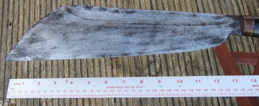

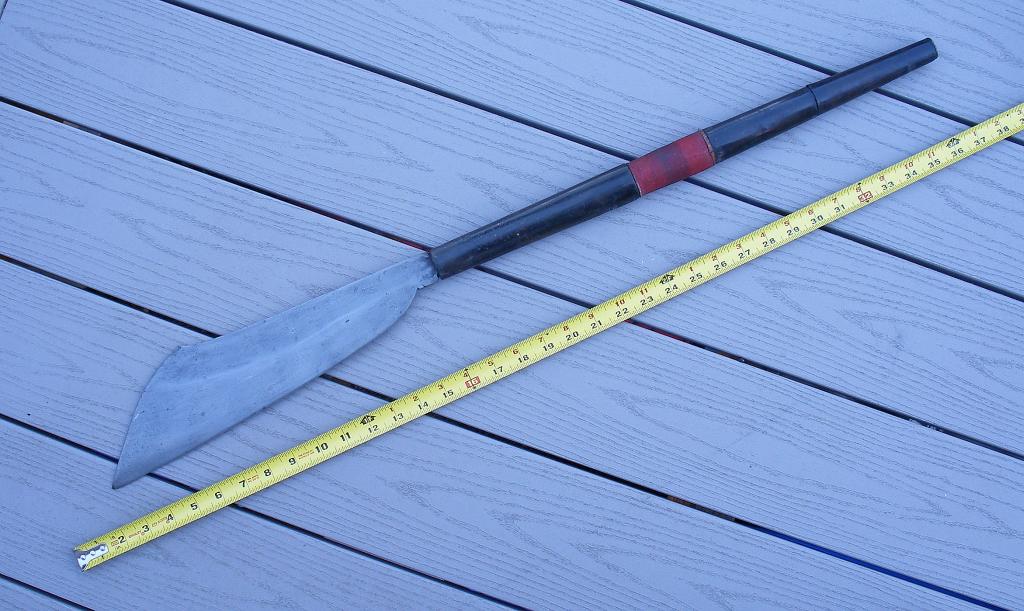

Posts: 445

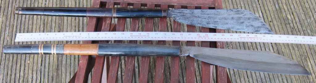

Default A couple more
Yes, I know, I am being greedy.

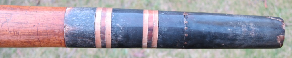

I have collected since the 70's and these are the only two I have ever seen. Both are horn, wood, horn although the horn is wrapped around the wood on the pommel end so I think they are one piece wooden hilts with horn decoration.
Sajen, I think you are correct about their rarity. Not surprising seeing the size of the Islands.
Roy

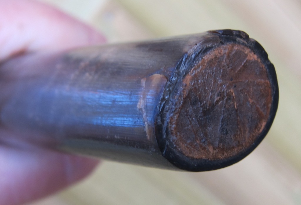

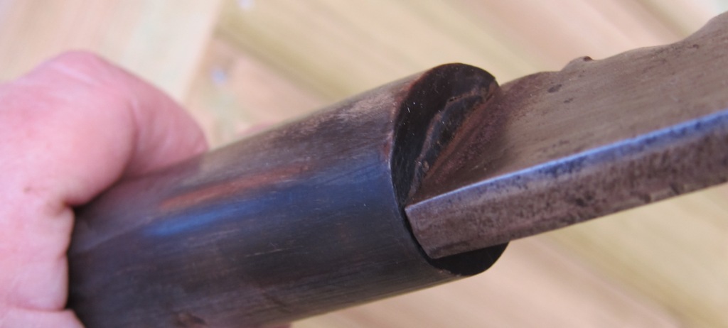

Old 14th March 2016, 06:39 PM   #12
Royston
Join Date: Mar 2008
Location: Poole England
Posts: 445

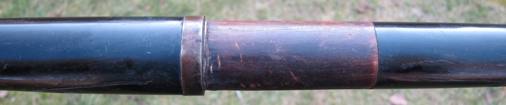

I forgot these two photos. Note how the pommel end shows wood with a thin layer of horn wrapped around it.
Roy
Hi Timo,
This blade is no low-tech metalwork, the blade is thin, tough, very sharp and absolutely flawless forged. This blade was forged by a master blacksmith. It is made from unknown type of crucible steel with very low contrast structure, possibly wootz. The high resistance against abrasion is an indicator.
A skillfull differential hardened blade has a very uniform hardness along the cutting edge. Differential hardening with clay on the blade is always more difficult than uniform hardening, especially if hardened in water. Many things are important like the temperature of water, the hardening time, the consistance and mixture of the clay and so on. The volume of hardened steel is bigger than unhardened steel, this causes tensions in the material. Even the best Japanese swordsmiths have lost blades during the hardening process because of hardening cracks (Hagire).
The temperature of hot steel can be controlled by its color. Well trained eyes do this with a precision of +- 10°C.
Roland

Old 16th March 2016, 01:43 PM   #15
Roy
Hello Roy,
thank you very much for posting your two nice examples, the one in up seems to be very similar to my posted example. May I ask how long it is overall and the length of the blade?
It's most interesting that the handles are not simple wrapped with horn but the horn is covered with a piece of horn without a joint, a technic I never have seen before. This is also the problem by the restauration of my other example.
Again, two very nice and rare examples you own!
