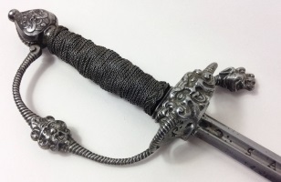

Hi Cathey,
Given the length of the blade you can be sure this is a blade of a small sword, its a blade not made for military use but for a noble men.
It is at its original length and not a shortened rapier blade, the sleek and slender point is an harmony with the whole blade.
The making of such a sleek and slender blade , extremely light, yet flexible but hard requires unique craftsmanship it is a work of art, these qualities can not be found in the hilt which looks more like a tool, which requires a different kind of craftsmanship.
Here are some examples of hilts that would go with your blade, since they are of comparable quality this is the style you should be thinking of.
The reason that someone at some point in time has brought these old parts together migth simply be that they were the parts that were available.
