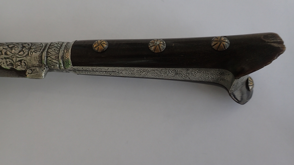

Default Yataghan dagger with inscription
A yataghan dagger with a silver scabbard. I think the dagger is newer than the scabbard, usually silver scabbards of this type do not contain daggers with black horn handles.

The Turkish inscription says:
Ustası Giridli Selim [1]322
“Its maker, Selim from Crete. [1]322 (1904-5 AD)“

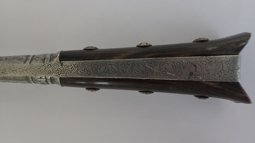

The drawing on the strip between the handles interested me precisely on the knife from the message #1.
This is a very interesting authentic Cretan knife.
If this is not a problem, please show this drawing .
And if you show it, then please show the hilts marked in the photo.

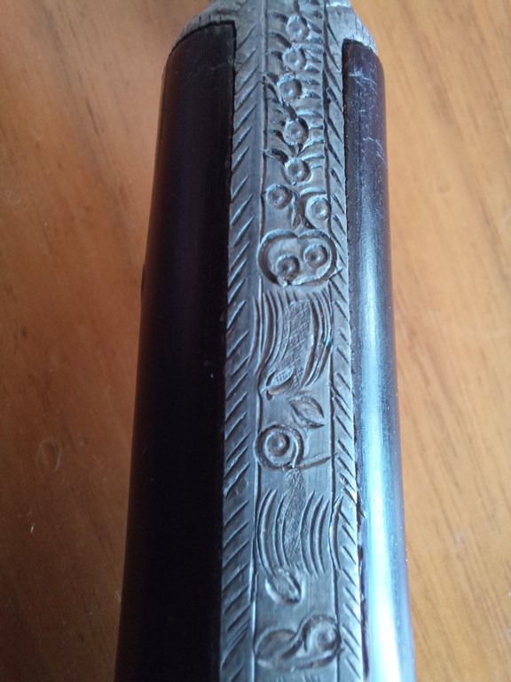

Here you are, for the others i am sorry is not possibe at the moment, when i will visit the bank safe next time...

The decorated center strip (which can be tin, bronze or silver) is highly decorated in variation which includes simpler geometric designs as well. This hilt element separating and securing the grips is termed 'tseberliki'.

Thank you for the photo, eftihis. I think on your knife is the same motive (not a design, it is various, namely an ornamental motive).
This motive is present on most tseberliki of old Cretan knives, sometimes in very developed and explicit forms, sometimes in simplified and almost unrecognizable forms.

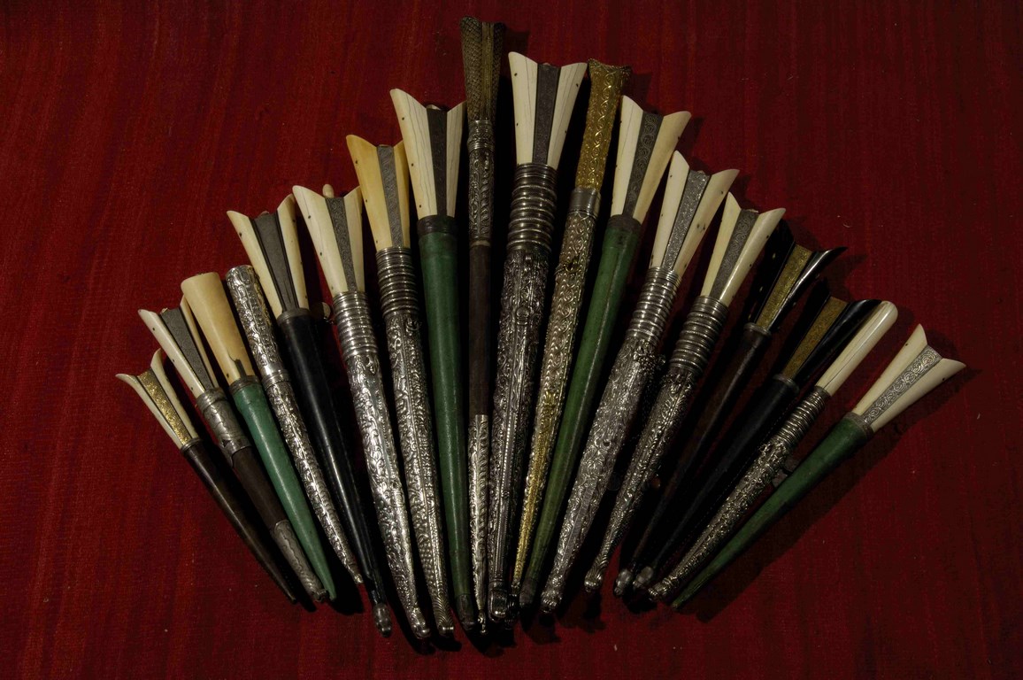

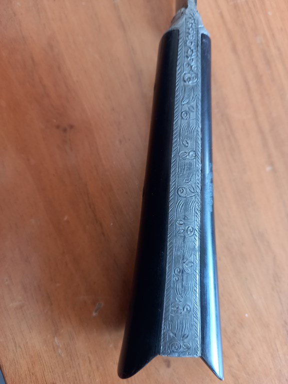

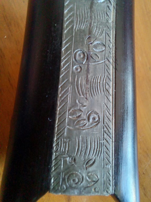

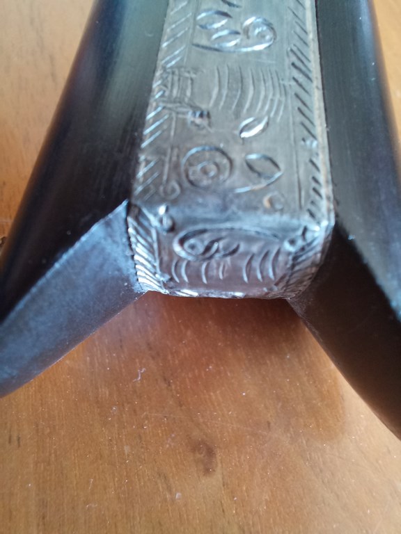

Saracen, here are some more... I am sorry i didnt have a better photo.

Thanks for the great photo.
