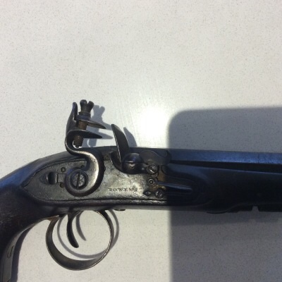

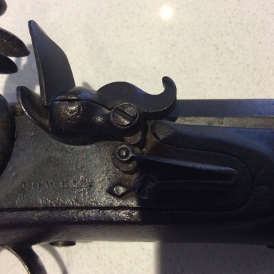

I recently purchased the attached pistol
It is maker marked to Fowler, I was told he was a Dublin gunsmith but I can't find nothing on him, does anyone have any information on this gunmaker
There is no proof mark on the pistol, this seemingly is common enough as ireland did not have a proof house.
Lovely tight well made pistol with roller on frizzen spring, snappy safety catch and silver furniture
Any information gratefully accepted
Regards to all
Ken

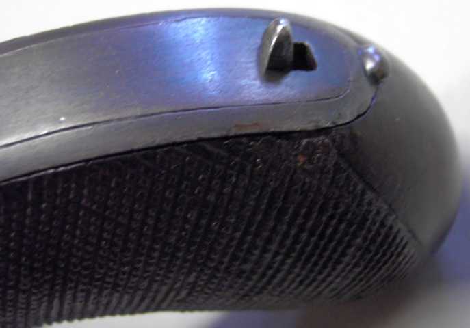

Is that a silver estucheon on the stock back?

Yes silver estucheon, with nothing engraved on it and silver butt cap

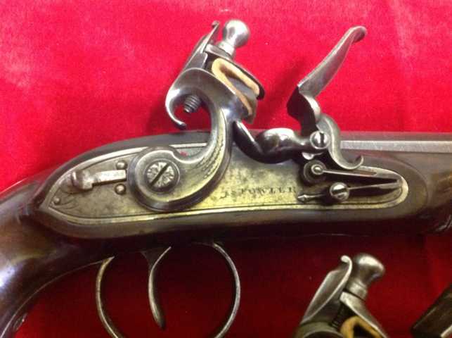

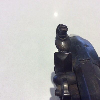

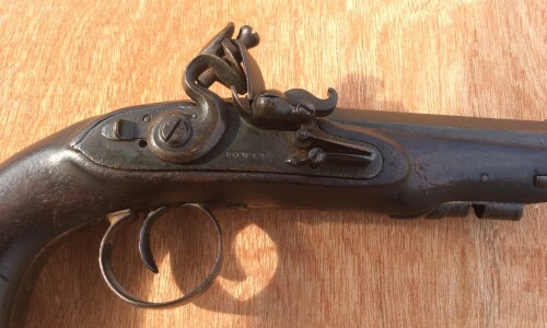

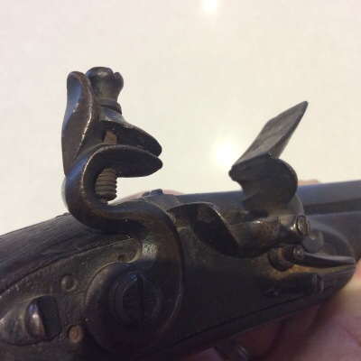

With respect, and without intention to disturb, I have caught my attention the geometry of frizzen seems cut, so that the cock not be stopped when it hit, before opening the bread. Also, I think the latch bolt failure. It would take a good photograph of the interior of the lock and the relative position of the parts of the lock.
Affectionately. Fernando K

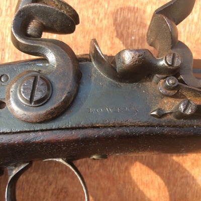

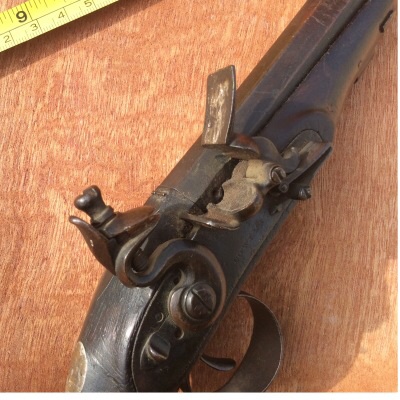

I have some extra images attached
I agree the top of the frizzen is missing a bit, but it fits perfect and I have added an image to show the hammer does match the frizzen in my opinion
Hope some more information can be gleaned
Thanks for observations
Sorry about bad photos, off to work and kids are acting up:-)
Ken

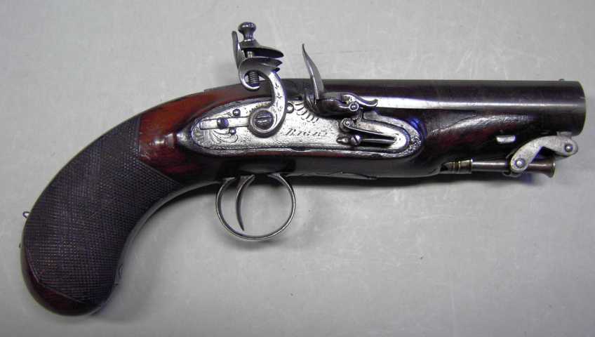

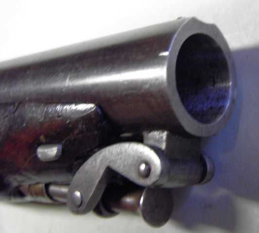

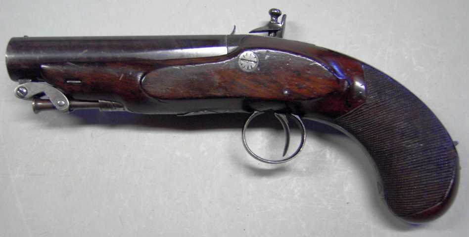

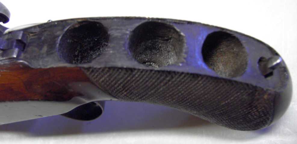

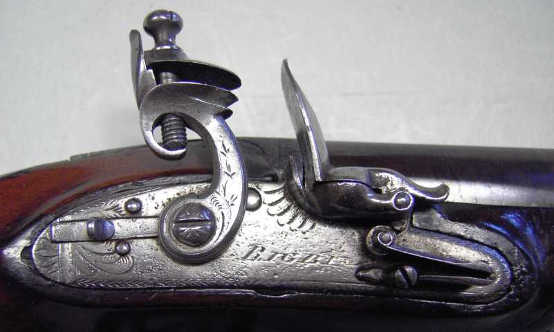

I want to add a very similar pistol of an other Dublin gunmaker. It is a flintlock-pocketpistol with a cartridge Magazin in ist stock for three rounds. The pistol was made by JOHN Rigby and is missing any proof marks as the FOWLER pistol.
The reason was probably the political situation in Ireland. Until the beginning of the Irish Revolution in 1798 the proof of all barrels took place in the "Dublin Castle". The proof mark showed two crossed hammers under a crown. These activities ended abruptly in 1798 and so all in Ireland produced firearms have not been proofed and got no proofmarks.
After the reception of the ideas of the French Revolution the Party of the politically extreme United Irishman was founded. Their aim was the total dissociation of Ireland from England and 1796 they had over 100.000 men under arms and got strong support from France. This movement was betrayed and the "Clearing" by the British army demanded more than 30.000 dead.
corrado26

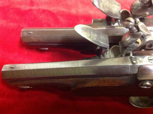

Posts: 1,268

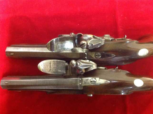

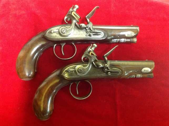

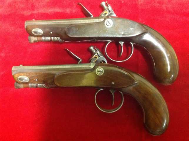

I just found fotos of a nice pair of FOWLER pistols in my Archive. These pistols are also made in Dublin and don't show proof marks too. Interesting is the Boutet style cock like an inversed "C" at both, the Rigby and the Fowler-pistol
corrado26
Old 14th August 2015, 10:11 PM   #12
Fernando K
Join Date: Apr 2010
Posts: 672
Hello
Rigby magnificent photographs and Fowler. I still think the frizzen this cut on purpose, to avoid collision with the cock in his fall. In any case, the cock has been replaced.
Would have to consider whether the tear line is spontaneous or has saw marks or lime.

Very nice pictures in the above posts.
The "French cocks" were quite popular in England & Ireland around the 1810 period, give or take a few years!
I wonder if the pistol in the O.P. has had the hammer (frizzen ) bobbed so that it would not be pulled open when withdrawing the pistol from an overcoat pocket?
It would be a bad time to lose one's priming, if the pistol was being withdrawn for defense!
Richard.
