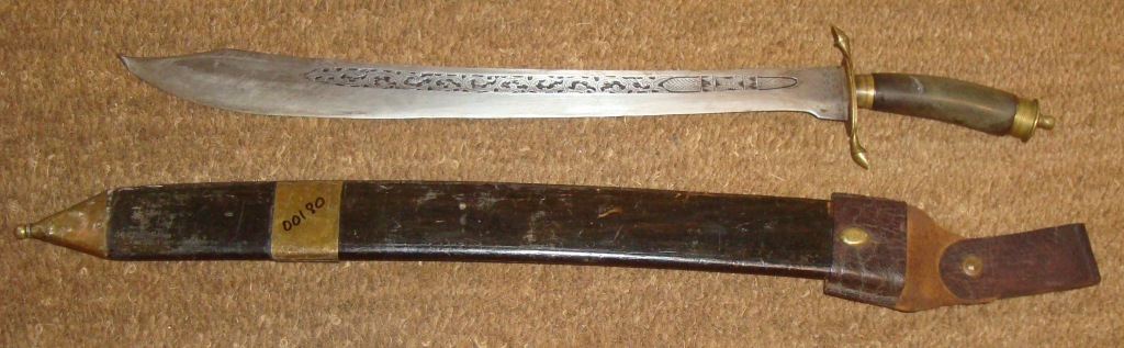

Hello Dave,
Bit of a coincidence here. Bought this a month ago and was wondering what it was. Not seen one before.

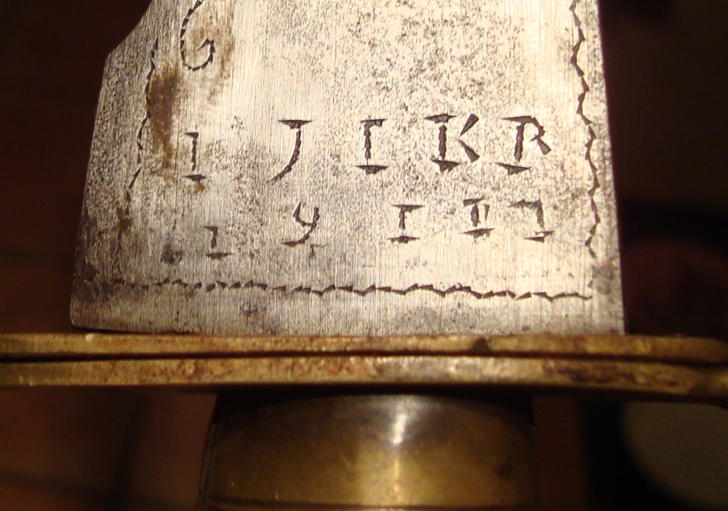

I can't really make out the name and I don't think it matches the names you have listed, but it's a nice piece anyway.
it looks like ? JIKR with a date below of 1911 and ?
Photos aren't good but feel free to use them if you like.
Hilt is horn with brass fittings. Scabbard is wood and brass.
Frog is unmarked but presumably nicked from a military weapon.
O/a length is 26.5 inches
Blade length 20.25 inches
Blade thickness is 0.25 inch.
Roy
Old 28th February 2015, 08:53 PM   #3
Posts: 7,274
I think that might be an abbreviation for Tjikeroeh. Nice sword.
Old 1st March 2015, 05:46 AM   #4
DaveA
DaveA's Avatar
Join Date: Apr 2007
Location: Wisconsin, USA
Posts: 442
Agreed. Sometimes just the initials appear.

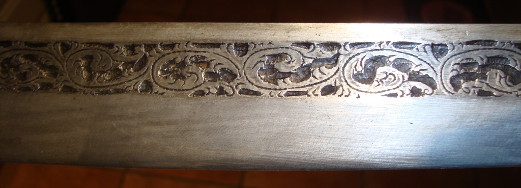

Default Interesting Okir
Roy, thanks for the post.
This is one if the group, definitely. The Okir design is one I have not seen before. How does the sword handle? In my experience these weapons are very well balanced.
Dave

Old 1st March 2015, 12:59 PM   #6
Royston
Join Date: Mar 2008
Location: Poole England
Posts: 443
Dave
It handles well. Quite heavy for it's length at 786g ( 27 oz )
The blade does not reduce much at all in thickness over it's whole length so it would deliver a substantial blow.
Roy
