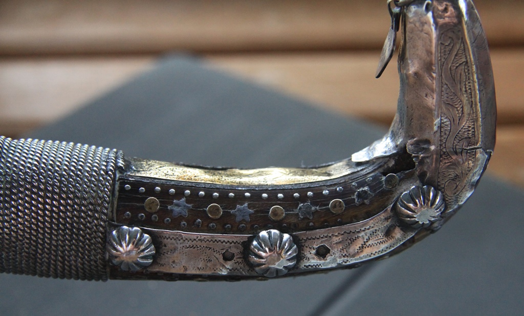

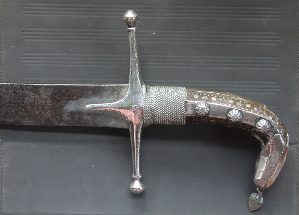

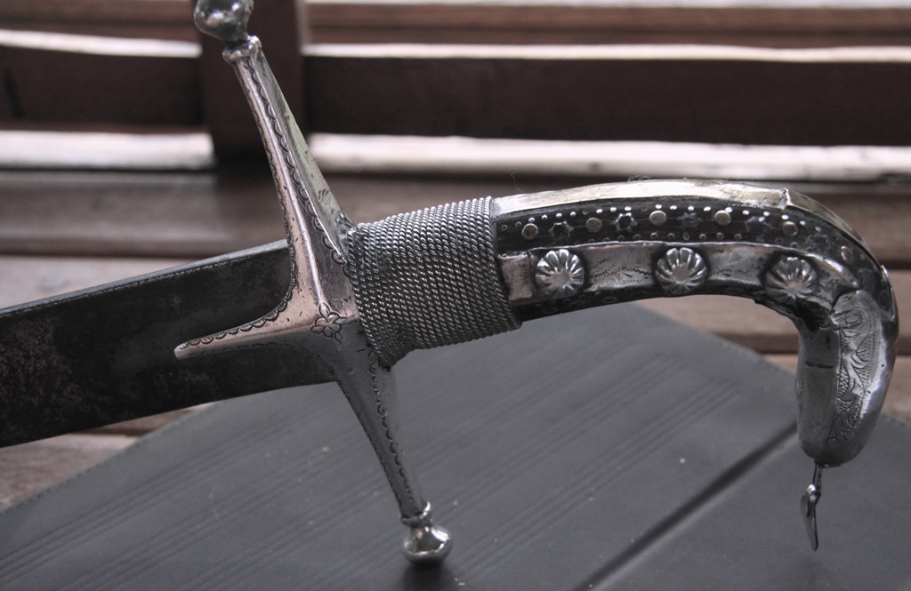

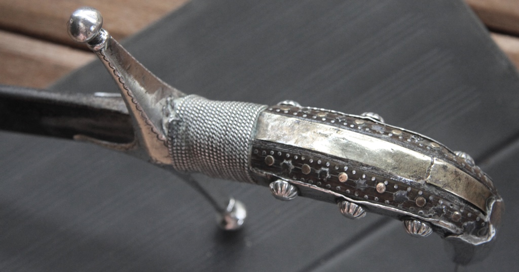

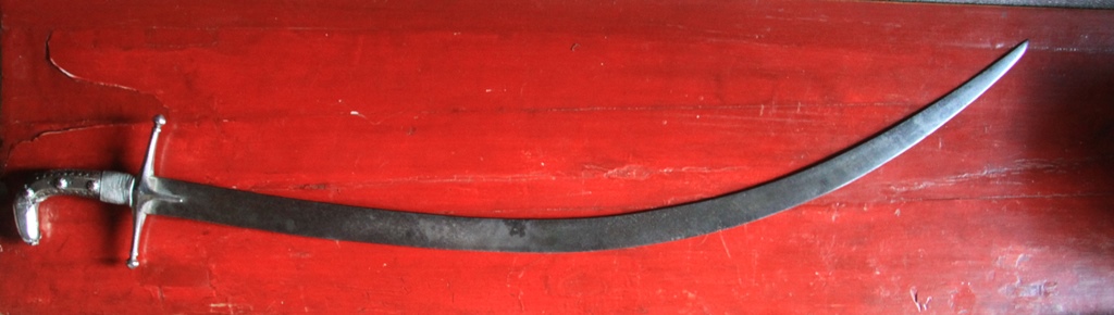

Is it still not clear for me if it is a Arab saif of Syrian style or a Kilij saber .

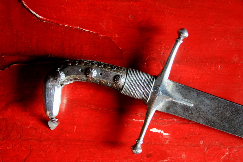

It is a silver mounted saber with a tear shaped silver dangle attached to the tip of the pommel cap by a loop
Overall length: 98 cm the blade 86 cm W 3.5 cm.
Is it a 19 Th century saber or later ?
Any comment on it will be welcome.
best
Cerjak

Posts: 7,374
From what I can tell, it is indeed Syrian, especially in hilt style.
Old 21st February 2015, 09:13 PM   #3
Yes, Syrian
But what about the blade, do you have any marks?
Could be Persian... Doesnt look styrian or Eastern European as it was often the case...

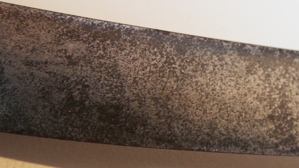

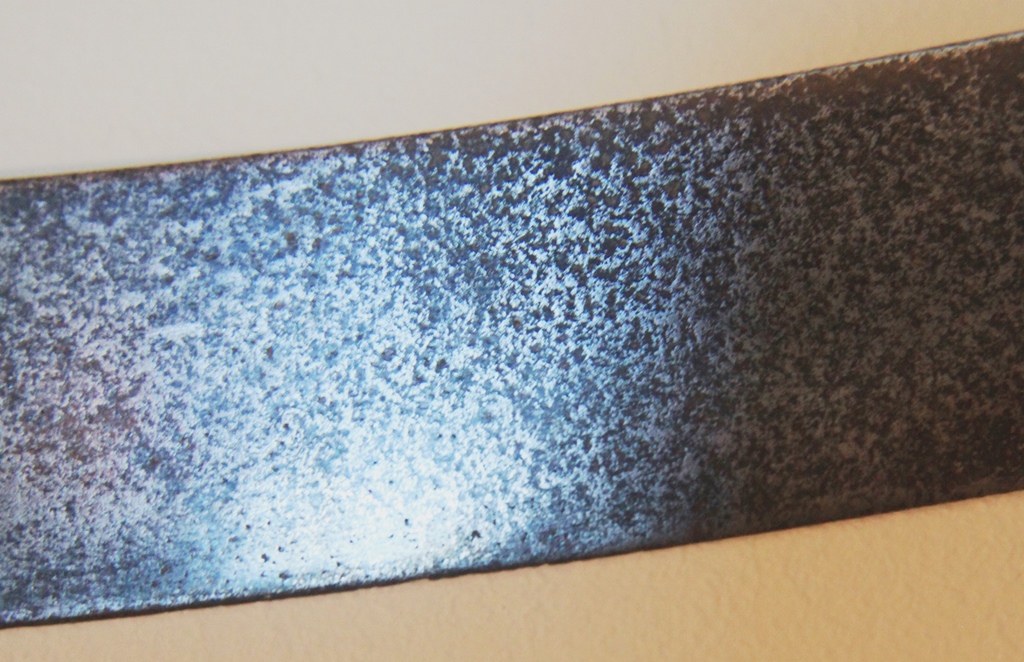

Posts: 7,374
Can you provide close ups of the blade where it is clean?
Old 22nd February 2015, 05:23 PM   #7
Posts: 7,374
Hard to tell what kind of wootz, if any, is in this blade. The type of wootz would indicate if Persian or Turkish, or if it is pattern welded.

Posts: 1,340
Hard to tell if its wootz or not without a clean up and an etch. With Syrian hilted swords I am less inclined to say something is wootz with such condition, that is because the industry there can make blades in any shape. What can help us further if you take photos of the spine, it may show a hairline crack on the spine and the Syrian craftsmen often make swords with odd distal tapering. But this one looks genuinely old, the hilt too, maybe 19th century as its silver fitted. The iron fitted ones are often early to very late 20th century. Worth checking if its silver and not some white metal.
Hi A.alnakkas
I have check the saber but I did not seen any hairline crack on the spine.
About the hilt there is no doubt it's silver .
Best
Cerjak

Not looking for the hairline crack mainly. The distal taper on Syrian made blades (usually later) is usually without a distal taper so its a sign but not a definitive one.

Posts: 334
Syrian handle, apparently persian blade, turkish-style guard (long, thin prongs).
