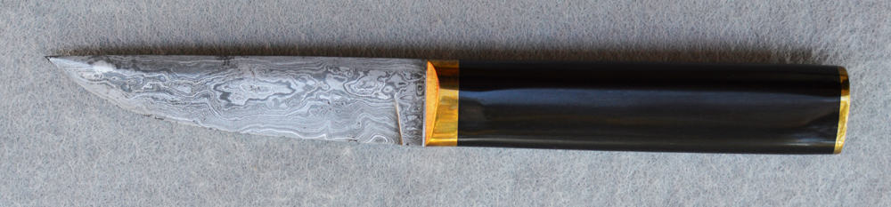

I have etched a lot of blades, but I'm no expert. My method is in this thread.
Etching
I have read that doing the first neutralization with vinegar converts some chloride ions to a non corrosive form. (I'm no chemist) I then rinse and neutralize with ammonia, then with a slurry of sodium bicarbonate.
I've never had any corrosion or rusting issues doing it this way.
Good luck sir!

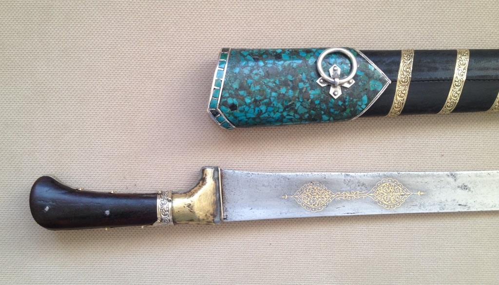

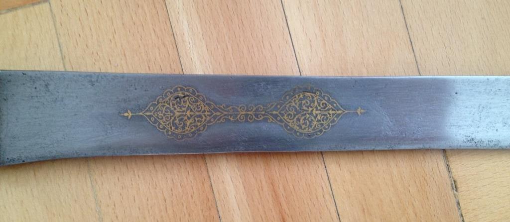

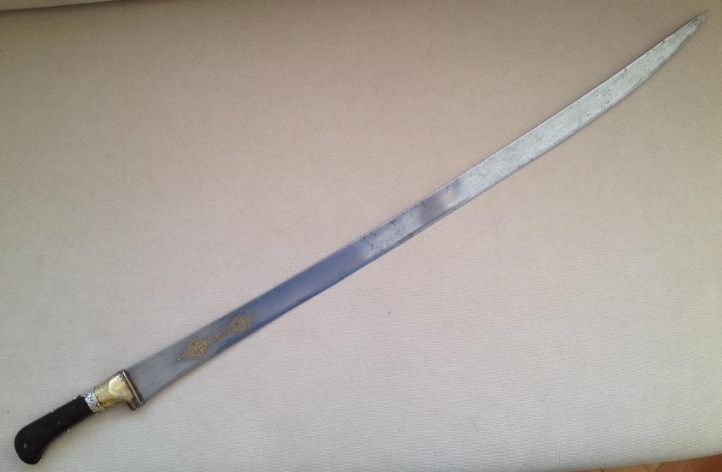

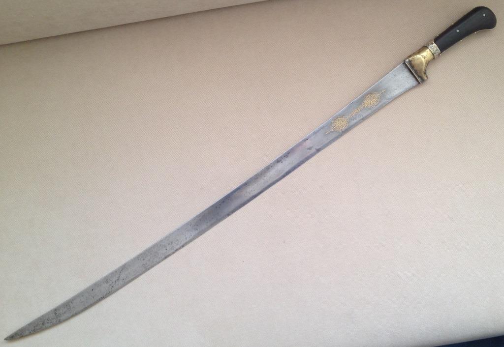

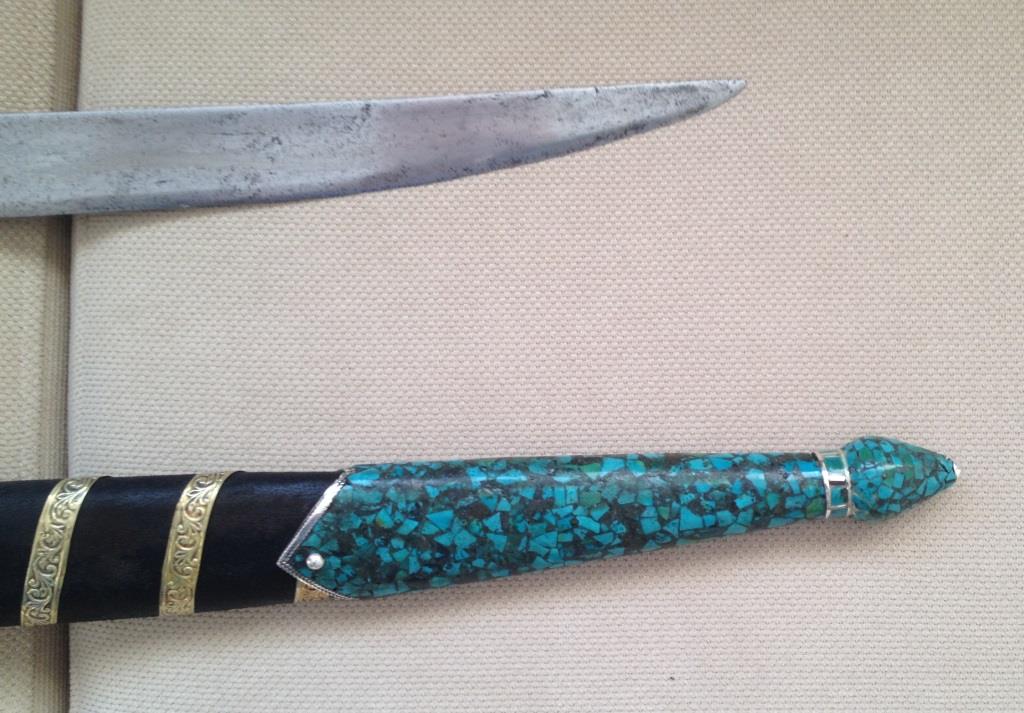

Unfortunately, miracle did not take place and I found out that the blade was made of, I would say, normal steel (there was some parallel lamination, but always accompanied with relatively deep pitting, so I better polished it again after three very quick attempts.
Very important was the piece of info from Spiral "to have uninterrupted time, turn your phone off & don't answer the door!". But when I cut my finger and the result was not "slightly yellowish", but "reddish", it was like phone ringing and at the door knocking etc altogether.
This is also the sword from this thread: http://www.vikingsword.com/vb/showthread.php?t=19145
And Here are the requested close ups - but as I said, no "damascus".
Thanks once more
Martin

Ahh that's only flesh though... that heals... the blade is what matters!
Mmmm so the hilt straps are re built by the same chap who made the scabbard it seems?
If blade was mine Id give it a little go with pineapple juice to see if that brings anything else out.... not all etchants work equally on all blades in my experience.
