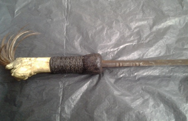

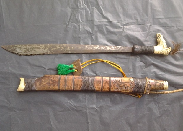

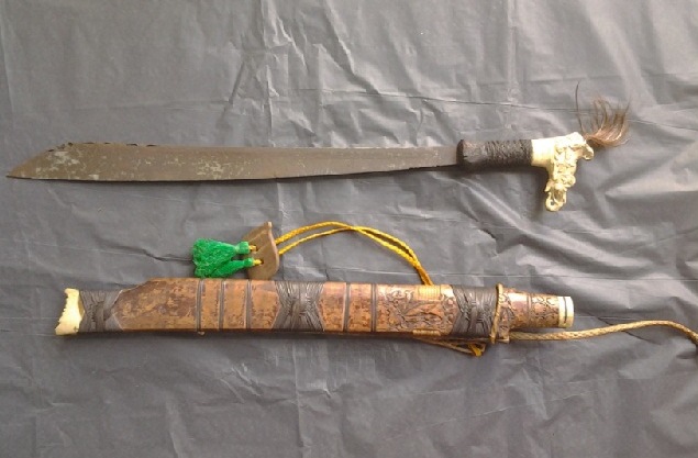

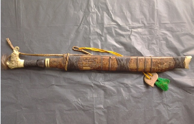

Hi;
Sorry for these seemingly basic questions about mandaus
1) Can one determine where a mandou comes from based on decoration and shape of the hilts eg, Serawak orang Ulu? Iban? etc? Kalimantan ?
2) Can one determine if a mandau is made for ceremonial dancing or mainly utilised for head hunting (in case of old antique mandaus)
3) It has been explained that mandaus that have been used for headhunting in the old days (19th century /older) are marked with 'notches' at the base near the hilt? can anyone show examples of this.
I have here a mandau (not a particulary good one) which has a typical concave and convex blade sides , a scabbard that looks quite old with varnish peeled off and showed some patina but I guess was made in mid 20th century based on the plastic ropes with green tassels attached. (may have been later addition though). The hilt is carved with elephant trunk motif. Can anyone identify where is this likely made?
There are 4 notches at the base of the hilt , I don't presume these are notches of heads taken as they look too well made and I guess they are merely another form of decoration.

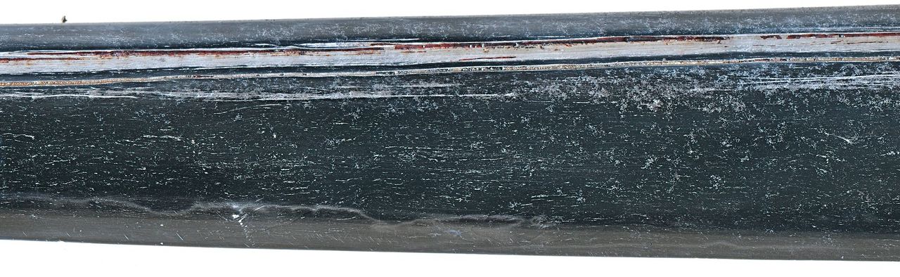

here are the notches i meant.

Hello Green,
1: I would say a nice Kayan mandau, but I'm no expert.
2: A head hunting mandau is thick at the base, sharp, quite heavy, forward balanced, often "decorated" with nicks and has a concave/convex blade. The best head hunting mandau are made from clay tempered, laminated high quality steel with a beautiful hamon. I have one of these .
3: I heard, that the number of brass points in many mandau are equal to the number of "purloined" heads.
Roland

Posts: 10,872
While my knowledge on these and many of the Indonesian, SE Asian forms is admittedly quite limited, from discussions over the years here, it seems that the concept of 'notching' signifying some sort of tally for heads taken is a rather 'perceived' western notion . It is the same for the brass filled holes in the blade.
Actually the brass filled holes seem to correspond in some degree to this practice in many ethnographic settings; in Arab/Mamluk swords there were often a number of brass or gold filled holes in the blade which are believed likely to be talismanic for good fortune and power to the wielder . This same type of practice is found in North Africa as well as in Europe in degree in varying cases, actual meanings unknown.
As far as the notches in the back of the blade, these of course are believed significant symbolically though not in a tally sense. It seems these occur in many SE Asian dha, and in my own experience, the same type lines, sometimes diagonal, are tribally aligned (in one I had which was traced to a Hmong tribe in a Laotian context, Montagnard from Viet Nam, 60s).
Headhunting itself was of course outlawed in the early 20th century, but naturally old traditions may remain in degree in more remote regions.
The idea of regional attribution with any degree of certainty is a very slippery slope indeed with ethnographic arms, though one might find a certain proclivity of form or decoration to a defined area. There are I believe some good images in the Holstein reference from 1930s (cant recall the title offhand, but Im sure the much more informed group here who collect these can help out).

Jim:
I agree strongly with the idea that brass inlays of the face of blades are probably of talismanic importance or purely decorative. They are found occasionally in mainland SE Asian blades, as well as some from southern China (Yunnan). I have several dha/daab/dao with inserted dots towards the tip. The "notches" on the back of these swords are a relatively recent phenomenon and purely decorative (according to native informants). Since the bronze inserts are part of forging the blade, it is highly unlikely they indicate what would happen when the blade was used subsequently. Likewise the file work and copper or bronze inserts on the spine of the blade are put there at the time the blade is made.
The idea that these features represent some tally of kills or heads taken is not supported facts, and yet the notion continues to be spread, perhaps as a marketing tool by a few sellers of these items.
I think it is important that this Forum debunks such myths as often as they come up. I mean no disrespect to Roland_M or Green in raising this point. They are not alone in having heard these rumors, and I want to thank them for raising the issue again just so we can remind our readers of the facts as they have emerged in these pages over the years.
There is always the possibility that what has been stated as "factual" may not be universally true. If anyone has firm ethnographic evidence that a SE Asian culture kept "score" of an individual's kills or heads taken by marking his weapon, then please report it here--it would be important new information.
A further note on mandau. The reports of early travelers in Borneo noted that individual natives usually owned several mandau. These were all purpose tools and weapons that were made by the respective owner. Within an individual's arsenal there could be wide variation in decoration, carving, weight, length, etc. A tribal leader might have 20 or more mandau.
Ian.

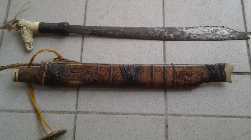

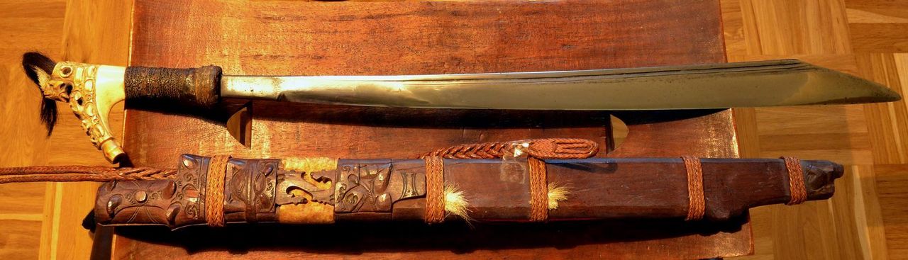

This mandau is from the upper Mahakam area, Central Borneo, kayan tribes.
If this mandau was an old one, it would have been used for everyday tasks of which an axe would be too rough and a knife would be too small.
When dayaks went for travel, they used their average mandau, which was used for cutting branches, and also for headhunting when the opportunity arose. Dayaks had several mandaus, but always took one with them on expeditions.
The mandaus with beautifull inlaid blades, often were used as "show off" weapons, but also with these it can not be ruled out that branches had been cut with these to get through the jungle, and ofcourse also with these mandaus heads had been taken....
Other mandaus had been used for other occasions, like dancing, ceremonies, offerings, weddinggifts, graves and other rituals.
These notches at the base, where the edge begins, had been made by the smith right away. And not later when it had been used for headhunting.
Looking at all aspects of your mandau, I think it even could be more recent as mid 20th century. The hilt, though in good porportions, had been carved very "clumsy" in my opinion. Also the blade is different as the old blades I have seen of this type.
Also I agree with Ian and Jim. The inlay of the blades had been done during the whole forging proces of the blade, and not afterwards.
But besides of that, sometimes there could be other traces, put on later as a "decoration" to show heads have been taken with the blade. These "headhunting" marks are divergent and much less in quantity as the many brass dots we sometimes see on mandaublades.
The beautifull Longglat blades, with beautifull portrusions and many inlaid motifs and dots of silver, brass, suassa or even gold, where well known and also traded with dayaks from other tribes.
It would be not likely to trade heavily decorated inlaid blades when they took heads with it. This because dayaks would never dare to possess a blade which would be too powerfull for them, because they took many heads with it. And secondly it isn't likely that a dayak which has a "loaded" mandau because he took a head with it, would ever sell his blade to other dayaks for trading....

Returning to 'notches' I agree that these must have been applied as the blade was produced, and perhaps might have been makers markings or possibly tribal associations etc. . Once again with reference to the 'west', the notion of gunfighters notching their guns, this was purely fabricated and as far as I have known, not a single gunfighter among the 'legends' ever notched their guns, nor would they so deface their trusted weapons.

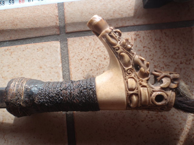

Roland;
Many thanks for the comments! would love to see pics of your headhunting mandau!
Hello Green
Quite late, I'm sorry, i have a summer flu, but here it is. I will introduce it in a few weeks with better pictures.
The laminated structure and hamon are a little weak but still good to see.
The deep polish was neccesary, because the previous owner used an angle grinder to remove the rust.
Roland
