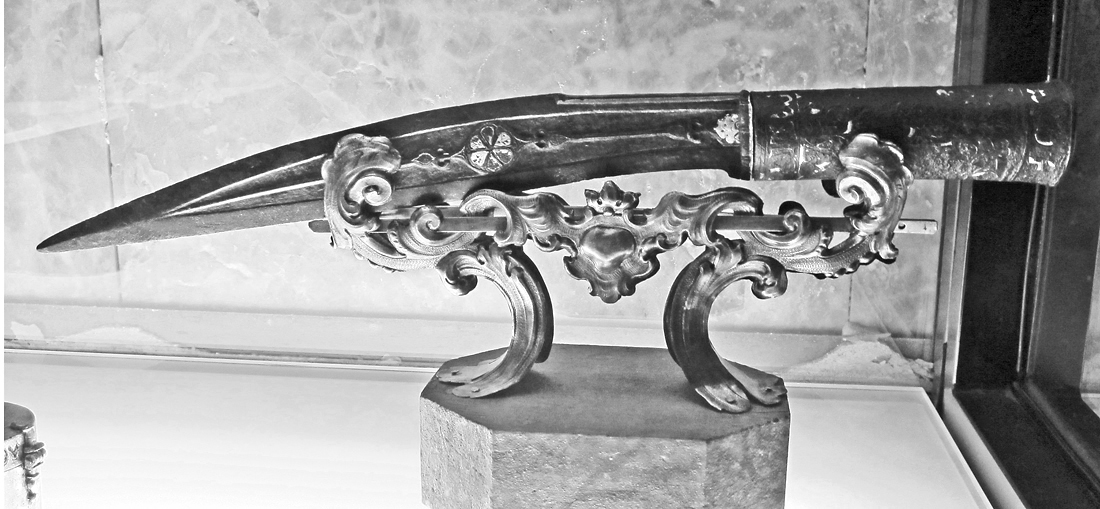

This dagger can be seen in the Treasury of the Basilica San Marco in Venice, Italy.
It is identified as 14th century and named "St. Peter's Dagger"

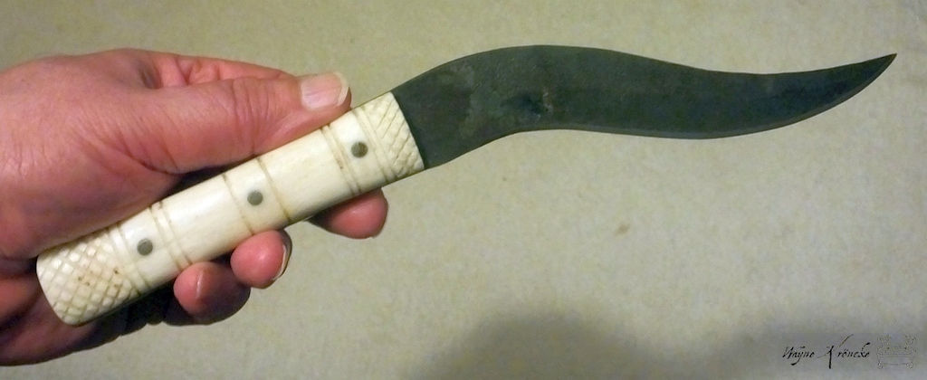

st. peter came from the middle east. more specifically, syria. as most people travelled armed in those days, especially in the far provinces of the empire, i'd guess he obtained his dagger in palestine or syria before he journeyed to rome as an old man. at least if we believe it was his. for interest, judas was thought to have been a sicarii (dagger man).
reminds me a bit of a roman utility knife:

The form of the blade and chiseled motifs, fullering and the shape of the grip all support a mid-late 15th century Ottoman attribution. I wish the pic was clearer; the motifs decorating the grip would prove illuminating.
Oliver
Old 7th August 2014, 10:53 PM   #15
Posts: 7,230
Oliver, we're lucky to have any photo at all.
Photos in this part of the Basilica are strictly forbidden.
Oliver, i've turned it B&W and opened up a the shadows a bit. Not ideal, but it may help a little.

Alan, did you take the pic? Wondering how large it is.

Its in a glass case, I'd guess maybe 15", end to end.

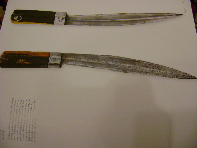

I would just want to draw your attention to 3 daggers from the book of Bashir Mohammed, - Furussiya Collection. All identified as Timurid Afghani, 11-12th century.

Posts: 7,407
Timurid Afgani - not crossed my mind. Does slightly remind me of the profile of an Afgani kukri........

Brilliant, Ariel. I was just readying the camera to shoot those images.
The St. Peter dagger is certainly of this family, but I don't agree they are from Timurid Afghanistan. I'm not sure the authors are, either-- note that in the description, the first line reads, "This dagger is said to have been found in present-day Afghanistan."

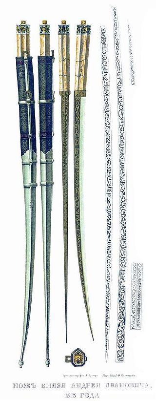

And then, there is this enigmatic knife of Prince Andrey Staricki of the early 16th century, the origins of which are still hotly debated in Russian sources, although, IMHO, they are fairly obvious: Islamic, Persian, Mongol,- choose your definition, but no matter what, - Eastern.

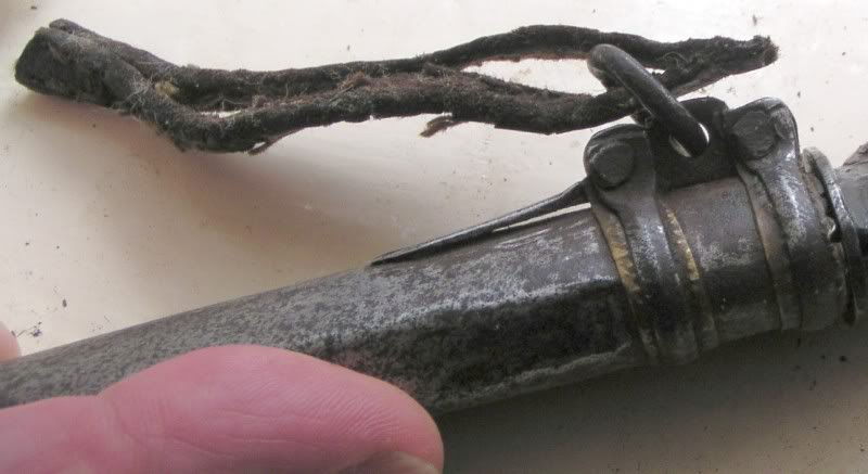

Ariel, I agree one can certainly argue the boundaries- to the degree there were any-- to the lands of the Afghan tribes; for the "modern" boundaries of Central Asian states, we have mostly Stalin to thank. On the other hand, the designation "Central Asia" specifies a geographical region, it isn't a political distinction.
An observant friend who has been to St. Peter's recently provided the image I've attached below. It shows that the grip of the dagger is ferrous metal, and was chiseled overall originally-- probably inlaid with gold or silver at one time as well. The image also makes it clear that the band around the pommel contains an inscription in Arabic characters. Based on this, I would argue that the dagger is in a homogenous state, which allows it to be associated with two of the examples pictured in The Muslim Knight cited above, numbers 138 and 139. The authors suggest that those examples may have been produced during the Ghazavid era in Central Asia. By comparison, the blade of the St. Peter example is more substantial, and the overall quality and complexity of the blade, even taking into consideration the condition of number 138, is substantially higher. Further, the grips of both the published examples are, or were, organic. The St. Peter dagger has an iron or steel grip, given the type and degree of corrosion. For these reasons, I would provisionally attribute it to a form that existed in Central Asia (and may well have evolved there) but was produced in an Ottoman or Safavid (or pre-Safavid Akkoyunlu) workshop, probably between 1400-1500, based upon the motifs which appear on the blade, i.e. the Timurid trefoils and segmented sun disk.
I don't think the Staritski dagger is much of an enigma. It's a Central Asian bladeform that survived into the latter 18th century; the suspension system survived even longer. The forward-curving blade remains in use by Persian, Mughal and even Ottoman smiths up to the latter 19th century; it seems to be a simplification of the very complex blades discussed above. The real key to attributing the origin of that type is the scabbard. Note the strip which runs up the back of the scabbard-- it is set with a ring at the top and bound by a series of bands. This characteristic survives on elaborately-decorated kards of 19th century Bukhara and Khiva, among other Central Asian daggers. It is also found on some Tibetan weapons and I've even seen Chinese trousses that make use of it. Too, the long chape terminating in a bead is retained on the scabbards of "Khyber knives" dating well into the 20th century. So yes, definitely Eastern....

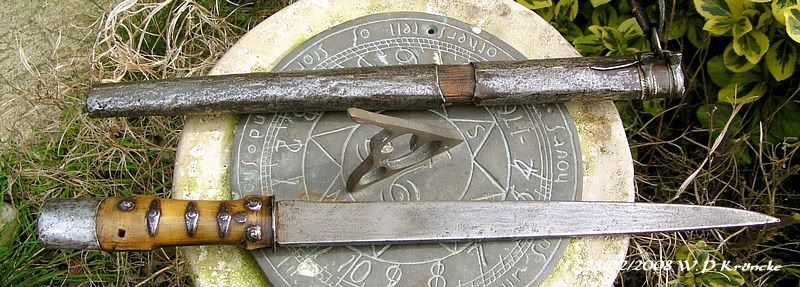

The real key to attributing the origin of that type is the scabbard. Note the strip which runs up the back of the scabbard-- it is set with a ring at the top and bound by a series of bands. This characteristic survives on elaborately-decorated kards of 19th century Bukhara and Khiva, among other Central Asian daggers. It is also found on some Tibetan weapons and I've even seen Chinese trousses that make use of it. ...
my old chinese/tibetan knife with two bands and the strip:

No argument here: Central-Asian origins, actual manufacture 14-16 century Persia or Mughal India. My only hesitation is with your mention of its potential Mamluk origin. Perhaps, we did not understand each other's intentions. But so be it, end of disagreement.
The Staricky's dagger still is a subject of vicious, murderous arguments on some Russian Forums. I do not have to tell you about the nationalistic currents in the Russian history of everything: who invented radio, airplane, steam engine and shashka, the Fourth Rome etc. The prevailing view there is that Staricky's dagger is an example of pure Russian origin and tradition, although some brave souls try to tie it to the Vikings' skramasaxes( well, Vikings were part and parcel of Kievan Rus etc, but Asians did not leave any imprint on the pristine body of Russian culture :-)). I tried to draw their attention to the very same features that you have mentioned, but was summarily shot as a secret agent of the Mongolian Horde:-)
And still.... The enigma of that dagger is in its inscription: pure and unadulterated gibberish, but imitating Arabic script. To me it suggests that the dagger might, -just might! - have been made by a Russian master who tried to advertise it as a genuine "Eastern" object.
There are very few 16-17th centuries iconographic evidences of its presence in the suit of arms of Russian nobility and even fewer actual examples. But they do exist, just like St. Peter's dagger..... I think they might be reasonably close cousins.
