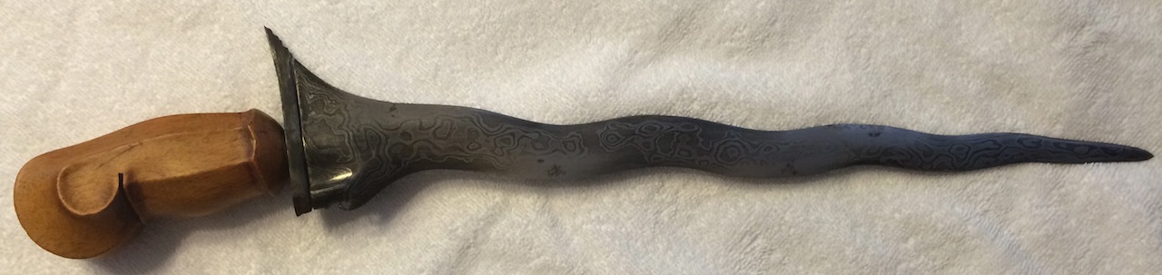

Hello everyone, I thought I would try to elicit some responses on yet another keris, purportedly from Bali. Its not very big, the blade is perhaps 11" long. The gajah, if that is the right term, is very fine, about the thickness of a dime if even. I am of two minds, one part of me wants to renew the pamor and clean up the one one section of pitting. The other wants to let well enough alone.
I don't know anything about this keris except where it is said to be from, what the pamor is, what social position it represents, or anything. So, any hypotheses, theories, or conjectures are appreciated.
One more thing, I think its from an old European shop or collection, it has some kind of glued on tag but it was written in pencil, long ago mostly worn off.
What do you all think?

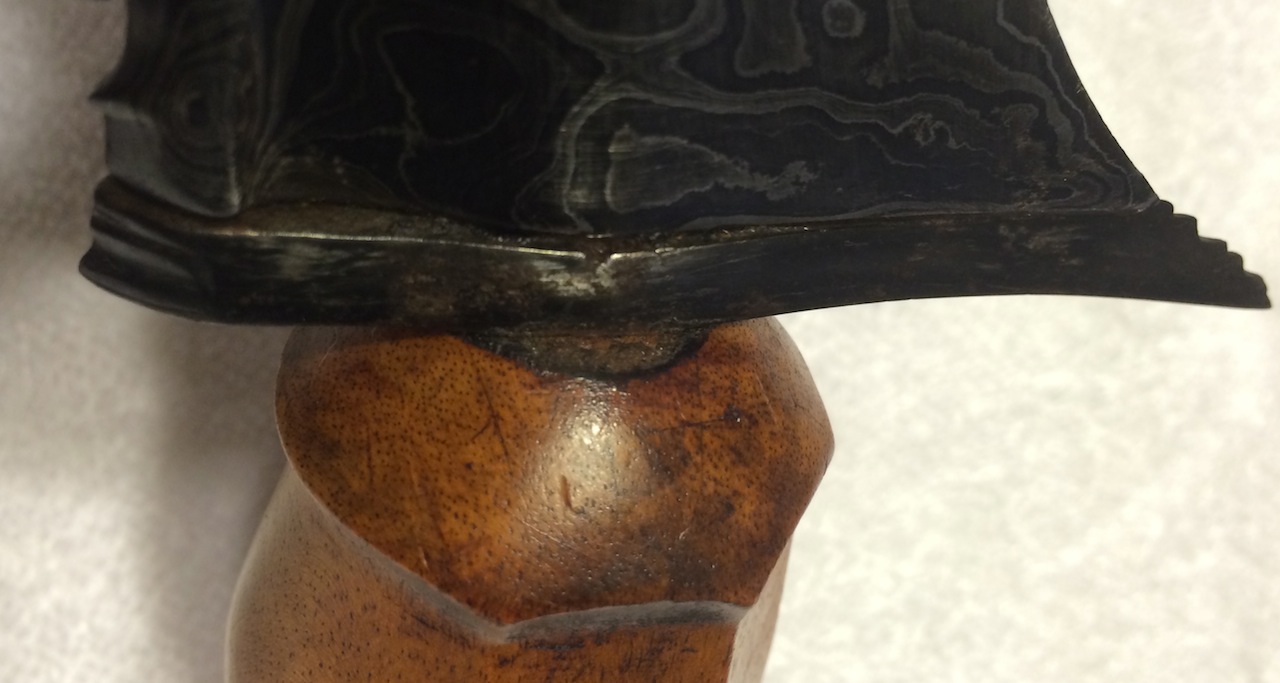

Sure thing, here you go. One other thing, the first pic shows the point where the wrapped peksi enters the hulu. It seems to be wrapped with a whole lot of some very fine material, but while it is very firmly set, it is a touch cocked in overall relation to the rest of the assemblage. I can't tell what the wood of the hulu is, it looks for all the world like sycamore, although of course thats really unlikely.
The fit in the scabbard is very good, no rattle at all. One last thing, the ganjah is loose on the tang. Not bad, but its a bit annoying.
You can see in that first picture how loose and cocked off the ganjah is, but the fineness of the akut, is it? has me hesitant. This hulu is really on there, and I am sure I could fix the ganjah, but….

The pamor almost looks drawn on the blade; but I know it is not .
The blade has a nice polish .
Bali or Lombok .

Respectable old Bali keris. The blade is a little unusually short for Bali blades, but not unprecedented. I have one that only just a bit longer that yours. The sheath looks to be a true pelet patterned wood. Sometimes they fake this with markers or dye. Pamor names aren't my strong point, but yours looks to be a fairly common kulit semangka (melon pattern).

think it's best left alone, but I really don't like the skewed ganjah much, since
it catches on the scabbard unless handled really carefully.

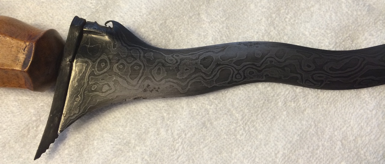

My personal thoughts about this kris, which may not be approved by all members and I apologize in advance:
. This is an old Bali/ Lombok blade indeed. Unfortunately somebody seems to have sanded the rusty areas, which have caused the colour to fade and the pamor to get blurred. If this blade was mine, I would take the risk to send it to a reliable craftsman for complete cleaning and warangan. From experience the polish would not be affected.
. From the pics the pamor pattern seems to be Ngulit Semangka as said by David.
. The greneng is rustic and the ganja is worn-out, I would remove it and carefully clean the face in contact with the blade as well as the bottom face of the blade and glue the ganja in place with Superglue to avoid skewing.
. The fitting of the blade into the sheath slot is acceptable but the 2 pieces are not originally matching IMO.
. I would add a ring (uwer) on the peksi between the hilt and the blade.

Thanks for writing Jean. While I am no expert, I think that the fading along the edges of the blade, if thats what you are referring to, were caused by the slight "catch" as the blade enters the sheath. It is a bit tight, which may possibly be more evidence that it's not original? Or that the wood has shrunk a bit, who knows. As far as sending the piece away, I don't think that I can afford it. Shipping alone with reliable tracking is in the hundreds of dollars range. I won't use USPS for this because their tracking isn't really, and UPS is very pricey.
My other two keris I worked on myself, and I guess I did OK, but I am not a professional restorer of anything. In the case of those two, it was do or die, since both were actually in trouble. I may just sit this one out.

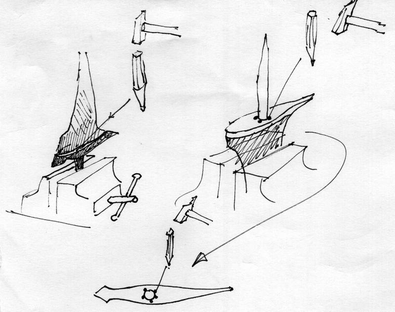

When I clean and etch a blade I always remove the ganja to eliminate the rust. I then cover all parts in contact between blade and tang with a rust converter to avoid future problems.
In the self-explicating drawing you can find the method I use to remove and re-fit the ganja. If possible I avoid using glue of any sort.
Be very careful and delicate to avoid any damage, especially when you place the blade in the vice: it must be very firm, so place two pieces of wood on both sides of the blade and close with strength the vice.

That's a great drawing. This is exactly the method I used on one of my other keris. I had to make a new wedge out of a nail.

In fitting a gonjo I have never seen an original gonjo fitted with multiple pins, as GIO has shown. In my experience, the use of more than a single pin complicates the job and makes precise alignment difficult. The usual Javanese method is a single pin on the buntut urang side of the pesi.
The pin used to fit a gonjo should be cut square and tapered and fitted into a tapered square cut hole. You cut the square hole to accept the pin with a jeweller's file, you make the pin by using a jeweller's file.
Another way of fitting a gonjo is to make the hole in the gonjo a very neat, press fit to the tang, then tighten the gonjo around the tang with a hammer and punch.
Aluminium jaws for a vice are more effective and long lasting than wood, but for a quick fix, folded newspaper works well.
Eeeeek. I didn't notice that the drawing indicates multiple pins. Thats what I get for poking around on the internets at work. Alan, do you know anything about this type of keris?

No, I do not use pins to secure the ganja. I get a small deformation on the ganja around the peksi, so that the ganja is firmly fixed.
The same principle is applied in Japan to adapt tsubas on the blades.
I am sure Alan has never seen such a system: it is my personal clumsy work to avoid the use of glue. In my defence I would emphasize that the result is invisible (also because hidden by the mendak) and reversible.
When a pin is present, I obviously use it. If it is worn out, I make a new one.

Please accept my apologies Giovanni.
I misinterpreted your sketch:- I thought that the black spots surrounding the tang were holes to accept pins.
Yes, tightening a gonjo by working around the tang and punching the top of the gonjo is a valid way to fit a gonjo, I've often found this method used on Bugis and Peninsula keris, but I cannot recall ever having seen it used on a Javanese or Balinese keris.

Alan, you absolutely must not excuse yourself.
In fact I am rather flattered becoming aware that the procedure I follow to fix a ganja is being utilized in Indonesia too. At the end my work is not so clumsy and rough !

Yes, I believe your finished job would be neat.
However, this type of fit can only be used when the hole in the gonjo is a neat fit to the tang.
