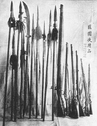

Great topic. I am in the process of putting together a nice kung fu practice spear with an antique head on it now.
Here are my thoughts on your topics.
Shafts - I think Timo had a lot of good info. Also, I have seen in several period photos that waxwood appeared to be the wood being used for "commoners" spear shafts. I bet the use of one material or another was also relative availability in the area. It may also have been relative to your pocketbook so to speak. I see fancier pole arms with well finished shafts, while more village like spears have functionally finished/bumpy surfaced staffs like many Chinese martial art practitioners use today. A nice mid thickness waxwood staff has both the strength and potential flex to absorb impact shock rather than break. That is what I am using on my spear and have had good results practicing with them for years.
Butt spikes- I have seen them on other pole arm examples but not spears. I would not count it out though. From my experience variability seems to be the norm in Chinese weapons.
Length- Back to the variation being the norm comment. As you can see in the photos there are long, short, and in between.
Tassels- Good question. I have seen photos of them in use from late Qing through WW2
Pictures - 1. Presented as confiscated weapons from "Manchrian bandits". 2. I think I pulled this off a Chinese site. Looks like Warlord era to me or Spear Society. Could be wrong.

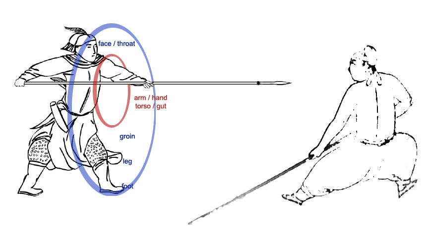

Centre and periphery, I think. If you hold the spear with right hand forwards, the spear is to your left. A thrust coming in on the right of your spear is in your inner circle. A thrust coming in on the left of your spear (perhaps to face or left shoulder) would be in your outer circle. Think of "inner circle" as the space between your spear haft and your body. Outside that is the outer circle. For the grip above, with spear on left, I don't if outer circle includes the right side of the body (so the whole torso), or only the left side (i.e., the side closer to the spear).
My impression was similar to yours that it was something like this

So far I have concluded that "inner-circle" and "outer-circle" is a bad translation. It's more like "inside my circle" or "outside my circle"... and it's better described in "modern martial arts terms" as my inside/centerline area and outside/back/flank.
"Inside" and "outside" in modern unarmed martial arts are, in my experience, defined by inside or outside the lead hand. In the usual right-handed stance, with left leg and left hand forwards, to the left of my left hand is outside, to the right is inside. My arm being where it is, this corresponds to front of body/centreline being inside, back/flank being outside. It isn't the target area that matters; it's which side of the front arm the attacker comes in on.
Extending this to spear (as I did), it is which side of the spear which matters. Practically, there is little difference between aiming at the belly and aiming at the side if both attacks go in on the same side of the spear. "Inside my circle" and "outside my circle" sound OK as translations.

Yes I agree with your explanation, I was trying to say the same thing but apparently not well enough. The "inside circle" and "outside circle" translation confused me, but when I read the actual Chinese I realized it was just referring to the inside and outside as me and you have described. It's not written as one would speak normally but in a more literary style I suppose...

Yes! Exactly.
Na is palm down, and Lan is palm up. For the spear, if you have your left hand forward, your spear would lan or na, left or right, to block incoming stabs as guided by your left hand.
Lan is also used to mean blocking in some Chinese swordplay.
