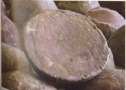

Archaeologists would eventually find an immense amount of these ingots beneath the sands (22 tonnes in total!), along with

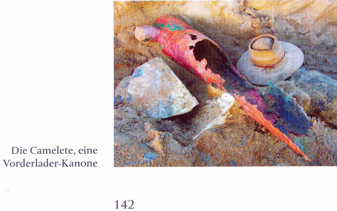

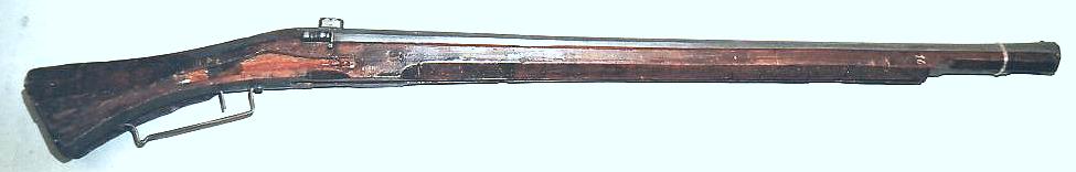

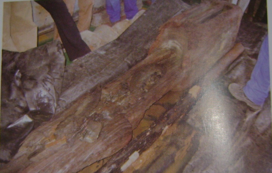

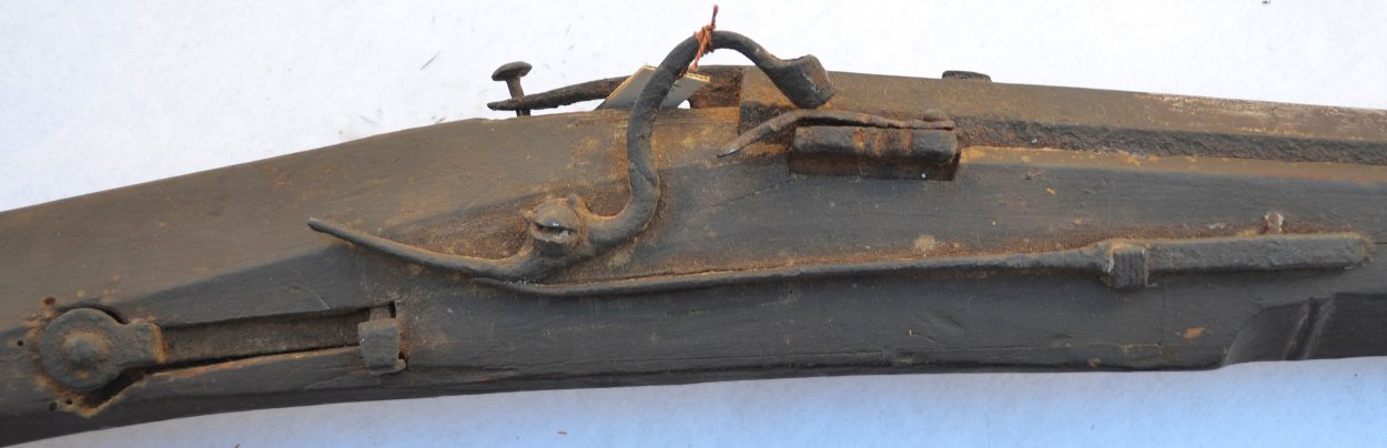

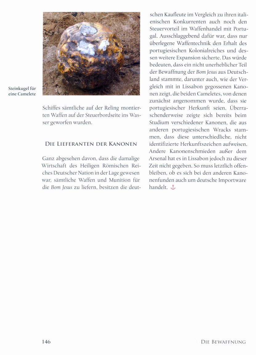

THE c. 1525 type NUREMBERG SNAP-TINDERLOCK ARQUEBUSES
that, among other goods, the Bom Jesus was taking to India!
Way before even taking a first glance at what actually turned out to be two stamp-size (!) printed photos, showing some details of an arquebus stock salvaged, I was well aware of the doubtless fact that the Nuremberg gunmakers guild was trying to sell off first, and especially overseas!, the remaining number of a technically outdated model of Landsknecht guns - rather than the latest stage of Nuremberg technologic evolution of mechanism (in terms of all mechanical parts being united on an iron! lock plate).

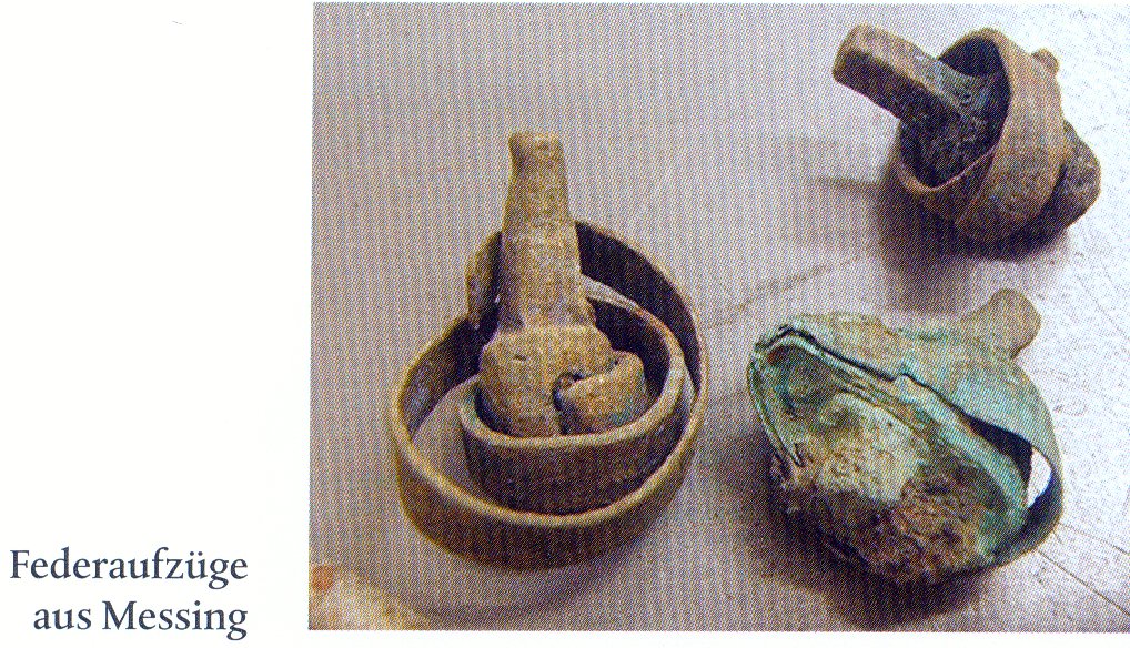

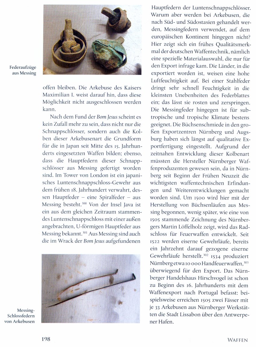

So I feel sufficiently sure to exactly predict what the mechanisms of the Bom Jesus arquebuses must have looked like - before even getting a glimpse of an actually salvaged specimen.

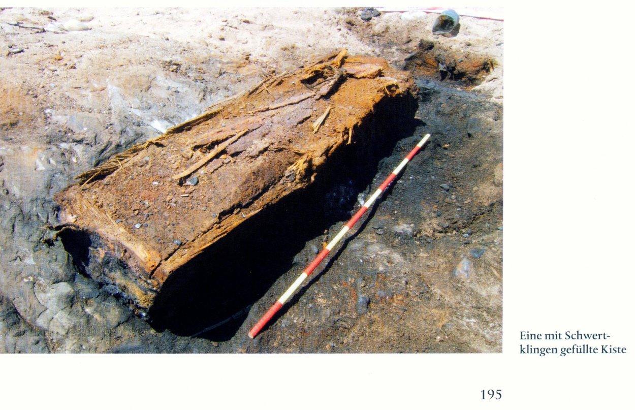

And mind you: At least a chest full of completely preserved arqebuses was found:
See attachments no. 2 and 3!
Michl/Michael

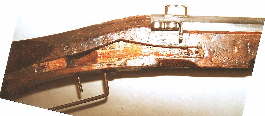

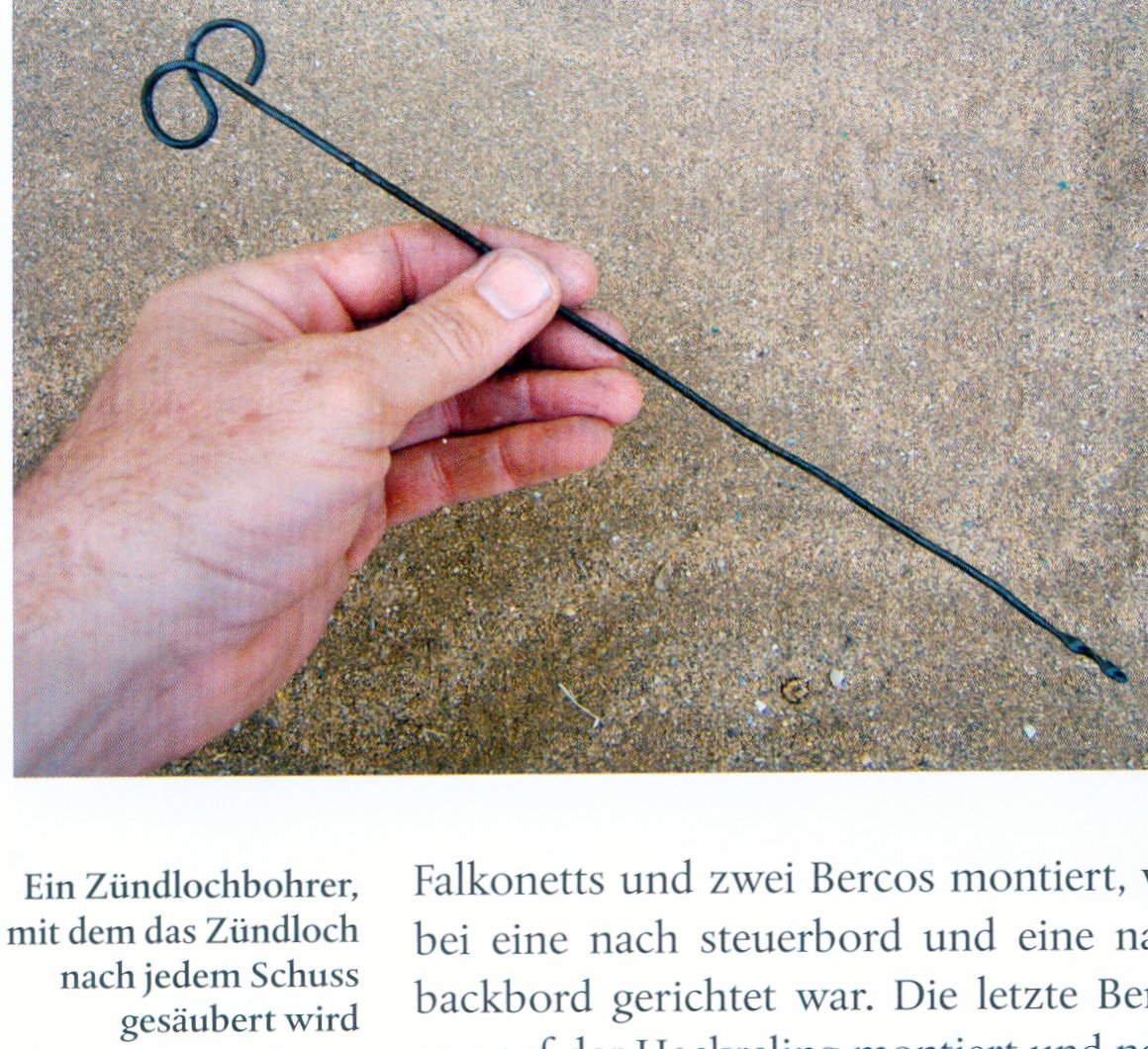

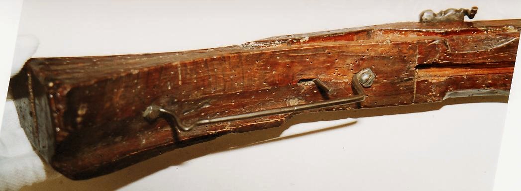

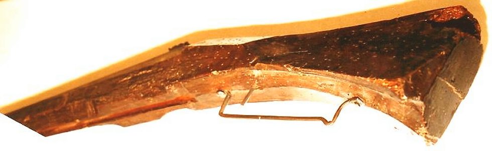

I definitely doubt the alledged fact that attachment no. 1 shows a touch hole prick (German: Räumnadel); in my opinion, this long needle with the double scroll to its upper end was a bodkin used for long hair.
Such a long and delicate object would have bent and broken right away, at the very first tryto prick the fouled-up touch hole of any
gun ...
Further down in this thread, I will attach photos of two actual wrought iron pricks preserved in
The Michael Trömner Collection.

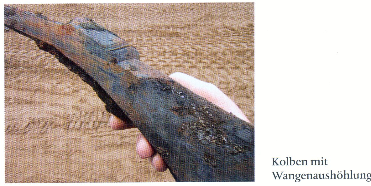

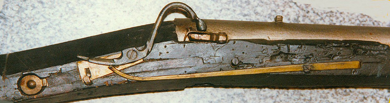

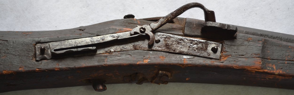

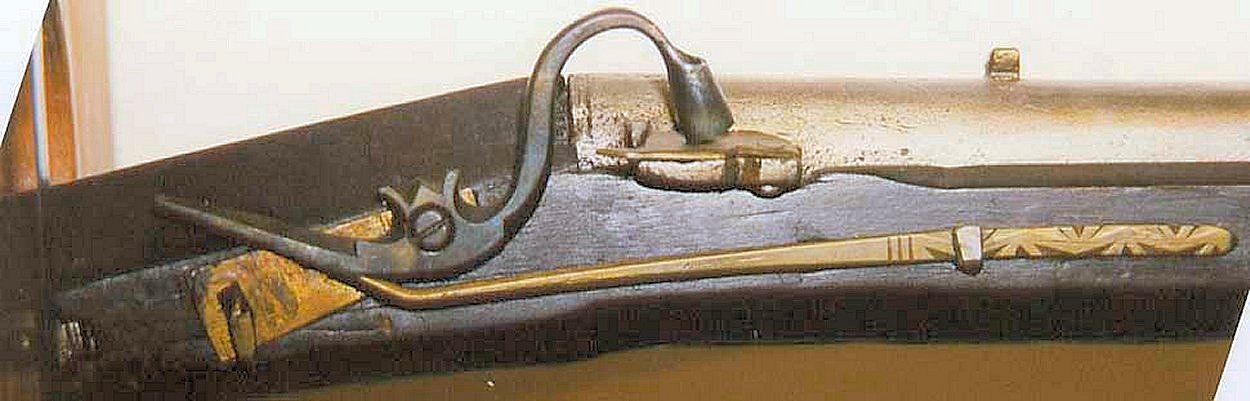

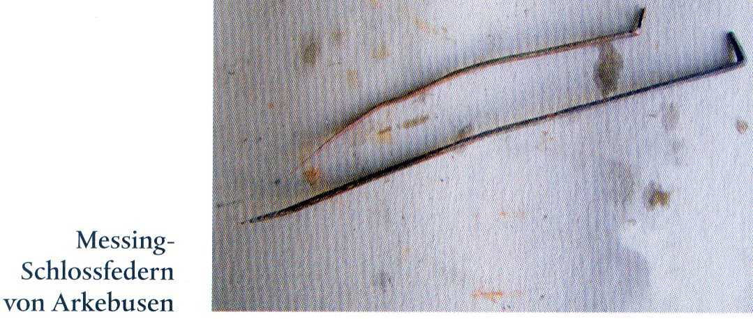

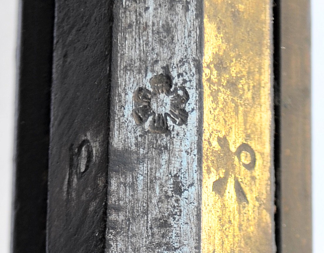

Attached to this and the following post, find some photos
of Nuremberg made snap-tinderlock arquebuses with lateral push-button triggers, and with only the serpentine riveted on a small brass plate while all the other mechanical parts like the long forward-mounted one-armed main spring (mostly made of hammered brass) were inlaid in recesses cut out of the stock, and covered up with a thin plate of wood.
A long brass-hammered spring of exactly this type is illustrated on one of the scans I made of photos of arquebuses discovered in the wreck of the Bom Jesus.
The arquebuses on my photos are preserved in the historical armories of
the
Západočeské muzeum v Plzni, Czechia,
and
the Brukenthal-Museum Sibiu,
Romania

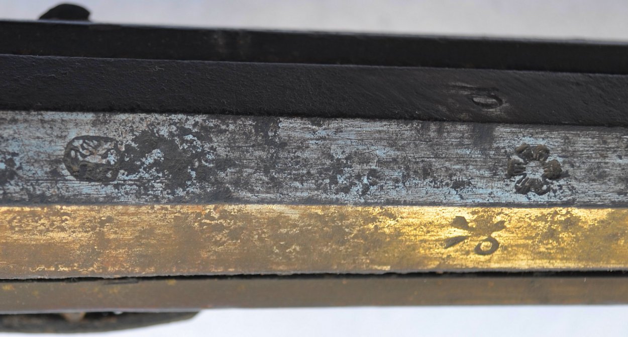

Please note the Nuremberg control mark struck as a sign of quality on the barrel of one of the Sibiu arquebuses.
The latest stage of technological development, now uniting all parts of snap-tinder/snap-matchlock mechanism on one iron lock plate, Nuremberg, ca. 1530, is represented
by a short arquebus preserved in the reserve collection/storage rooms of the Hessisches Landesmuseum Darmstadt (bottom attachments).
Although the lock mechanism is missing from the latter gun, the lock recess cut out of the limewood full stock clearly denotes its pointed triangular shape.
Please also note that this arquebus, for the first time, features the 'modern' form of a trigger (German: Züngleinabzug or Abzugszüngel), which is protected by a rectangular trigger guard!
Please also cf. Alexender's threads:
http://www.vikingsword.com/vb/showth...ht=zapadoceske
and my threads:
Photos of the Pilsen and Darmstadt arquebuses copyrighted by the author, Michael Trömner.
Photos of the Sibiu arquebusees copyrighted by the Brukenthal-Museum Sibiu/Hermannstadt.

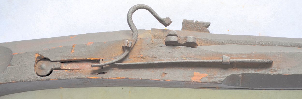

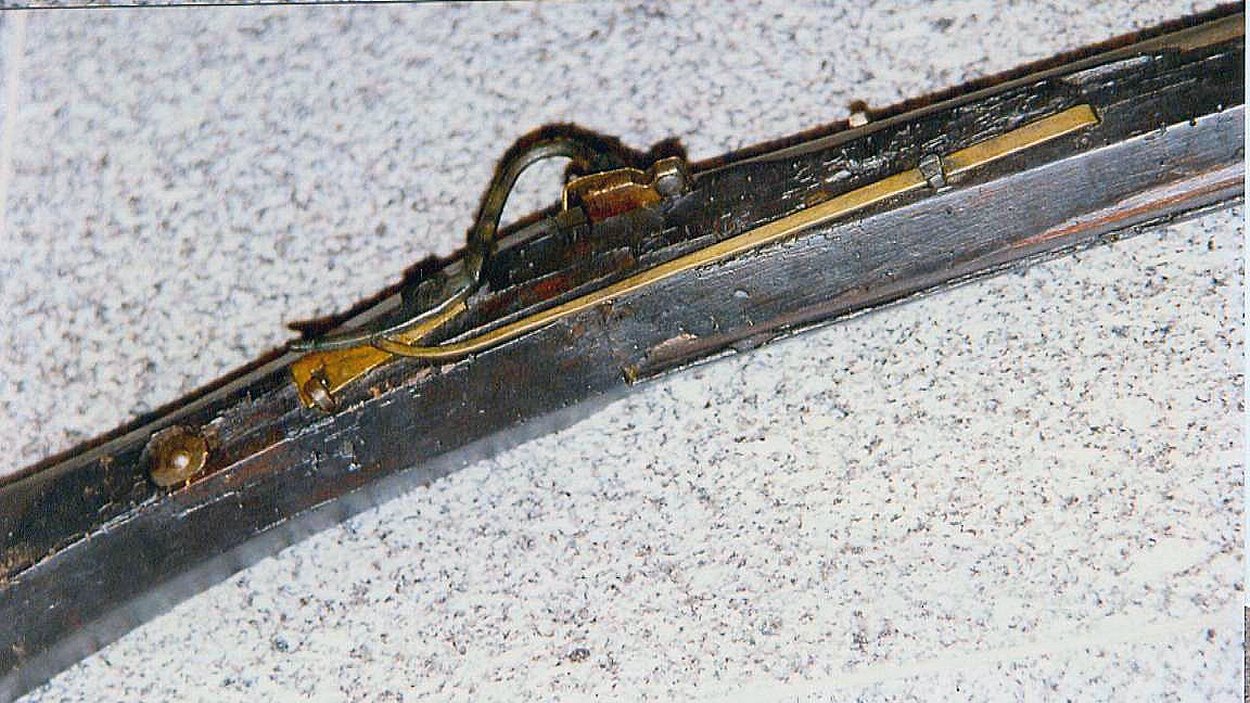

Top 5 attachments:

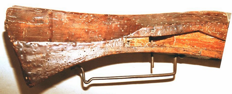

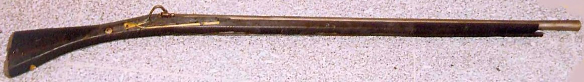

A Nuremberg made snap-tinder/snap-matchlock arquebus of ca. 1530, the lock recess showing the contours of a triangular shaped lock plate which united all the mechanical parts of the action.
Together with a contemporary Italian snap-tinderlock arquebus preserved in
The Michael Trömner Collection,
this gun at the storage rooms of the Hessisches Landesmusum Darmstadt, inv.-no. W 61:100, is the oldest known gun to feature, for the first time, showing the presence of the 'modern' type of trigger replacing the lateral push-button that had been used to trigger the snapping serpentines from ca. 1490-1530.
Furthermore, these two contemporary arquebuses of ca. 1530 are equipped with a vertical type of trgigger guard, for protection of the first triggers mounted on the underside of the stock, beneath the lock mechanism. The Nuremberg made arquebus in Darmstadt features an especially delicate type of trigger.
Attachment no. 6 depicts an action of the very same type, on another Nuremberg imported arquebus in the Brukenthal-Museum Sibiu, ca. 1530-35.
The author's thesis is that the arquebuses on the Bom Jesus were not yet equipped with that kind of 'modern' triggers and trigger guards.
All photos copyrighted by the author, Michael Trömner.

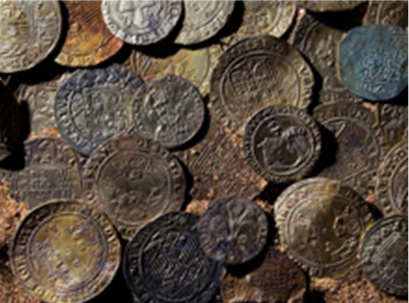

... The gold was in the form of coins, more than 2,000 in total, mainly Spanish excelentes bearing the likenesses of the monarchs Ferdinand and Isabella, but also some Venetian, Moorish, French and other coinage....
Other coinage is in fact Portuguese coins, as per the original texts, something which is more than obvious, once the ship was Portuguese. Actually the coin shown in the (Amy Toensing) picture above is a silver "tostão" of the King Dom João III realm.This is a very important detail, once the mintage of these coins had started in 1525, having all units been withdrawn from circulation in 1538, to be molten and not put back to use, for the presence of these coins in such good condition is a strong evidence that this ship was launched to sea during this 13 years interval.
Also the Spanish gold "excelentes", which represent 70% of the gold coins present in the wreck, are a vital detail for history, as it didn't occur to archeologists that the Spanish investors, as it appears, had a great contribution to this Portuguese expedition, such an unusual fact.

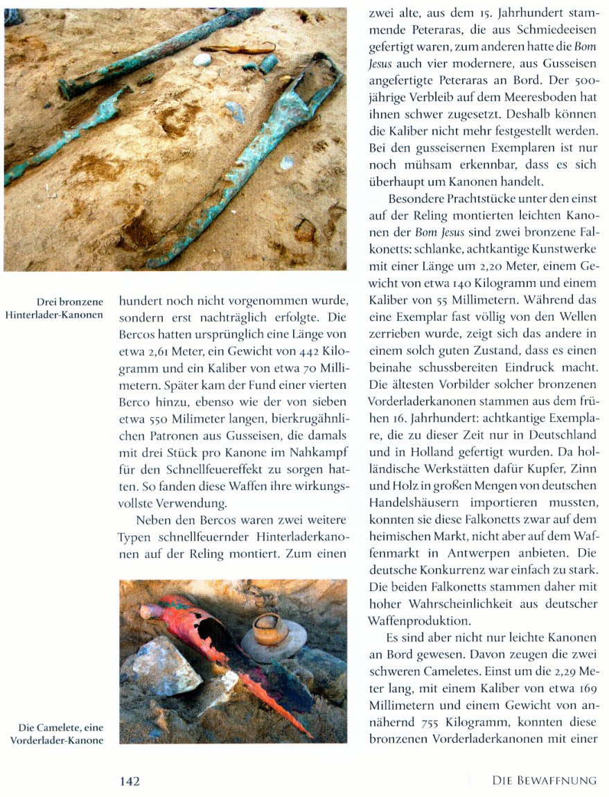

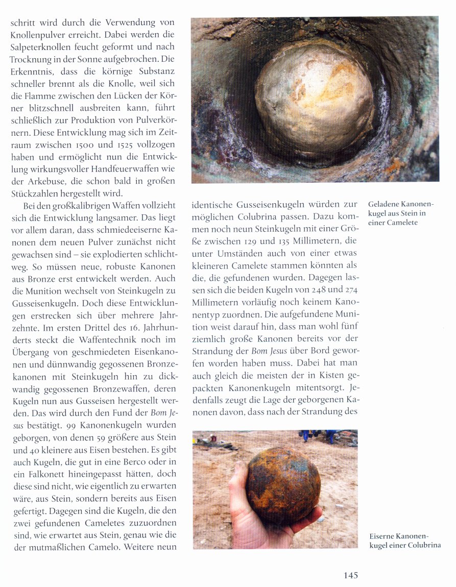

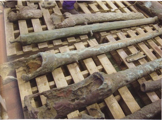

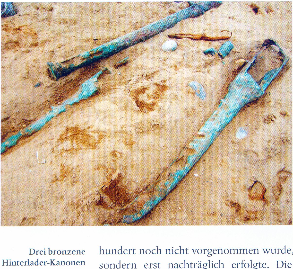

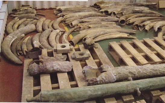

Some more pictures of the salvaged parts.
The artillery (the falconets and the famous berços), the elephant tusks and the copper ingots for trade, the ship's astrolabes, the inumerous coins and an early sylized illustration of the Bom Jesus.
Also a section of the main mast, where may be seen the masthead in which laid the topsail basket and the rigging fixation.

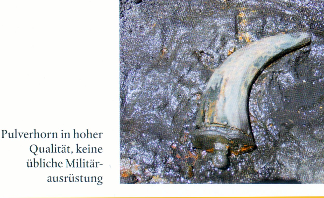

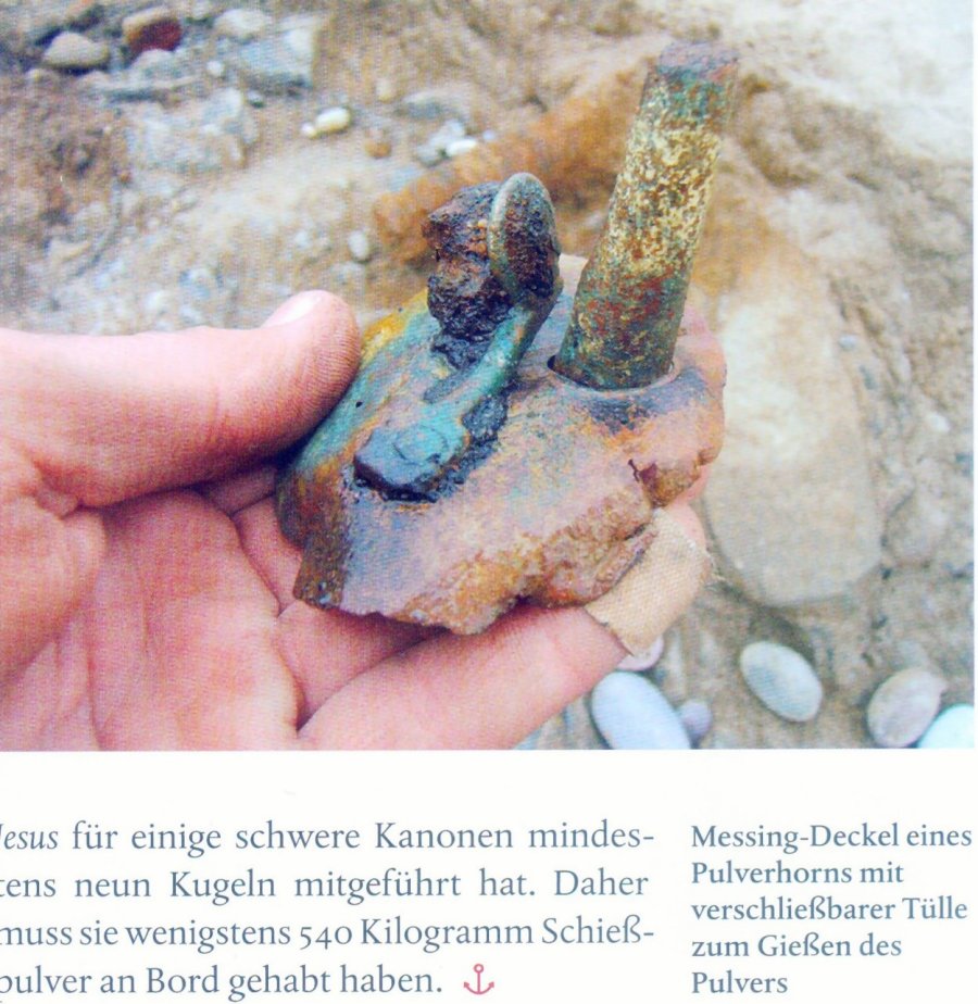

Hi there,

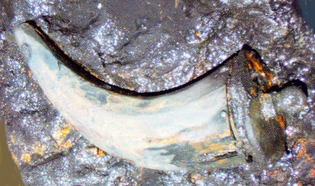

Attached please find some images of the powder horns and brass-cast ball molds found on the wreck of the Bom Jesus; sadly, I had to zoom them up from stamp-sized images printed in the book.
They are characteristic of the Italian taste of the 1520's to 1530's, readily copied by Nuremberg manufacturers by ca. 1525-30.
From ca. 1530, powder horns started getting replaced by trapezoid flasks.
Horns were re-enlivened from ca. 1580 through ca. 1650. They just got flattened, and a hook was added for attaching the flask to the leather frog of the caliverman they were reserved for.
The musketeer, in contrast, was equipped with two trapezoid powder flasks: a larger one for the barrel powder and a small priming flask. Alternatively, he carried just the bandelier, either together with a small trapezoid priming flask, or one of the tube-like powder containers on the bandelier was reserved for priming; in the latter case, its top had a nozzle.
The text of the book states that the horns were of unusually high quality, and therefore cannot not have been part of the equipment of the common mercenary/Landsknecht arquebusier.
Three contemporary sources of illustration of ca. 1525 -1533 re-attached prove the contrary.

Please note the technically topic state of the mechanisms mounted on the horns, for exactly measuring the correct load of powder needed for each shot.
Also, in the painting by Ruprecht Heller dated 1529, the earliest trapezoid flasks are portrayed to have been used in the Battle of Pavia in 1525
(two attachments at bottom).
