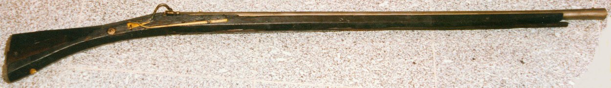

Default A Crudely FAKED Wall Gun, in the Style of ca. 1500!
Fortunately, this crude fake failed to sell in the latest auction of Hermann Historica's, Munich, 5 May 2014, lot 21.
The wrought-iron barrel is the only older part of the whole item; it is from an Indian (Raipur!) matchlock wall gun, 19th century.
Everthing else, including the hook (!), is brand new (!), and made so ridiculously primitively that it will make any expert laugh out loud at first glance!
Just look at those hammer marks on the hook, obviously done in an unbelievably unprofessional way, and carried out with the narrow edge of the hammer, instead of using the blunt side!
Another blunt effrontery is the so-called 'gunsmith's mark', 'struck' on the hook; it represents a Gothic p miniscule, and the catalog description identified it as the mark of the Nuremberg workshop of Pehaim.
FACTS:
- 1. All the Pehaims (Behaims) were bronze founders, none of them was a gunsmith or a blacksmith, ever!
- 2. Actually, this mark is a primitive forgery of the Gothic p miniscule mark of the Nuremberg Pegnitzer workshop. All Pegnitzers also were bronze founders, none of them ever made a wrought-iron barrel!
With only the least sense of responsibility, Hermann Historica's catalog description cannot be called anything else but completely incompetent and sailing close to the wind of crime outrageously!
ANY PROSPECTIVE BUYERS of early pieces BEWARE!!!!
Those plain guns can be forged either partly or completely very easily, and it usually takes a lot more expertise to tell the wrong from the right than it does in the case of this 'gun' in discussion.
I usually and regularly watch all relevant international auctions, minutely and critically searching them for items of my expertise. And I have been a regular subscriber to all relevant printed catalogs from all the big sales firms for almos 40 years. In my library are auction catalogs back as far as the 1890's!!!
You won't believe how many forgeries, both part and complete, there are on the market; I would roughly say, about 60-70 per cent!!!
If only it were allowed to post auctions before they are over, I could warn people on the forum ...
Now have fun reading, and please do comment!

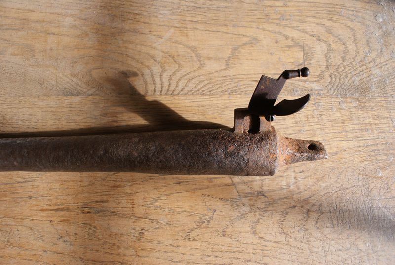

Sorry to muddy the water on this one. Yes , the pan certainly looks Indian and the distressing / stamp on the hook is obviously spurious and recently added. But are we absolutely certain that their isn't a precedent for early Indian matchlocks (with or without hooks ) following directly of European patterns of the late 15 / 16 century ? The use of matchlocks in India is well recorded from C 1480 and by 1550 standards had been introduced regarding the manufacture and proof firing of matchlocks.
The reason for re raising this issue is that I posted the barrel from a faked up European style matchlock with a barrel which probably was Indian but with what I thought was an unusual termination to the breech . That is a large lug on the rear of the breech secured presumably to a stock by a transverse pin , not unlike it appears , the example above. Although I cant think of a precedent for it you could argue it might be a rational transition between the earlier spike or socket and the lug under the breech found on early European matchlocks , which survives in a smaller form on later Indian matchlocks.
My point being that once something is outside of the supposedly established European chronology we simply haven't a clue .
Raf is offline   Reply With Quote
Old 29th May 2014, 08:08 AM   #18
Matchlock
Matchlock's Avatar
Join Date: Sep 2008
Posts: 4,310
Hi Raf,
Fully agreed, basically.
In any expert analysis, we can but rely on facts generally known.
In other words:
The sky's the limit; all bets are off ...
It's just that I used to own two Indian matchlock muskets, a wall gun and two detached matchlock barrels about four decades ago, all of them preserved in fine original condition, and the barrels struck with a long row of an inventory no. from the Rajpur arsenal each.
Moreover, I have seen a number of those items at various auction viewings.
So please trust my being quite familiar with every little detail of those barrels, their peculiar form actually imitating the characteristic Nuremberg style of about 1510-20 - apart from the pan which, unlike the pans of early 16th c. German barrels, usually shows no provision for a pivoted cover on about 90 per cent of average arsenal quality Indian matchlock barrels.
The swiveling pan cover is a feature most often observed with finely made decorated specimens rarely ever emerging on the market. I remember noticing two or three of them in London sales catalogues, over quite a few years. When they are fitted with a swiveling pan cover belonging originally the latter is sometimes made of brass, again copying some German barrels of ca. 1525-30.
What is more, and definitely contrasting with their German paragons: Indian barrels are usually not sighted while German barrels usually feature both a rear sight and foresight, from about the 1470's:
http://www.vikingsword.com/vb/showth...barrels+dating
The presence, position and shape of sights are further important dating criteria for barrels. They first appeared around the mid-15th c. starting with a raised rear fire shield behind the touch hole on top of iron barrels, incised with a small central slot for aiming (attachments). At about the same period there was just a very subtle small raised portion of the swamped muzzle that acted as the first preliminary stage of a foresight. On my earliest Nuremberg/Passau barrel of the 1460's, a very rare instance of a hog's back barrel (German: Schweinsrückenlauf), an edge instead on top of an octagonal barrel fulfills the function of both sights over all its length. My next-in-line Passau barrel, bearing the earliest known city mark of Munich according to Erasmus Grasser's design of 1477, together with the date 1481, is the second-oldest known dated handgun barrel in the world:
http://www.vikingsword.com/vb/showt...t+dated+handgun
In the case of 'your' barrel, the tang, pan and cover (the finial of the latter imitating the German style of the 1630's), as well as the lug(s), all are spurious additions. Somebody obviously intended some gun to appear like an original German 'military' musket of Thirty Years type - at least to the inexperienced eye.

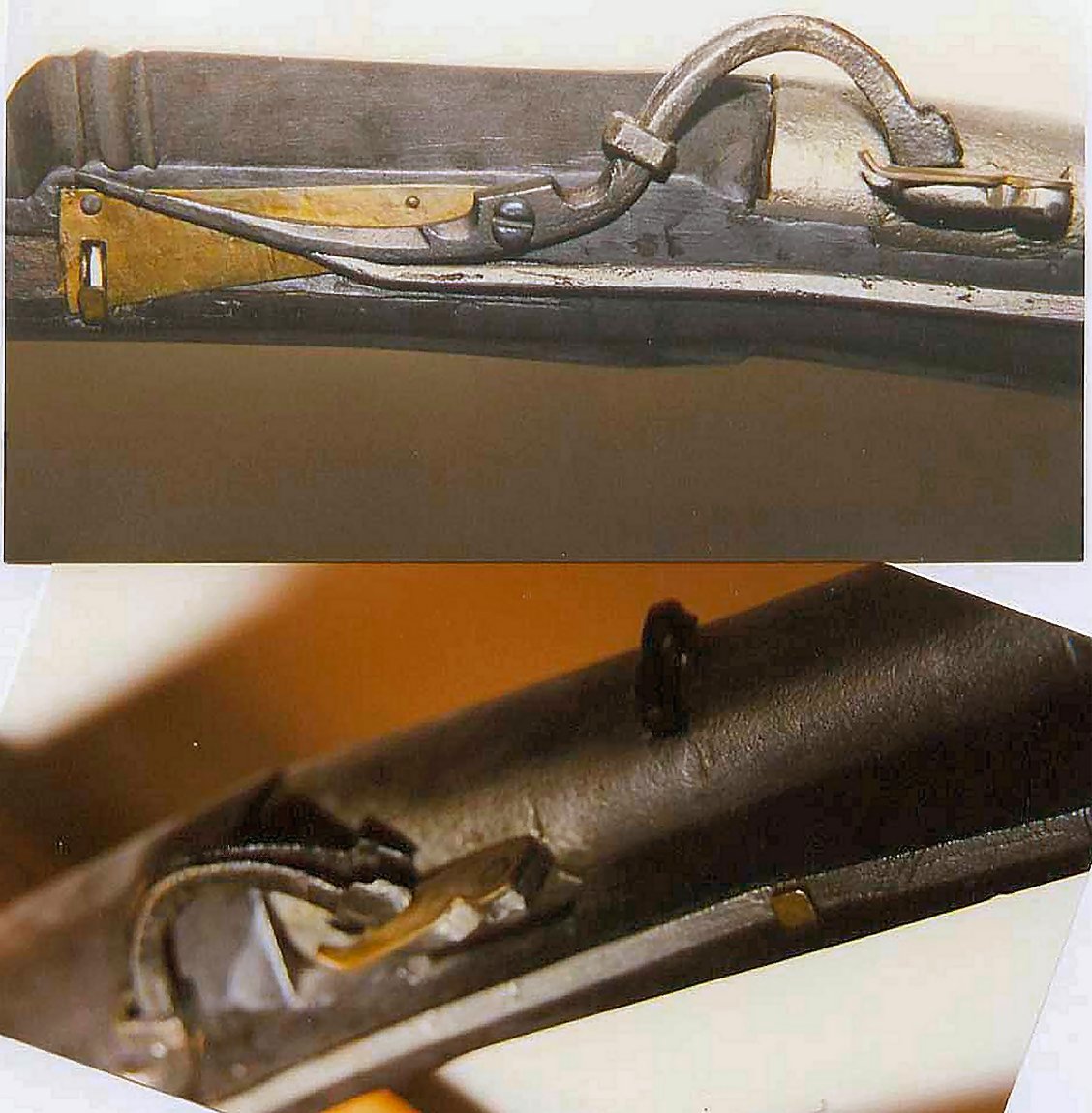

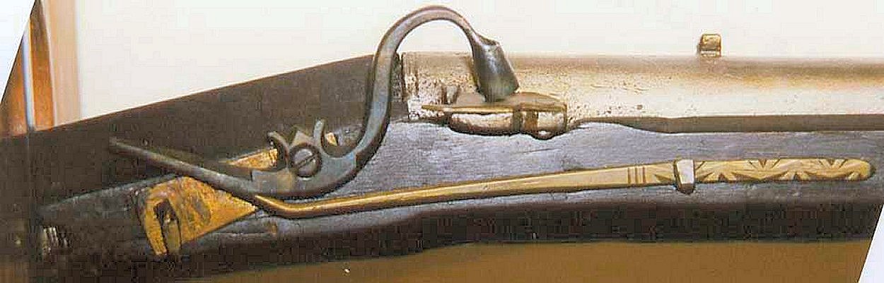

Author's photographs from the year 2000, picturing two different Nuremberg manufactured tinderlock arquebuses of ca. 1525-30, retaining their original brass pan covers; they once were part of the inventory of the former Pilsen arsenal, and are now preseved in the Západočeské muzeum v Plzni, in Pilsen, Czechia.
All of these guns, and there are still more than 200 of them!, probably never left Pilsen since they were delivered from Nuremberg workshops, almost 500 years ago ...
