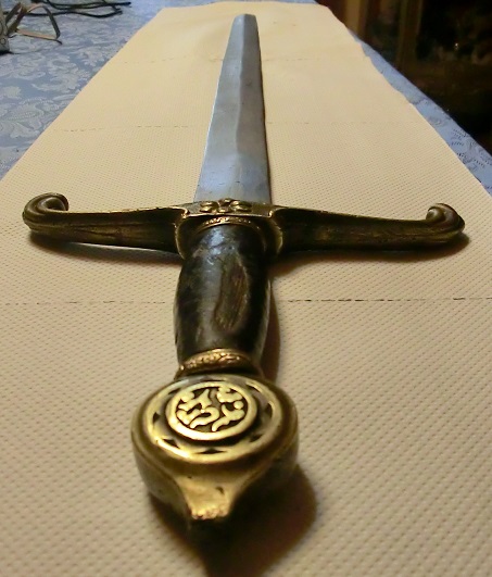

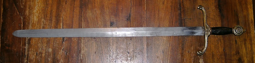

Hi at all ,
I bought this strange sword ... it have brass pommel and guard and a damascus blade ...

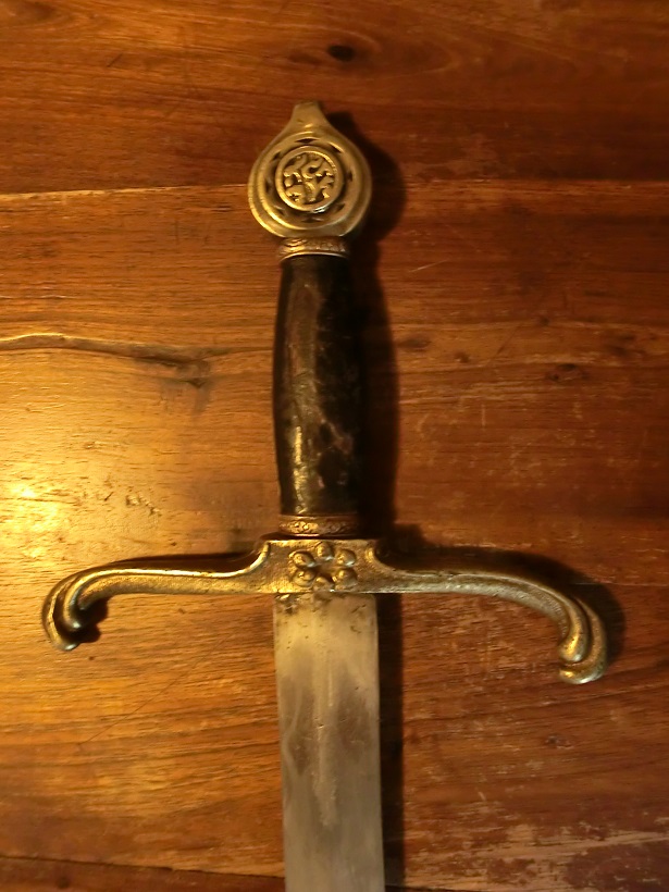

the pommel have an arab ? inscription in the centre and i would ask to collectors is someone known what is ...
thank you BerberDagger

Salaams BerberDagger... Is this not a Chinese style pommel... ? In which case I would beware the modern copy scenario.

I dont think it is chinese ... I think european " in style " but is not arab characters in the centre of pommel ?
thank you

Salaams BerberDagger I dont think so... they also look mildly Chinese ..cloud patterns. It is not impossible to have Arabic on a Chinese item ... The Islamic frontiers of China are vast... but in this case I think you have a Chinese sword according to the pommel style (the crossguard baffles me). However, I am no specialist of Chinese weapons nor of the huge complexities in Arabic or Chinese calligraphy so perhaps we can pull someone in who is?

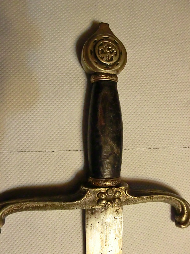

It isn't Chinese (unless it's a modern-made Chinese-made replica of a European sword). Neither the pommel nor the guard are Chinese in style. Both are Medieval European in style, though the guard is very chunky. My first thought was "Toledo replica", but this sword has a forged blade, so I don't know.
One of the photos shows the end of the pommel, but it's shaded. Is the tang peened there? If not, the pommel is either glued on or screwed on. Perhaps disassembly will provide some answer?
On this style of pommel, the pointy part is an integrated peen block. (Separate peen blocks were common.) But brass tends to be soft and can deform when peening. Which is why I ask if it's peened. (All the original pommels of this type I've seen are iron/steel.)
The blade is forged, but by Medieval standards, poorly finished. So it looks like a modern sword, perhaps deliberately left with a wavy ridge etc. to make it look obviously hand-forged.

Salaams Timo Nieminen, I think it is a mixture but based on a new Chinese sword as at the start of your post. I think the top ring on the pommel has snapped off...on which the tassel would have been tied. The crossguard is odd.

I think this is most likely a modern fantasy sword probably of Chinese origins. If that is the case the feature designs of the blade and fittings are not going to be a fair guide to origins.

I've never seen a Chinese-style sword with a wheel pommel (or wheel pommel + peen block, or wheel pommel + ring). If you're thinking of a specific example, I'd be interested in seeing it.
The shape of the pommel is very European. The decoration on the pommel is not. Here is an example of a modern replica with this shape pommel: http://www.myarmoury.com/talk/viewtopic.php?t=14705
This particular sword might be inspired by a famous sword. Here is a review of a replica, with original for comparison: http://www.myarmoury.com/review_aa_hen.html
(David, I haven't seen a blade like this on modern replica/fantasy stuff out of China. Unless the lighting exaggerates the waviness and unevenness of the blade.)

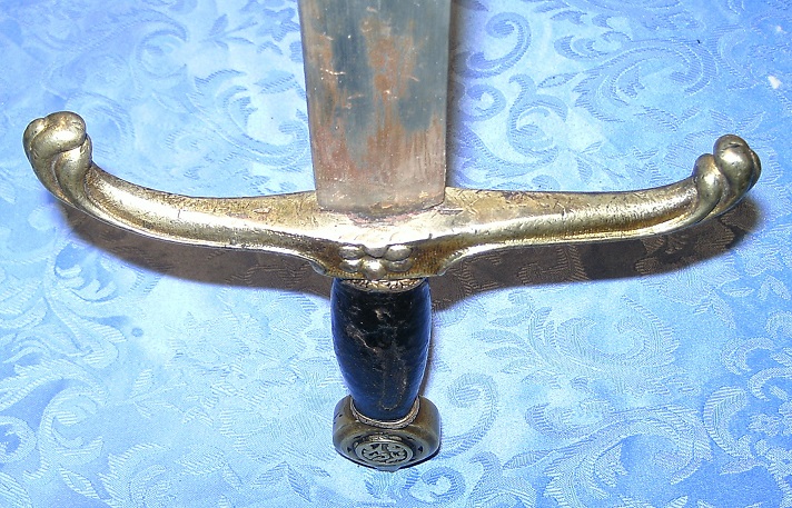

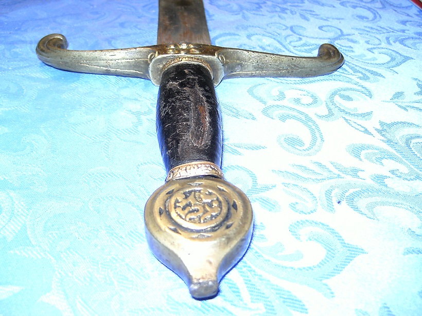

here others pics
Old 12th December 2013, 01:05 AM   #12

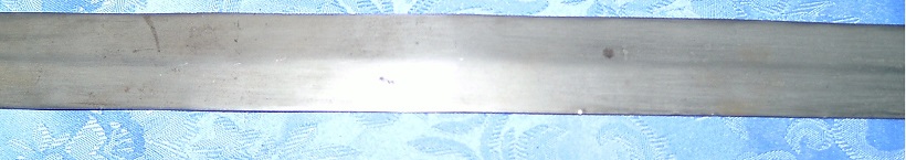

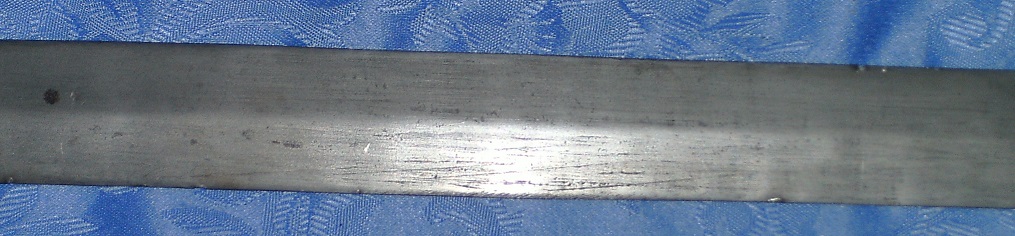

Would it be possible to see a close up picture or two of the Damascus blade? This should at least tell us something about the blade And the type of steel.

Posts: 247
Default pics
here a detail.

Salaams All, Not being expert in Chinese weapons ... It does however strike me that the blade profile which by the way I can see no evidence of Damascening wootz or any such pattern... is like/similar to modern Chinese martial arts Tai Chi sword blades. It also looks faintly theatrical... I may be wrong ... The Pommel looks like it has Chinese(shapes) around the inner circle and the pommel ring looks missing from the top... where a tassel would normally be tied. The small rings top and base of the hilt look Chinese in style.
It inspires me to look more closely at the broader subject of Chinese Swords.

Hi, I disagree ... the style is spanish XV Century not chinese , the blade is damascus ... maybe a composite sword but chinese is very hard !!!

Like Ibrahiim i also see no sign that this blade is damascus steel. What do you base this assumption on?

Thank you for posting a closer picture of the blade however from the picture provided I can see no evidence that this is a Damascus blade. I do see some surface scratches but can't see any evidence of a pattern. Also, there seems to be a couple of spots along the edge where the blade has folded up, presumably when the edge has struck something. The way it is folded up would suggest that this blade is not tempered with a hard edge. It would suggest that the steel is rather soft. A hard edge would chip away, not fold over. Also, the unevenness of the ridge line suggests a poorly made blade. I think at best here you have a 19th century piece made for hanging on the wall.

I very much agree with most all of the excellent observations that have been posted here. Berber, I believe it has long been established that you are a well seasoned collector with considerable experience so completely unnecessary to assert that in response to the opinions you have solicited.
As has been well pointed out, this example seems clearly to be an 'interpretive' production which does seem to hold composite influences.
It is important to note that medieval swords typically have iron/steel hilts, not brass (and this as already observed, has rather crudely executed casting).
I would concur with the latter 19th, early 20th period suggestions, but feel this more likely to be a theatrical item. With these the brass is not only easier to produce stylized hilts, but they lend well to appearance in accord with the often romanticized glint of early swords in the literature.
I think observations are well placed and the resemblances to Chinese and Spanish swords, though subtle, do reflect the desire to bring in exotic and chivalric elements to carry out the obviously intended appearance.
In my view, most Victorian period pieces intended for decorating parlors and smoking rooms etc. were actually remarkably authentic reproductions, far from these theatrical props. I would note also that while to many, such theatrical items of the 19th century and other periods have gained considerable traction as collectibles, much in the manner of Masonic arms and regalia which now have their own unique place in collecting.
