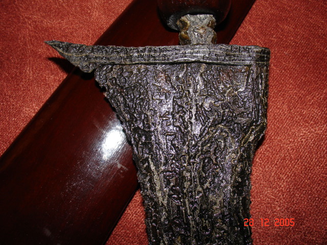

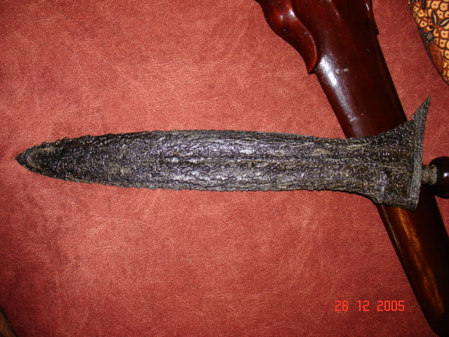

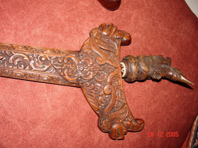

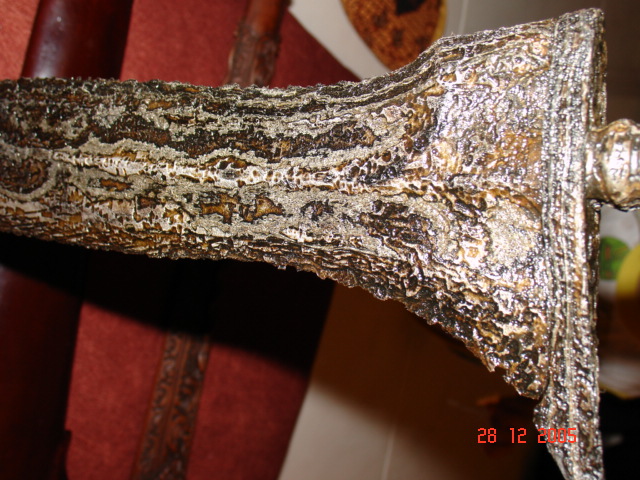

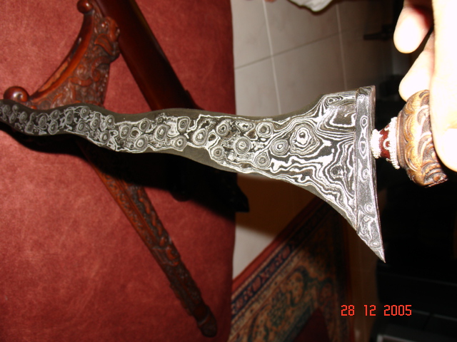

Hi can anyone describe my keris. Refer to "Ensklopedia Keris" - look like keris betok & can describe the pamor.For my keris madura hulu - what does it simbolise? Both keris i bought capture my heart.Thanks

Welcome rizramon. IMHO, both these keris are rather new creations. The keris buda or betok looks like it has been artificially aged to give the appearance of antiquity.
You haven't provided a very good angle of view on the ukiran of your keris madura, but it looks like it might be some representation of a wayang character. Pamors are not my strong point, but this one appears to be a variation of golden rain, a fairly popular pamor used on new keris, perhaps because actual old examples of it are not too easy to find.

Hi Rizramon,
I agree with Nechesh that your keris is a new made.
1st keris called Bethok Budha.
It is a new keris, but processed with chemical in order to look as an aged keris.
The pamor called Kulit Semongko (WaterMelon skin), but actually difficult to described it. The pamor was worn-down because chemical processing.
For comparison : http://gallerykeris.fotopic.net/c791072.html (it is a processing keris Jalak Budha).
2nd keris is a quite new keris too. It has the pamor Udan Mas (Golden Rain). Nechesh is right. Very difficult to found the Old keris with pamor Udan Mas. If we found it, we must spend much money to get it. So that why many kerismaker producted the new keris with pamor Udan Mas. (Most wanted pamor )
Unfortunately, you didn't add the overall pics. I don't know how many luk (waves) it has. So that the dapur can't described.
For comparison : http://keris.fotopic.net/c750780.html (it is an Old Keris with pamor Udan Mas. Estimated made from Tuban period - about 17th-18th century).

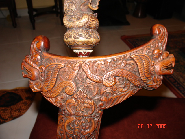

The Hulu/Hilt (Jawa = Deder/Ukiran), it has the Dragon (Naga) carved and the figure on Wayang (Puppets) story. At Jawa, the Dragon can be symbolized as guardian, protector, guard. But, I don't know the figure of Wayang on this Deder.

Hi guys , these are detail pic of my madura hulu.Well im a beginner so need u guys info.For the madura I love the craving & the pamor.For the betok...well i just keep it for my collection.

Henk, i know similar discussions have taken place before, but why on Earth would you not consider the Madura keris "authentic"? The sheath carving certainly has little to do with traditional style Madurese wrongko of the, say. 19thC, but this style of carving IS very much in Madurese and i would accept it as a tradition piece for the late 20thC. I certainly wouldn't brand this a "tourist keris", it's just not an "old" keris. It is a decently executed blade, certainly not tourist junk. It is a modern keris for the modern keris collector. Why should we have to wait another hunderd years to accept that (you know....when it becomes old).

One thing for sure. If the Madurese scabbard and hilt is any indication, the art of fine wood carving is very much alive and well on the islands, even if in this case it's "too much".

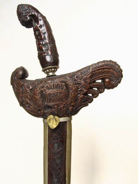

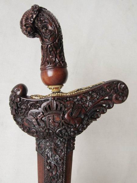

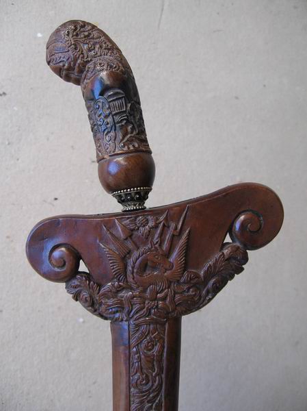

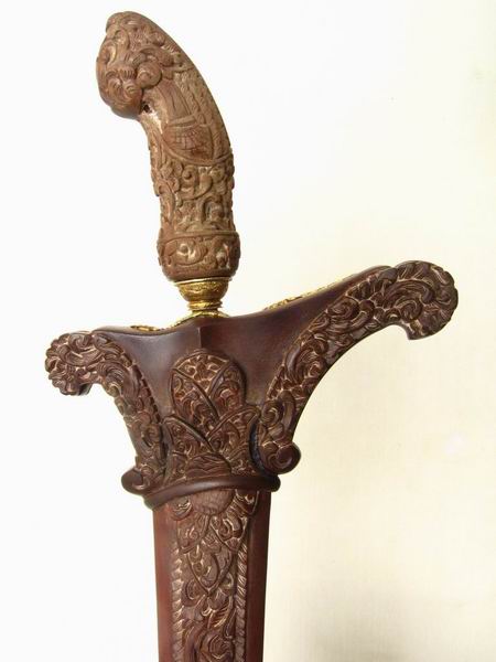

Just for warming this discussion, here I posted some of Madura wrangka's
1st and 2nd are new made / 3rd and 4th are old.
The same thing on all of the wrangka is the rich carved. It shown the part of Maduranese sparkling culture.
Mans is offline   Reply With Quote

Posts: 940
I think the examples Mans posted show pretty clearly that Rizramon's Madurese dress is well within the bounds of traditional and authentic work from that area. No, you don't have to like it, but i still would maintain that there is nothing about this keris that insists that it would only be made for a foriegn market.
