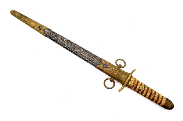

Default Need Help Identifying This Tantō
This is the first of two Tantō Daggers that I am trying to learn about. I would appreciate any comments.
The overall length is 15 5/8 inches. The blade measures 9 3/16 inches from the tip to the guard. The weight with the scabbard is 9 ounces.
Thanks Dana

Post 1883 Commissioned officers naval dirk. In use up until 1945.

Thanks Atlantia, Using the info you provided I was able to located one a lot like it.

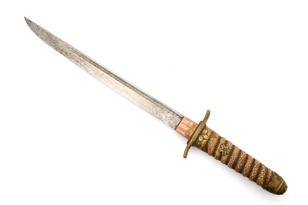

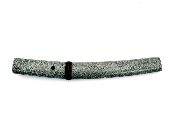

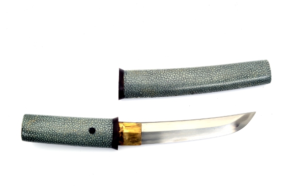

This is the second of the two Tantō Daggers that I am trying to learn about. I've been told that it was for use by Kamikaze pilots in WWII.
The overall length is 9 inches. The blade measures 5 1/4 inches from the tip to the guard.
The photos are copyright (c) 2012 by Dana K. Williams, All Rights Are Reserved
I've not seen any genuine military dirks or tanto like this, just plenty of Chinese fakes. Officer and kamikaze dirks in my experience tend to have either plain wood grip and scabbard, or lacquered, or leather covered.

These are problematic at best.
I was examining a similar 'dirk' a few weeks ago and whilst beautifully made with a striking hamon, the overall feel didn't seem right for a wartime piece.
It also had the complete shark/ray skin cover, but I remember that the joins on the skin seemed slightly 'ragged' and ugly. I actually disassembled it and the tang seemed artificially aged.
I would be interested to see your piece taken apart if you don't mind?
The definately genuine examples are in my limited experience mounted in plain wood, or even more rarely leather covered. (sometimes in a linen or leather cover/bag).
The one's I've seen also have 'flush' collars and not the tapering ones that your's has.
So, as a background on these, they certainly DO exist, although for obvious reasons they are rather rare.
The 'Kamikaze' (Divine wind/God Wind) pilots were allowed to carry a small Aikuchi dagger to allow him to slit his jugular vein in the seconds before impact.
Clearly the practicality of being able to do this while under heavy fire from the ships and wresting with the controls to stay 'on target' is debatable at best and it's unlikely that many pilots managed to say a prayer and slit their own throats and still hit the target.
However, that hasn't lessened the 'legend' of the Kamikaze and the demand from collectors for their 'dirks'.
As with all 'suicide bombers' the psychological effect, fear and damage to morale that they engender in those on the recieving end cannot be underestimated.
Bearing that in mind it's easy to understand why the 'Kamikaze dirk' has always been a desirable and sought after item.
After the war, when Japan was occupied and awash with American servicemen looking for souvenirs, I've often wondered if some of these 'more elaborate' Aikuchi were produced as 'letter openers' and sold to servicemen with a 'wink and a nudge' (or whatever the Japanese equivilent is).
That's just a thought, I have no evidence to back it up as I've never really attempted to look into it.
One thing is for sure. There are a lot of similar fakes that have come from China and continue to do so.
So! Is it a Kamikaze dirk?
I'd say not.
Could it be small non-military Aikuchi? You'll need to take pictures of it in pieces and wait for those who collect such things.
Or is it a later 'post war' souvenir?

Sorry, but it is not a kamikaze tanto, just an aikuchi (guardless) tanto. For more info on Japanese military tanto see my page at:
http://japaneseswordindex.com/dirks.htm
Possibly a kwaikan (ladies sleeve tanto) based on size and simple same' covering. Not ruling out a late tourist knife or even Chinese fake however.
It needs to be seen up close and personal to tell.

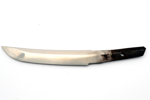

Old 5th February 2013, 06:30 PM   #10
dana_w
dana_w's Avatar
Join Date: Nov 2012
Location: Southeast Florida, USA
Posts: 437
Thanks everyone!

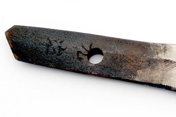

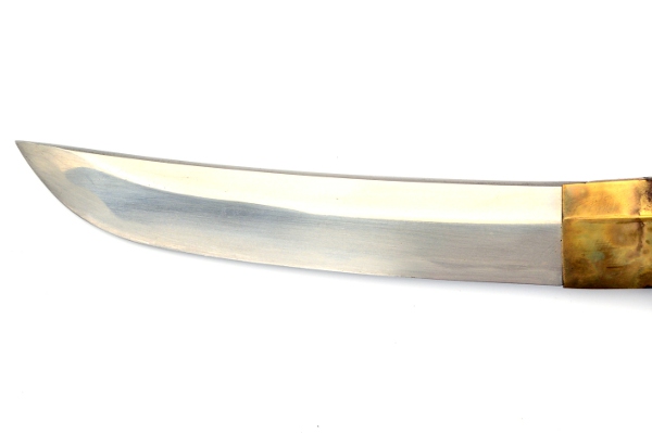

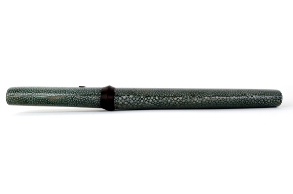

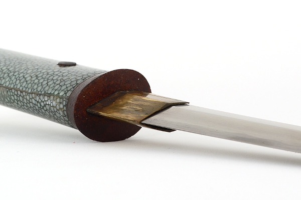

Here are three more photographs. If you can you give me any tips on removing the pin, I will photograph the tang.

Posts: 2,928
Did it come from the UK?
The peg should just push out from the narrow side (I assume the side not standing slightly proud). I suggest using a matchstick and be careful.
Old 5th February 2013, 07:52 PM   #12

No, it didn't come from the UK. My Dad picked it up at a gun show in North Florida eight or nine years ago.
The fit of the peg / pin is too tight to just push out. I may be able to tap on it with a punch.

FWIW, I use the skinny end of a chopstick as an awl/punch and a rubber or (better yet) a wooden mallet to tap it out.

Ok, I used the skinny end of a chopstick and a rubber mallet, but I can only move the pin a little less than half way. Any suggestions.

Sure - punch it out the rest of the way.
These mekugi are made to be slightly tapered, so if it's come out halfway, removal shouldn't be an issue... If it's stuck, then maybe you're trying to force it out from the wrong side?

I just needed to use a little more persuasion.

While the hamon appears to be legit, i.e., the blade looks to be differentially hardened, there are plenty of differentailly hardened contemporary - and commerical - katana that would make a nice template form which to make one of these... With that in mind, I see a couple 'red flags' right off the bat... the displacement between the mune machi and the ha machi appears extreme IMO, and while at first glace I would think this to be a cut-down katana - which would explain the mekugi ani having been drilled through the mei - the mei wouldn't have existed where it is if this were the case...
Maybe reduced from the machi and re-profiled and re-tempered (not sure if or how the kissaki could be reprofiled though or if this is even done) ?
Another concern I have is that the patina inside the kanji looks new relative to the patina of the nakago, suggesting (again IMHO) it is gimei.
However, please accept my input as being worth exactly what it cost...
And please understand I am only looking at this as if I were considering it for myself, which means (especially when it comes to nihonto) I am looking at it with an awfully critical (and even somewhat skeptical) eye.
I look forward to hearing what Rich has to say about this, as he is the resident authority on nihonto.

Dana, the tanto is a modern reproduction, I have seen this type for sale quite often. Your WWII dirk is also called a "tanken".

Is there anyway to put a production date on the officers naval dirk? Is it worth removing the handle and photographing the tang?
dana_w is offline   Reply With Quote
Old 7th February 2013, 05:05 PM   #22
laEspadaAncha
Posts: 608
In a word, no.
The blade in the officer's dirk is almost certainly (read: certainly) not nihonto, and is more appreciable and desirable left as-is.

To be honest, that's a good question, Dana... As I understand it, this pattern is still issued in the Japanese navy to this day.
With some Japanese military-pattern edged weapons (e.g., Type 30 bayonets and Type 95 NCO swords), arsenal marks, serial numbers, and/or acceptance stamps can sometimes be used to narrow down a date range with varying degrees of success. There should be arsenal marks or acceptance stamps on the crossguard of your dirk.
Another clue may be found in the same grips. Is the grip of your exmaple made with real or synthetic same? If synthetic, it dates to late-WWII or later.

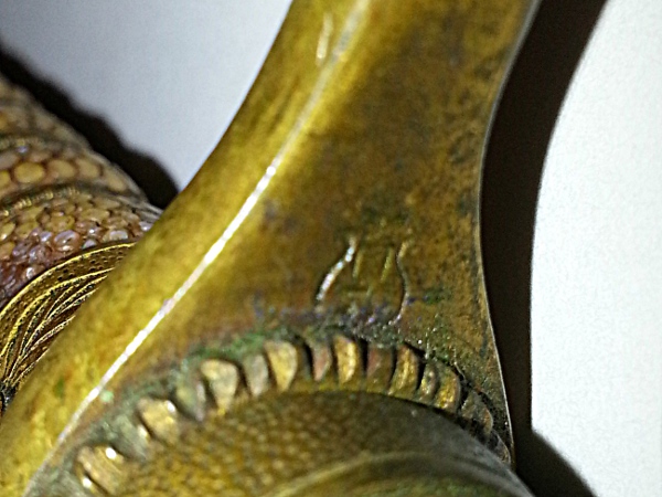

Hello laEspadaAncha,
Here is a photo of a mark on the crossguard made with my cell phone.
Is there anything to look for that would tell if the grip is synthetic or real?

The same looks to be authentic. The maker mark is that of Suya Co. Overall, this dirk is of very good quality, and possibly pre WWII.

There are two blades here.
The Navy Dagger is absolutely a piece of WWII era Japanese militaria.
The other blade is absolutely Modern Chinese production. Your father wasted his money. It will be hundreds of years before this has collectors' value.

Thanks trenchwarfare, I'll see if I can find some information on the Suya Company..... Ok found something "Suya Shōten Co. Ltd with To inspection stamp". Time to do some more reading.
pbleed, You must be psychic to say that my father "wasted his money". What do you think he paid?
In any case, I would enjoy seeing a picture of your WWII era Navy Dagger for comparison.

Well, gee.
I tried in concrete terms to explain what IJN daggers are really worth. There are lots of books and websites that offer this information on these blades. I did not mention the fact that I currently have a IJN dagger that I would sell for XXX as a ad. I simply thought it was a graphic demonstration of the real world value of such daggers.
Apparently, my comments on the other "sword" seemed harsh. I'm sorry. But this knife it has nothing of the balance and beauty of a real Japanese sword. I never met your Dad. And Lord knows that I have made lots of good friends at Gun Shows.I probably would have liked him. But, whatever he paid for it, as an investment, this knife has essentially no upward potential. It was, in other words, "a bad investment." Maybe your Dad had a great day, a pleasant trip, and a good lunch. I hope so. Maybe he liked buying this sword. That's okay, too. But you seemed to want information about this knife and I assumed that the purpose of this list is to tell the truth.
Maybe I was short, but I tried only to tell you about this knife. It is not old. It is Chinese in origin, and -given the standards of Japanese swords- it is not handsome.
