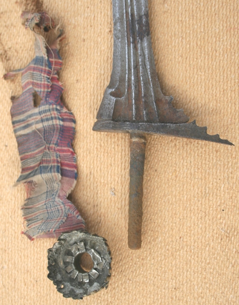

It took a lot of effort to get the hilt off so appears to have been together for a long time.

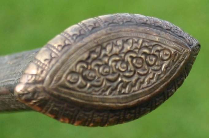

I think thats a very nice Keris Royston!
Great size, interesting hilt form.
Very unusual two part pendok with bands!

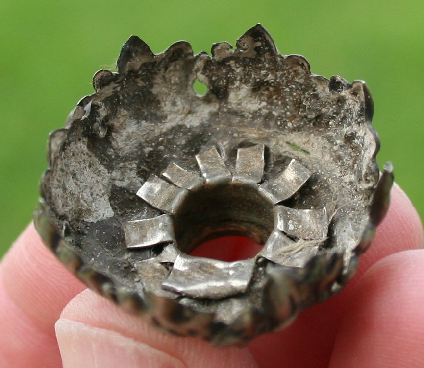

What about the cup ? Anyone any suggestions on the fit of this ?

Though an attractive form the cup is certainly too large for the hilt, You might want to consider finding a smaller replacement.

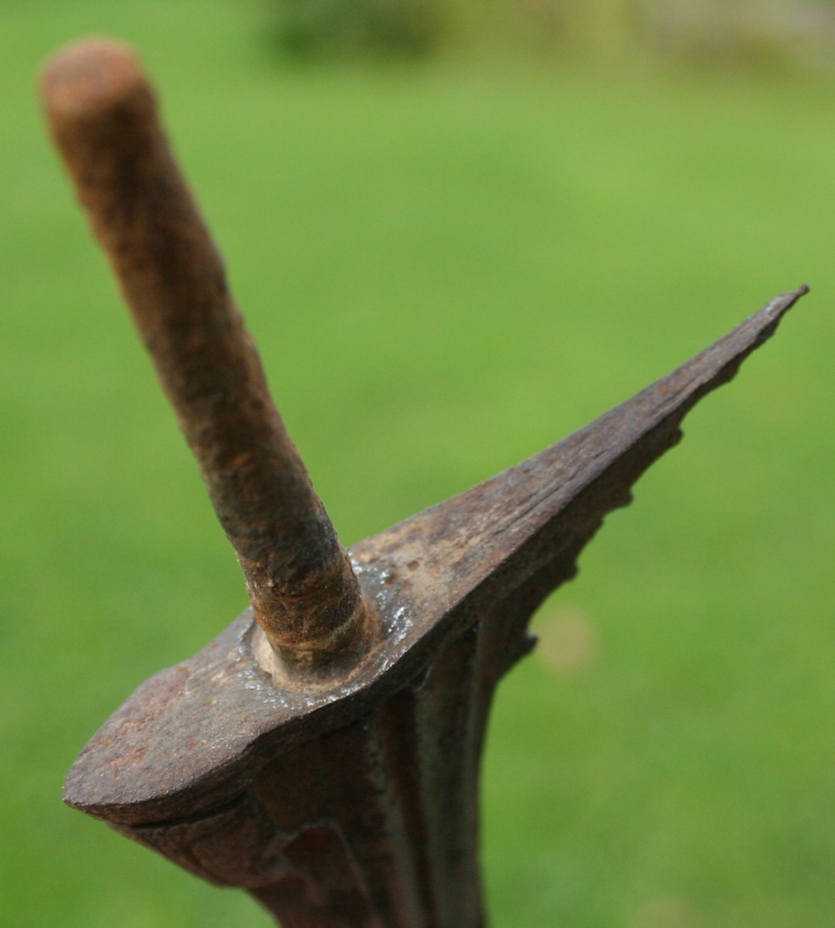

In the Malay world including much of Sumatra, blades of this style are usually kept smooth: polished and only swiftly etched/stained. It stands to reason that the minority, blades with distinct miring pamor, will have benefited from warangan treatment while it is often not clear what the preferred treatment for the huge majority of laminated blades with only low-contrast pamor was in different areas historically. It's likely that this often only was an acid etch with fruit juice or vinegar.
Roy's blade is clearly laminated and this will most probably show nicely with little effort and some gentle etching.
I'm with David, it's obviously a bad replacement (in addition to the non-fit, compare the quality of workmanship...); the ensemble would certainly benefit from a matching pendokok. Old ones are tough to find - you may want to consider having one made in the region?
