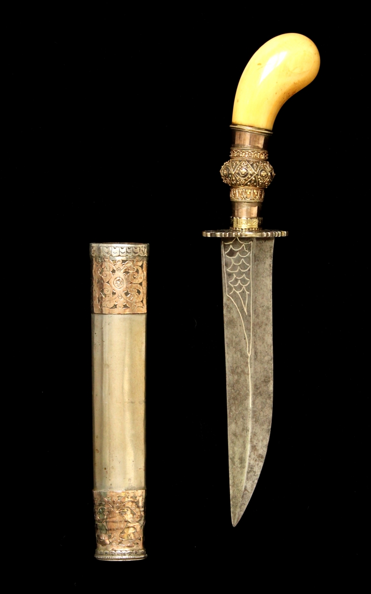

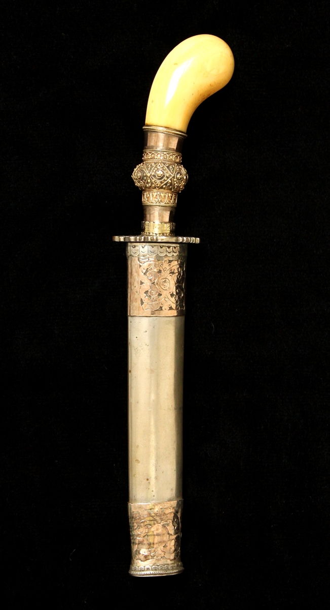

A nice and used gunong found in a Middle-East antique shop!
Old 4th October 2012, 02:03 PM   #9
Posts: 7,303
That's a sweet gunong you have there Jean...

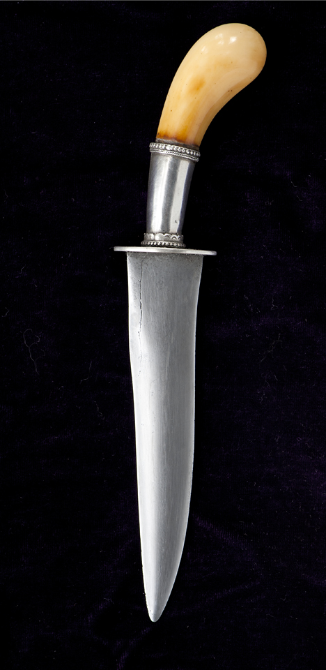

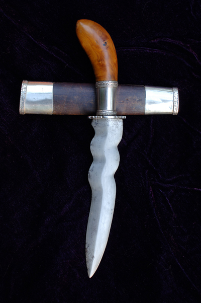

Here are the blades. The hilt orientation seems correct to me. I believe this is a matter of which side of the body the sheaths are oriented to be worn on.
Old 5th October 2012, 01:28 AM   #10
Posts: 7,417
Well the blades do show that they are not post 1940s. Nice blades, although I suspect an etch could show laminations.
These knives if I remember right were used for personal defense. Smaller ones are usually older (as well as your hilts on these) and kept on the body, sometimes even hidden in the clothing.
As far as the sword banning, it was done I think after the Battle of Bud Bagsak, which was in 1915. After this battle we gradually see these gunongs get bigger and more ornate, sort of replacing the outlawed Moro swords.
Old 5th October 2012, 02:51 AM   #11
Posts: 7,303
Jose, i pretty sure these are both pre-1920. I really think they are both closer to turn of the century. They are indeed both laminated blades, but they don't show any particularly interesting pattern. I did an etch on the ivory one and brought it back a bit because it looks better this way.
