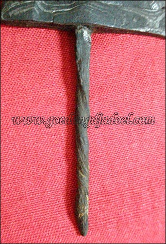

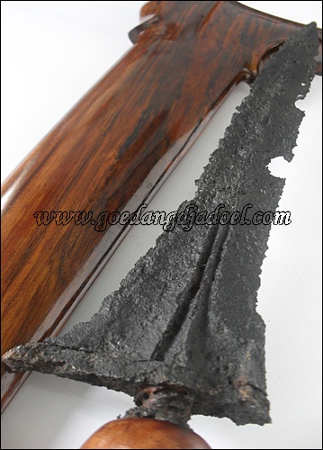

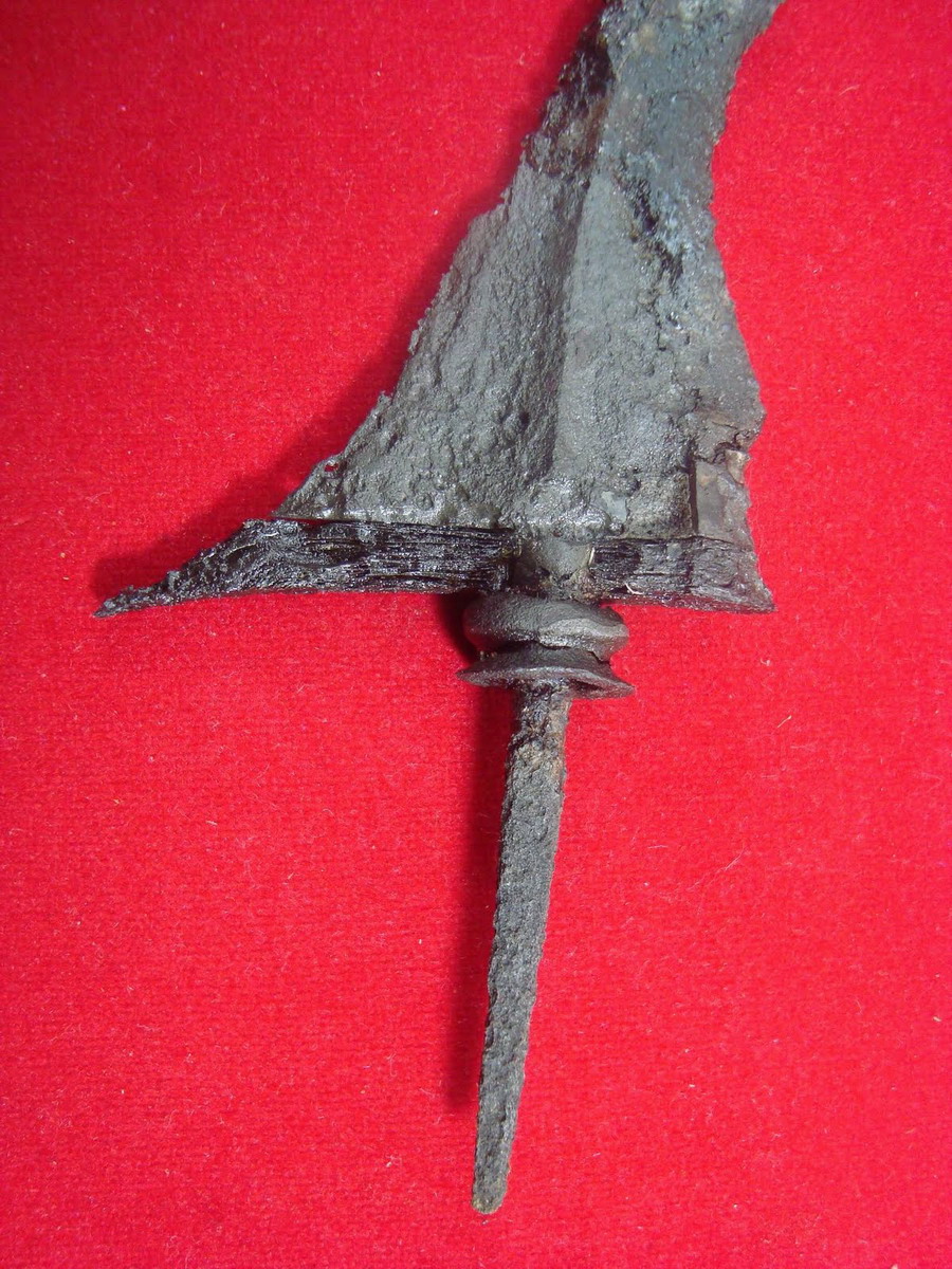

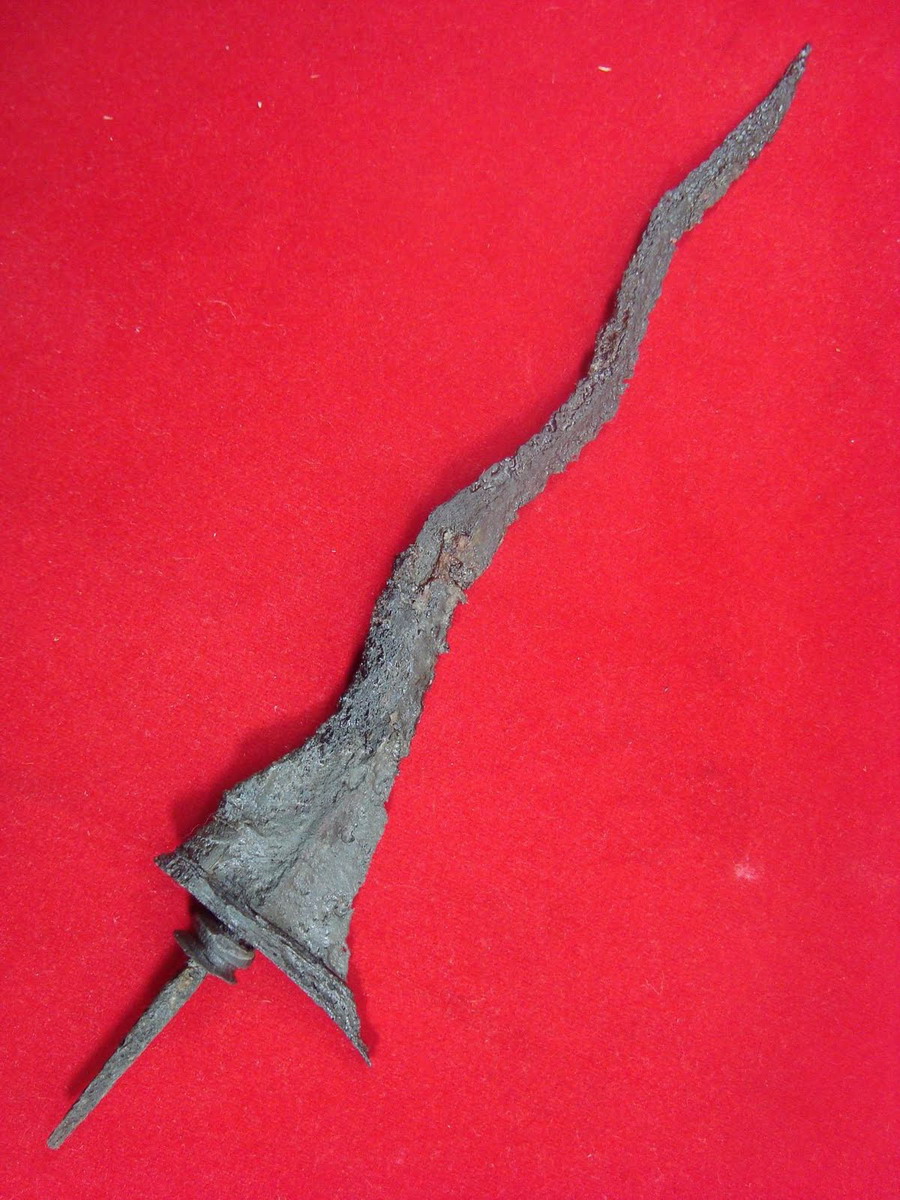

OK back to the point, I would like to ask you about one characteristic of older blade my friend told me last night
feel free to correct me on this one
there are 3 shapes of pesi : rounded, rounded and spiral-like, and squared (kotak)
squared pesi are from old blade, very old blade
spiral-like and rounded are common and from younger blade
is it true ?? can the shape of pesi be used as one of main factor to determine age ?? is there no younger keris with pesi kotak ?? (squared)
photo below taken from various sources, and only served as educational purposes - I have sent email to the owner asking for permission to use his pictures for educational purposes and as courtesy, I put the link to his website : http://goedangdjadoel.com/2011/12/keris-jalak-budho/
1st photo from Jalak Budho keris, the owner said that it is genuine Singosari era, and honestly that's what I thought seeing this keris ... looked like something you dig up from the ground - and has been there for centuries
2nd photo showing the keris' pesi (squared), or kotak in Indonesian terms
3rd photo showing standard pesi (rounded)
4th photo showing spiral-like pesi
