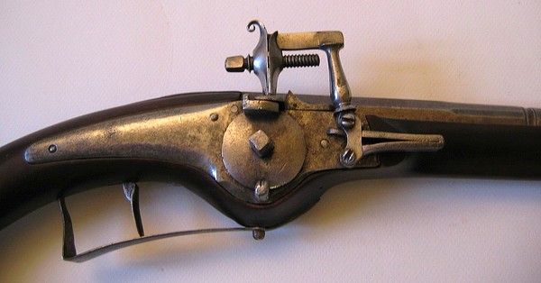

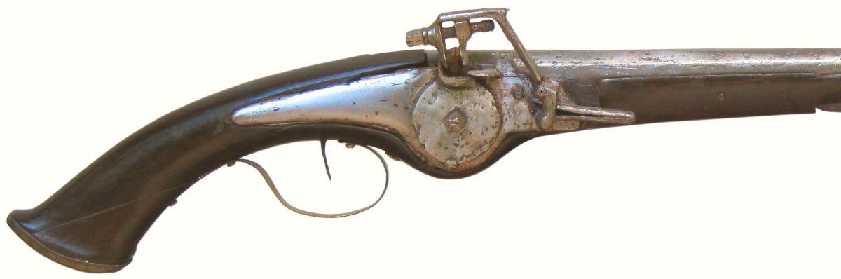

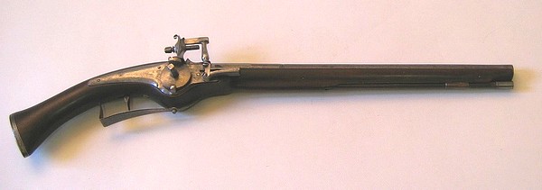

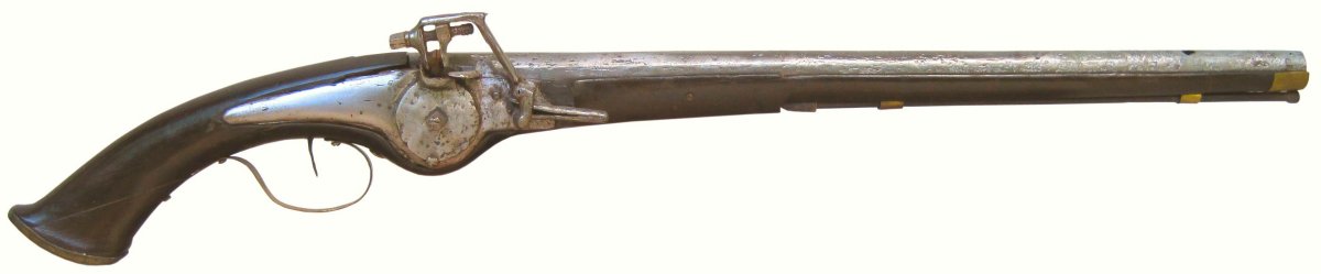

Please, what do you think of this wheellock pistol, ca; 1630-40 ?
Do you think it is good ?
Thanks,
jm

Hi Jean-Marc,
This is a characteristic Late-Thirty Years War 'military' wheellock saddle pistol of Netherlandish type, the rounded lock plate with beveled edges denoting that it should be assigned to the second half of the 1640's-1650.
Provided that the ramrod is the original its iron finial may be threaded for a worm and scourer for cleaning the barrel.

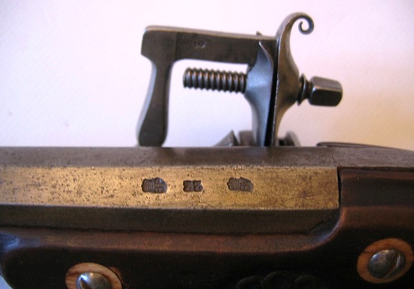

I cannot make out the barrel marks but their general rectangular shape, most probably struck containing capital letters, is also typical of the Netherlands. Good close-ups (!) provided, I could probably tell you more.

Thanks Michael. Could it be actually a German military pistol, as stated by the original owner ?
Barrel markings are 'BP' and 'BV'
Are all parts original 17th century (from the pics) ?
jm

Posts: 4,310
I am not Superman, J.-M.,
Meaning that I do not have anything like 'Rontgen' power.
In order to try and qualifiedly answer your queries I definitely need good, big and detailed close-ups - for comparison, please check out the quality of images that I usually post.
I would also have to see a clear view of the inside of the lock mechanism.
What about the ramrod finial detail I inquired about?
From what I have seen that far the butt-stock of this pistol comes close to some English 'Cromwellian' type items I have seen, which of course were based on the Netherlands' style.
m

The ramrod was said to be a replacement piece (not an original one).
jm

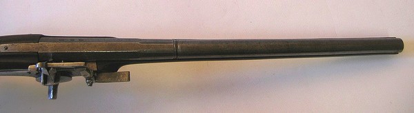

Posts: 4,310

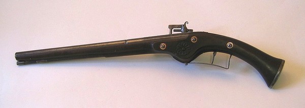

Here is another Netherlandish wheellock holster pistol, ca. 1650-55, dated on the grounds of the rounded lock with beveled edges and the barrel changing from octagonal to round without a noticeable staging - very similar to the one you posted, Jean-Marc.
It was found in the mud of the river Hase in Emsland, near the Netherlands border, and is preserved in astoundingly good condition, with all the original wooden parts still there; the mounts are of brass which is also typical of post-1650 firearms from Holland and the far Western parts of Germany (Aachen, e.g.).
m
