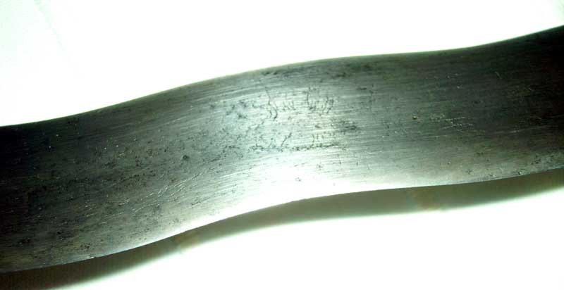

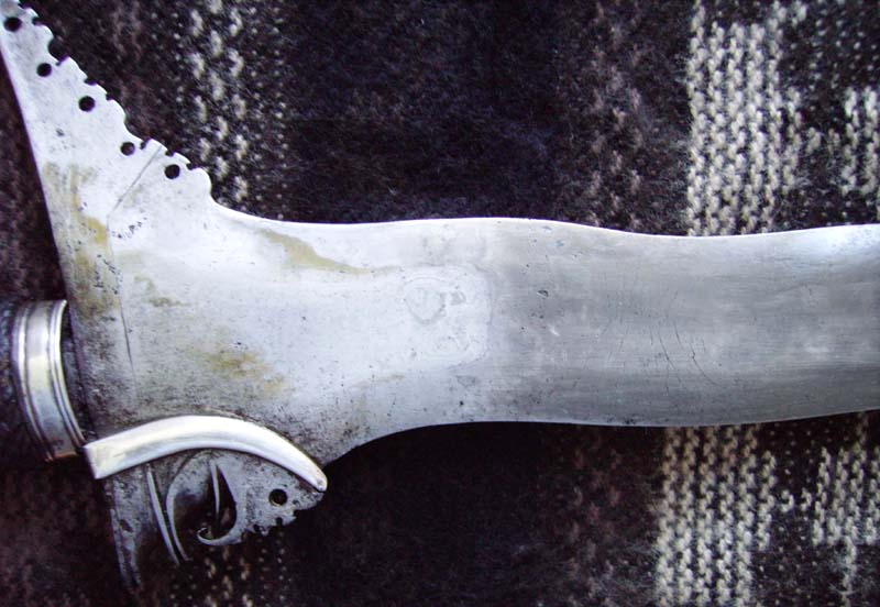

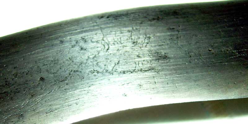

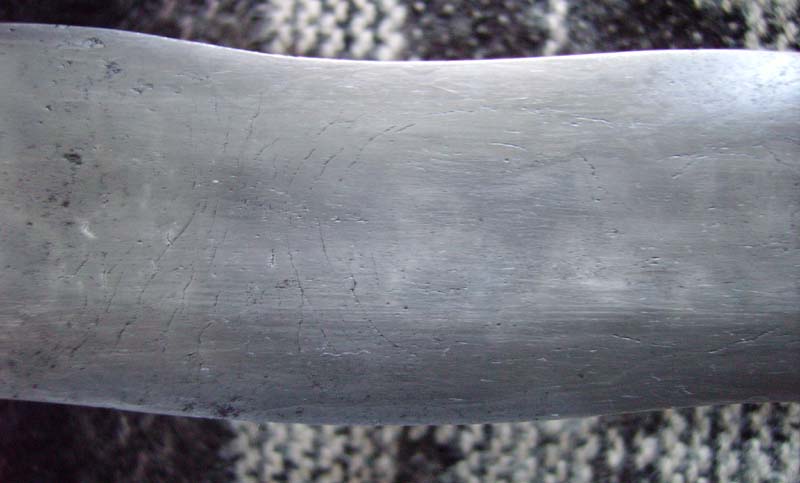

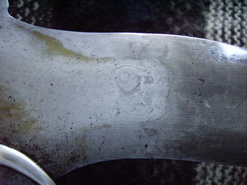

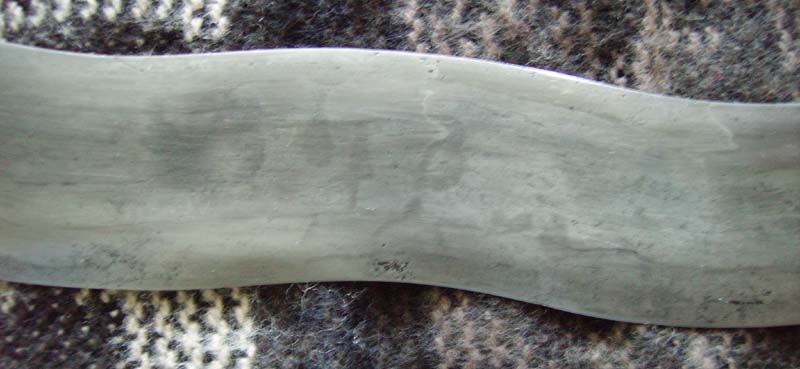

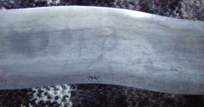

Here is a nice kris that maybe someone already knows I have etched the blade but there is something strange: the area near the gangya shows a clear lamination, but the rest of the blade is black!!! Anyway, even if the pictures are quite bad, you can see a nice lamination. Maybe this is due to many and many deep polishings of the blade that have removed the "superficial" steel, and so the original lamination that is something like you see near the ganya???? Any comment is welcome and appreciated

That is an unexpected occurrence. Is it possible that there are two parts to this blade. ? In the motor trade it might be known as a cut and shut.
I suspect you may have a real winner here... Could you please email larger close-ups of the blade?
The original sandwich construction is certainly still intact: I do see blurry laminations towards the tip of the blade. I think you're just in for some more rounds of polishing and etching to get a very pleasing result - go for it!

I agree with Kai & Rick that it would be worth it to re-polish & etch again. I have a wavey kris that is somewhat simular. The inner core much lighter, the outside almost being black (I've never etched it). In almost the same place as in Flavio's kriss, mine also has the same characteristics except it's a very distinct line that's the same on both sides. I've always assumed that it is a quench line but I'm far from certain. My sword has held a very sharp edge. Usually I have noticed, while etching, old rust area's will come out dark/black; but definitely, some steels will etch out almost black while others in the same blade stay light.
No, not a quench line: Your's is a perfect example of the usual sandwich construction with the outer steel with less carbon (but more tensile strength) partly covering the central plate of harder high carbon steel. Both steels can show laminations although this is usually only obvious within the low carbon steel (both for twist core as well as more laminar/random pattern welded blades).

Kai, Sorry but the picture doesn't show my point well. I'm not set up for pics right now & added this one as a after-thought to my post (I had it on disk). There is a faint line on the pic (very strong on visual expection) about 5 cm from the hilt. The outer darkness stays the same on both sides of the line but the inner core has noticable differences in the lamination. That is the line, that may be a quench line. I assume the smith started by making a straight sword, adding the waves after. Would he use constant quenching to keep previous "waves" from being distorted as he preceded? Kris generally keep a very sharp edge, this one is even sharper then the usual, another reason it may have a unusual quench "marking"?

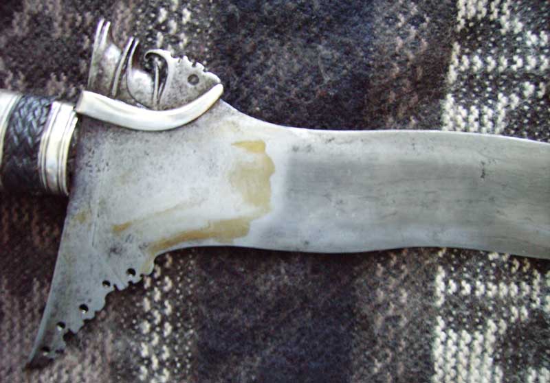

I have seen a lighter area at the forte of a blade on a Chinese dao that Philip Tom attributed to annealing. The idea was to reheat the base of the blade and let it cool slowly to increase durability at the expense of hardness in an area where hardness is not as important. This is not a comment on the underlying pattern of the steel, but the lighter area at the base of the blade looks almost exactly like what I saw on the dao.

Well, since I will not have the time in the next few days to re-polish and re etch the blade I have a more close look at the blade: in on side there are three (maybe four) clear rows that comes from the gangya area untill the point in the middle portion of the blade (the center). On the other side these rows are clear but I can see also some other thinner lines (the others in the center of the blade are 0.6 mm circa of width). In the pictures you can see a photo taken before of the etching: there are some strange, how can I say, "cracks" on the blade....
Thanks for the nice observation! Maybe this would be preferable to do before attaching the gangya; it seems safe to assume that the latter was also annealed for ease of working and toughness.
The only other explanation which comes to my mind would be quenching almost the whole blade in some fluid...

Hi all!! Well I was so curoius that I can't wait: I have tried but don't seems to be twisted core..... I'm so sorry, I was hoping.... Anyway I haven't taken pictures because it wasn't worth. I have polished and etched twice one side of the blade, one time with cloruric ferric and than with lemon, but nothing. Anyway I will try again on the whole blade with vinegar.... The last chance

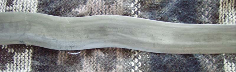

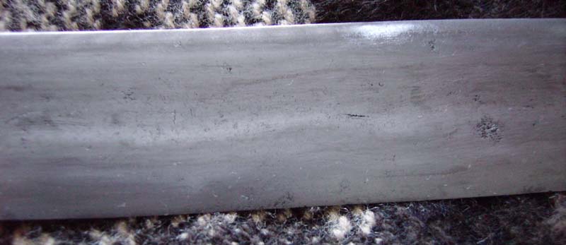

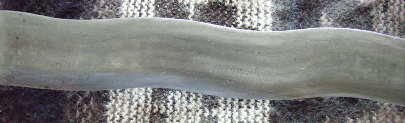

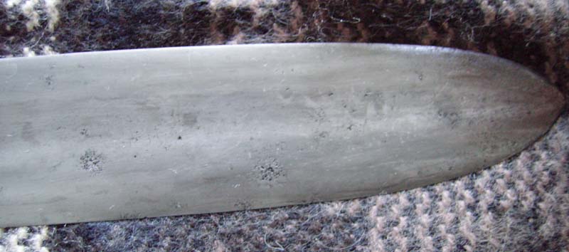

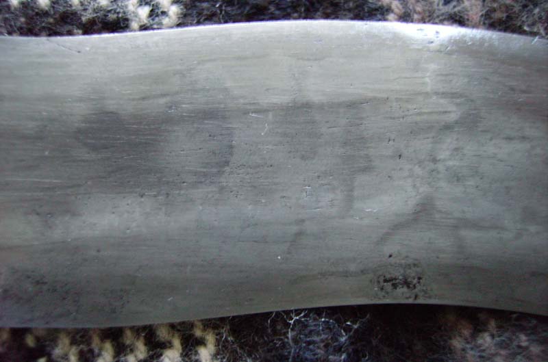

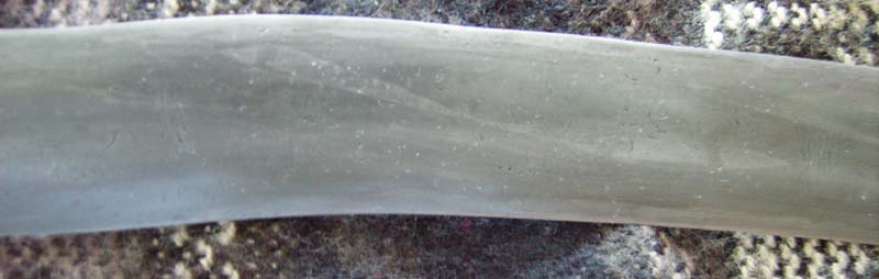

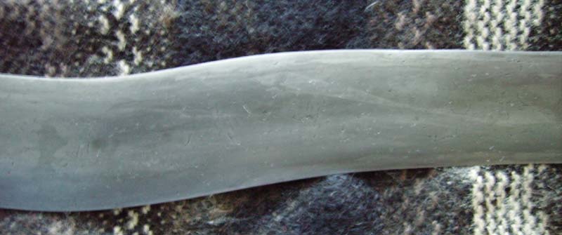

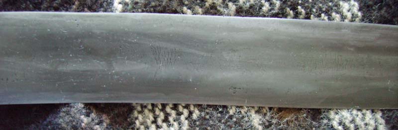

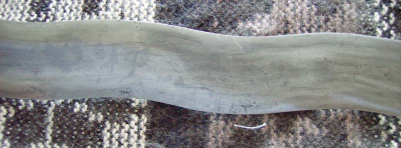

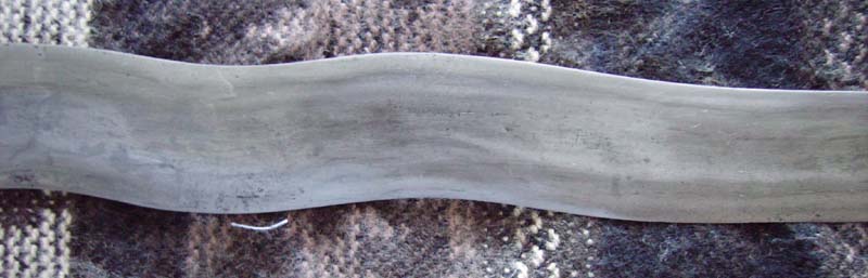

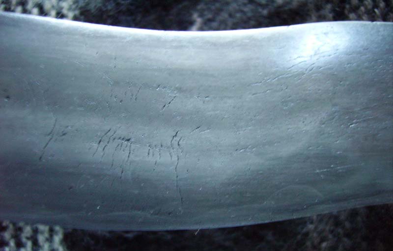

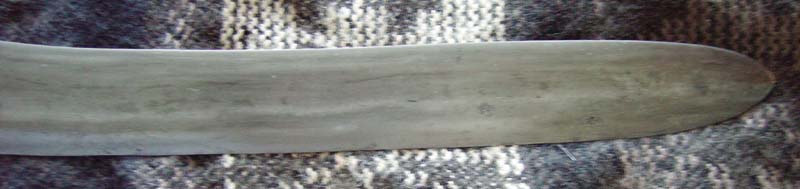

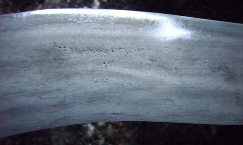

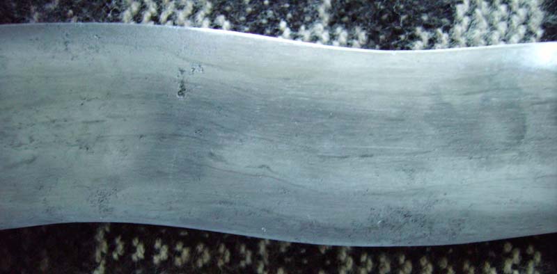

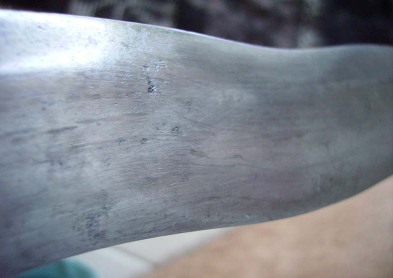

Well, guys, I need all you help here: attached are many (maybe too much ) pictures of the result.... If in some parts seems that the blade could be twisted core, in other no at all!! So please, be so kind to be clear : it's me (i'm not an expert and this is not my field, so no offens) or it's the blade??? Thanks a lot

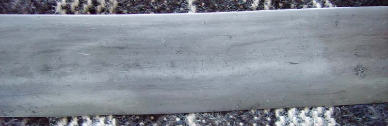

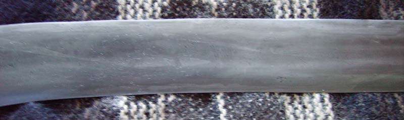

others

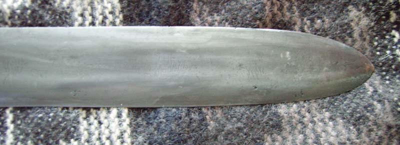

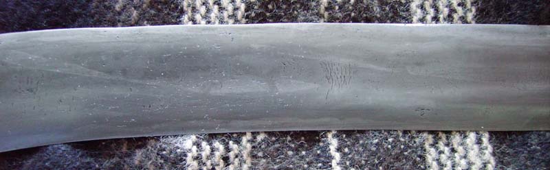

Location: Italia
Posts: 1,243
two more
Old 28th July 2007, 07:48 PM   #24
Posts: 7,374
Keep re-etching it - something is coming out, though may be a lamination instead of twistcore.....

I know nothing about these things really but to me it looks like two billets are worked into one here. At what stage the smith decided more metal was needed one cannot tell. It seems clear more material has been added in the forging of this blade, a confluence at the forte is evident. I could be completely barking.

Hi Jose, maybe from pictures it's not so clear, but for sure the blade is laminated (parallel lamination alongs the blade). I have etched the blade for an hour or so with some stops to clear the vinegar with cold water and this is the result. All other weapons that I have etched didn't take so long time to shows the pattern
Hi RIck, no I have tried with vinegar, cloruric ferric and lemon (in every different etching, not together ). This time with vinegar again
