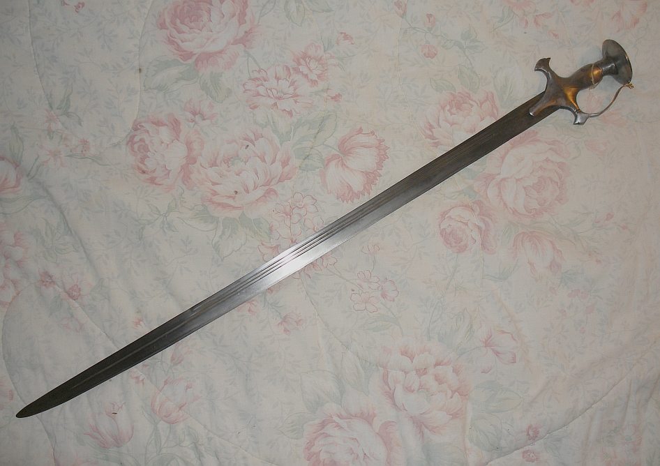

Default UNUSUAL TULWAR for COMMENT

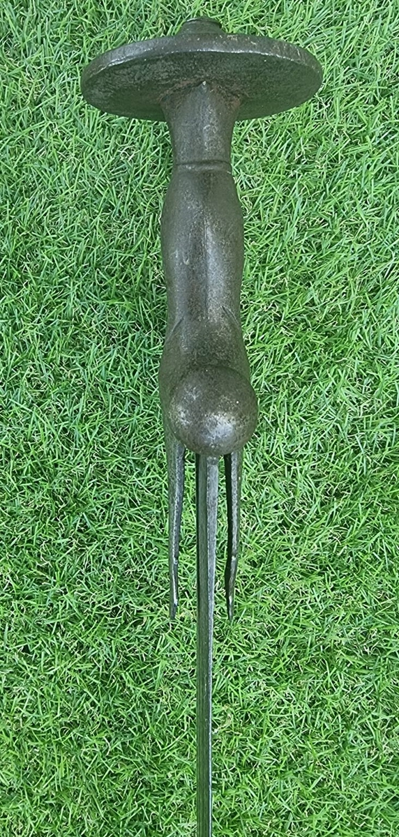

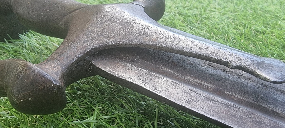

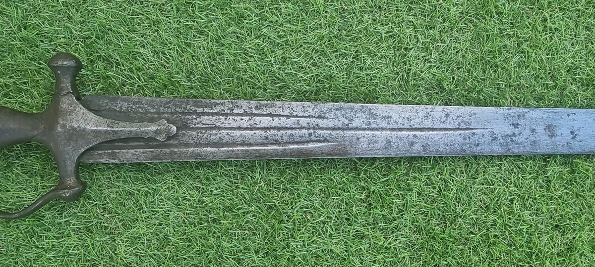

This Tulwar just finished at auction here and I am interested to see what Members think about the blade. It looks very much like a Takouba type blade but does not appear to be a "hybrid" creation.
Stu

This is a very interesting and unusual talwar. If its length were more than 120 cm, then we could boldly call it as "dhōp".

Hi Stu,
This does look like a firangi (foreign) blade, but I would not exclude the possibility that it was a local copy. Most firangi I have seen were longer than the usual tulwar. Hard to judge age, but it does not look recent.

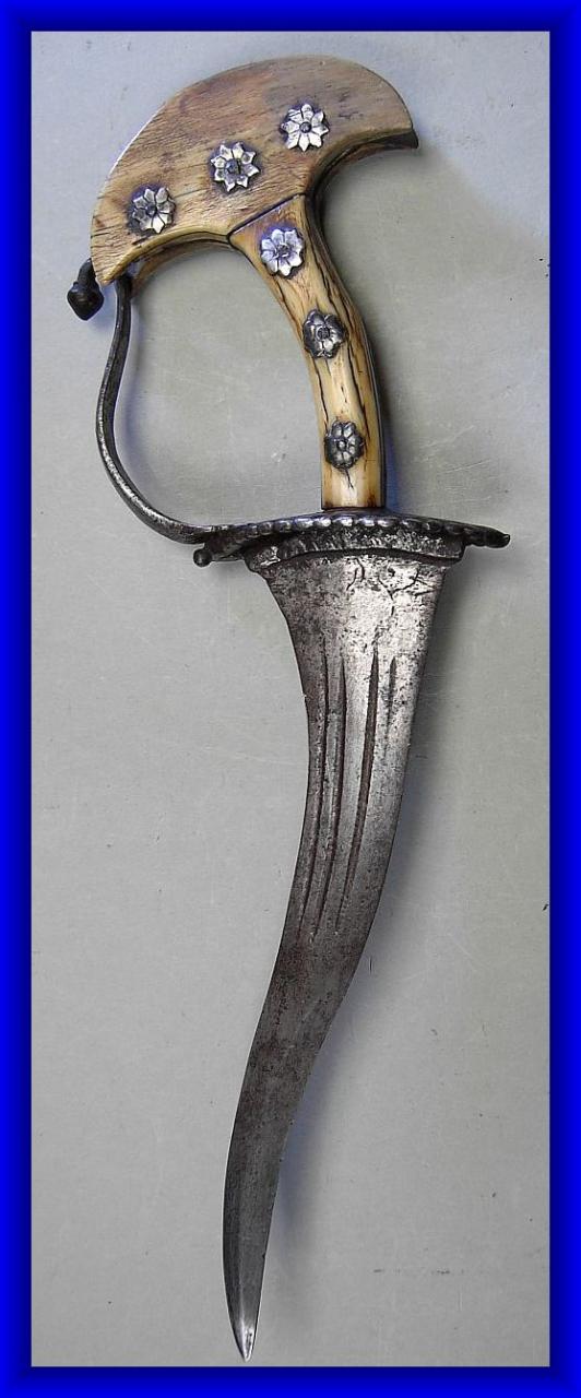

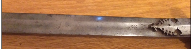

Very interesting blade decoration; I have a khanjarli with the same type of decoration

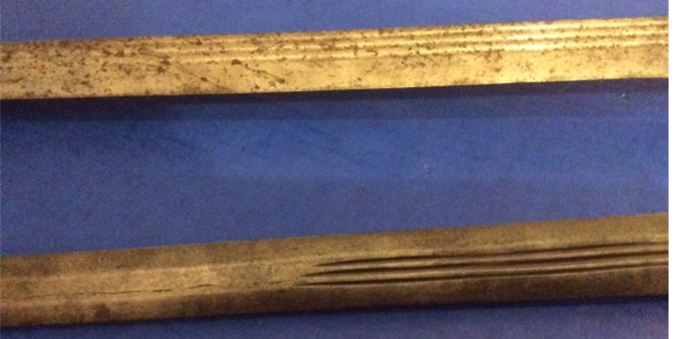

I have Indian blades with the same fullers...
Yes, Indians imitated European blades, nothing new.
If Tuaregs can do it, of course, Indians can do it too!
I agree with Mercenary, Firangi means nothing, just foreigner and the Indian swords called firangi have a basket hilt...

What hilts are your fullered blades on? Do you have any blades like this with TULWAR hilts. If so could you please post some pics.
I was hoping that this thread would comment on the particular blade/hilt combination as I have not been able to find any other pics or reference to Tulwars like this.
Stu

Posts: 10,860
My initial thought in seeing this example, I thought perhaps this was a Sudanese kaskara blade mounted in a tulwar hilt. However, while the crudely drawn central triple fullers resemble those on the blades commonly seen on these, the blade fans out toward the hilt, while kaskara blades remain uniform.
A 'straight' blade 'tulwar' (Indo-Persian hilt) is known in Hindu as 'sukhela', and to the south in Deccan as 'dhup' (Marathi). ("The Indian Sword", P.Rawson, 1969, p.30,p.90).Trying to categorize these, just as with most ethnographic weapons, by term, is usually pure folly.
The straight blade on these swords seems to have been regarded in many cases as for representations of authority, court officials, and often soldiers or warriors of high esteem....apparently the variation had some significance.
It would seem this blade is a copied version of possibly the Sudanese kaskara blades, as far as fullering that is. Interestingly, I have seen Indian swords with 'kaskara or Sudanese' blades, or actually those of the form which were exported heavily into Sudan from Europe. In some cases these were with 'tulwar' hilts, some 'pata' etc.
That would suggest there was enough diffusion and interaction with trade between these spheres to bring about these kinds of circumstances.
Thus, a dhup/sukhela sword with probably Indian made approximation of either a Sudanese blade or its European counterpart. The 'firangi' term is used only collectively to describe any sword with a 'foreign' blade, regardless of overall sword form.

Hi Jim,
Thanks for your contribution. Much appreciated. Yes I would perhaps call this a Sukhela but any illustration I can find suggests that the Sukhela blade has paralel sides rather than tapered from the hilt as this blade is.
I am not (necessarily) trying to get a concise ID of this sword but simply to see if anyone else has (or has seen) this particular variant.
Stu

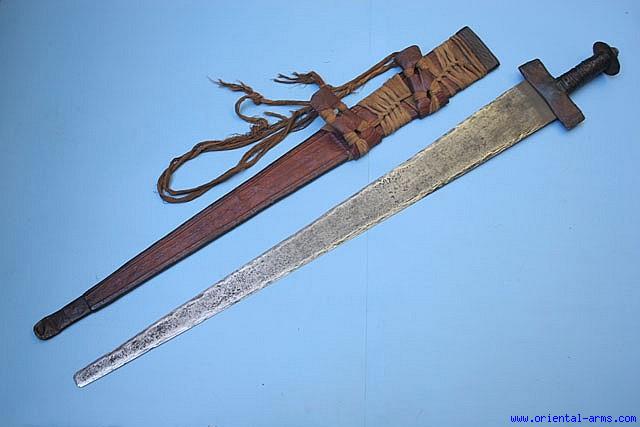

Here is a pata of mine I've had for about 40 years. As can be seen this appears to be a Solingen blade, the cosmological motif can be faintly seen. This is of the type that went into Sudan c. 1880s. The erratic profile of the blade is common on older kaskara and Saharan blades which have had rugged sharpening by native warriors with stones. Clearly this blade at some time ended up in this pata hillt, and it was long ago as considerably before I acquired it. In various ceremonies with groups in regions in SW India pata are used processionally and in demonstrations so this might well have been a votive piece, not intended for combat.
The wide, tapered blade takouba from regions in Saharan regions such as Mali, to Cameroon seems to have been status oriented. While often the upper part is covered by a metal collar, often these are seen with the kind of fullers seen on Stu's example.

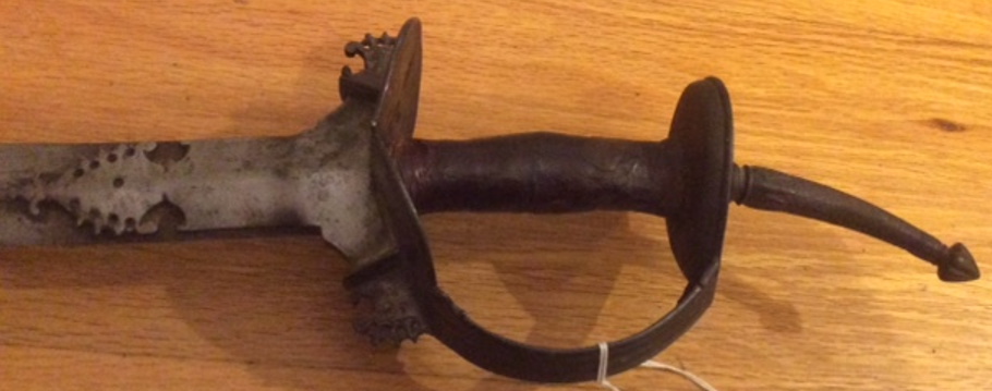

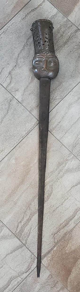

This sword belongs to me and I am as sure as I can be that it is all original and not a composite. I termed this sword as Sukhela as the blade has the flexibility to conform to the type. The sword form appears to be named after this type of steel. This is a backsword and I would be interested if Stu could confirm if his is a backsword or broadsword.
Norman.

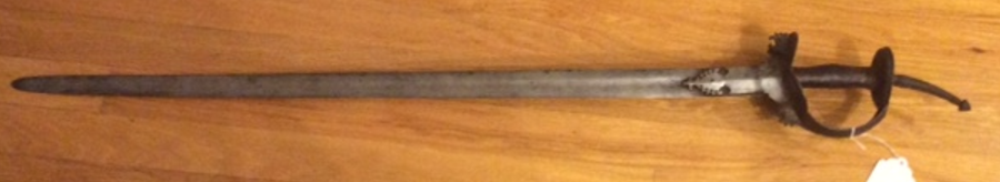

Hi,

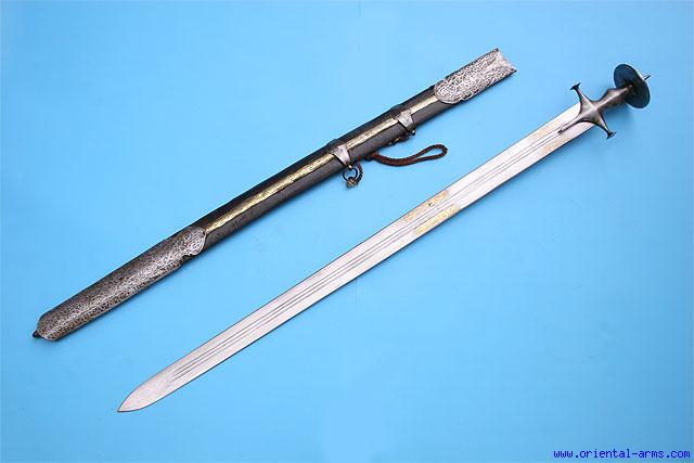

This sword belongs to Rick and again as far as I can see it is also a backsword.
Rick questioned whether his example be termed a Dhup.
Norman.

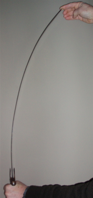

Old 4th September 2021, 01:36 AM   #27
Posts: 6,429
Originally Posted by Norman McCormick View Post
Hi,
Norman.
This sword came from Oriental Arms many years ago; Artzi described the steel as very fine grained, low contrast wootz.

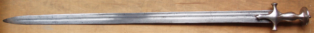

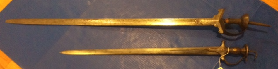

My understanding ( as per Elgood) that a Firangi ( European blade) migrated North and was called Dhup in the Deccan and Asa Shamshir in North India.
And yes, those were usually quite long, but, just like everything in India, they varied enormously.
Here I am showing my Firangis. It is quite dark outside, I had to turn off some lights in our pretty small " open" room to eliminate flashes on the blades and,- last but not least,- I am a crummy photographer!!!!!!

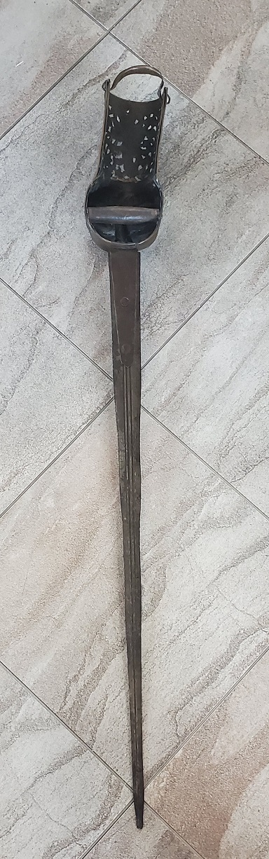

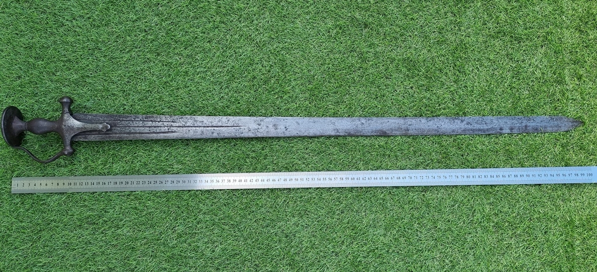

Default Real firangi.
This is an unquestionably real Firangi from the South.
European double-edged blade wit a single wide fuller and a " Genoese"/"Styrian"/ make your guess. trade blade. Blade is marked , see last pic.
No Indian ricasso, blade length 34 "
Good and complete basket handle with intact baluster and leather-wrapped hilt, old, practically congealed leather, if not the original, then definitely from the working life of this Firangi.

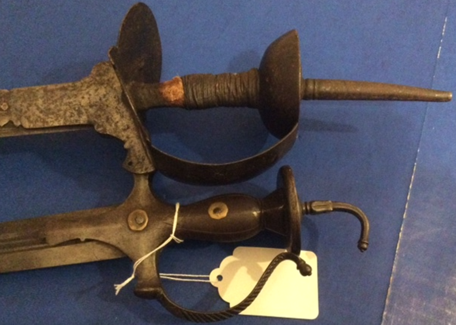

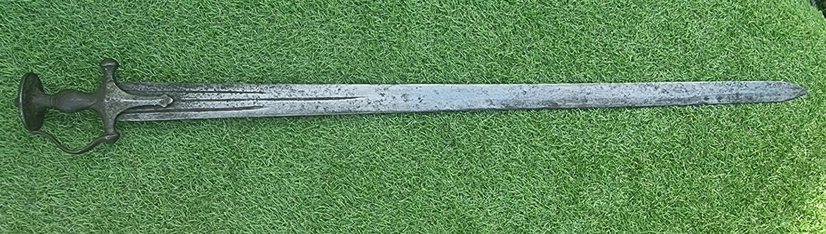

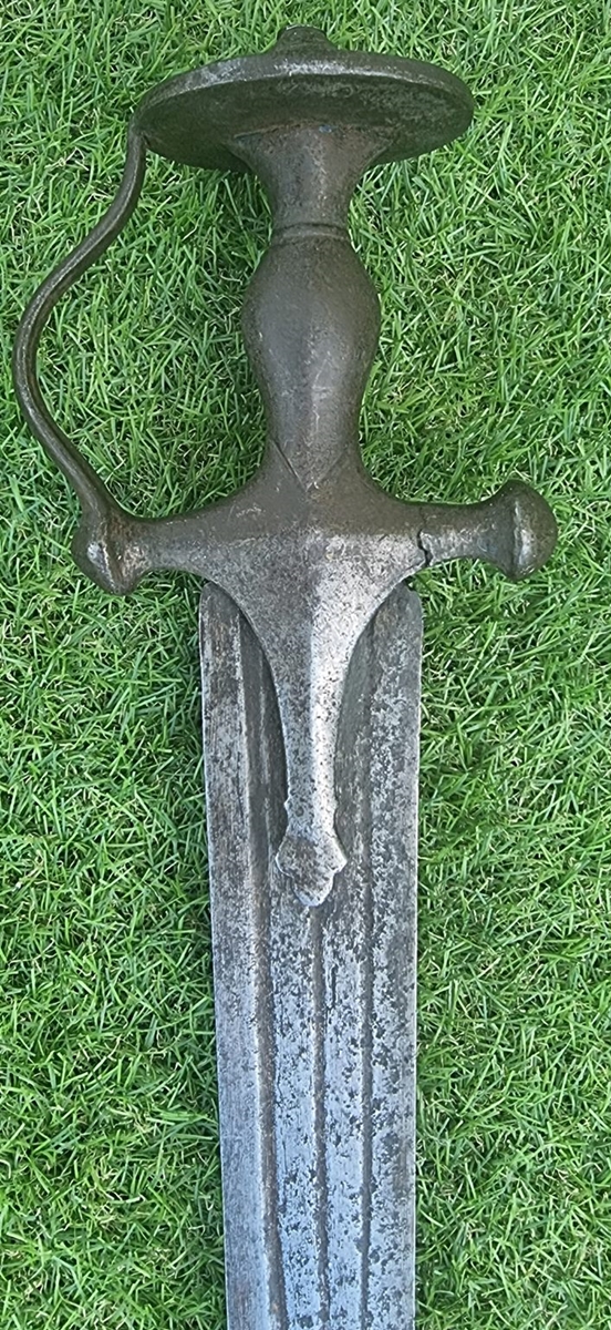

Default Two more firangis: Indian? European?

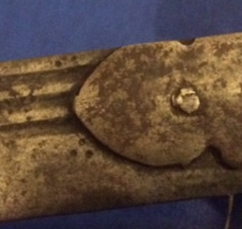

Here are two more with questionable datings and attributions.
The first pic shows them together: blade length of the long one is 38", definitely qualifying it as Asa Shamshir ( staff sword). The blade has 3 narrow fullers and we can see it on trade blade from Europe, North African and Indian, It is single -edged and has no Indian ricasso. There is a mark almost hidden under the langet: real European trade or local imitation? Pretty basic basket handle, no terminal of the baluster ( lost? never existed?) I suspect the entire sword is a local Indian production, likely Moghul, 18-19th century.
The short one is more interesting. blade length only 24". It is hexagonal that I cannot recall on genuine Indian blades. AFAIK, this pattern stems from the Spanish cavalry sword 1728 pattern, but please feel free to correct me. Three narrow central fullers, pretty crude carving technique, I would guess made locally. No Indian ricasso, double-edged. No marks. My guess those might have been lost when the blade was shortened: the original Spanish blade was 33" long and had small ricassos on both edges.
Typical Tulwar handle, but with an interesting feature: pretty long baluster that is bent down: usually thought to be a feature of the 17th century.
Two rivets with brass washers underneath: one at the grip, another at the quillon block. While some stress the presence of rivets (especially at the quillon block) as a distinctive Afghani feature, the original idea came from the South and just migrated North.
I would think about Deccan/ Maratha and place the whole thing around 17-18 century ( open for discussion). Highly likely, for both the blade and the handle it was not the first marriage:-)
