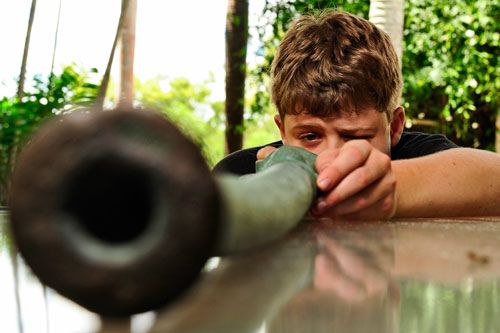

Have you guys seen the news ?
http://www.couriermail.com.au/ipad/....-1226241146851

Remarkable find indeed, especially if it is of Portuguese manufacture!
Michl
Old 12th January 2012, 02:01 PM   #3
That's precisely the point, Michl.
Portuguese style, no doubt, but ... Portuguese original manufacture or, cast in the West Indies ... Jawa, Sumatra, Malaca, under Portuguese supervision or later 'free lance' later copies, falling into the Lantaka area .
Let's see what the local museum says ... assuming they hold the final truth.

Too bad the photos did not show the area just forward of the breech opening, as it appears to bear some type of raised symbol. One here is much larger and bears a kind of star with a button in the middle in that area, and I'm fairly certain it is Malaysian, or at least "South Pacific" in origin. Back to the young man's discovery, given the geography of the area, if I had to judge whether it is more likely that this came from say, Indonesia as opposed to Portugal, my money would be on the former every time.
This is an extremely small, light weapon of its type, smaller than I've ever seen before, and was probably that size because it was the largest such weapon that could be carried by some kind of canoe or very small vessel. This is not the type of vessel that would be capable of traveling from Portugel to Australia, but more likely one which could make the journey from Indonesia to Australia, if with great difficulty. I've seen quite a few much larger breechloading "pedreros" of cast bronze, similar in construction to the small one shown, and most seem to have bores in the two to three-inch range and weigh somewhere between 100-250 pounds. The young man's find looks to have something like a one-inch bore and probably weighs 20 pounds. I'll see if I can dig up a photo of the larger Malaysian one we have here (about four feet long, 1.5-inch bore, 60 lbs.)

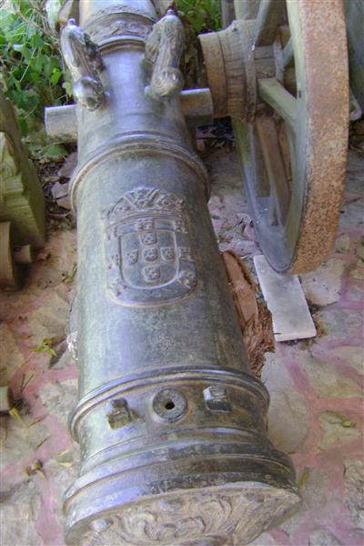

The authenticity of this piece (as being Portuguese or not) doesn’t necessarily have be questioned by its small dimensions.

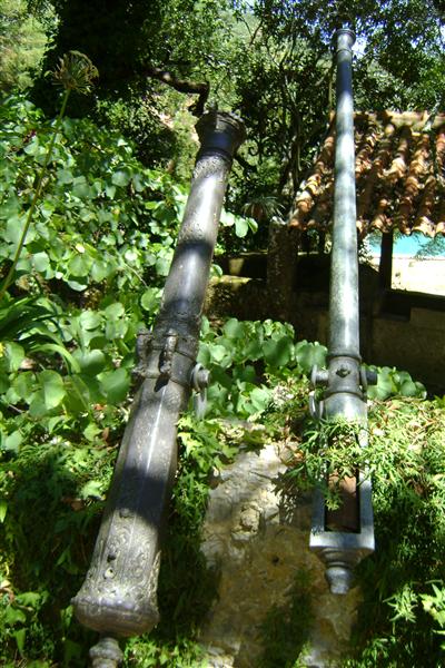

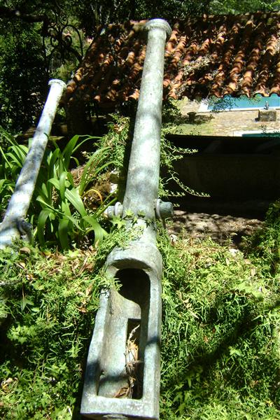

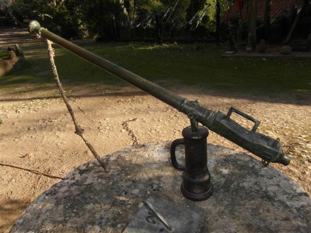

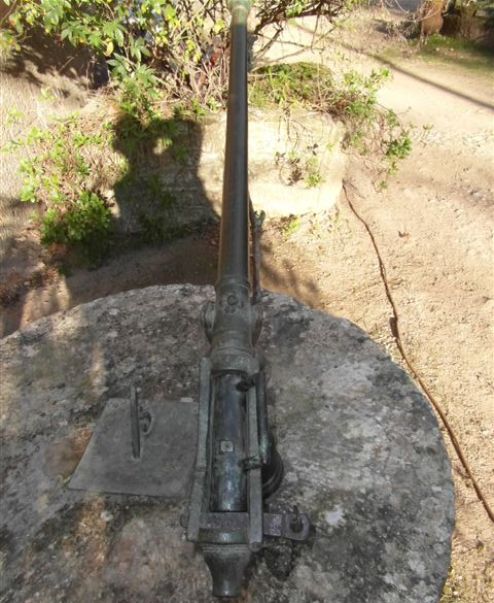

There were in fact small bronze ‘berços’ (cradles), cast in Lisbon, of the size fit to equip in batels (ships ‘multiuse’ auxiliary roaring boats) in disembarking operations and light enough to be carried by crew men in river exploits.
This recently found example might as well be a XVI-XVII century local interpretation of a Manuelin berço.
Attached is of such examples, cast in Oriental India between mid XVI and end XVII centuries, with a diameter of 1,5 cms and a cannon length of 97 cms. (excluding the cascavel).
Their ammunition was generally a lead bullet or a bamboo tube filled with small shot.
Still the authenticity of the one found in Australia is something to be discussed. This type of cannons, having joined the Lantaka family, were later (XIX century) developed into distinct purposes, as either operational or passive versions, the late being widely used as currency (cannon money).
Those bearing such examples in their hands are in a better condition to judge their purpose and originality.
Let’s see what those museum curators say about it … if only caring for the truth and not fearing to shake history concepts.
Fernando, the photos you posted there are as close to what I'd call a "dead ringer" (identical) as you can get. I isolated and compared features of the boy's cannon to yours and they are an excellent match down to some small details. I don't know the size of the boy's discovery so didn't compare that, but that's not as critical as the contours.

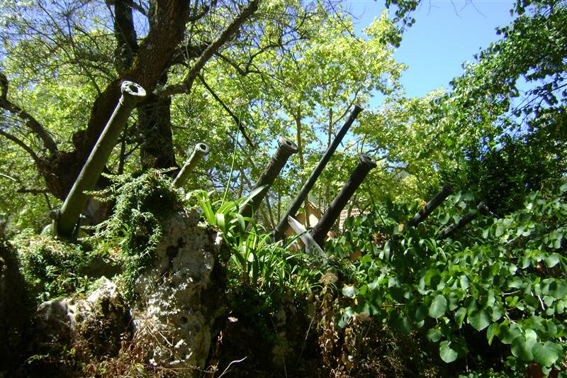

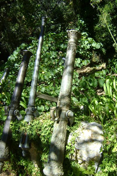

The information provided was a transcription of a paper passed by Luso-German collector and arms historian Rainer Daehnhardt, who intended to divulge it among his Association fellow members and other acquaintances. In fact, during my visit to his premises near Lisbon a couple months ago, i had visual contact with this and other numerous cannons, that he displays in his estate gardens.
I understand that what he means by Oriental Indias is, for one, Indonesia, assuming that when he quotes the copy of these cannons by local 'mobile' smiths who worked under commission he names places like Jawa, Sumatra and Malaca.
I take it that he recognizes the origin of this (his) piece as 'provenly' from such provenance due to his experience with handling several of these things and not exactly because of this possible breech insignias.
Worthy of note is his quoting in this (sort of) publication that he once had the task to classify the Sultan of Brunai's cannons collection. Out of 900 tubes in bronze, from which a half dozen were breech loaders, only thirty were fire weapons ... the rest having been cast for purposes of money currency; they would burst if fired.
The Thunder Mug serving as a stand is, because he has quite a few around, he might find this one useful for these purposes ( i have a few, myself ).

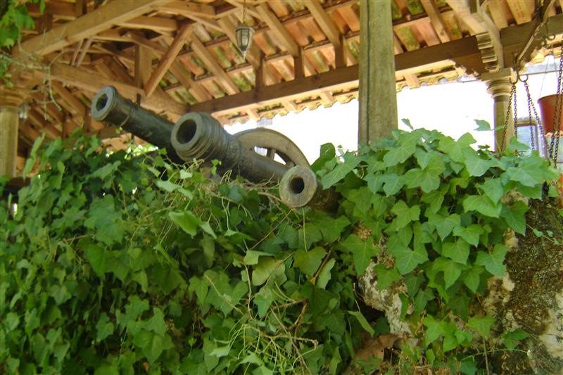

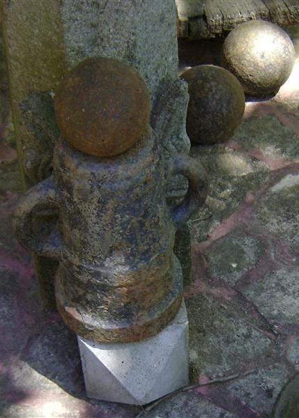

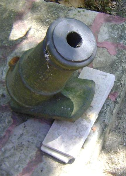

I hope he doesn't mind that i post here some of the stuff he has in the gardens.
