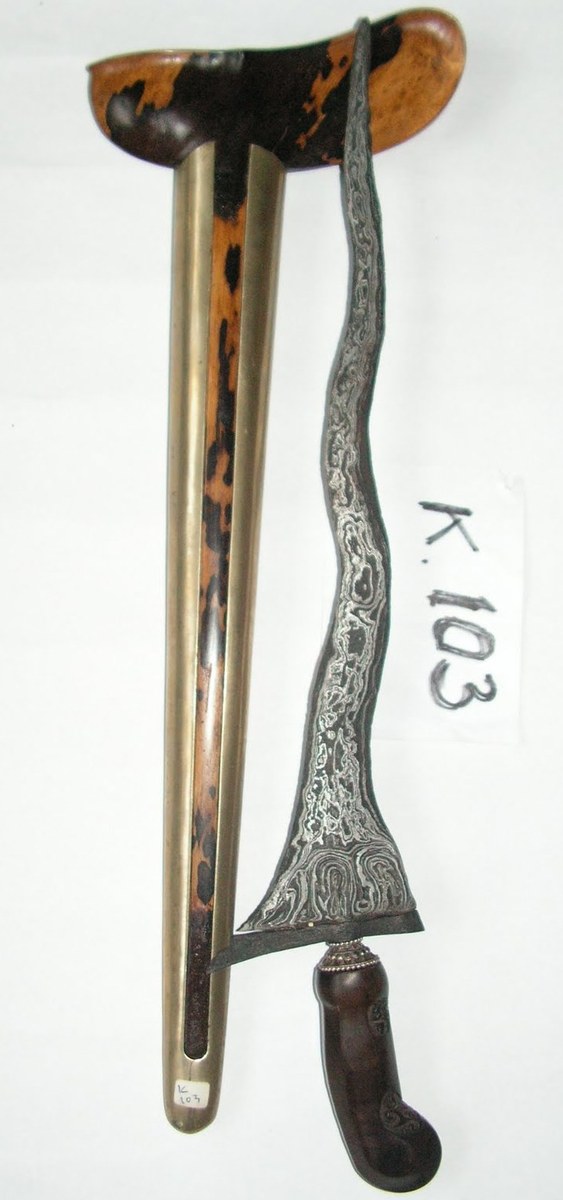

I've got a pendok that is on an old Solo keris that is made from a metal that is the colour of copper, but it has never tarnished like copper. It is definitely not suasa, I have no idea what it is. I've had it about 45 years.
The keris that goes with this keris has some kinatah work that I thought was brass when I bought it, but it also never tarnished, and is not gold.

The pendok looks like copper, but has never tarnished like copper; it has not maintained a bright, polished finish, but the build up of tarnish that we commonly find on copper that has never been polished over an extended period of time is missing.
The kinatah on the blade has a brassy look to it, but again, no cleaning for the time I've had it, just an occasional oiling, and no tarnish. I've had keris with brass kinatah, and in my experience the kinatah has tarnished pretty quickly.
I find this puzzling, but it is fact. Don't ask me to explain it, I cannot, I'm simply reporting it.

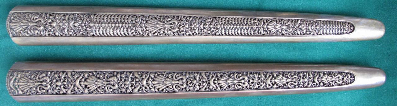

I think that the alloy described by Pusaka could be gongso, I saw some very nice pendoks made from this materials but don't own any in my collection. I have some old "singing" bowls and confirm that they did not tarnish at all since 20 years, I can send some pictures if you are interested.

Sorry, I forgot this kris (1.4.4) which has a pendok made from gongso I think (looks like gold, very thick, does not tarnish).
And the pendok of kris 1.4.13 is made from a copper alloy which does not tarnish much as described by Alan.

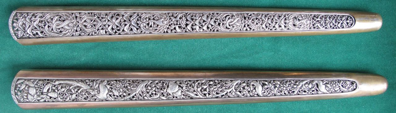

Old 10th November 2011, 10:24 AM   #18
Jean
Join Date: Jun 2009
Posts: 1,740
Originally Posted by rasjid

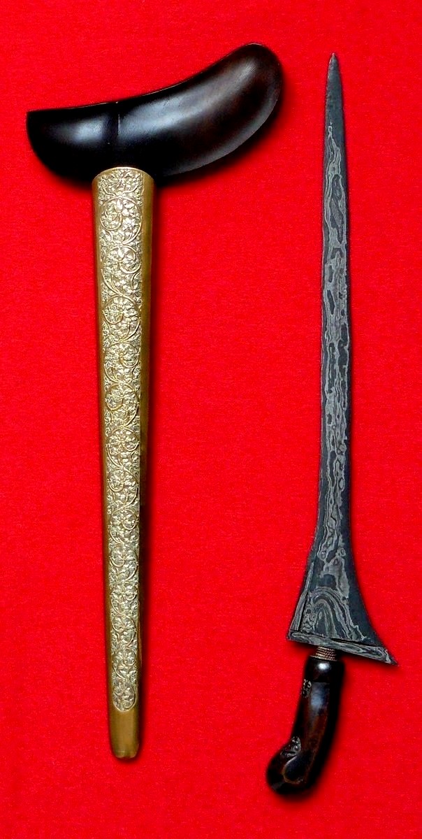

Since last year, in jawa tengah we have a lot of pendok gongso for sale. Most of them is jogja style with silver plate in the middle. The price is quite dear due to gold content (very little) and hard to make, unlike silver easier to work on. Rasjid
Attached are examples of such gongso pendoks with silver slorok.
Best regards
