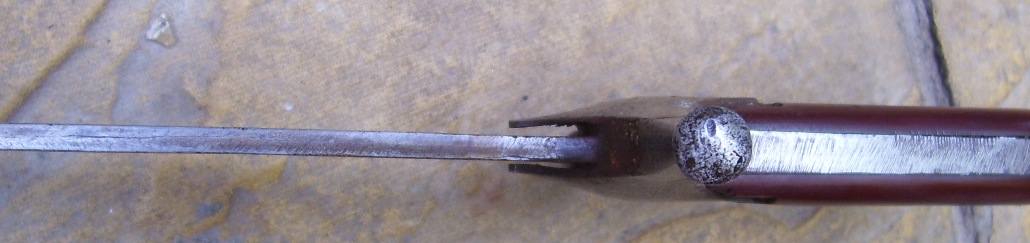

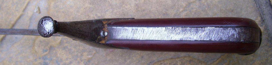

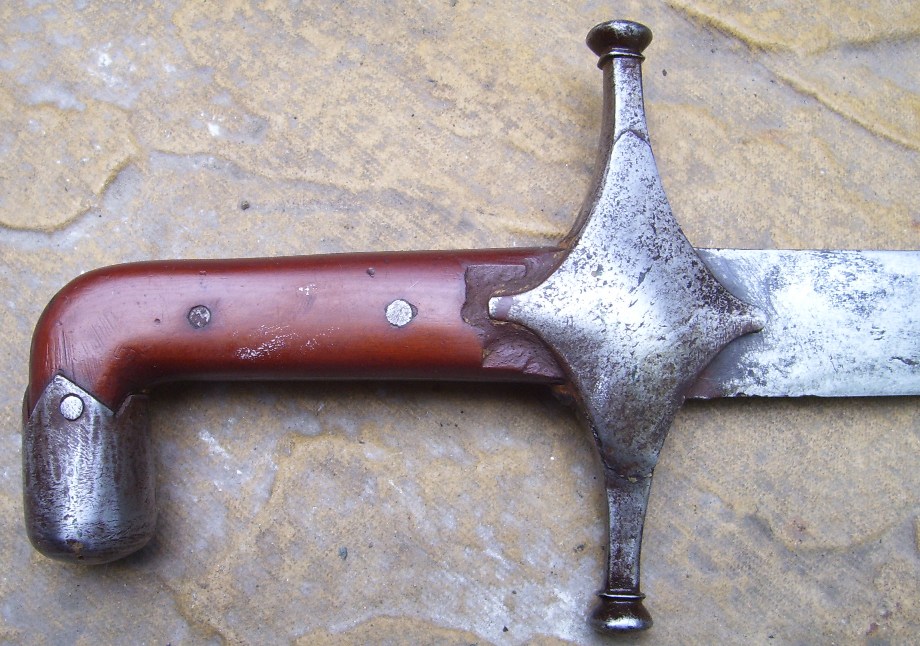

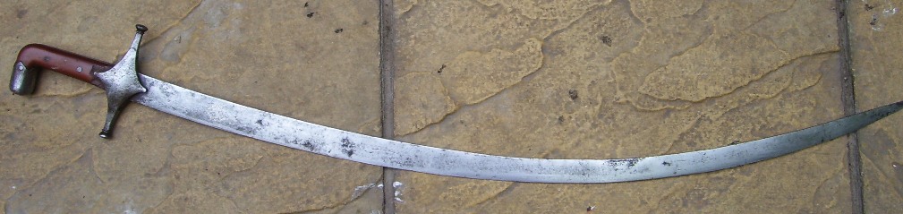

Shamshir, no scabbard. Hilt slabs are made from a resin type substance....has anyone seen anything like it....and know what it is.

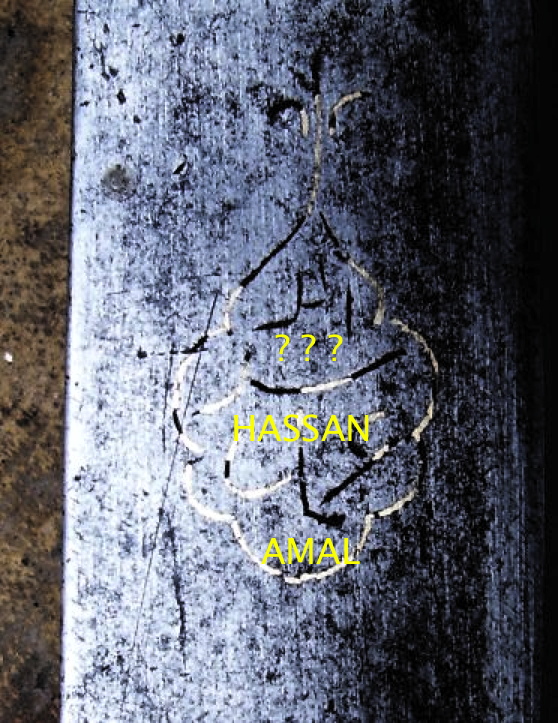

Gold inlaid cartouche with a lot of losses. Arabic script on the opposite side. Forged with some small 'cold shuts'.
Comments and a translation would, again be, much appreciated, thank you

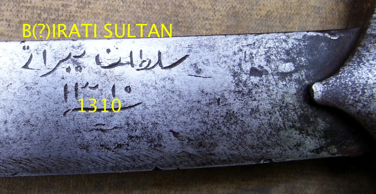

You've seen the date on the blade of this one I guess?
1315 would be 1897/8.

still haven't worked out what material the hilt slabs are ? I know a number of Jambiya / Khanjar hilts have resin handles that simulated Rhino.....so perhaps this is the same idea.

Well the 1897 date and the bakelite type hilt are consistent I had a French saber from the same period with a resin/Bakelite hilt.

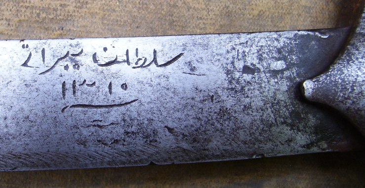

Hi Dav
the cartouche;

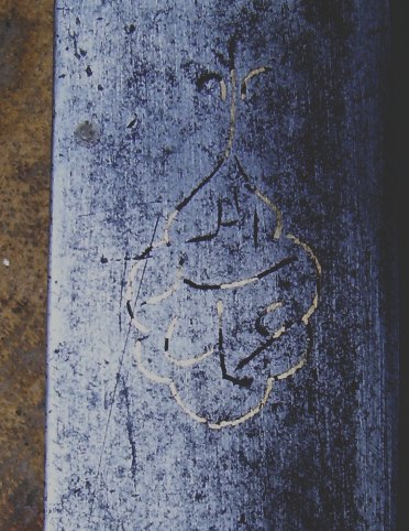

- AMAL HASSAN ??? either MADE BY HASSAN, for the upper line we have a problem,
by extrapolation, due to some erase, we should read "HOM" what is non sense, coze the translation could be;
- MADE BY THE MOTHER OF HASSAN ...
very hard to imagine a woman blacksmith, in Muslim country
very sorry for "Atlantia", but despite his efforts to translate the date,
we guess that it's 1310 (or 1892 Gregorian) and not 1315
I agree that it's look like a circle, but really too small to be read by Arab natives, as digit 5
SULTAN BIRATI ... the name it's not Arab, could be Perse, or even Indian ...
"Birati" it's a locality in the city of Kolkata (formerly known as Calcuttā) West Bengal, India
all the best
à +
Dom

Hello guys, beautiful shamshir David! Congrats. As for the material of the hilt, such type of material such as bakelite was probably liked back then. They are still used but for prayer beads, one of mine which I use for formal dressing is infact a bakelite (called bokolite/sandaloos here)
Sheikh Dom got the date and name correctly, but the cartouche says "amal Assad Allah" which ofcourse means: Work of Assad Allah

If you want to check if the hilt IS Bakelite, run it under hot water and it will give off a noticable smell characteristic of all Bakelite.

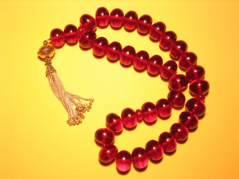

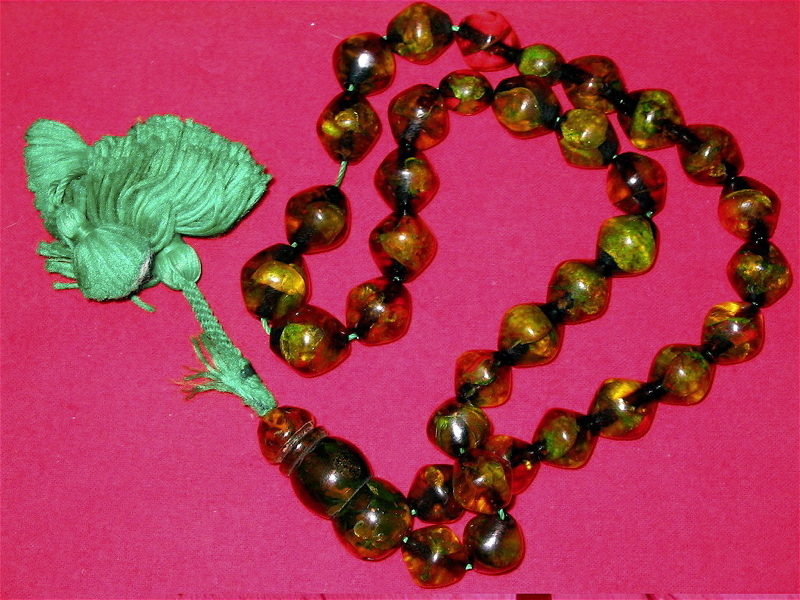

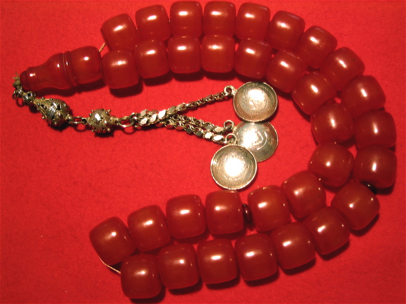

...snip.. bakelite ...snip... They are still used but for prayer beads, one of mine which I use for formal dressing is infact a bakelite (called bokolite/sandaloos here)
correct, those material for prayer beads it's know under the name of
- karaman (Turkish city, where it's come from this type of "false amber")
- faturan (http://en.wikipedia.org/wiki/Faturan)
most of the time, some pics are better than a long speech, to understand
- the 1st picture, is real amber
- the 2nd, it's "kahaman" mixture of resin and amber powder
- the 3rd, it's "faturan" .. synthetic resins, let said "Bakelite"
they are part of my collection (an other) of "subha"
à +
Dom
ps/ those Islamic chaplet are from last century ±*150 years

Hi Dom,
thank you very much for the translation I believe that the sword came from the Iraq /Iran area, I will try and see if Sultan Birati has any association with this region. If not, you've been very helpful with the India connection

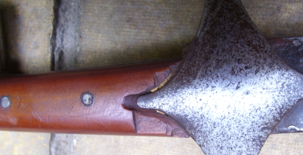

Note how the grips go into the guard and under the lagnets, unlike with shamshir #2
Note how the guard is assembled by hammer welds.
What is the feature that in the sixth photo looks like a modern weld spot at the juncture of guard and handle at the front edge?
Hi Hawkeye ,
yes seems to be a 'modern spot weld' but why its there ???
it serves no function
Kind Regards David
Old 10th July 2011, 11:24 AM   #17
tom hyle
Location: Houston, TX, USA
Posts: 1,254
Is there a tang band? (an applied strip of metal affixed perpendicular to the edge of the tang to yeild an "I beam" type construction) I think it may tack down the end of the tang band. Very risky for the strength of the blade, welding without retempering.
