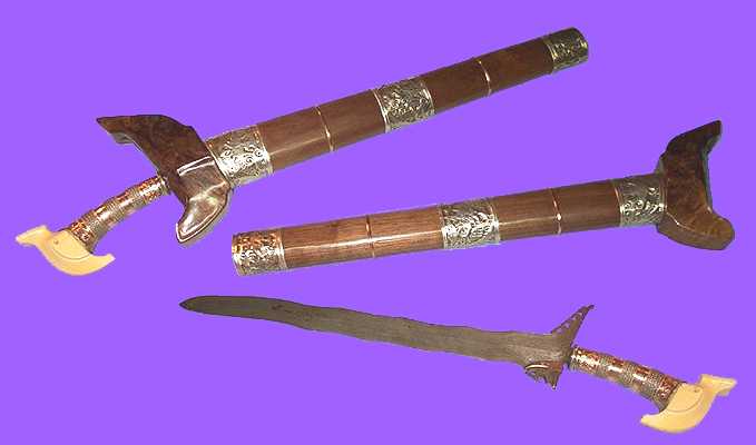

Hello forumites,
Does anybody know th eprecentages of copper and gold in Suasa ?
is their a recepy, or was it up to the goldsmith to decide ?
Maybe also a nice thread to put some puctures of Suasa adorned weapons ?
Here is one from my collection.

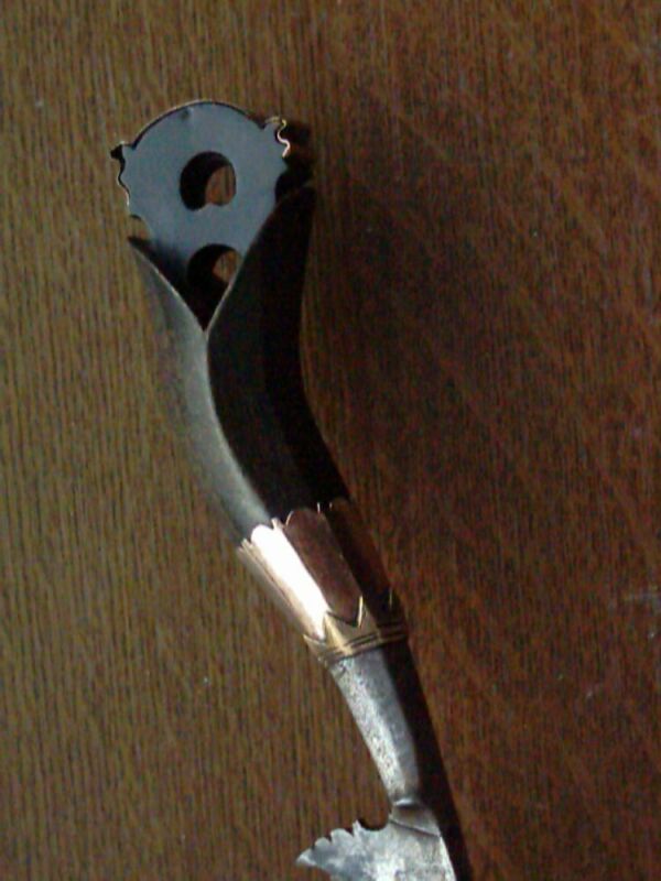

Posts: 2,238
and one more picture.

Acutally it depends on the color wanted. VVV is correct for some swassa, others are different depending on if you want orange, red, white'ish, etc. When a friend and I made swassa several years ago, it was roughly 1/3 gold and 2/3 copper with some silver. Some even use zinc for a greenish color, though rare.
Here is an example of what I mean. The orange bands on the hilt are swassa and the orange bands on the scabbard are the ones we made. I did the rest of the scabbard work (the second one I ever made).

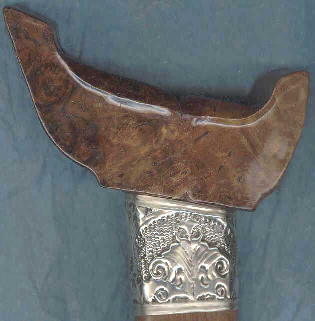

Posts: 7,417
Thank you.
This is the only other close up I have. It is of the top wranga that I made of burled wood and silver. I made it Maguindanao to match the same type piece and the silver work was inspired by what was already on the swassa hilt bands (to match them in motif).
Enjoy

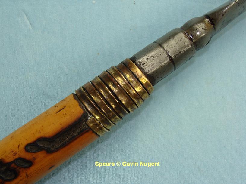

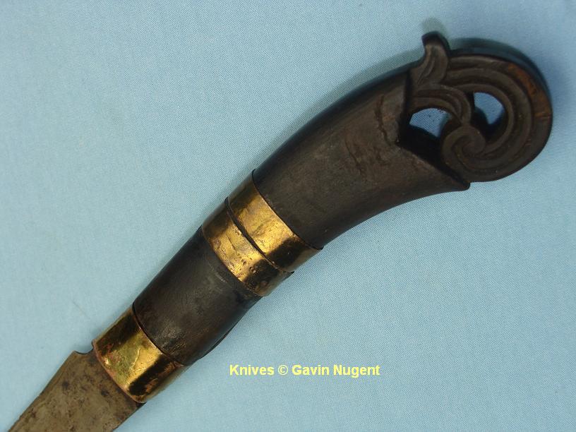

Old 25th May 2011, 08:14 AM   #15
Gavin Nugent

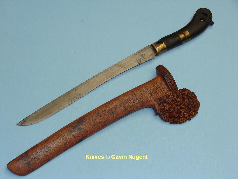

Gavin Nugent's Avatar
Default another
Another example as requested.
Gav
Old 25th May 2011, 08:55 AM   #16
Hello Gavin,
your example would have been referred to as gold, even if it were a fairly low carat alloy. Suasa is supposed to have that copper hue but contain enough gold to avoid getting patinated when handled regularly. Basically, any yellow gold alloy (including "pure" gold) would be considered gold while red gold would be suasa (often at the low end of the carat scale).
Old 25th May 2011, 09:24 AM   #17
Gavin Nugent
Originally Posted by kai
Hello Gavin,
Thanks Kai,
Although there is not the desirable hue as you note, the bottom image, there are 'rusty' copper 'flecks' seen in the image and found on ...what accounts for this? It is found on the bands too...just not enough melting of the alloys together?
This spear also has the same compound by the eye and it is think banding...the copper is in there...so is the gold.....
Gav
Old 25th May 2011, 09:35 AM   #18
Hello Gavin,
Probably impossible to ascertain from pics of your peurawot. More often than not, this is a sign of gilt construction (on copper or brass) with copper leaching out through imperfections/wear. Maybe you can find any hints under magnification?
The spear looks very much like having gilt bands. In this case the gold seems to be very thin and may have been applied from very thin sheet gold.
Old 25th May 2011, 10:41 AM   #19
Gavin Nugent
Hello Gavin,
Makes perfect sense. Gilding is not often spoken of from the region.

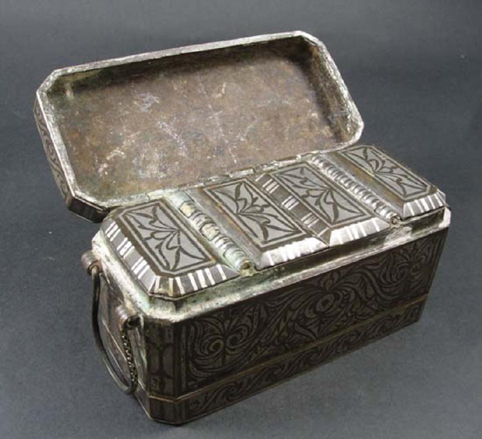

Here is a gilt silver over brass Sumatran box I have.
Thanks
Gav
