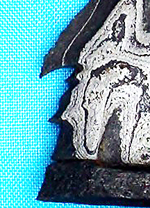

semar
semar's Avatar
Join Date: Jul 2007
Posts: 272
Default close up picteur
I have made a new picteur I think that it is easyer to say what the dapur is
regards semar
semar is offline   Reply With Quote
Old 14th May 2011, 08:18 AM   #15
Posts: 7,134
In the crop of the gandhik, who can identify the features that we can see?
In the crop of the greneng does everything look as we would expect it to?
A. G. Maisey is online now   Reply With Quote
Old 14th May 2011, 02:17 PM   #16
Greybeard
Greybeard's Avatar
Join Date: May 2009
Location: Switzerland
Posts: 124
Here's my uninformed opinion: I see 1 jalen, 1 lambe gajah (placed a bit high!). Regarding the greneng, I would expect to see Ron dha, but cannot find it here (might be worn down, of course).
Greybeard is offline   Reply With Quote
Old 14th May 2011, 03:10 PM   #17
Posts: 7,134
Yes, I think that is also what I can see.
But I cannot reconstruct the greneng to any correct form, additionally the gonjo appears to be of different material to the material in the blade, so it is probably a replacement done by somebody who did not understand what the greneng should look like.
It is not at all unusual for a worn old keris to have a replacement gonjo, in fact, it is common, but often these replacements have been done by owners or people who are not really trained in keris maintenance, and when that happens it can make a keris more than a little bit difficult to read. One of the reasons why 100% original old keris, even if in a worn condition, can be quite valuable.
