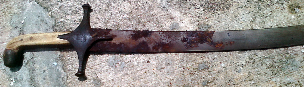

Hi Guys,
I have no idea of how to proceed. I usually advise others with similar problems to dip the whole thingamagig in a tube filled with cheap olive oil, and let it soak for a couple weeks. OTOH, this a (reported) 17th C weapon, and I'd like to know if there's something better that can be done.
This shamshir is heavily rusted within its scabbard, and the latter is also in poor shape. Seems it was found in a tomb somewhere. I'm leery of destroying it's green-blue lether scabbard, in the process of retrieving the blade.
OTOH, perhaps it can not be helped?

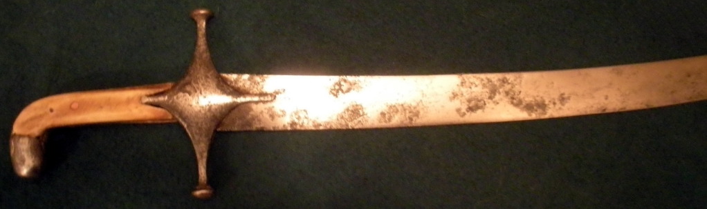

Please grace us all with a couple of images of the sword as it currently stands, it would be very interesting to note how it sat in a tomb.

Sure thing, click on the thumbs for a larger image

Thanks for the images Celtan
You have a job and a half ahead of you there. IMHO do not concern yourself too much with the scabbard, you have the sword as your objective and you have scabbard fittings too so modern marvels can be achieved.
Me, I'd be tempted to drill a few very small holes discreetly along the seam on the underside of the scabbard and use a fine dropper to fill with oil. There are bound to be places along the seam, that when pressed with your thumb will have points of give in them, this would be where I would start.
I'd be interest to see what others have to say and I certainly wish to see the sword once removed.

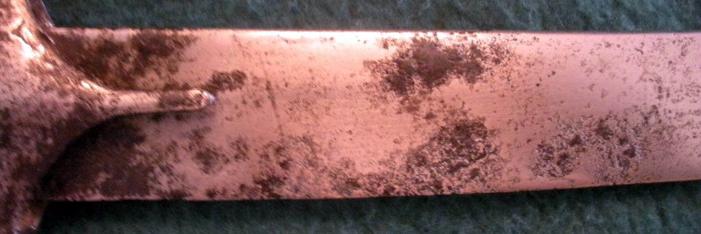

Used the mineral oil through breaks in the scabbard, let it soak for a couple hours, applied some judicious tapping to the crossguard, and voila!
Now, the condition of the blade as it is is troubling. The rust has grown to a concrescence in certain areas, as you can see. I was wondering how to deal with it. I have never had to work on such heavy rust. Naval Jelly? A Dremel Drill? Seems like an obscene fungus growth.
Any suggestions?

Old 12th September 2010, 08:15 PM   #11
Posts: 6,414
Rennaisance makes a very good de-corroder; this will work well in the pitted areas after the rust has been removed .
PM if you need a source .
Soaking in acid fruit juice, Pineapple; would remove most of the crud from the blade .
Coca Cola is a great rust remover .
The handle is a problem unto itself .
Maybe the Rennaisance de-corroder would be a good choice for the rust on the hilt .

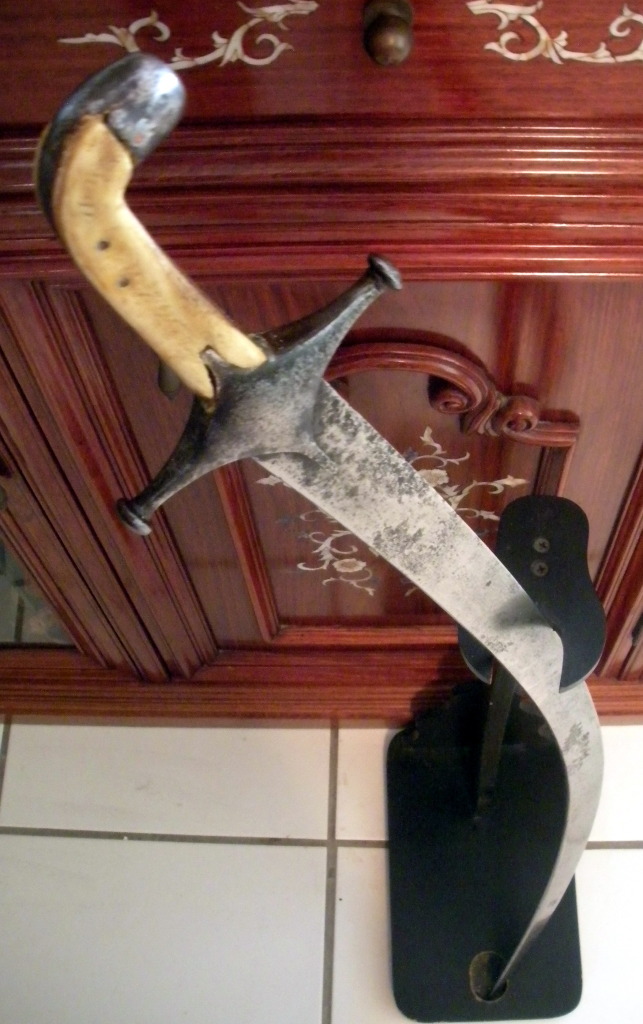

Just a FU note:
Found a good storage media for the soaking: A pool skimmer's tube. Cut it to the right size, it bends according to the blade's curvature, and displaces less volume, so I will need less pineapple juice. Lets see how this develops.
I will use the decorroder on the hilt, and scabbard fittings.

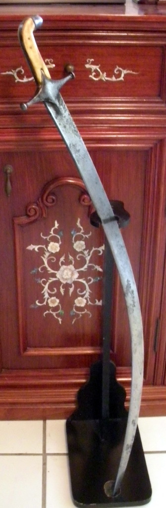

Began the cleaning. Added the Pineapple juice yesterday. Tube seems to hold the juice sans leaking. So far, so good!

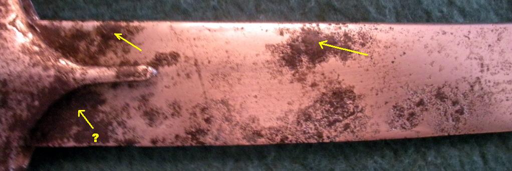

M
Sorry Manuel I missed your post ,....the million dollar question, each individual has he or she's 'limit'. I treat each sword differently ....some I feel are better with more cleaning, others less. I always err to 'less' to preserve it's history. Personally I think the dark patches of what appears to be raised (above the general surface) 'scaly' patches should be removed.....generally these raised areas (if indeed yours are?) tend to have active rust within them, similar to a 'blister'.(actually the steel seems to delaminate with rust between each layer)
To remove them I very gently scrape them with a small sharp blade, I know many would make a face like this ....but I find it a good way to remove these areas without unnecessary sanding of the blade surface surrounding these 'blisters'.
All the best
All the best
Salaams, Nice job so far though I dont know why this thread has apparently stalled... My advice is drop the blade into coke for a day or two... and second but more agressive is to use lemon salt... To remove rust patches and spots seen on your last photo use aluminium foil ... use as you would use sandpaper but with aluminium foil you are at the finest level of abrasion ... in fact it isn't abrasion ... more like molecular technology involving ions or somesuch molecular majic... it is superb for rubbing out rust spots but it takes a lot of numb finger rubbing.. Aluminium foil !!! Marvellous !
