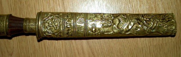

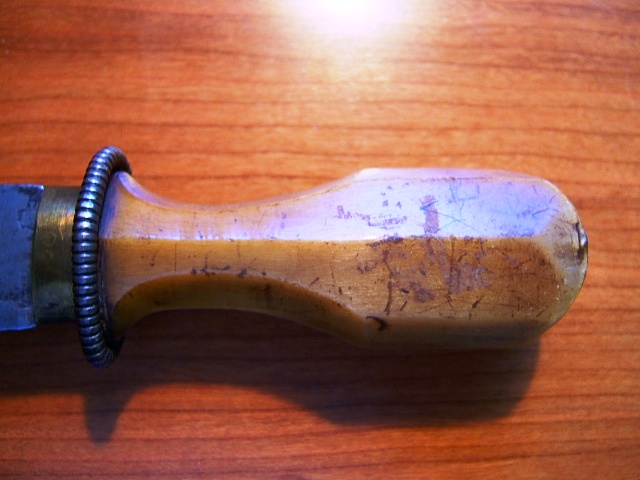

Default Chinese dagger for comment

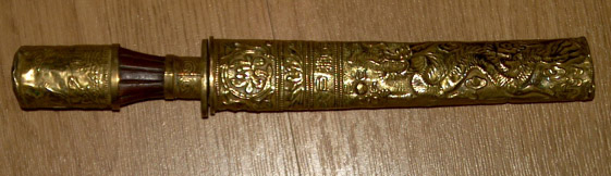

It is probably nothing and the characters will say "made in China" but I picked this one up with some other real nice things.
Just wanted to be sure because the chinese stuff isn't my field.
A translation of the characters on the scabbard as well on the knife would be nice. But I'm sure it will be made in China
Old 17th July 2007, 09:23 PM   #2
Lew
Lew's Avatar
Location: East Coast USA
Posts: 3,191
Henk
It looks like a Chinese repro of a Tibet dagger.
Lew
Old 18th July 2007, 01:21 AM   #3
Posts: 7,415
Yeah I am afraid I agree - never seen Tibetan pieces have chinese characters on the blades and the style of work does not appear Tibetan to me.
Old 18th July 2007, 09:34 AM   #4
Henk
Henk's Avatar
Posts: 1,209
Lew, Battara,

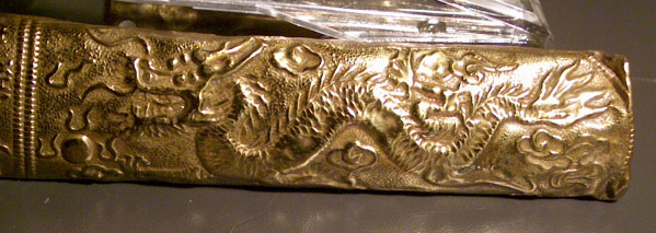

Thanks for your answer. A repro of a tibetan dagger. Don't know why your answer doesn't surprise me. I don't know why, but with chinese stuff i always get an itchy feeling.
What does it make you think it should represent a tibetan dagger? Is it the horned dragon on the scabbard or the complete style of this thing?
Old 18th July 2007, 09:47 AM   #5
Bill M
Bill M's Avatar
Location: USA Georgia
Posts: 1,599
The overall design looks Tibetan.
This is an everyday herdsman's kinfe.
Old 18th July 2007, 05:31 PM   #6
Posts: 7,415
I'm with Bill, the overall style is Tibetan/Bhutanese, althought the style of the mounts are not and the design features are a little off to be authentic for me.

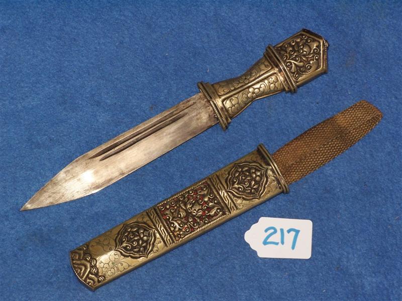

Old 18th July 2007, 05:37 PM   #7
josh stout
Join Date: Mar 2007
Posts: 407
The blade seems a bit rough and not well finished, and the fullers are also shallow and not well made. I have a dagger made around 1990 for everyday use from the Tibetan/Chinese border region and it is quite different. The scabbard is plain brass with no designs, while the blade is thick and solid and well made with deeply cut fullers. The tang runs through the solid metal handle and is peened at the end. The point is also much less hurried looking. Even in the early 90s when there were no Westerners traveling in the area and not even that many Han Chinese, there were many knives in the market that looked like this (according to hearsay). They were not exactly tourist pieces, but perhaps more for status and show than use. Now of course eBay is flooded with such stuff.
Can anyone comment on the pommel style of this blade? It looks like a copy of Bhutanese styles to me.

Old 18th July 2007, 06:13 PM   #8
Bill M
Bill M's Avatar
Posts: 1,599
Hi Josh,
I got this from LionsGate at the Baltimore Arms Show. He said it was Bhutanese. Can you tell us the differences in Bhutanese and Tibetan?
Thanks, Bill
Old 18th July 2007, 06:25 PM   #9
Lew
Lew's Avatar
Posts: 3,191
Originally Posted by Bill Marsh
Hi Josh,
Thanks, Bill
Bill
Tibet borders on Bhutan to the north east and north west so the lines start to get a little blurred when looking at these types of daggers.
Lew
Old 18th July 2007, 06:27 PM   #10
Henk
Henk's Avatar
Posts: 1,209
Bill,
That are some nice and better examples.
Josh,
The one I picked up didn't come from ebay. But that statement means nothing at all.
The tang of the knife runs trough the handle and is also peened at the end. The blade is thick and sturdy and still rather sharp. I can see traces of sharpening at the edge and the edge has some blunts as it was used to cut something with it.

Old 19th July 2007, 04:56 PM   #13
josh stout
Join Date: Mar 2007
Posts: 407
Well that last dagger has several elements that identify it as Bhutanese. The pommel is absolutely typical, and the blade looks like the hairpin folding has been highlighted with narrow shallow grooves which are also associated with Bhutanese styles. A classical Tibetan dagger would have the trefoil pommel, and very distinct dark and light lines of hairpin folding without grooves. That said, there are many mixtures of the two styles, and within the region of Tibetan influence there are many pommel styles beyond the trefoil. In "Warriors of the Himalayas" there are Tibetan swords with grooves cut in the blade, though they still look a bit fatter than most Bhutanese styles. Also in Phuntsho Rapten's "Patag-the symbol of heroes" there are several different styles of blades, ranging from those with no grooves to wide grooves to narrow grooves. In addition, Rapten mentions a trade with Tibet in Bhutanese pommels (price=one mule). Undoubtedly blades were also traded back and forth.
So while there are many areas of uncertainty, the last dagger has purely Bhutanese elements in a cohesive unit that is easily recognizable as Bhutanese. I would say the same about many Tibetan daggers.
About the first two daggers posted: I tried to convey the sense that while the fittings look like more energy was put into them than the blade, I would not at all assume they were meant for tourists or were never used. The first one shows quite a mixture of styles with a vaguely Bhutanese looking pommel, Chinese characters, and Tibetan brass work. The fullers have decorative lines at the ends similar to the "Unusual Tibetan saber" I recently posted. That saber also shows several influences. The brass work on the second dagger is better than the first, with a pommel that is even further evolved from a classic Bhutanese look. But once again, it looks like less time was spent on the blade than the fittings. This does not mean it could not have been used, just that use was secondary to show.
In the last dagger from Bhutan, is the tang peened at the pommel? It is something I have wondered about, and it does not show up in the usual pictures.
Josh

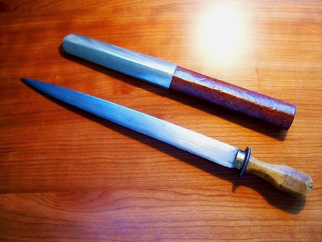

Old 27th July 2007, 08:13 PM   #14
josh stout
Join Date: Mar 2007
Posts: 407
Here is an example of a "Bhutanese" dagger with a more debatable origin. It shows the Bhutanese style handle, but in a form more similar to ones such as the first two posted. I wonder if it is not a Tibetan copy of a Bhutanese dagger.
http://www.sevenstarstrading.com/swords/?subpage=1414
Josh

Old 28th July 2007, 06:02 AM   #16
Lew
Lew's Avatar
Posts: 3,191

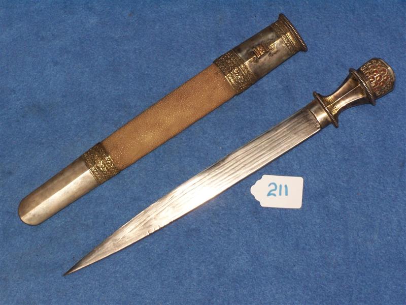

Here is a nice example from my collection the hilt is made from local mountain sheep horn.
Lew
Old 30th July 2007, 04:41 PM   #17
josh stout
Join Date: Mar 2007
Posts: 407
That one is just lovely. Where would you say it is from?
Josh
Old 30th July 2007, 06:25 PM   #18
Lew
Lew's Avatar
Posts: 3,191
Josh
It's from Bhutan.
Lew

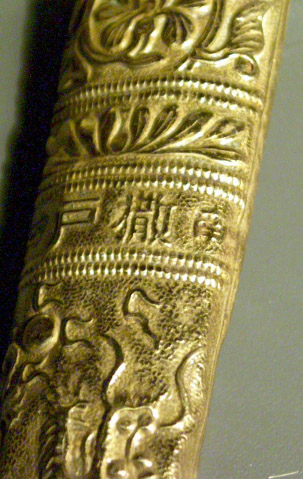

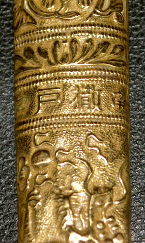

Old 31st July 2007, 10:35 AM   #19
yuanzhumin
yuanzhumin's Avatar
Join Date: Sep 2005
Location: Ex-Taipei, Taiwan, now in Shanghai, China
Posts: 180
Default It's a Chinese dagger, from Yunnan
Hello

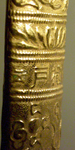

Henk, your dagger is from China, because it is written on it, unless "yunnan" is not anymore a province of China ;-)
In fact, there are 4 caracters on you scabbard
yun hu sa nan (in this order)
The first and the last have to be read together as the size of their font show they are linked. In fact, they are smaller and from left to right, they mean simply "Yunnan", the province of China. At least, you know for sure the origin of this dagger.
The second and the third caracter, hum... It's something else.
"Hu" means family, house, clan
"sa" means to let go, to abandon, to escape
So there is many ways to understand it, but I see two very different. What is strange is that these two caracters are read from right to left to have the meaning I see. In the other way, from left to right, they remain a mystery.
First explanation, it's the name of a clan : the clan Sa.
Second explanation, there is a very rare Chinese proverb in four caracters that say : Use extreme means so that there is no way to escape (sa chueh hu wang)
The Chinese always reducing the four caracters sentences to two, the proverb in this way would become 'sa hu', exactly what is written on the scabbard. The precise translation in our case, adapted to the knife :
(This knife or the holder of this knife) use extreme means without anyway (for the prey or the opponent) to escape.

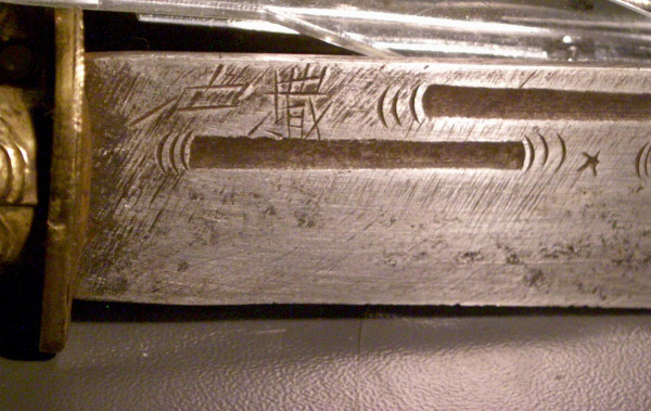

On the blade are carved exactly the two same caracters, linking the blade to the scabbard and emphasing on the fact that this blade leaves no way to escape for the one that is targeted.
Sorry, it seems a little esoteric, but I can't tell you more. At least, Henk, you know that your dagger is from Yunnan, China.
Nicolas

Old 31st July 2007, 02:58 PM   #20
Henk
Henk's Avatar
Posts: 1,209
Hello Nicolas,
Thank you so much for your translation. Indeed now I know the dagger is from Yunnan, China.
Two ways to understand the writing on the scabbard and dagger.
First one, it could be a dagger from the family or clan Sa, Yunnan or made in Yunnan.
Second one, the dagger is made in Yunnan and has both on blade and scabbard the saying, this blade leaves no way to escape for the one that is targeted.
Maybe it is a little bit esoteric, but I like it. It certainly gives another dimension to this dagger for me personally.
Thanks again, Nicolas
Old 31st July 2007, 06:15 PM   #21
josh stout
Join Date: Mar 2007
Posts: 407
Originally Posted by LOUIEBLADES
It's from Bhutan.
Lew
Thanks, the handle certainly has the Bhutanese shape, but as has been shown, some Tibetan daggers seem to have the same shape. What are the materials?
There does not seem to be anything about the blade itself that would be definitive either way that I can see. The elegant undecorated scabbard looks like what I have read about Bhatanese scabbards, but this example is the first I have seen of this particular type.
Thanks,
Josh

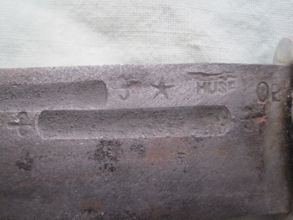

Old 2nd January 2011, 11:46 AM   #22
viracocha
Join Date: Dec 2010
Posts: 1
Default Husa Knife

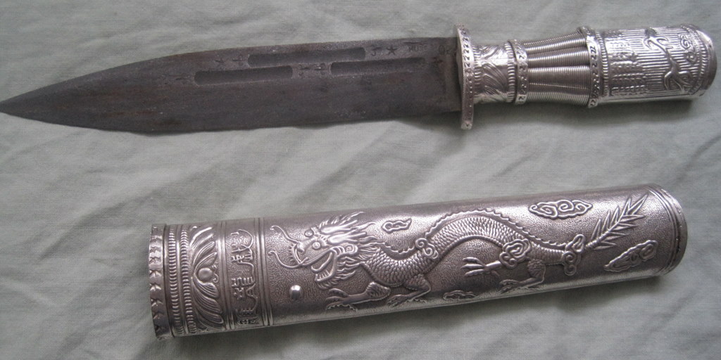

Hi i the first knife must be an Achang knife which is also known as Husa knife Husa and Lasa areas of Longchuan County province of China . This sort of knife is well-forged and elaborately made, and very sharp, tensile, durable Sheaths made of wood, leather and silver i got one of those in silver with rusty blade but still sharp
viracocha is offline   Reply With Quote
