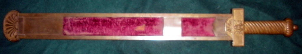

Here's a link, with an album full of pictures of the Gladius sword I have been researching.
http://s353.photobucket.com/albums/r...e%20Militaire/
I have seen several _similar_ swords but only one or two identical. Either the crossguard shape, the langets, or the blade itself differ.
Someone suggested it might be a ceremonial sword created on the 100th anniversary of the French Revolution. The sword was reportedly found in a Vichy French military school in the city of Aix, and was reportedly labeled as an "epee de cadet a la Ecole de Mars".
I have found nothing definitive on its origins.
Best regards
Manuel

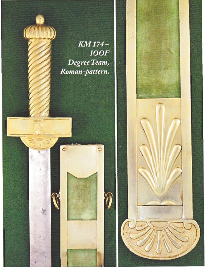

Thank you for the illustrations, that sure makes this more conclusive. As I indicated in my previous post, the Independant Order of Odd Fellows (IOOF) regalia swords are shown in the book I listed, and while I dont have the 1882 Ames catalog, the example shown in the book is a spot on match with yours.
It is shown in the reference as KM174 (p.76) and is the prescribed sword for a member of the IOOF Degree team, and as noted, of 'Roman Pattern'.
When I first saw the pictures you posted I recalled having seen this unusual kind of sword in Blair ("European and American Arms" , 1962). Checking that book I found that a similar type sword (p.103, 'J') was issued to cadets at the Ecole de Mars, a Revolutionary military academy which existed for only one year in France (1794-95). Apparantly the sword was designed by French artist JacquesLouis David (1748-1825).
In looking online to learn more on the Ecole de Mars, I discovered the similar type sword, but not a match to either this clear IOOF pattern, nor the original example from France in 1794, on an identification site copyrighted by a C. Allan Russell, which also reflected the data I have shown above. He also mentions the IOOF possibility, but was unclear on its veracity. Russell notes also the "Swords and Hilt Weapons" (Coe) reference showing one of these type swords.
The Freemasons and other Fraternal Brotherhoods of course incorporate a great deal of neoclassic symbolism in thier regalia, so these swords and much of the motif of course lean toward these Roman patterns often seen in the times of the French Revolution. On the original Ecole de Mars sword there is a device showing the 'Phrygian hat' which was used considerably during the Revolution. This design is also used stylistically on the French military sabres and subsequently US military sabres (the pommel is termed the Phrygian hat).
The original Ecole de Mars sword has also strange downward quillons and a rudimentary upturned open knuckleguard. The pommels on these other examples were smooth rather than fluted, and the grips scaled rather than spirally gadrooned.
Thanks for the opportunity to identify this Manolo! While seemingly a distinctly established pattern, these must be relatively uncommon. The IOOF was founded in England in 1745, with the first American lodge in Baltimore in 1819. The organization became independant of the original British branch in 1843. It was a benevolent organization and it would seem that further research would reveal the various lodges and membership numbers etc.
The color in the scabbard insert seems to be pertinant also as these it seems relate to status or rank.
All the best,

Could I trouble you for a scan of the image found in "The American Fraternal Sword" (Hamilton, Marino and Kaplan) KM174 (p.76)..?

Here it is Manolo!! Please note, if it is in the Ames 1882 catalog, the #352 must be the wrong designator as that number is outside the groupings listed.
