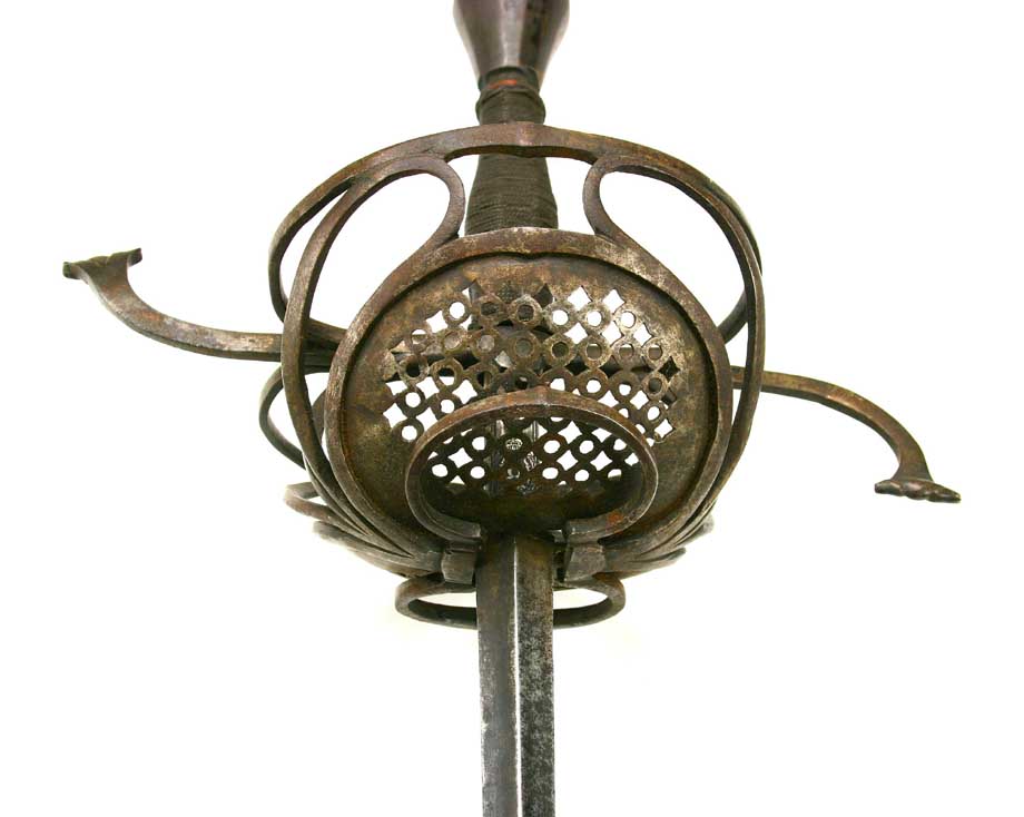

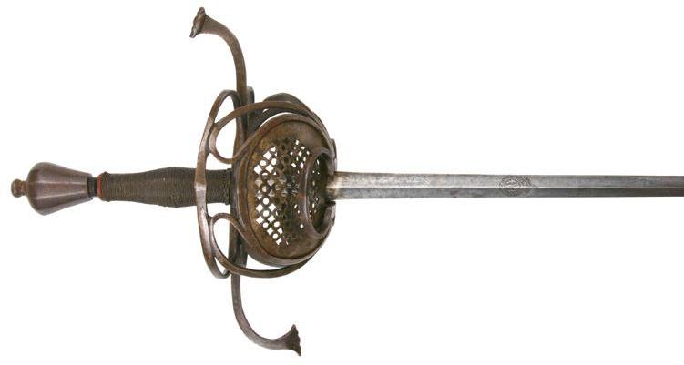

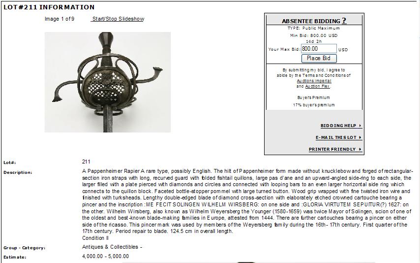

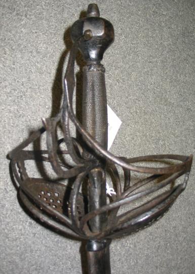

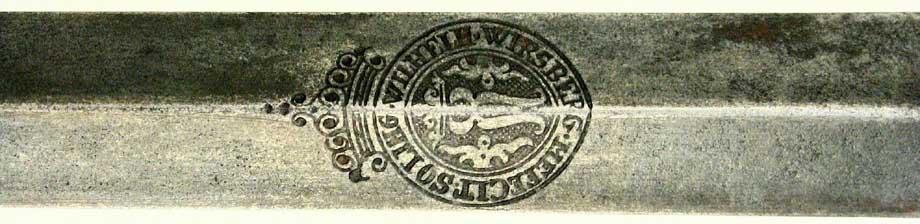

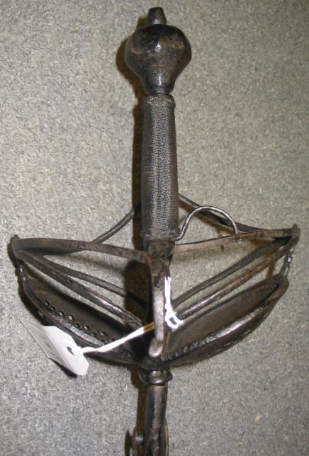

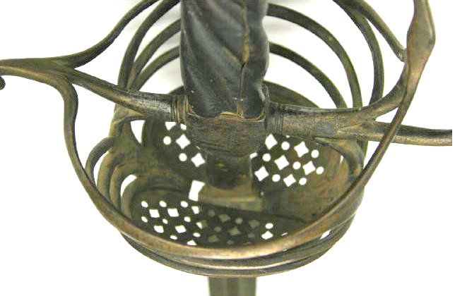

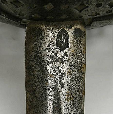

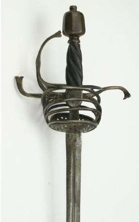

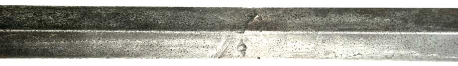

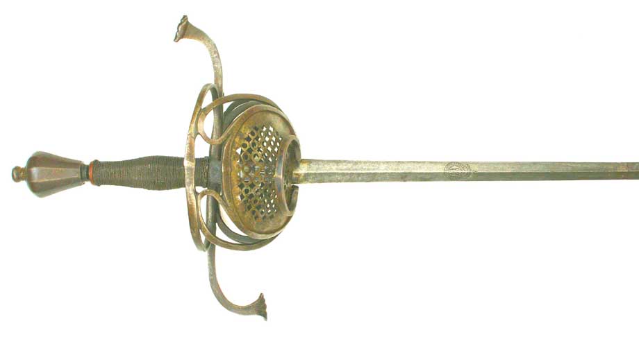

This one was sold at Auctions Imperial one year ago. Although it was described as 'English' it was actually a German piece, the blade dated 1627. The only trouble was that the blade seemed to have been repaired in its working time.
The blade was inscribed by its maker:
ME FECIT SOLINGEN WILHELM WIRSBERG.

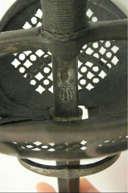

The rest.

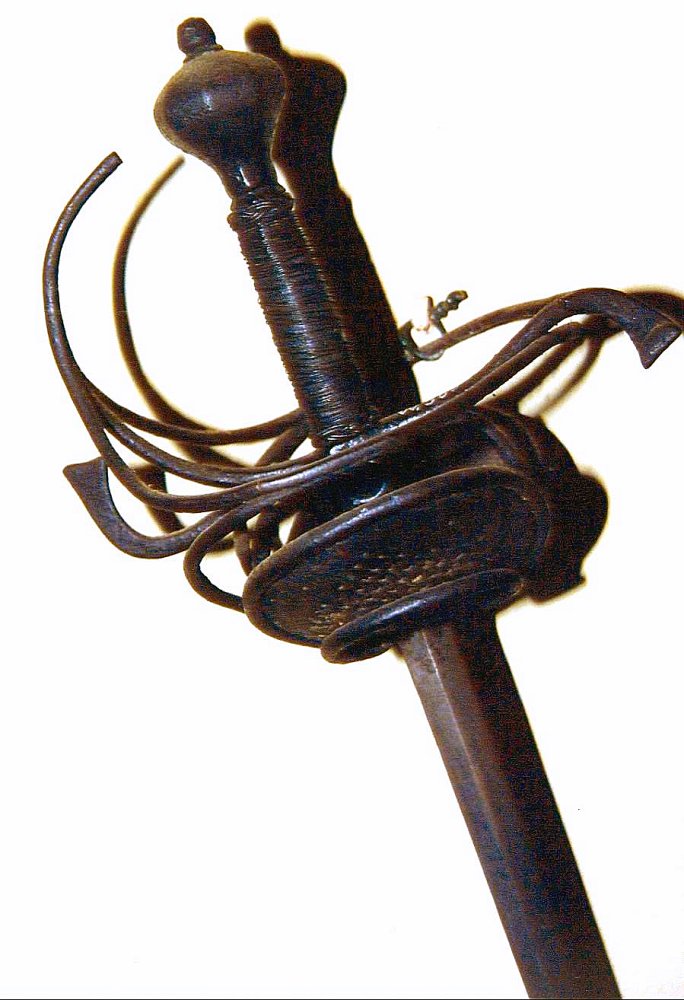

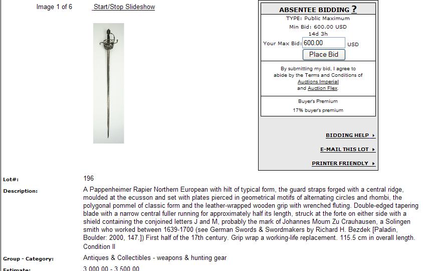

The next one was also sold at Auctions Imperial, March 15, 2008.

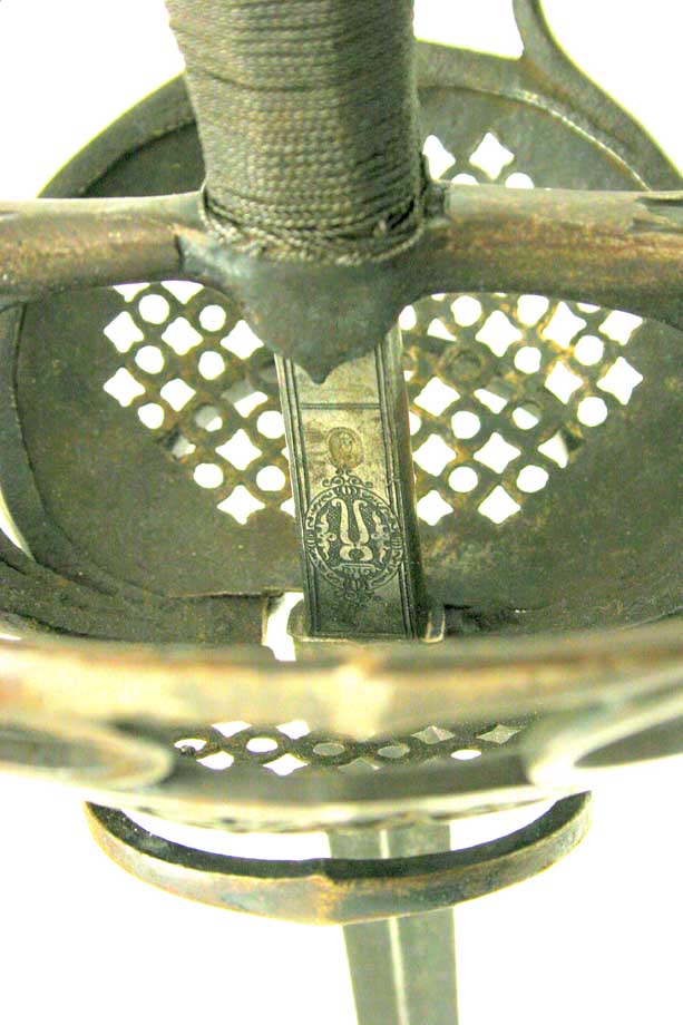

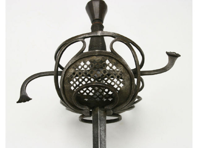

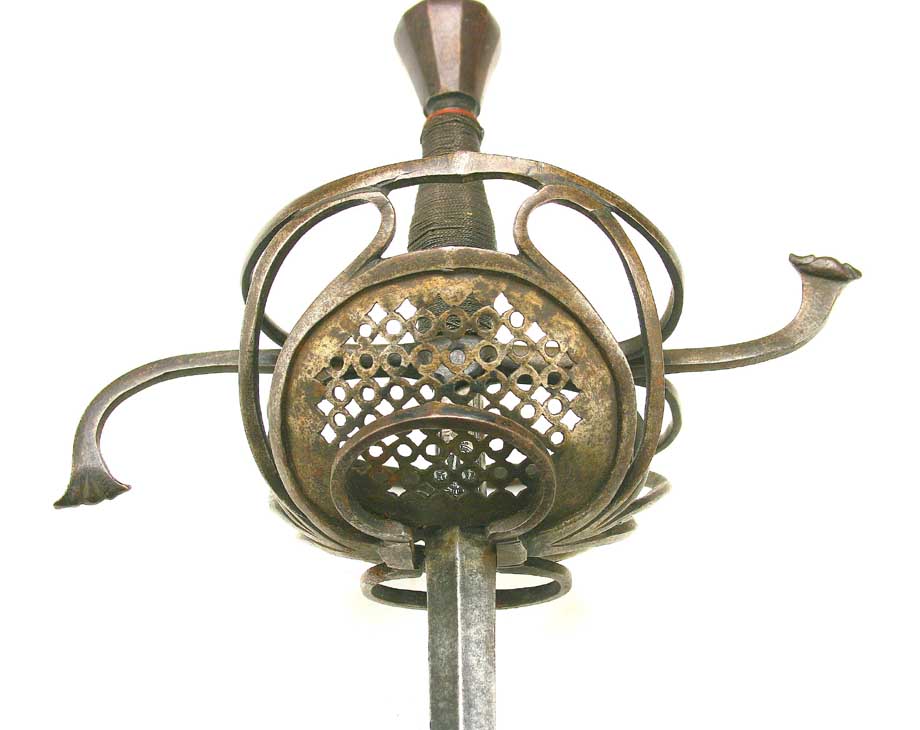

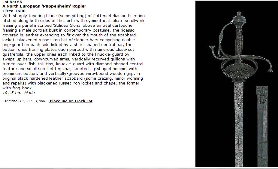

And an absolutely fine and important piece retaining its original sheath, sold Bonhams, ex-Visser Collection, in 2007, to a friend of mine.

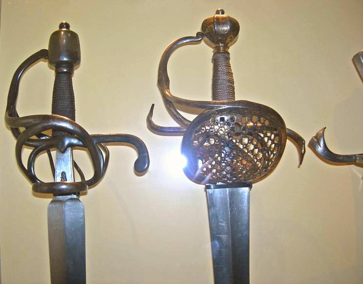

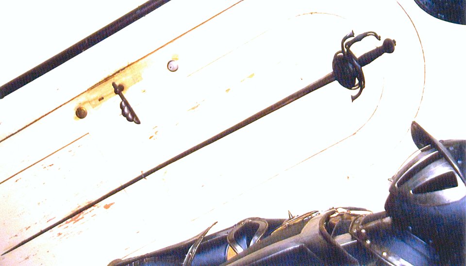

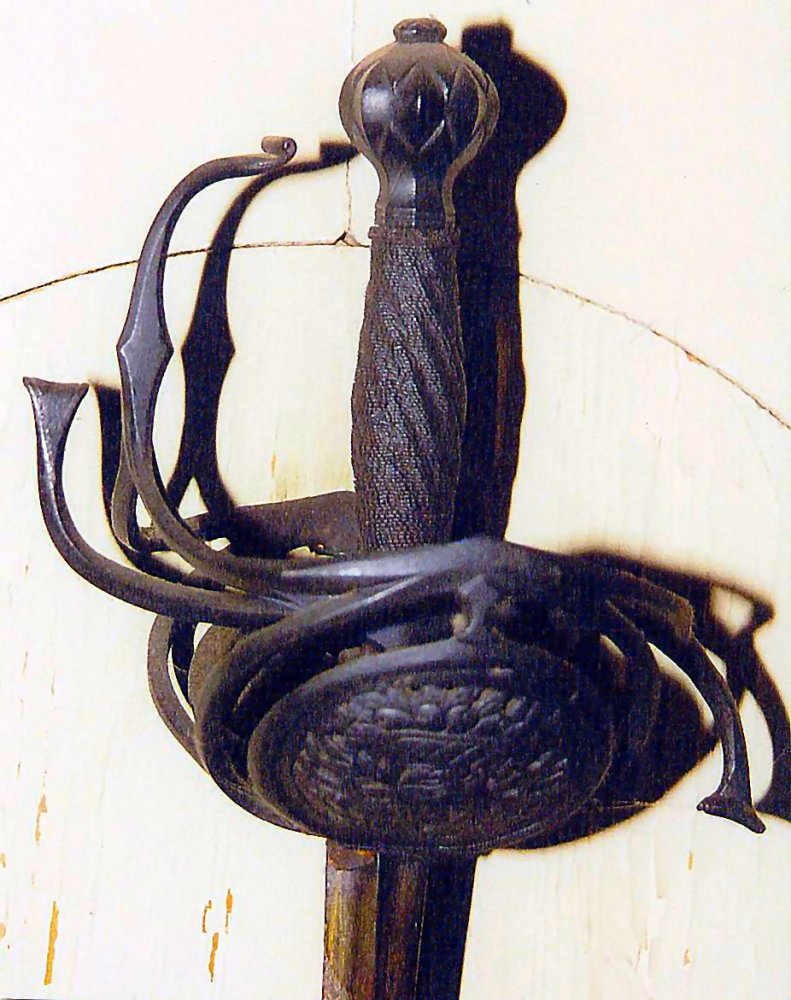

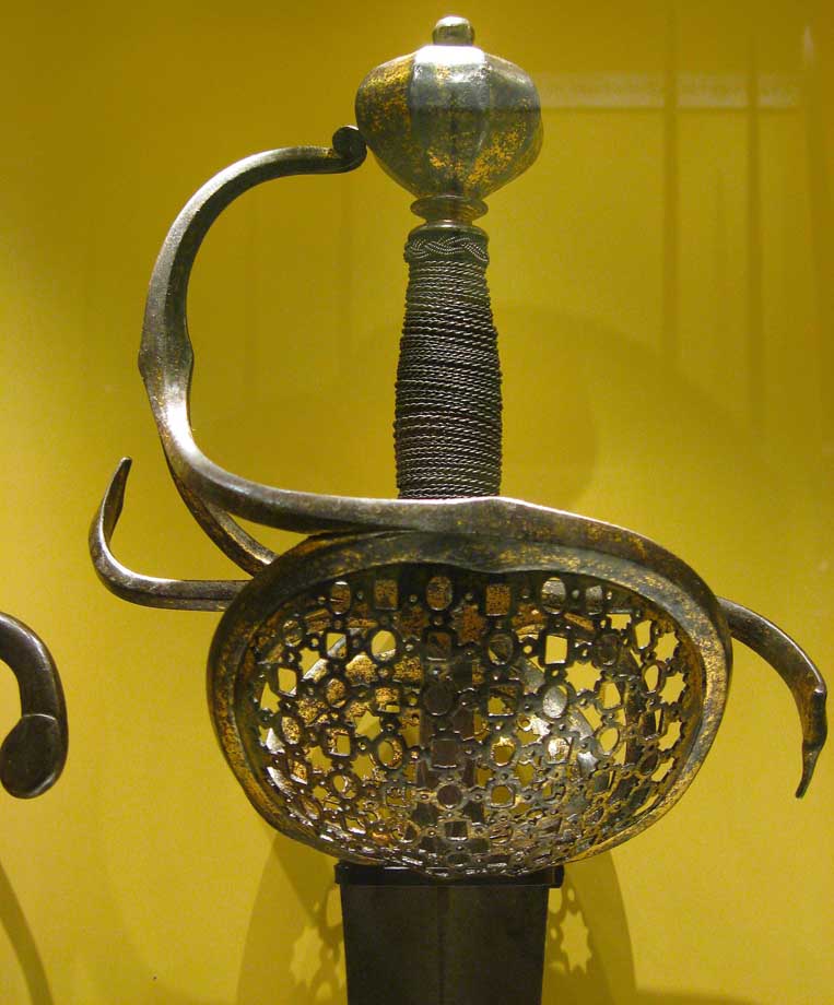

Default A Variant Pappenheimer Rapier at the Army Museum Stockholm
I owe two photos to kisak - thanks a lot, kisak!

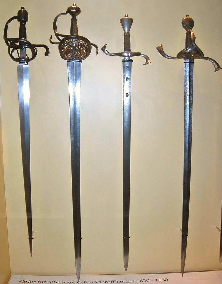

What is the first sword from the left?
Muenchnen town watch?

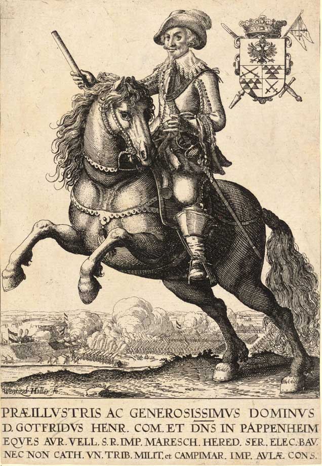

I have been interested in why the first example shown in this thread was identified as possibly English, so I spent some time tonight checking into this.
While this example is obviously German, and does correspond with the hilt example found in "The Rapier and Small Sword 1460-1820" , A.V.B.Norman, 1980, #67. The pommel also is similar to #64 ( Norman, p.268) described as the type typically found on these 'Pappenheimers'.

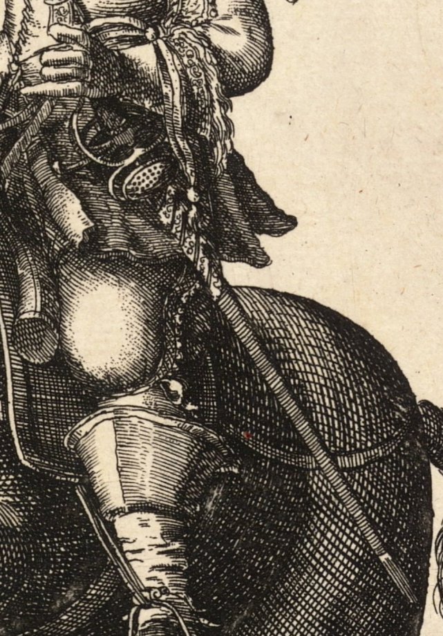

The term 'Pappenheimer' seems to derive from later collectors associating this type of rapier with distinct hilt having pierced convex plates in the rings of the guard, to Gottfried Heinrich Graf zu Pappenheim (1594-1632) who was a distinguished cavalry commander in the German Thirty Years War. It is also suggested by Norman (op.cit. p.140) that an engraving by Wenzel Hollar of him with a sword with somewhat similar hilt being visible may be the source of the idea ("Wenzel Hollar", G.Parthey, Berlin, 1853, #1336).
For some reason it seemed to me that I had seen somewhere an illustration of a Royalist trooper carrying a rapier similar to the 'pappenheimer' so I thought it might be interesting to search out that idea. While I have been unable to locate any evidence as yet confirming that now misplaced reference, it did seem worthy of note that there were German swordsmiths in England, but I will emphasize that Wirsberg was not one of them.
There had been German swordsmiths in England since Tudor times where royal armouries employed foreign smiths particularly German. Apparantly workshops near Hounslow Heath west of London was a key location and in arrangements with King Charles I in 1629 Solingen smiths were brought to England to manufacture wares in Continental fashion.
By the time of the beginning of the English Civil Wars in 1642, these shops had certainly become well established and produced for the Royalist armies.
While this example sold at Imperial Armouries does seem distinctly German, especially the work of such a profoundly established Solingen maker, I am wondering if there were indeed 'pappenheimer' rapiers produced in England as suggested in this reference.
If so, it would seem that the pommel would have been more the globular type characteristic of English rapiers of the period.
According to the sign in the museum, it's a "värja" (sword/rapier) ca 1600, "of a type used by Pappenheim's cavalry in the Thirty Years War".

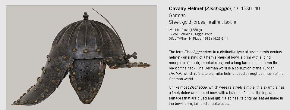

Default Pappenheim and Lobster Tail Helmets
It seems interesting how much influence there was between the Continent and England, and it seems that during the English Civil Wars there was a great deal of equipment besides obviously the swords, used by the forces involved. If I am not mistaken, the 'lobster tail' helmets were of Continental influence, and I believe a number of them were German.

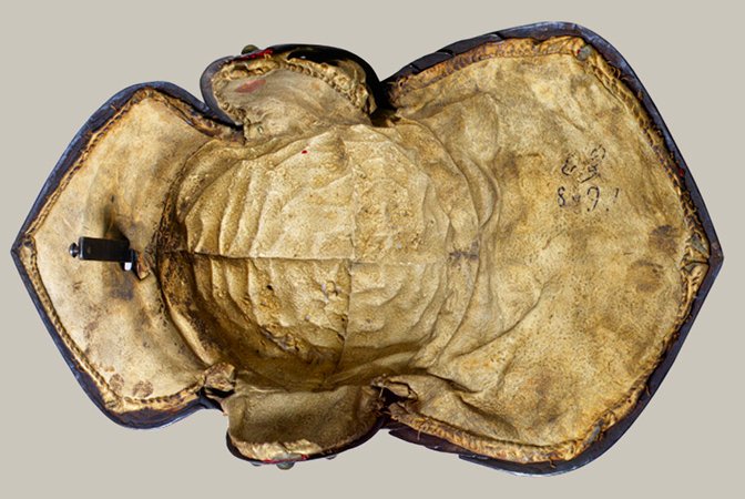

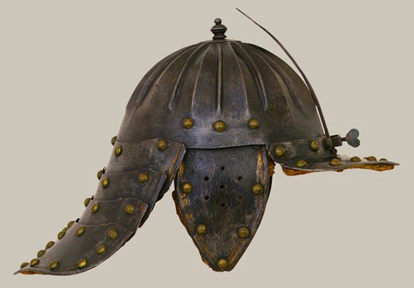

Exactly as ever, Jim,
A great number of Thirty Years War lobster tail helmets were German indeed although they seem to have originated from the Oriental part of the world and are also often connected with the Polish cavalry.
I attach two details of a German lobster tail helmet (Zischägge) from the Met collections and another sold at a previous Christie's sale.

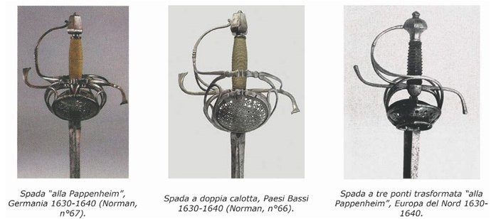

I also managed to find the portrait of Gottfried Heinrich Graf zu Pappenheim (1594-1632) by Wenzel Hollar, which you mentioned, as well as two other portraits of the Graf plus a self portrait of the artist, Wenzel Hollar.
Furthermore I attach a few views of the town and old castle of Pappenheim, plus two of the Pappenheimer rapiers illustrated by Norman and quoted by you.

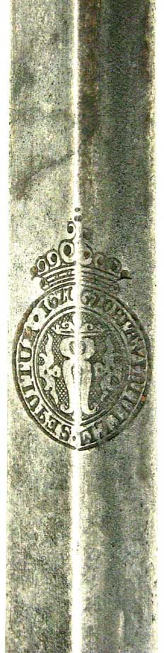

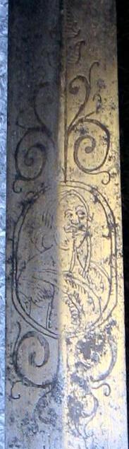

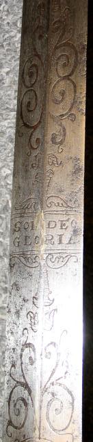

I just seem to have discovered what may be a small sensation:
It seems as if the above posted Pappenheimer rapier retaining its orginal scabbard, the blade engraved with the portrait of a noble man and the Latin inscription Soli Deo (and) Gloria, belonged to a guardsman of Gottfried Heinrich Graf zu Pappenheim (1594-1632). It is now in the collection of a friend of mine.
The portrait on the blade is very similar to the Graf Pappenheim portraits posted.
Anyway, I'll repost them.

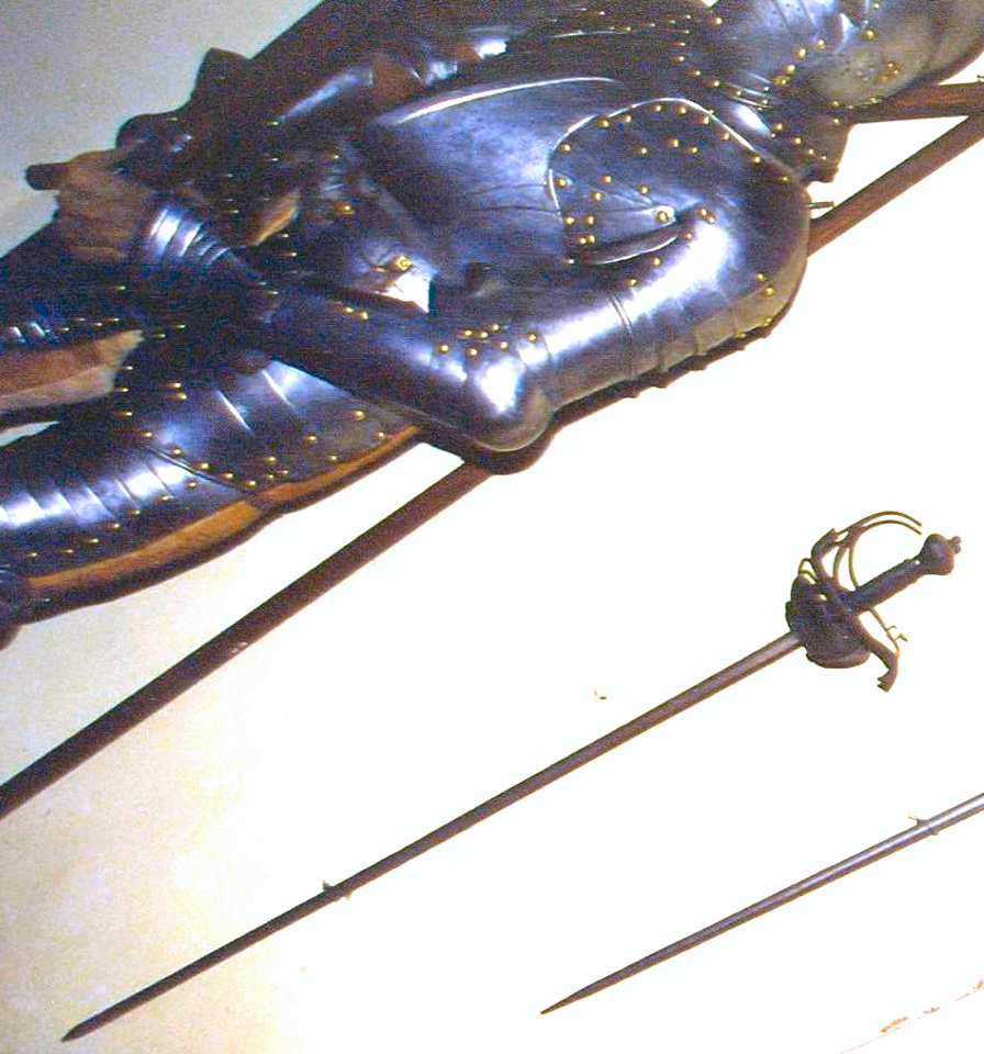

Two Pappenheimer rapiers, ca. 1630, preserved at Schloss Braunfels, Northern Germany.
Author's photos (2005) and copyright.
