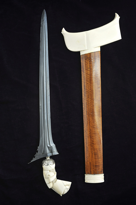

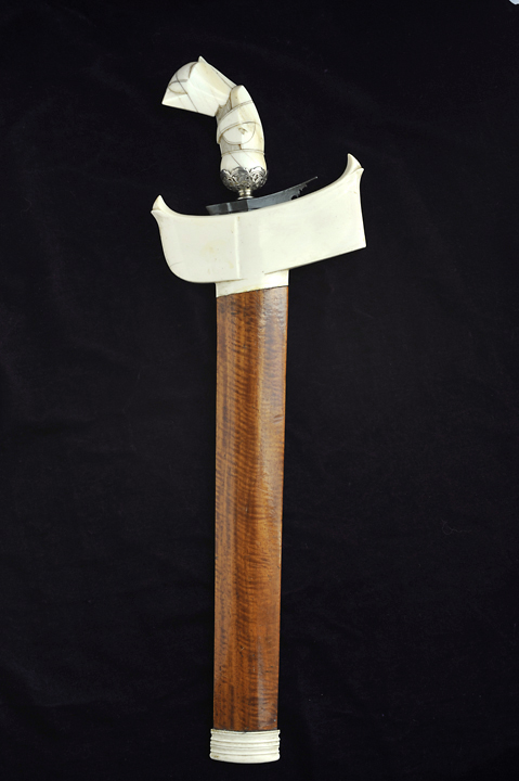

Well i'm sure that some of you might be wondering just what it is that creates such a beautiful shadow...
....and Kai Wee, i'd say if anyone here has access to beautiful Malay keris worthy of a nice "pin-up" coffee table book it's you...I'll have my agent call your agent and well do lunch...

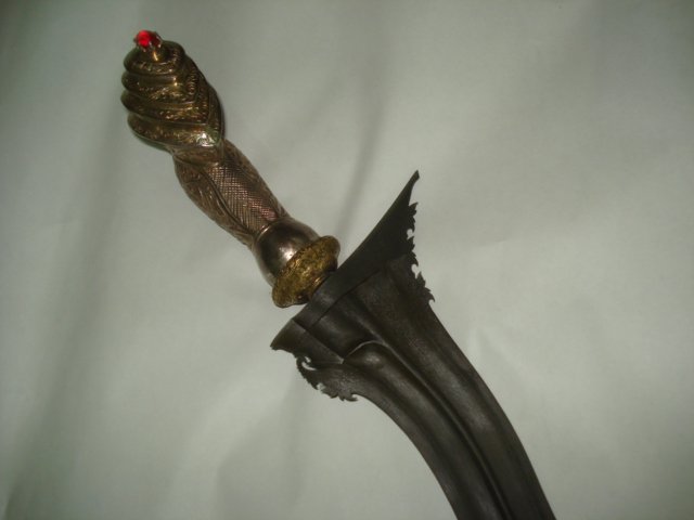

Beautiful fittings.. looks like a piece from Kedah. If you don't mind David, can we see the blade..

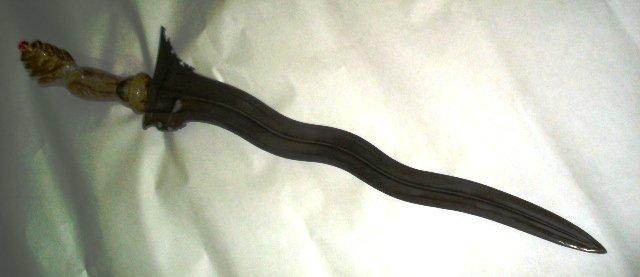

Well, i sure got myself into a bind this time, didn't i.
As i am sure some of you know it is not generally my practice to show my blades on the internet for numerous reasons, some practical, some personal. But it is also not my intention to be a tease either, so since i have raised the interest level of my own accord i suppose it wouldn't be fair of me not to give you all a bit of a viewing, especially given the relevance of this blade to Kai Wee's concurrent Carita thread.

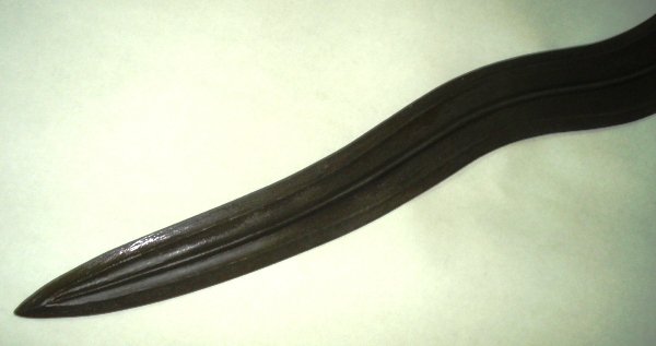

Killer beauty! the lines are so sharp that looking at it can cut...

Aweee.. David *drooling*, what a beauty.. very nice well-constructed piece indeed.. There's some age to it but imho, haven't reach antique status yet..

Not sure what more i can tell anyone Gustav. I pretty much lucked into this keris shooting a collection of weapons that someone in my area was trying to get rid off. JHe needed images for internet sales. He had a number of keris and i got some in exchange for the work and also bought others at some good prices. I have many more Java/Bali keris in my collection so the Malay pieces are more a mystery to me, but i do know quality when i see it.
As for age i wouldn't call this contemporary either, though i also would question if it is 100 years old. So i might call it "old", but not yet antique. It shows some age,patina and slight pitting and the I have always thought that pre-WW2 was a good assessment, but i might be wrong.

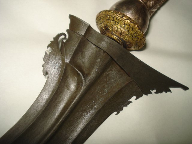

Regarding the really good new Malay kerises, Shahrial's recent comments made me sit up and try to take note of what's around. So far, I've only seen 1 example which I would consider as good. Perhaps it would also be useful to post examples of what is considered a good new Malay keris to share that standard. It would also be useful as a yardstick for collectors to know what is the best available out there.

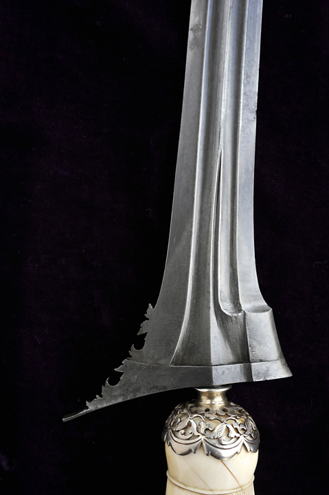

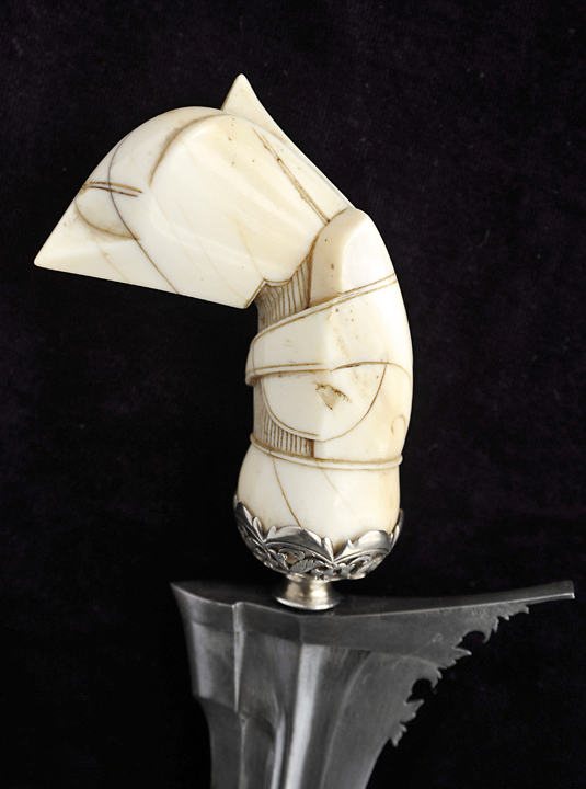

To start that off, I post the following pictures, taken from a fellow Facebook acquaintance's photo album, of the good new Malay keris (apologies, I cannot remember who is the owner of the pictures and the keris). I must clarify that I'm only referring to the blade, and not the fittings.
