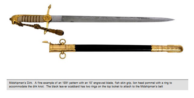

more standardised victorian dirks looked like this one, 1891 pattern. widely reproduced - may even still be in production. earlier one looked a lot like this (1879 pattern is nearly identical)
Hi Mate,
This one definately looks like the Cold Steel one. Wondered how to be sure its not a modern one aged up is all. No stamps of any kind on it that I could see. definately dark horn grips, never wire bound.

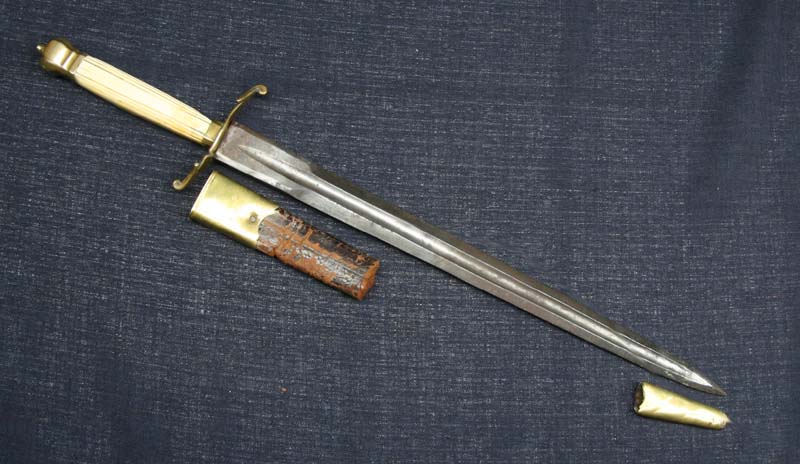

This what the dirk on the first photo is based upon, a popular form from the mid-1790s to ca.1810.
Sometimes there is 'cigar band' around the waist of the grip, which is engraved with a fouled anchor, which, understandably, adds a factor of desirability to collectors.
Both pieces are in my collection.
Thats a beauty Dmitry! (5 Ball to match the sword?)

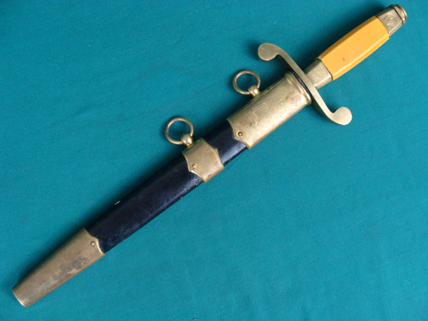

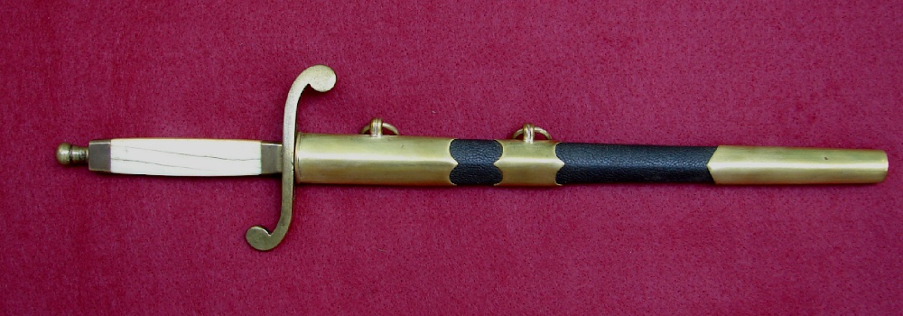

Seems quite a generic style, here's a couple of Russian dirks separated by more than a century.
Norman.

The two dirks that Norman has posted are -
1.Soviet Model 1944 officer's dirk
and its predecessor.,
2.Russian Imperial Model 1803 naval officer's dirk.
The latter one was a regulation pattern, based on the period British examples, and similar to the one I posted above.
Funny enough, there was no regulation pattern British naval dirks until 1856, but other countries copied the popular British designs from the earlier times, and made them Pattern long before the Royal Navy got to pattern theirs.
