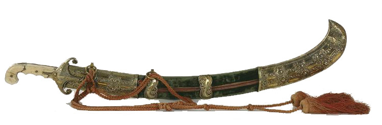

Hi, not 100% relevant, but still nice to see, this is a sabre made for Napoleon, while he was in Egypt.

No, it is not the same sword. The one on recent sale was of "european style" while this is of mameluke style.

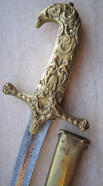

Another interesting matter would be the source of their weapons?
Were they made by the French, or in Egypt, when Napoleon bought his 2000 Mameluke mercenaries?
IIRC, the Mamlukes were sort like a caste, and as such they probably wore blades of their own property.
OTOH, the Vieille Garde had Music bands dressed and attired in the Turkish/Mamluke way. Weapons for the latter were of Mamluke style, but French in actual provenance.
The mameluke style sword was adopted by many European armies, both for their musicians and for field use. The quality and features of these blades vary accordingly.

Posts: 7,300
Manolo, we certainly don't want to put you to too much trouble. But if you have ever been referred back to an old thread in our archives and found nothing but "image removed" icons amongst the text you might understand our frustration. Without the weapons in discussion properly illustrated the text often becomes completely useless. As Lee pointed out, you own the rights to these photos regardless of who you might sell the weapon to down the line. And you certainly don't need to reshoot these. The image below i simply dragged off your site. it was already well within the size specs for this site so i didn't need to to anything to it, just upload. I can delete this post (and image) if this offends you, but this will preserve these images connected to this thread for as long as this site exists therefore keeping the conversation and continued research viable.
